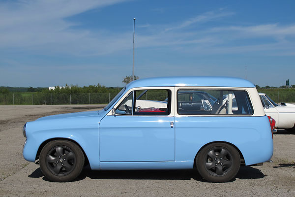

Ryan Reis' Oldsmobile Quad 4 powered 1959 Hillman Husky
Ryan Reis' Oldsmobile "Quad 4" powered 1959 Hillman Husky
Owner: Ryan Reis
BritishV8 UserID: mgbreis
City: Beatrice, Nebraska
Model: 1959 Hillman Husky
Engine: Oldsmobile Quad 4 2.3L
Conversion by: Steve Green. (Finished by Ryan Reis)

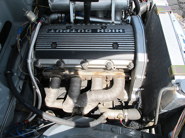

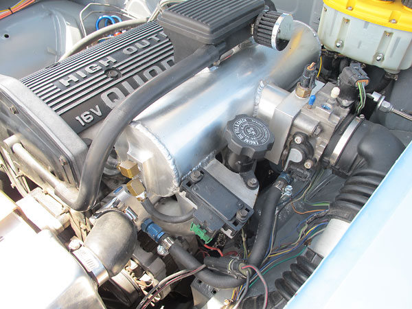

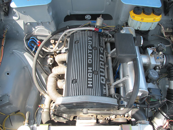

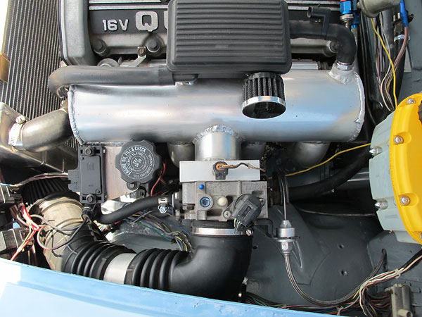

Engine: 1992 Oldsmobile Quad 4 H.O. 2.3L, D-code (rated 190hp) from an Oldsmobile Achieva SC. Stock DOHC camshafts and four-valve-per-cylinder valvetrain. Converted to RWD. Custom aluminum log-type intake manifold and plenum. Stock throttle body. Stock engine wiring.

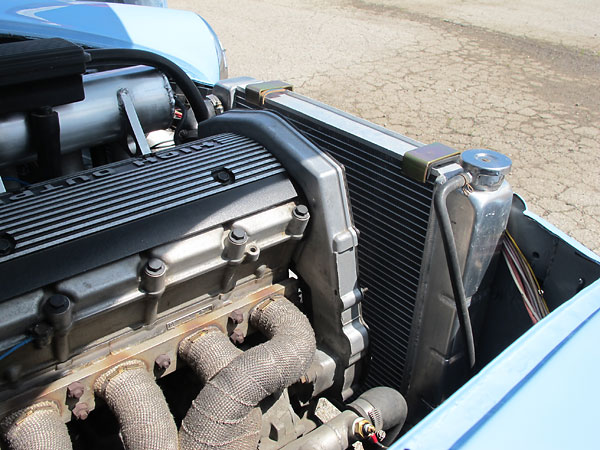

Cooling: Speedway Motors aluminum radiator. Electric pusher fan.

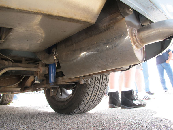

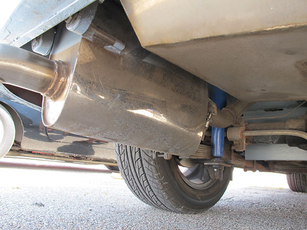

Exhaust: Custom stainless four-into-one header. Custom stainless one-into-two exhaust system with three mufflers. Borla stainless steel mufflers.

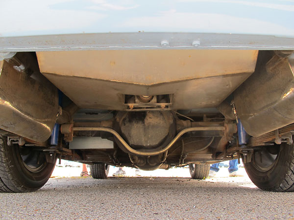

Rear Suspension: stock leaf springs. Custom anti-sway bar. Tube shocks of unknown origin.

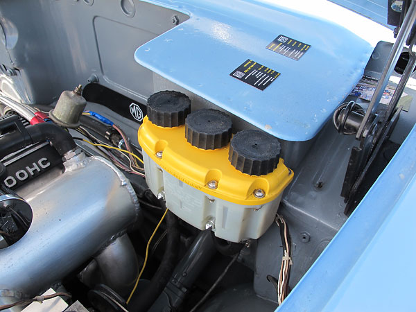

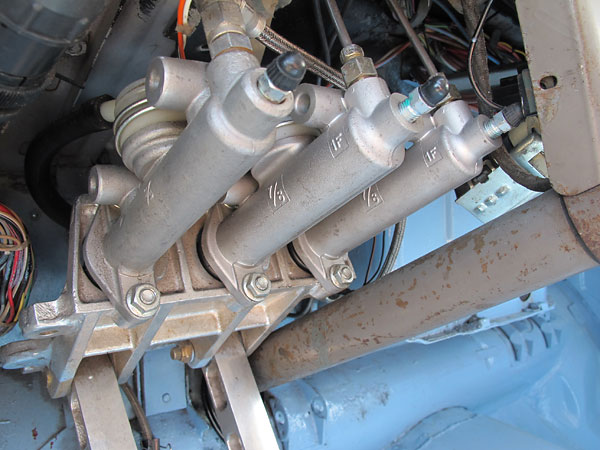

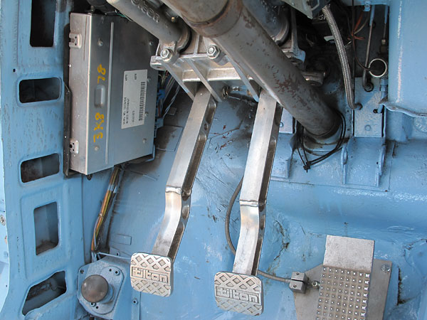

Brakes: (master) Tilton pedal assembly with balance bar and 7/8" master cylinders.

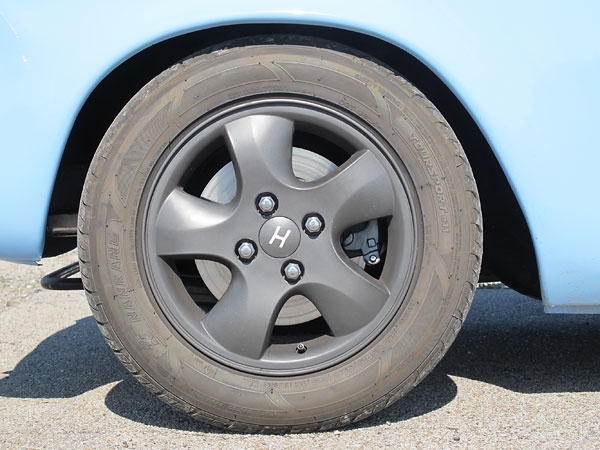

Wheels/Tires: Mercury Cougar wheels, circa 2000. Nankang XR611 tires (185/65/15 front, 205/60/15 rear.)

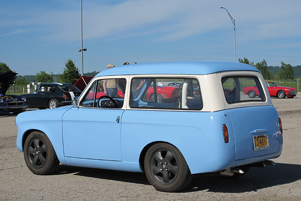

Body: rear quarter panels reconstructed using late model Nissan Altima front fenders. Jaguar XJ6 fuel filler door.
Paint: Eastwood epoxy primer (two coats) over original paint, feathered at the edges of repairs. PPG Omni MP282 high build primer. Farecla dry guide coat. Lots of block sanding with a hard long board. TCP Global Restoration Shop single stage acrylic urethane in Glacier Blue and Wimbledon White.

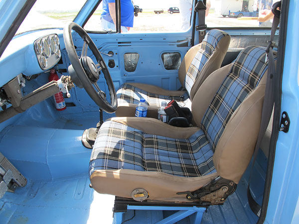

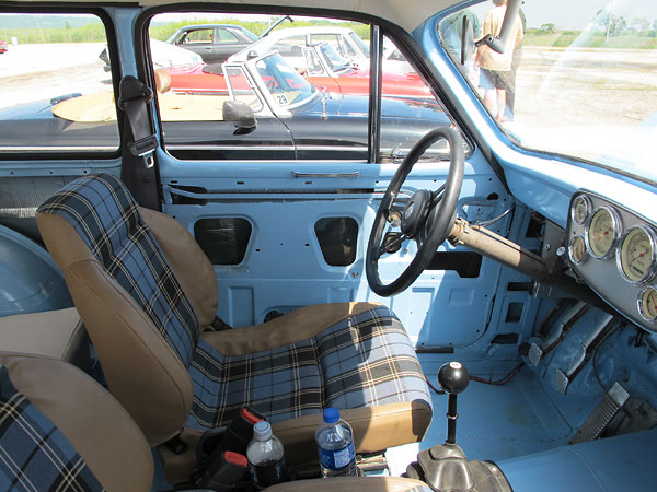

Interior: 1980s Subaru front seats, recovered by Ryan. Stock back seat, recovered. Custom headliner made from canvas drop cloth. Modified Jeep Wrangler roll hoop is for mounting 3-point seatbelts. Jeep Wrangler seat belts.

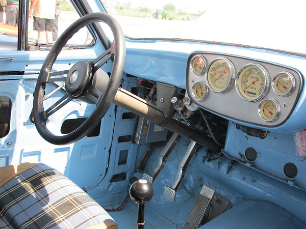

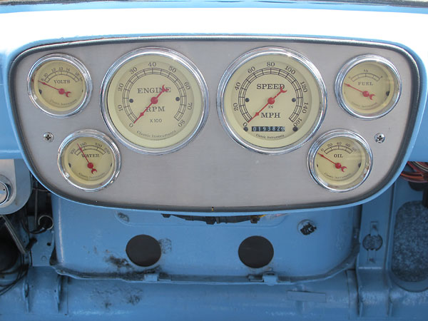

Instruments: Classic Instruments gauges, including an electronic speedometer.

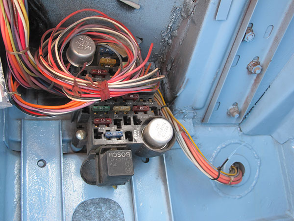

Electrical: stock alternator and starter motor. Painless Wiring PPPI wiring harness. Taillights and turn signals have been converted to newer style sockets/bulbs.
Tilton hydraulic reservoir.
Stock Oldsmobile Quad 4 throttle body.
Manifold absolute pressure sensor.

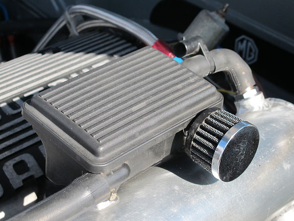

Oldsmobile Achieva crankcase breather / oil trap.
Like vintage Offenhauser engines, Quad 4 engines feature separate camshaft towers.
Ryan plans to eliminate the Quad 4 engine cover and polish the aluminum underneath.
Like vintage Offenhauser engines, Quad 4 engines feature separate camshaft "towers".
Don't use through-the-core fan mounts!
When purchased by Ryan, this Husky had a custom brass radiator with early Camaro end tanks.
An electric fan mounted with the through-core ties had nearly completely destroyed that
radiator core in only 17,000 miles or less. The new fan is mounted seperately from the core.

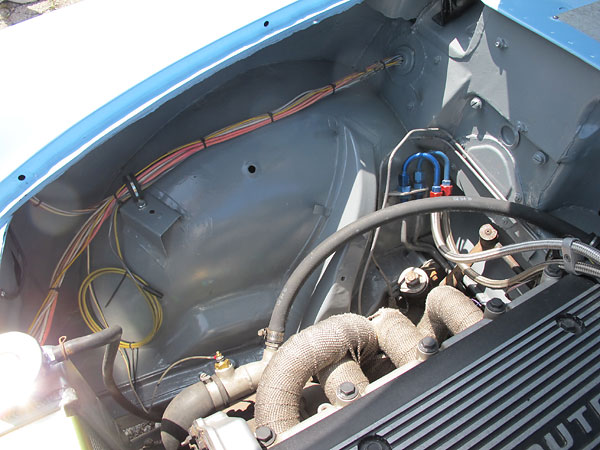

Header wrap helps keep temperatures down inside the engine compartment.

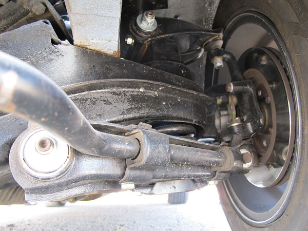

Front Suspension
Stock Hillman Husky crossmember with Sunbeam Alpine upper and lower A-arms and spindles.
Stock Hillman Husky crossmember with Sunbeam Alpine SIV/SV upper and lower A-arms and spindles.
(Alpine SIV/SV A-arms incorporate ball joints where the Husky had king-pins.) Pontiac Grand Prix
11" vented rotors are used with Sunbeam Alpine hubs which have been turned for spindle clearance.
Credit for the front brake system design: Bill Blue from the Sunbeam Alpine Owner's message board.
Rear Suspension
Custom stainless steel gas tank.
Stock leaf springs. Custom anti-sway bar. Tube shocks of unknown specification.
Borla stainless steel mufflers. Three of them are employed!
1980s Subaru front seats, upholstered by Ryan.
Jeep Wrangler 3-point seat belts for both front and rear seats.

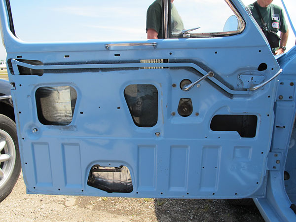

Custom door cards will be added, and will help quiet down the interior.
Mazda RX7 steering wheel.

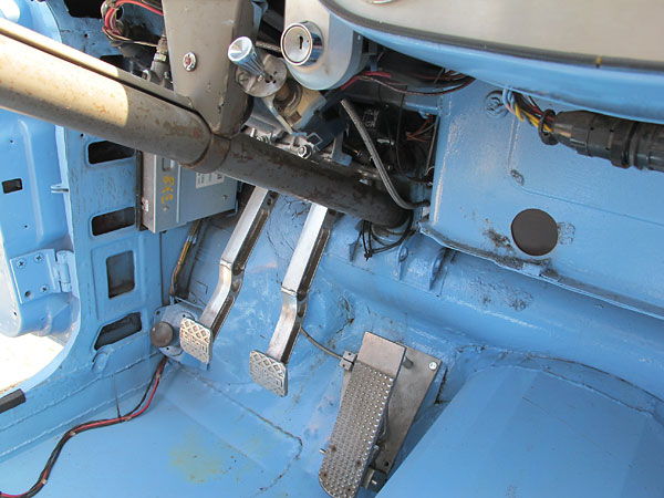

Tilton pedal assembly with shortened clutch and brake pedals.
Tilton balance bar and 7/8 inch master cylinders.
The Tilton pedal assembly features a balance bar and 7/8" master cylinders.
(Ryan changed both front and rear masters from 3/4" to 7/8" bore diameter.)
Floor mounted aluminum throttle pedal.

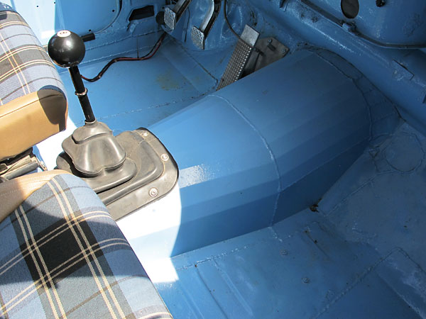

Custom fabricated transmission tunnel.

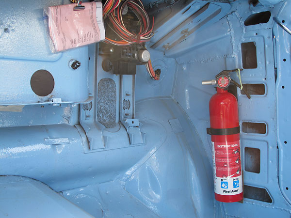

First Alert fire extinguisher.
Painless Wiring PPPI wiring harness and General Motors style fuse block.

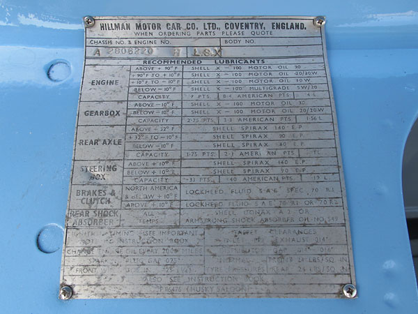

Hillman Motor Car Co., Ltd., Coventry, England. serial number plate.
When ordering parts please quote Chassis No. &l Engine No.: A2806220H / LSX.

Single stage acrylic urethane from TCP Global Restoration Shop.
Ryan did the bodywork and applied this paint job in Glacier Blue and Wimbledon White single
stage acrylic urethane from TCP Global Restoration Shop. About the bodywork: "I don't like
a lot of the new flexible sanders that are out there, even on cars as curvy as the Hillman.
To get a car straight you need a hard block and aggressive sandpaper. The new powdered
guide coats are awesome; they make block sanding a snap and are worth every penny."

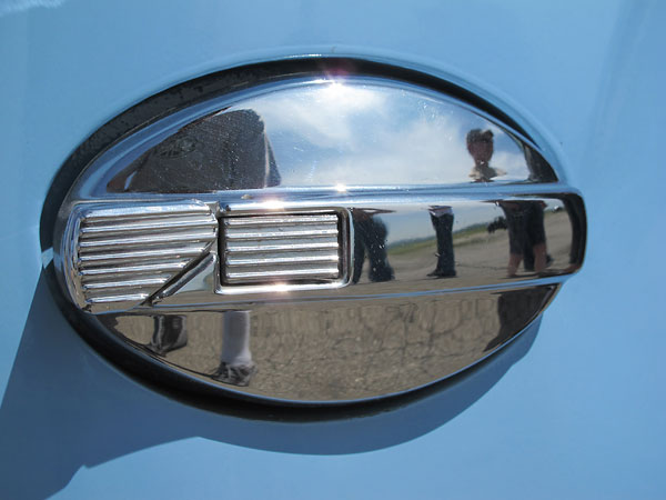

Hillman Husky door handles.

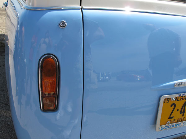

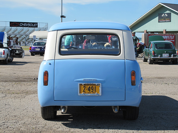

I'd rather be square dancing.
"I'd rather be square dancing."
Handle for opening the tailgate?
Ooops! Since the new bodywork, there's no handle for opening the tailgate.
Spacers and longer studs were required to fit these 2000 Mercury Cougar wheels.
Nankang XE611 tires (185/65/15 front, 205/60/15 rear.)
