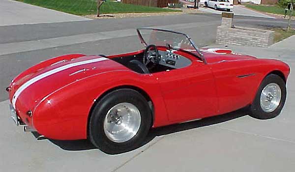

Owner: Rod and Janice Evans
City: Cle Elum, WA
Model: 1956 Austin Healey 100 (BN2)

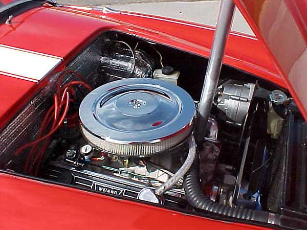

Engine: Chevrolet 383cid V8
Engine: Engine is a 350, stroked to 383, with 2:02 slant plug heads. It's been balanced and blueprinted, and fitted with a Lunati roller cam and Crane "Gold" roller rockers. The distributor is a Mallory Unilite. The engine has 4 bolt mains.
Transmission: Full manual, reverse-shift-pattern Turbo 350.
Rear End: Narrowed 1958 Olds, with Moser Engineering axles and 4.30:1 gears.
Wheels: 15" x 4" (front) and 15" x 10" (rear).
Brakes: Later model Healey disk brakes (front) and Oldsmobile drums (rear).
Curb weight: 2163 pounds.
Other: Fiberglass hood.
Performance: Mid-11 ET's.
Comments : We bought this car a few years ago in Colorado after one of those love at first sight things and I was tired of turning wrenches. Next thing I knew, out with the 355 and in with a 383 stroker. The 3:55 posi was fine for getting groceries but... So in with the 4:30's out of my friend's race car. We all know how this goes, don't we? Still have to finish the dual quads, roll bar and new paint, but it will wait until this spring.

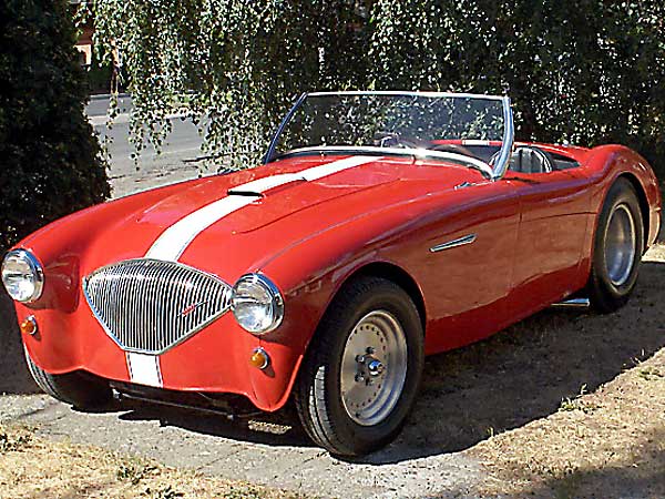

Austin Healey fiberglass hood

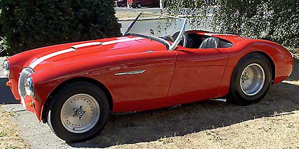

passenger side, Austin Healey 100 BN2

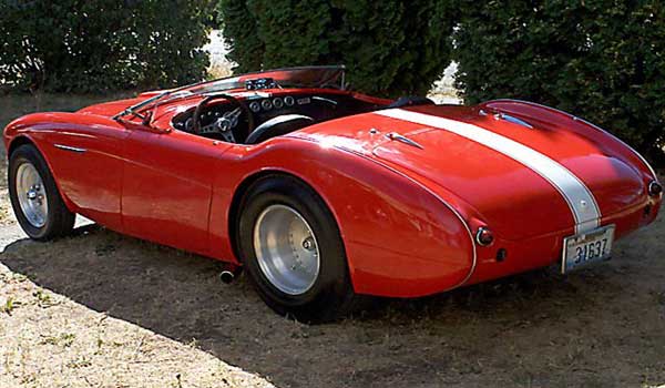

driver side, Austin Healey 100 BN2

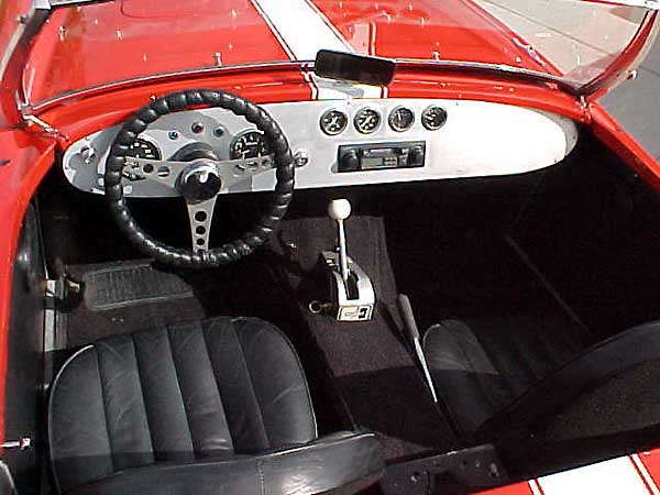

custom dashboard in an Austin Healey 100 BN2

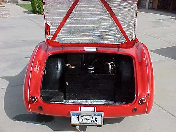

fuel cell in an Austin Healey 100 BN2
