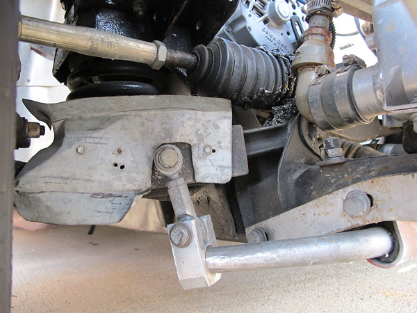

Front Suspension: converted to rack-and-pinion steering, with Spridget (front steer) rack mounted on aluminum pillow blocks. Stock Austin Healey Armstrong lever shock absorbers. Custom, adjustable anti-sway bar.

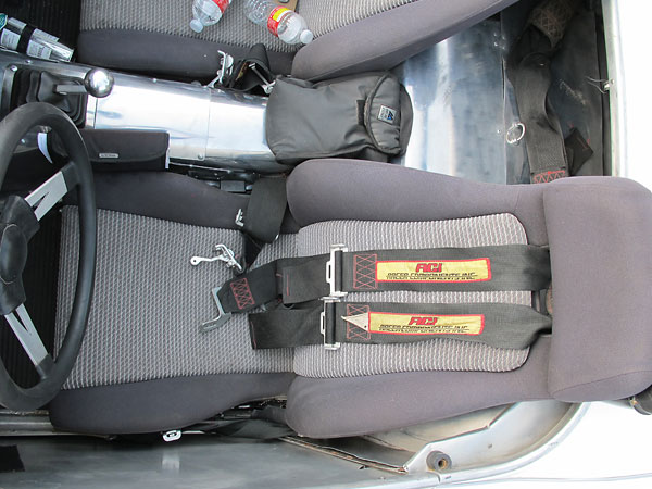

Interior Mods: custom aluminum trim panels and transmission cover. Grant cushioned grip steering wheel. Toyota Celica Supra seats. Racer Components Inc. five point latch-and-link safety harnesses.

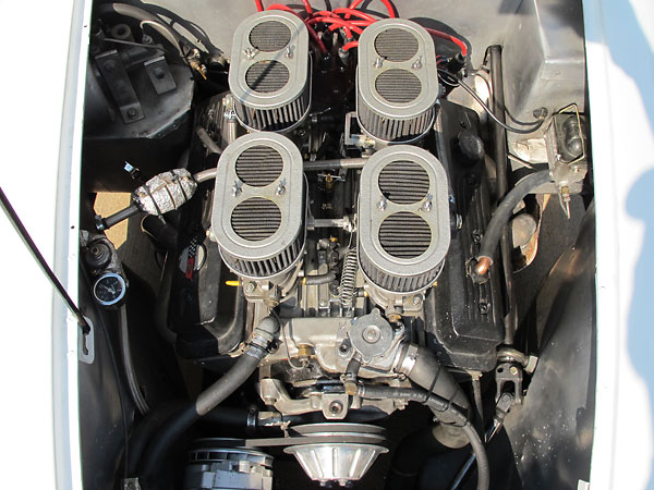

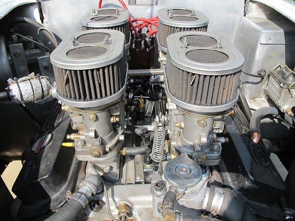

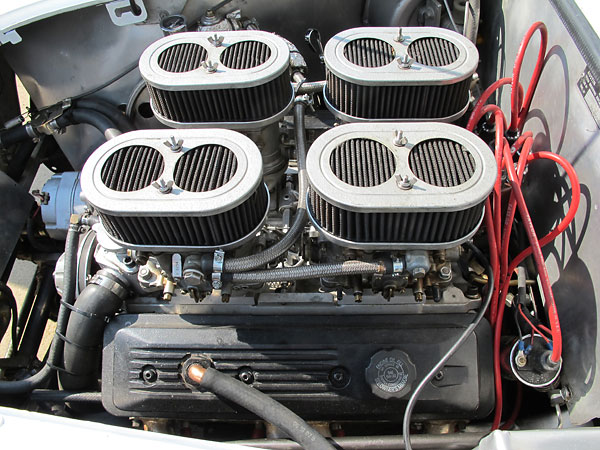

Four Dell'Orto DRLA 48D carburetors.
Four Dell'Orto DRLA 48D carburetors. Anti-competitive business practices aren't a modern invention.
The Weber carburetor company purchased Dell'Orto just so they could close Dell'Orto's factory and
proceed on their own. Richard strongly prefers the old Dell'Orto design to the rival Weber IDA model.
He feels that the transition circuit from primary to main circuit is superior; Dell'Orto carbs don't
have the IDA's characteristic bog that's so hard to tune out.

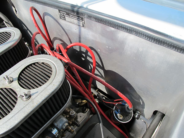

Pertronix Flame-Thrower II ignition coil. Taylor Spiro Pro 8mm silicone spark plug wires.

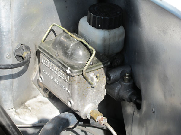

Wilwood brake master cylinder. Tilton clutch master cylinder.

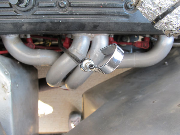

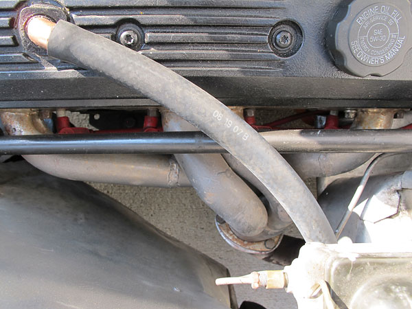

Custom four-into-one exhaust headers, driver's side.
K&N gauze air filters were specially modified.
K&N gauze air filters were specially modified: holes were cut in their top plates and
additional filter media was added for increased airflow. Previously, Richard had clear Lexan
plastic installed in the top holes. They looked really cool... until one of them shattered.

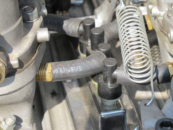

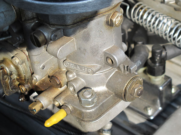

Dell'Orto DRLA 48D carburetor, tag number R6254.
Dell'Orto DRLA 48D carburetor, tag number R6254. Richard anticipated that swapping from a
four barrel to an independent runner system would help high RPM performance. He discovered
that low RPM performance was even more dramatically improved.

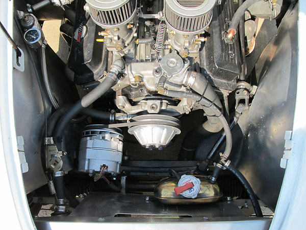

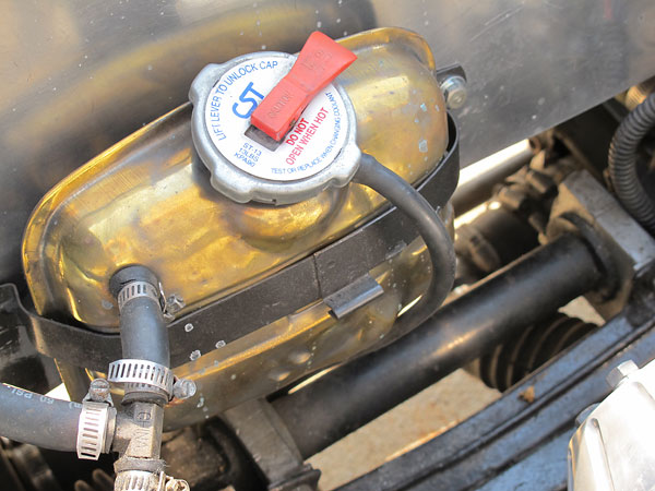

Cooling system filler cap on the thermostat housing.
Spridget steering rack mounted on aluminum pillow blocks.
Coolant reservoir. Background: Spridget steering rack mounted on aluminum pillow blocks.
(The big Healeys weren't offered with rack and pinion steering.)

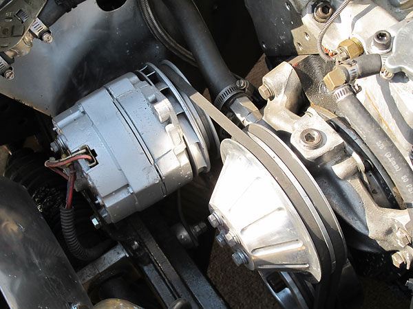

Delco Remy alternator, mounted and spinning backwards.
Delco Remy alternator, chassis mounted and spinning backwards. Alternators produce voltage whether
they're spinning forward or backward. Generators, on the other hand, are direction sensitive.
(If you try this at home, be mindful that your alternator's cooling fan will be less effective.)
Custom four-into-one exhaust headers, passenger's side.

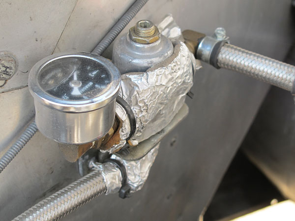

Holley adjustable fuel pressure regulator with Marshall liquid-filled fuel pressure gauge.

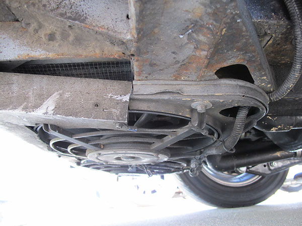

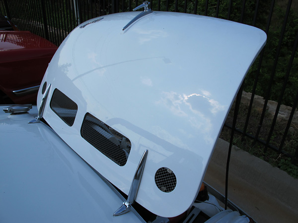

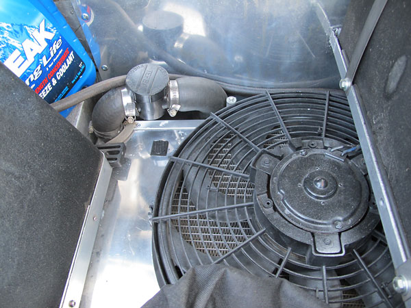

The car's main radiator is mounted in the floor of the truck, so it requires a vented trunk lid.
This vent location works exceptionally well. When Richard initially installed the rear-mounted
radiator, he had it drawing air from the passenger component. He quickly found out that at road
speed the airflow direction reversed, and air coming up through the radiator heated the cockpit.
Dual electric fans pull air through a boot mounted aluminum radiator.
Foreground: electric fan, pushing. Background: Tefba coolant filter.

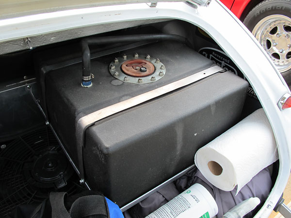

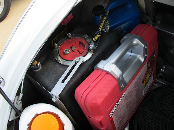

Jaz Products polyethylene fuel tank.
Supplemental Jaz Products polyethylene fuel tank.
Supplemental Jaz Products polyethylene fuel tank is selected via a dashboard mounted switch.
Richard uses it like a motorcycle's reserve tank, switching to it only when needed. Originally,
he kept race gas in this smaller tank and he could switch fuels on a whim.

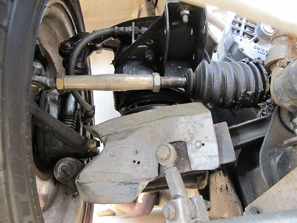

Front Suspension
Swaged aluminum steering links and high misalignment Heim joints.
Conversion to rack and pinion steering included installation of these
swaged aluminum steering links and high misalignment Heim joints.

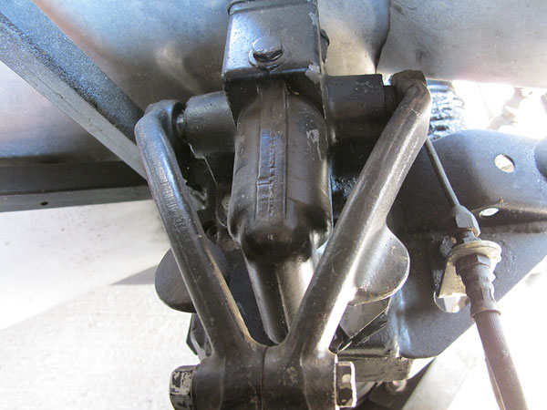

Armstrong lever shock absorber.

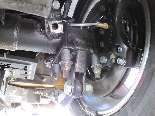

Rear Suspension
Ford 9 inch rear axle.
Ford 9" rear axle.
Four link rear suspension, plus Mumford linkage. Coilover shock absorbers.

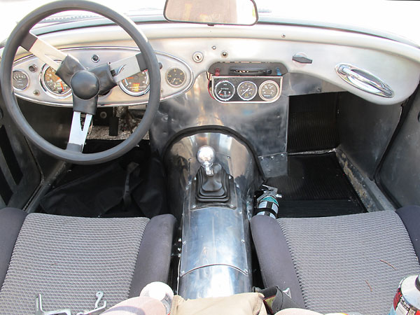

Custom aluminum trim panels and transmission cover.
Sun Super Tach II
Smiths fuel level gauge, modern AutoMeter speedometer (0-160mph), classic
Sun Super Tach II, and vintage Stewart Warner oil pressure gauge.

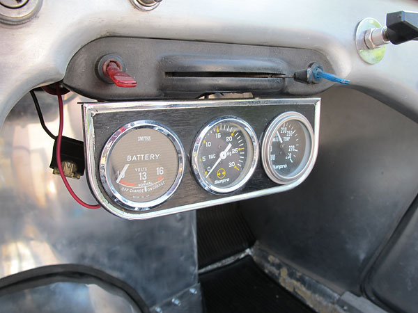

Smiths voltmeter, Sunpro vacuum gauge, and Sunpro water temperature gauge.

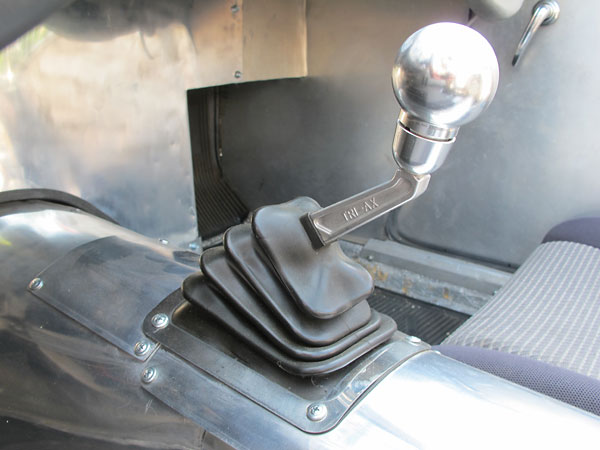

Steeda Tri-Ax shifter.
Steeda Tri-Ax shifter connected to a Tremec TKO600 5-speed. This is a very heavy duty box!
The car's seventh and hopefully last transmission, its torque rating is 600 foot pounds!

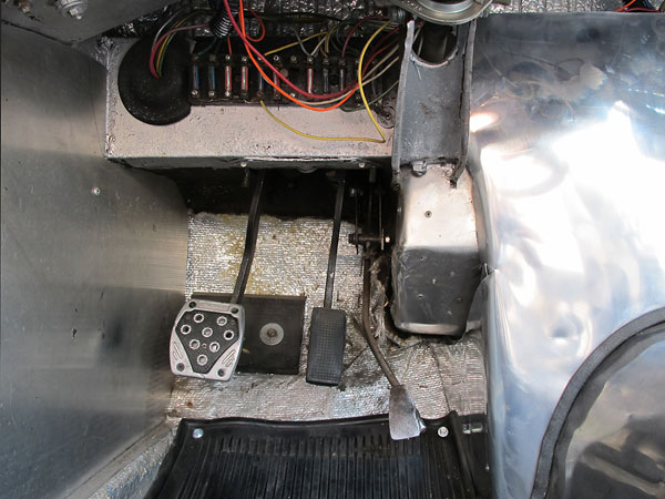

Footbox and fusebox details.

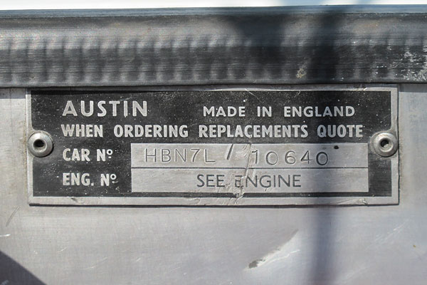

When ordering replacements quote: car number HBN7L/10640, engine number (see engine).
AUSTIN - Made in England

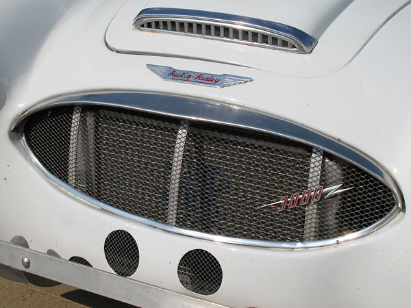

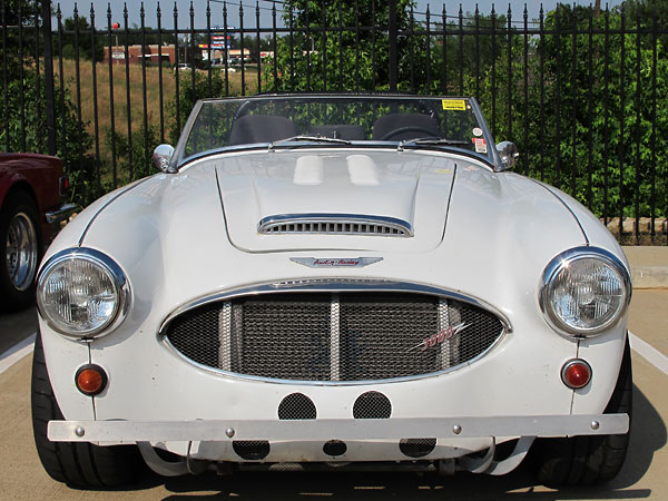

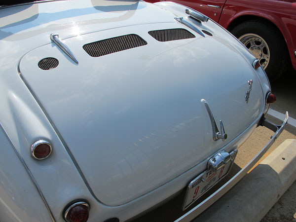

Wire mesh grille and extra vent holes in the bodywork below. Very lightweight custom bumper.

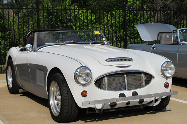

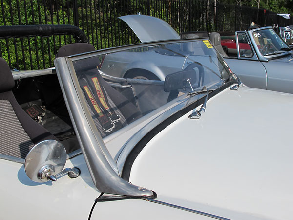

This particular Austin Healey 3000 MkI windscreen has been rakishly chopped.
This particular MkI windscreen has been rakishly chopped, and re-glazed with lightweight Lexan
polycarbonate. (Fifteen years have passed, and it's still not noticeably scratched or pitted!) From the
MkII model on, Austin Healeys came with wrap-around windscreens and roll-up door windows. Side
view mirrors weren't installed by the factory so there's great variation in type and placement.
Vented boot lid.
Vented boot lid.

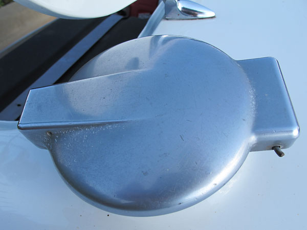

LeMans style fuel filler cap.

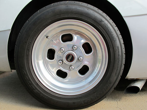

Weld Racing Rodlite 15 inch aluminum wheels. Bridgestone Potenza RE-11 205/50R15 front tires.
Weld Racing Rodlite 15" aluminum wheels. Bridgestone Potenza RE-11 205/50R15 front tires.
Yokohama ES100 215/50R15 rear tires.
