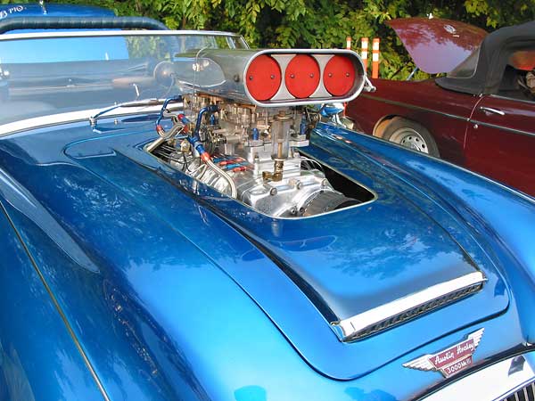

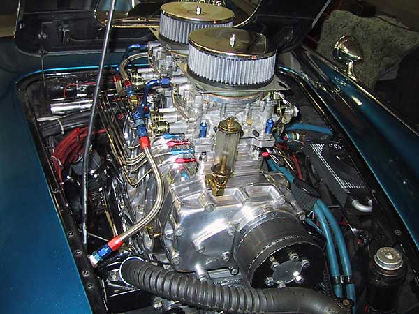

Engine: Chevy 350 (supercharged and nitrous injected)
Engine: Chevrolet 350cid Hi-Performance, bored 0.060" over.

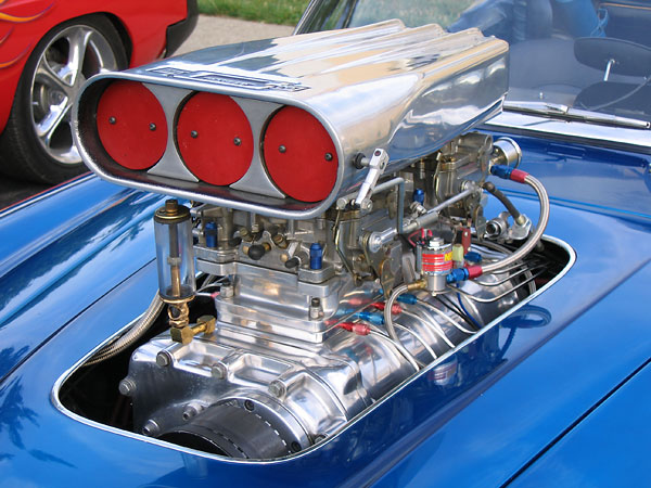

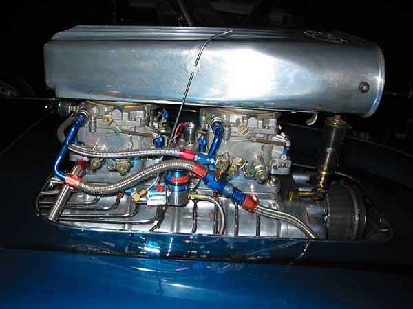

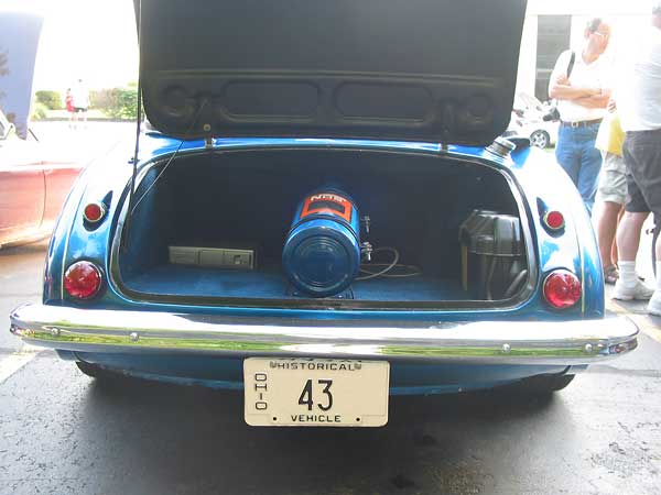

Induction: 6-71 supercharger, plus 16-port NOS system.
Cam: Hi Pro Max roller cam.
Cooling: custom six tube 11-fin-per-inch radiator with two high volume electric fans. Oil cooler with a 900cfm fan.
Exhaust: custom headers to leg pipes.

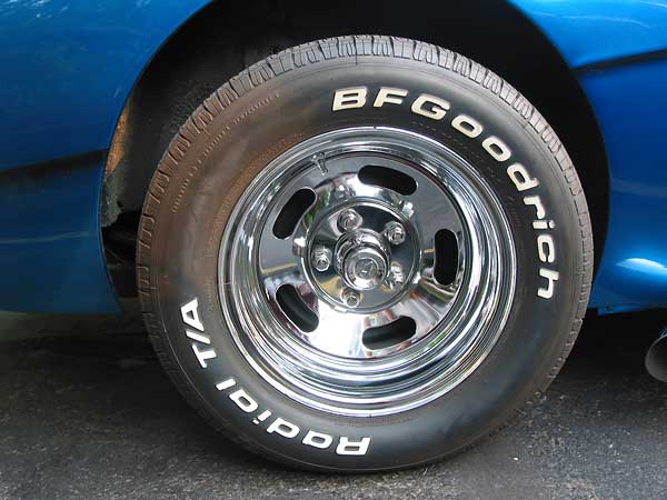

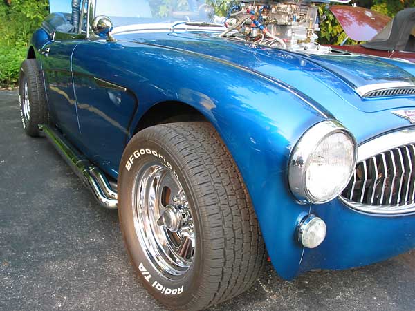

Wheels/Tires: chromed American wheels, with P245/50 (front) tires and P265/50 (rear) tires.

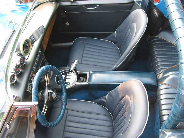

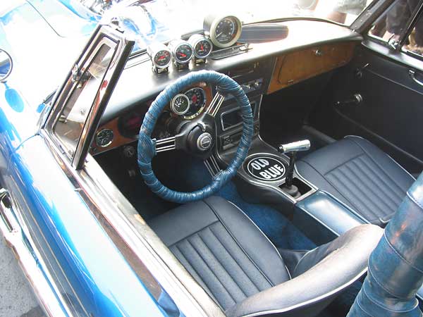

Electrical: custom wiring (by Ray Bencar). Gauge package includes: volt meter, water temperature, oil temperature, NOS pressure, boost, tachometer (engine RPM), speedometer (0-500mph), oil pressure, fuel level, and fuel pressure.

Chevrolet 350cid Hi-Performance engine
6-71 supercharger
16 port nitrous oxide system
twin four barrel carburetors
side pipes

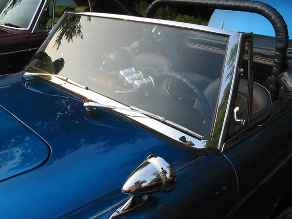

talbot mirror and polished windshield frame
auxiliary gauges
Old Blue... and shifter for T56 transmission

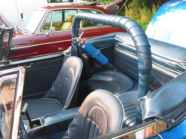

roll hoop and fire extenguisher
Nitrous Oxide (NOS) bottle
BF Goodrich Radial T/A tires
