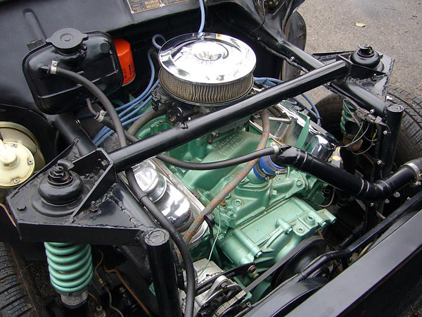

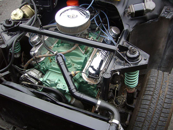

Engine: Chrysler 318cid V8. Stock camshaft. Stock cylinder heads. Chrysler 340 inlet manifold. Holley 600cfm carburetor. Stock Chrysler distributor with breaker points. Lucas Sport ignition coil. Remote oil filter.
Cooling: Range Rover radiator.

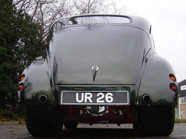

Exhaust: stock exhaust manifolds. Twin 2.5" pipes. Twin turbo mufflers.

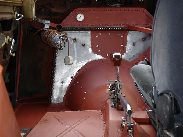

Transmission: Chrysler Torqueflite 727 automatic. Stock torque converter.

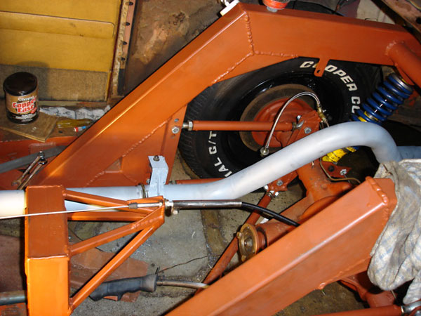

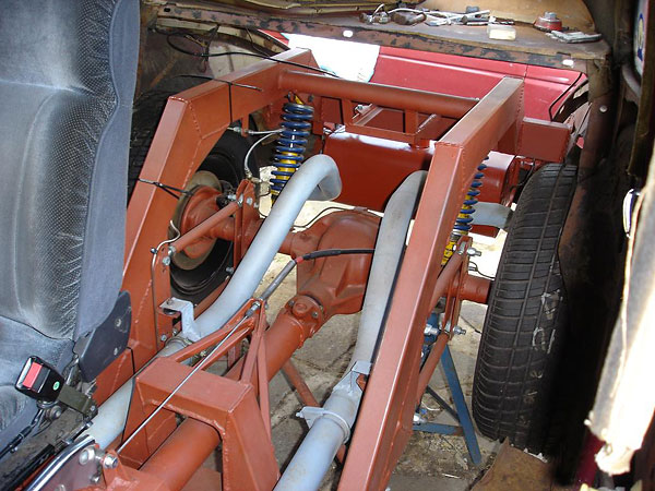

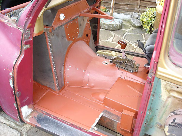

Chassis: original Jupiter chassis featured two 4" square tubes from front to back with a thin wooden floor. The car now has an 18-gauge steel floor and transmission tunnel with numerous square and round tubular additions for strength and engine/gearbox/suspension mounting.

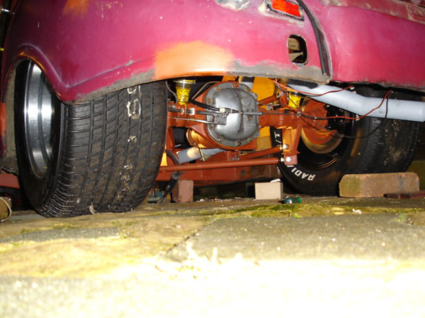

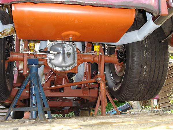

Rear End: narrowed Volvo rear axle. 3.7:1 final drive ratio. Locking differential.
Front Susp.: Ford Capri (2.8) modified with adjustable coil-over dampers. Ford Escort (MkII) rack and pinion.

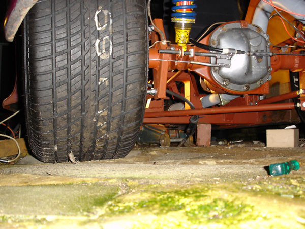

Rear Susp.: fully adjustable rose-jointed 4-link rear suspension, plus Panhard rod.

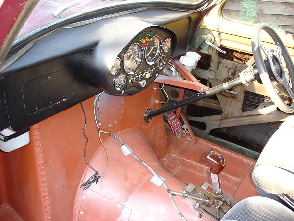

Interior: Triumph speedometer and tachometer. Ford oil, water temperature, ammeter and fuel gauges. Motolita steering wheel. No audio system. New door cards were made from 5mm plywood covered in foam and vinyl. New black headliner was handmade and fitted.

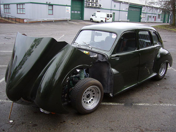

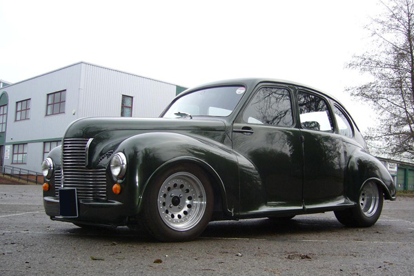

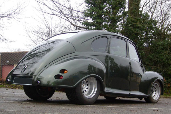

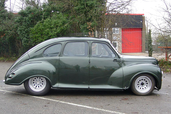

Exterior: wings (front fenders) were welded to the bonnet (hood) and made into a flip front. Chrome trim was removed. Rear lights were frenched.

The mighty Chrysler 318 V8.

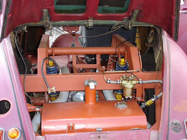

Rear Suspension
Fully adjustable rose-jointed 4-link rear suspension, plus Panhard rod.
Parking brake cable installation.
Adjustable coil-over dampers.
Carter fuel pump.
Carter fuel pump.
Narrowed Volvo rear axle. 3.7:1 final drive ratio. Locking differential.
Parking brake cable splitter/equalizer.
A Panhard rod keeps the rear suspension centered under the car.
Custom dashboard with Triumph speedometer and tachometer, plus Ford oil, water temperature,
ammeter and fuel level gauges.
Motolita steering wheel mounted on a custom fabricated steering column.

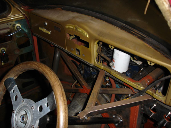

Test fitting the Jowett Javelin steel dashboard.
Shifter for the Chrysler Torqueflite 727 automatic transmission.
Custom fabricated firewall and transmission tunnel.
Suicide doors.
Suicide doors.
Custom fabricated flip front clip.
Frenched rear lights.
Most of the original chrome trim has been shaved.
