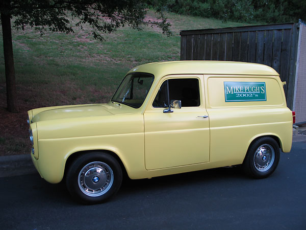

Mike Pugh's 1959 Ford Thames / Anglia Panel Truck with BMW 2002 Mechanicals
Mike Pugh's 1959 Ford Thames Panel Truck with BMW 2002 Mechanicals

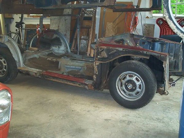

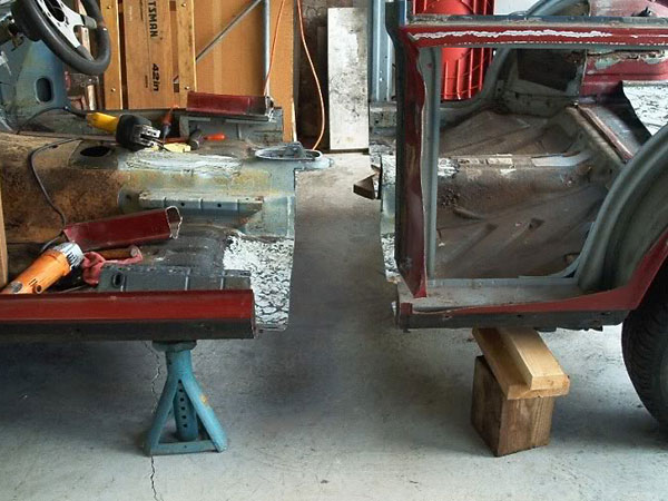

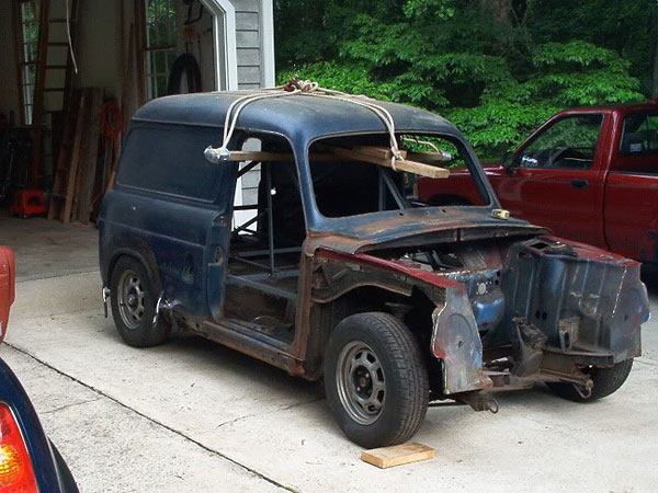

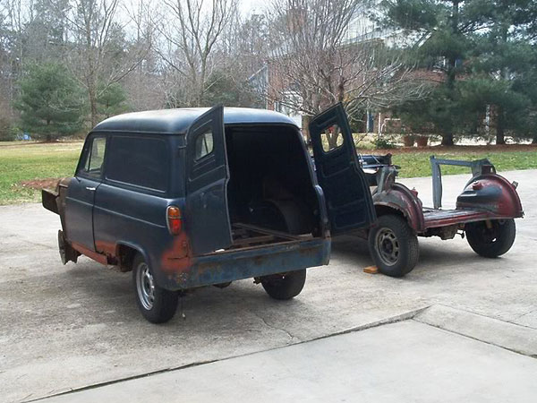

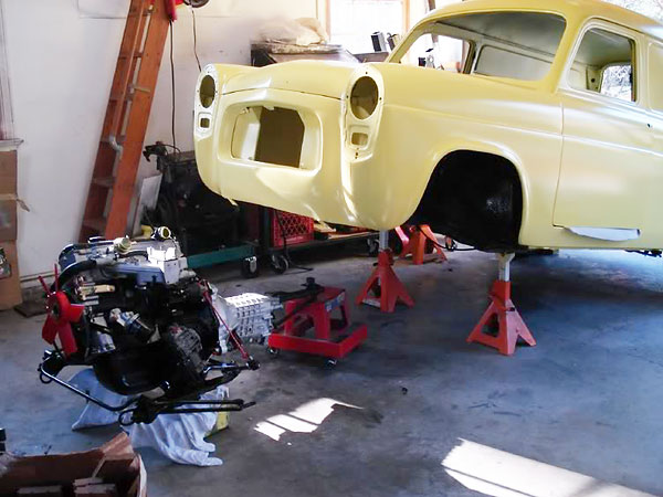

The first order of business was to remove the body of the 2002 while retaining the tub. Next on the agenda was to shorten the tub to accommodate the shorter wheelbase of the panel truck. This turned out to be almost exactly one foot. Now the fun could begin. I brought the panel truck up from the barn, removed all of the suspension and doors and began to brace the body internally so that I did not lose the shape as I was getting ready to remove the entire bottom of the unibody, leaving just the sides and the roof. I suspended the body with a hoist from the ceiling of my garage and began to carefully cut away the floor and firewall. Did I mention the little truck was rusty? After much trimming and planning, I was finally ready to make the critical cuts needed so that the two halves could be brought together. On my birthday in April of 2005, my Dad came down to have a look see. He gave me the thumbs-up on what I was about to do. In short order, the cuts were made and the two cars went together, albeit with a lot of work yet to do.
Two project cars?
Two project cars?
The next 8 months were spent grafting the concoction together and completing countless small jobs. I mounted the panel truck front end, replaced the bottom of one of the truck's doors, modified a BMW fuel pickup/sender to fit the panel truck gas tank, etc., etc. etc. Shortening the driveshaft was easy for the machine shop. I found out that you can't buy an exhaust system for a BMW powered English Ford... so I made one by cutting apart an ANSA system and welding it up to fit. The rear inner wheel arches are from a 2002. A small Mazda Miata battery solved one problem; a wiring harness from a BMW solved another. The dashboard from a 2002 was used as were the gauges and center console.

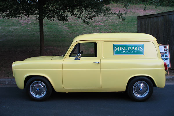

Finally, after 5 pounds of MIG wire and two bottles of welding gas, plus a half gallon of Bondo, the body work was nearing completion. I had to make a decision on what color to paint the truck. After much consideration, I opted for New VW Beetle yellow but with a flattening agent added for a sort of 'rat rod' look. My wife Eileen came up with the idea of putting a smiley face on the rear door. All of the running gear and suspension has been renewed and is pretty much stock except for the Weber carburetor and sport springs. Actually, it is very fitting that the motor is from that very first 2002 of mine.

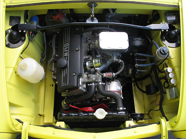

The completed engine installation.

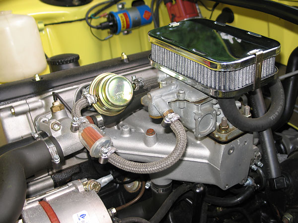

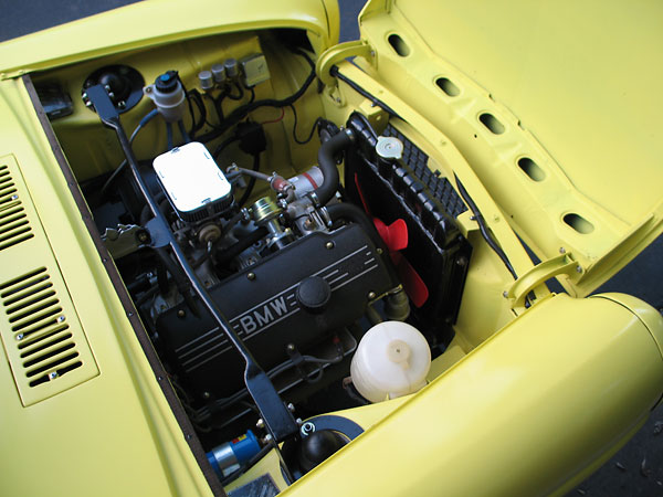

Engine: BMW 2-liter four cylinder engine. Weber 32/26 DGEV carburetor. K&N air filter. Overhead camshaft. Solid lifters. BMW 2002Tii distributor (mechanical advance). Bosch Blue coil.

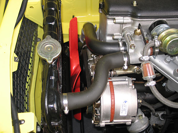

Cooling: re-cored BMW 2002 radiator. BMW 2002 engine driven cooling fan.
Exhaust: BMW 2002Tii exhaust manifold. ANSA aftermarket exhaust system for a 2002, cut down in length to fit.

BMW 2002 tub, cut in half.
Twelve inches removed, and then welded back together.

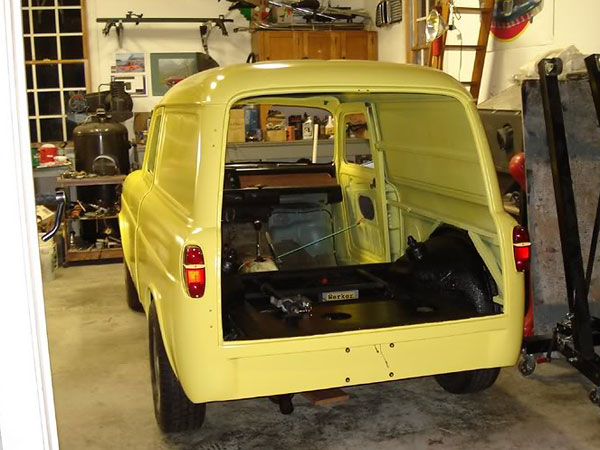

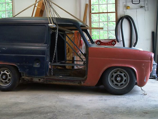

Setting the Thames panel van body on the modified BMW 2002 chassis.
Now the body is clamped in place, and the project can be rolled around.

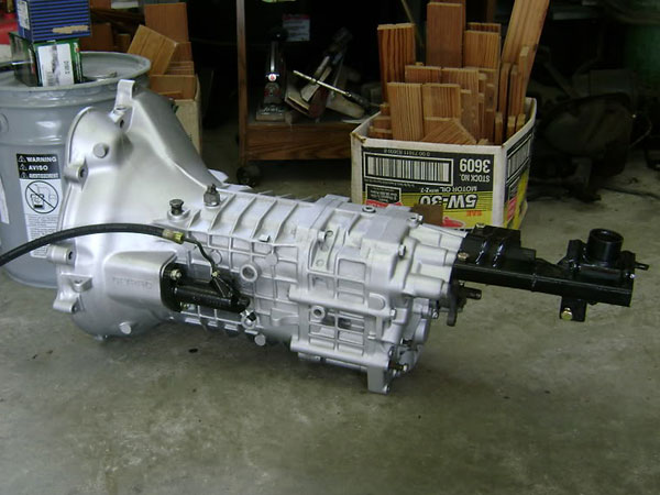

BMW 320i 5-speed with overdrive.

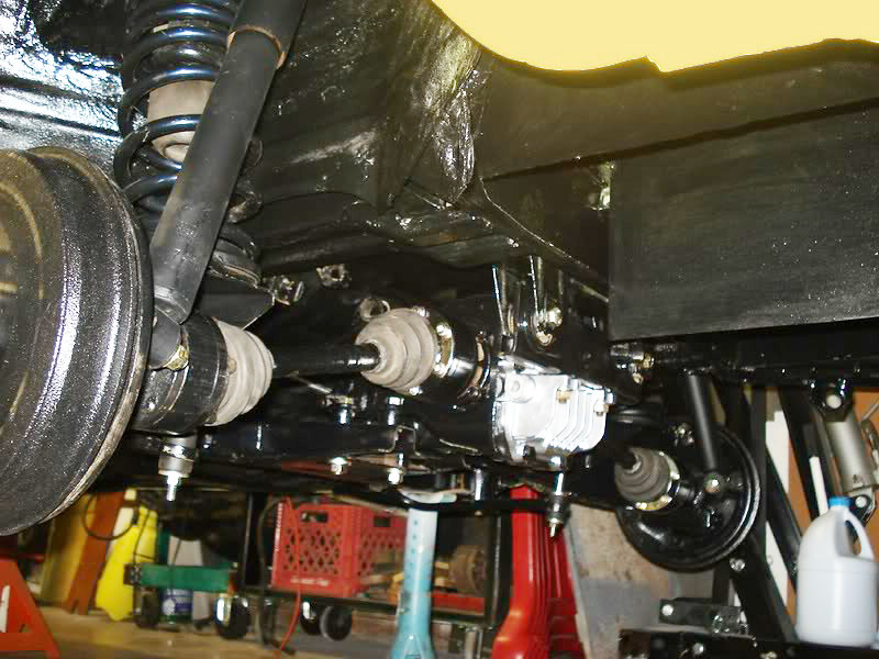

BMW 2002 independent rear suspension.

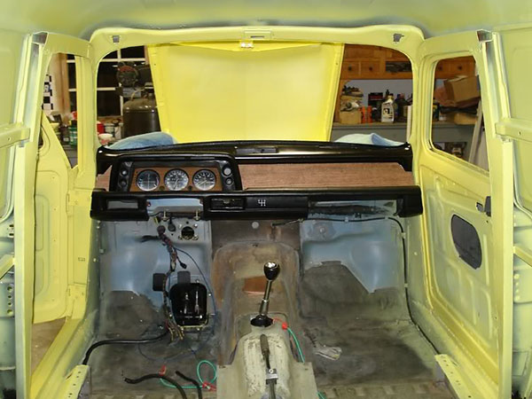

Trial fitting the BMW 2002 dashboard.
Battery hidden under cargo floor. (Werker is a private label brand from Batteries Plus stores.)
Battery hidden under cargo floor. ("Werker" is a private label brand from Batteries Plus stores.)

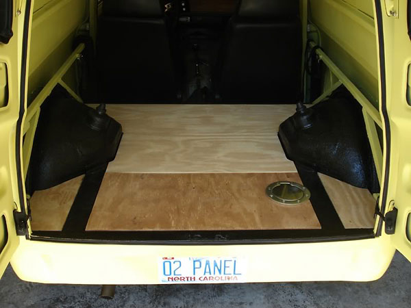

Plywood cargo floor. Note flush fuel filler, which will be hidden under carpet.

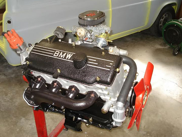

BMW 2002 1990cc, SOHC, 2 valve/cylinder four cylinder engine.

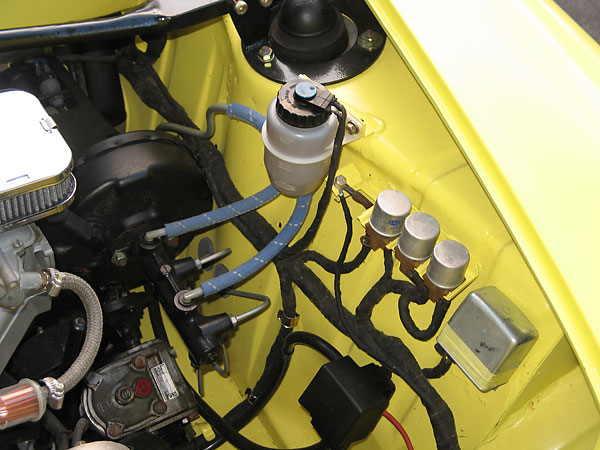

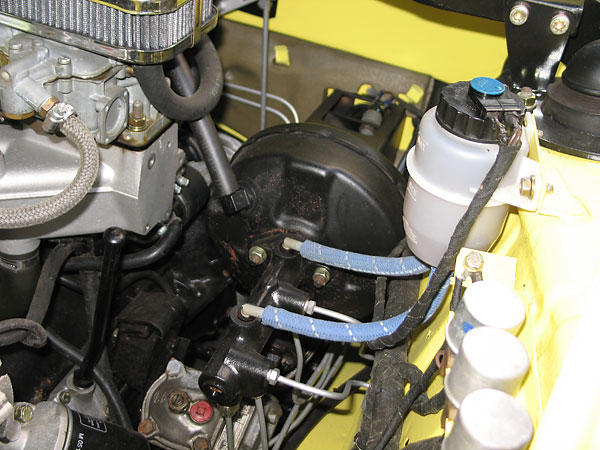

Power brake master cylinder.
Pierburg mechanical fuel pump.

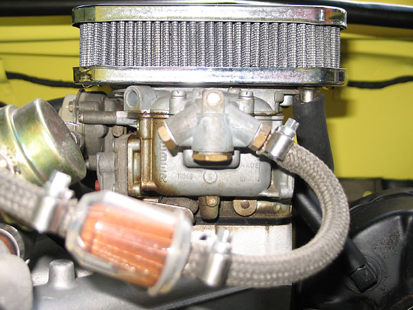

Weber 32/26 DGEV carburetor mounted to a stock BMW 2002 intake manifold.

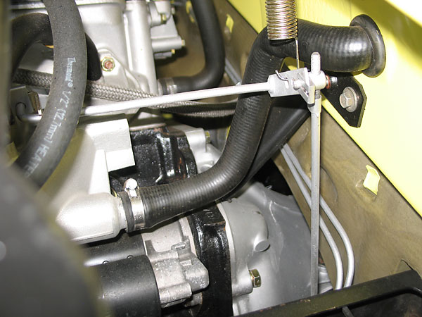

Throttle linkage.
Throttle linkage.

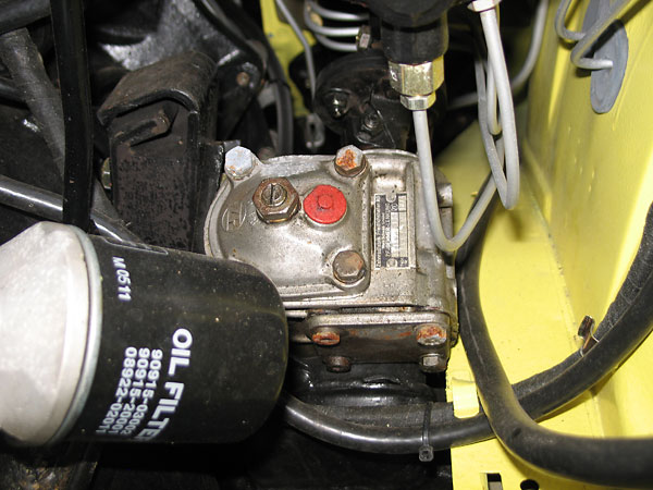

ZF steering gear.
ZF steering gear.

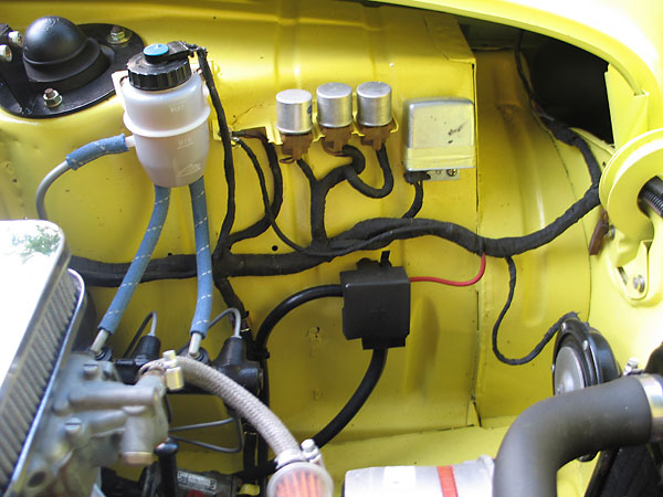

Brake fluid reservoir and various electrical relays.
Bosch alternator, remanufactured by Precision Parts (labeled BOA 089 and JQA6018701)
Bosch alternator, remanufactured by Precision Parts (labeled "BOA 089" and "JQA6018701")

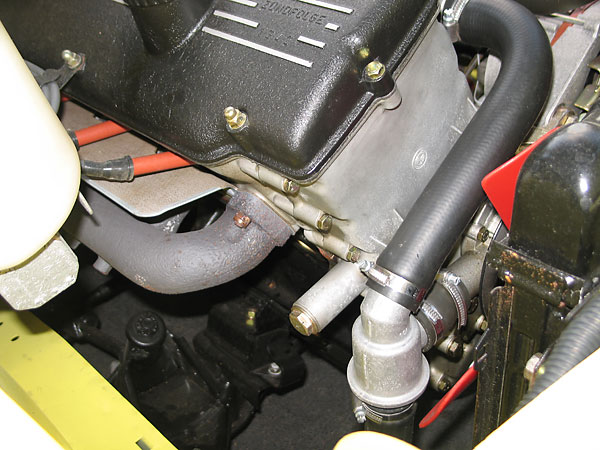

Motor mount, and plumbing details.

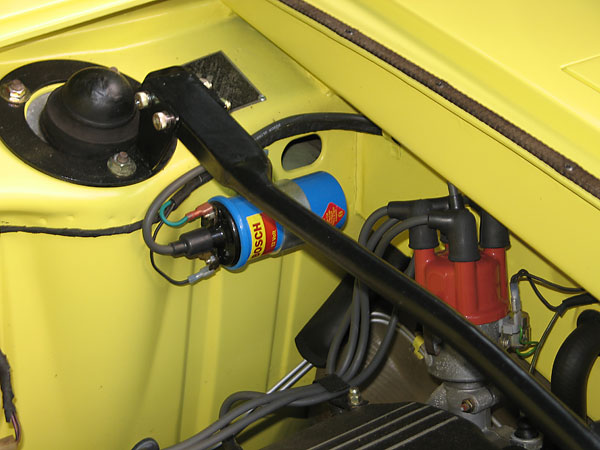

Bosch blue coil.
Bosch "blue" coil.

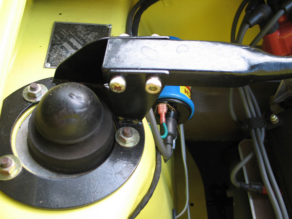

Monte Carlo bar.
Monte Carlo bar.

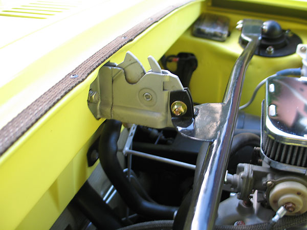

Hood latch.
Hood latch.

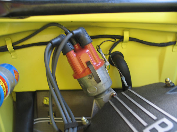

Distributor.
Distributor.

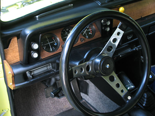

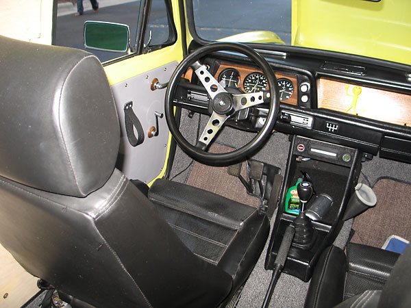

Interior overview.
Interior overview.

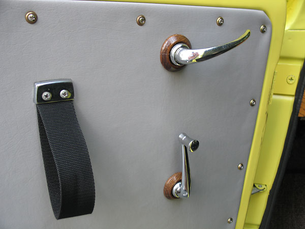

Custom door panel.
Custom door panel.

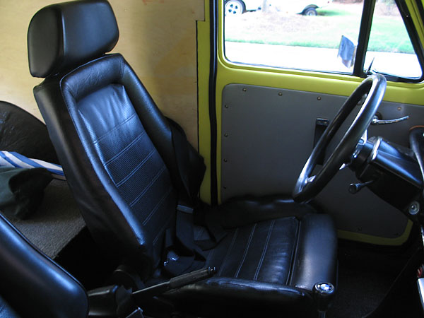

Recaro seats from a later model BMW 320i.
BMW steering wheel.
BMW steering wheel.

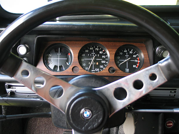

BMW 2002 steering wheel and instrument cluster. Speedo reads to 120mph. Tach reads to 8000rpm.
BMW 2002 instrument cluster. Speedo reads to 120mph. Tach reads to 8000rpm.

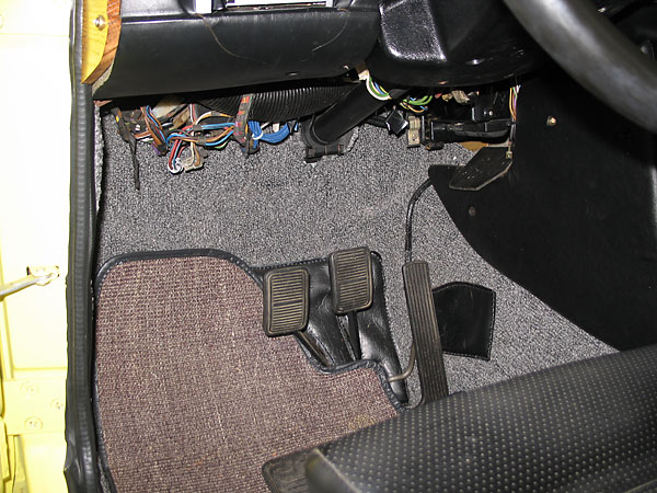

Carpet from Chris Willet at Only O2.
Carpet from Chris Willet at "Only O2".

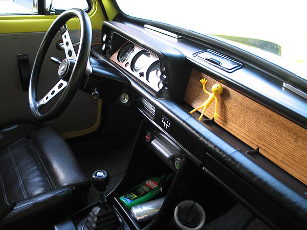

BMW 2002 dashboard.
BMW 2002 dashboard.

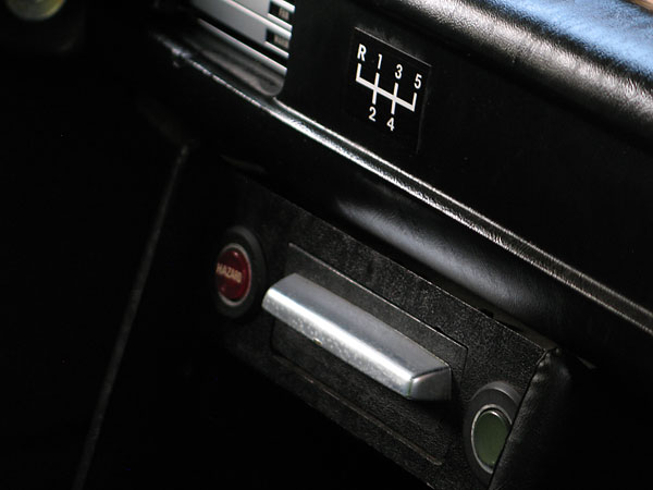

BMW 2002 center console.

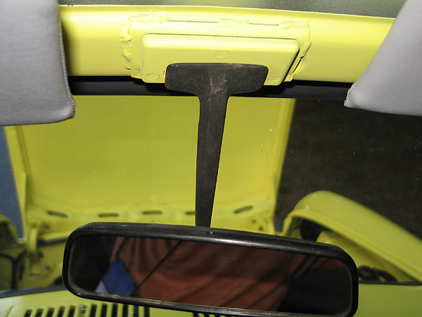

BMW 2002 rear view mirror.

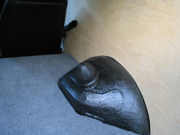

BMW 2002 inner wheel well.

Mike Pugh's 2002's
Mike Pugh's 2002's

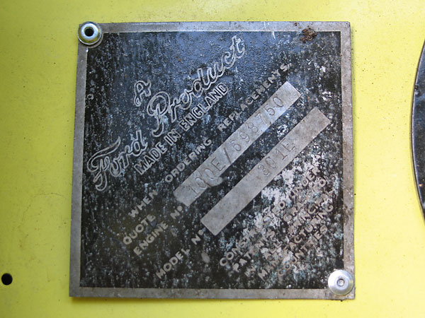

Ford engine 100E / model 301E
A Ford Product - Made in England
When ordering replacements, quote Engine No. "100E/698750", Moder No. "301E"
Constructed under patents granted in all principle manufacturing countries.

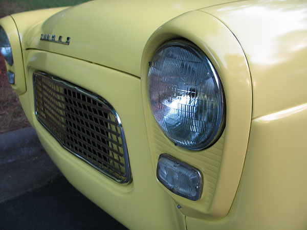

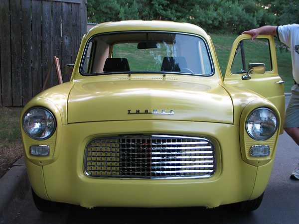

Ford Thames grille.
Ford Thames grille.

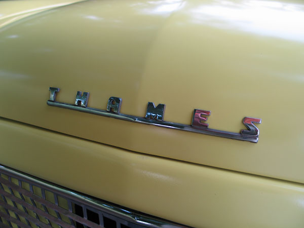

Ford Thames hood badge.
Ford Thames headlight trim.

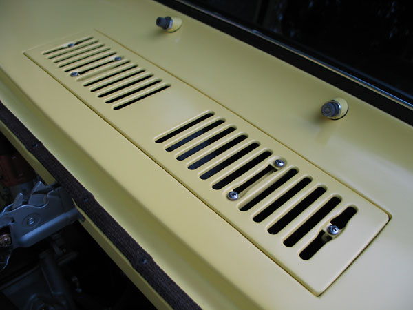

Ford Thames cowl vent.

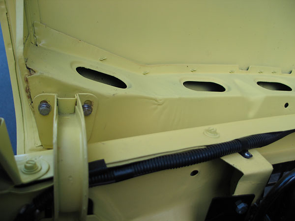

Ford Thames hood hinge detail.

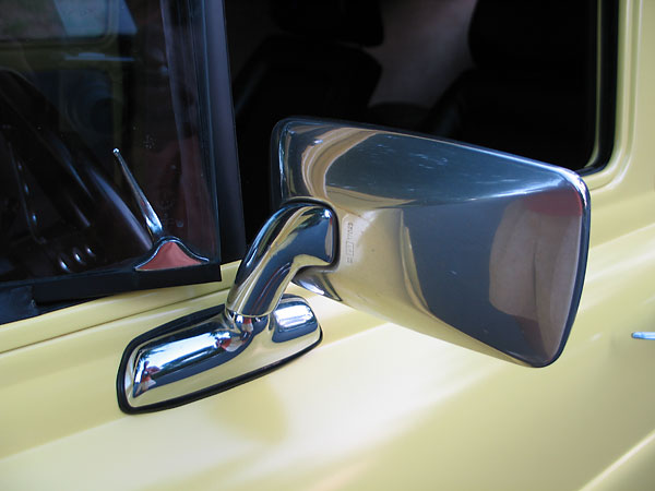

BMW 2002 side view mirror.

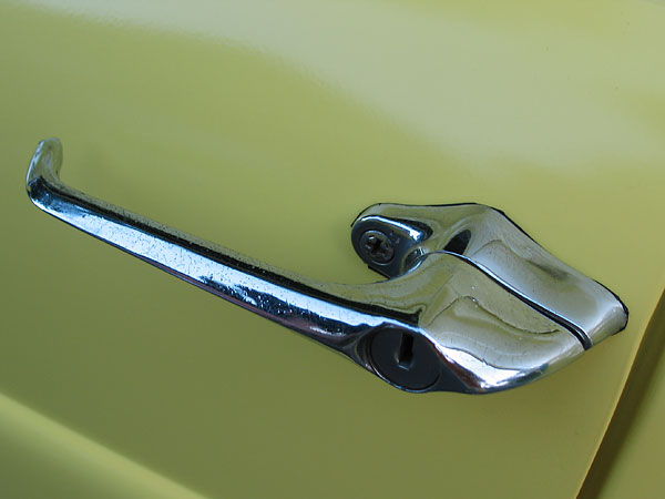

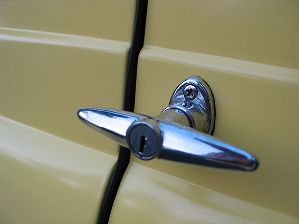

Ford Thames door handle.

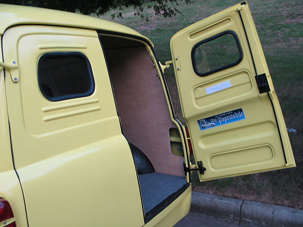

The bumper sticker reads: My other car is the Popemobile
The bumper sticker reads: "My other car is the Popemobile"

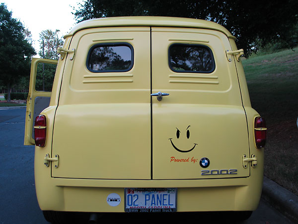

Powered by BMW 2002.

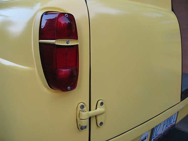

Ford Thames panel van rear door handle.
Ford Thames taillight.

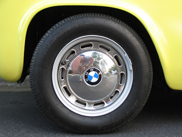

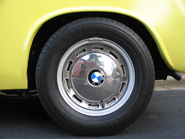

BMW 2002 Tii steel disc wheels.
185/70R13 tires.
185/70R13 tires.
