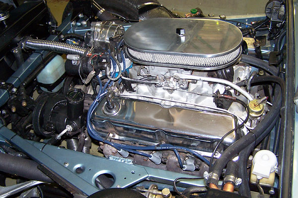

Engine: Ford 351 Windsor V8 engine. Ford aluminum two barrel intake manifold with Holley carburetor. Ford Duraspark II breakerless (magnetically triggerred). 100 amp 1-wire Delco-style alternator.

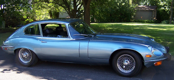

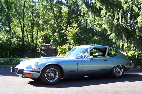

Comments: I purchased this Jaguar in July 2009, from a gentleman who purchased it in 1985/86. In 1987 he removed the V12 and replaced with a Ford 351 Windsor V8 along with a Ford C4 automatic transmission. In 2002 he had body and paint redone. He had a new short block installed in the fall of 2008.
I've always wanted an E-Type. The fact that this one already had a Ford V8 made it even more desirable to me. I would have hated to have been the one to pull out the V12 drivetrain, but now that it's been done I'm free to do whatever I want to this car. The engine conversion was basically sound. However, when I got the car the front suspension was simply terrible. Brakes had all of the typical Jaguar problems. The electrical wiring was quite "unique"; it had a nasty habit of completely stopping the engine at the worst possible times. The more I work on this car, the more sorted it is. Almost all systems now work as they should.
I have only put about 1500 miles on this car as of July 2010 (most of it in the last 2 months) so as of now it is simply a matter of getting acquainted, with cars good and bad points. This car is a work in process and I have no idea where it is going to go (although 400+ HP and a 5 speed sound pretty good). I'm sure that I'll spend much more money than it's worth. I often wonder why we do this, but I guess that it all comes down to one thing: it sure is FUN!
Ford Duraspark II breakerless (magnetically triggered). 100 amp 1-wire Delco-style alternator.

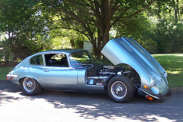

In 1987 the previous owner had swapped the original V12 for a Ford 351 Windsor V8.
Merv purchased his Jaguar E-Type in July 2009, from a gentleman who purchased it in 1985/86.
