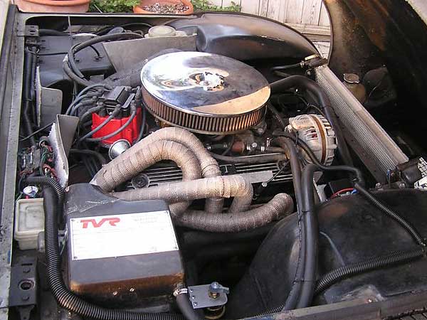

Engine: Chevrolet 350 cubic inch V8 (1969). Edelbrock intake manifold. Holley 650 carburetor. Mustang II/302 air filter (Fram C3371, it's just 1.75" tall.) Delco HEI ignition system.
Cooling: Chrysler aluminum rad
Exhaust: custom, with dual pipes and mufflers.

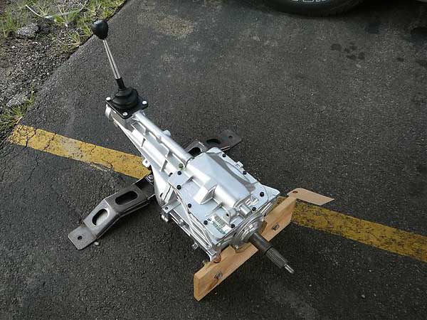

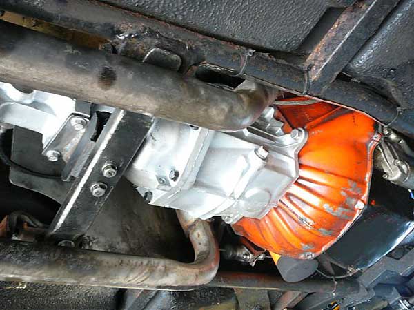

Transmission: Borg-Warner T5 5-speed, with 0.63:1 fifth gear. Hydraulically actuated clutch (with TR6 slave cylinder.)

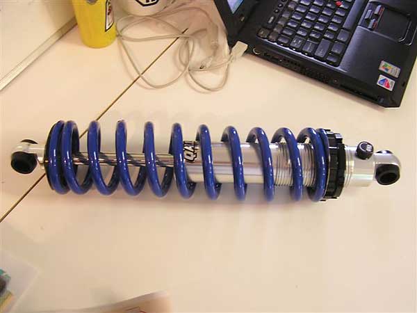

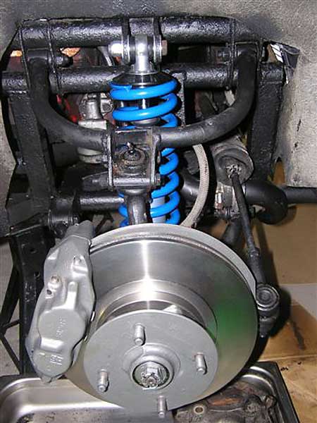

Front Susp.: QA1 coil-over shock absorbers with 400# springs. I've been experimenting with Spax gas shocks, which work nice, but I'm going to go back to the QA1s because they provide adjustable ride height (and corner weights). I'll lower the front about 1".

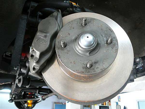

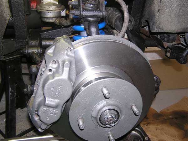

Brakes: Stainless steel braided hoses. On the front, 1988 Toyota "4Runner" 4-pot calipers (C8554/C8555) and 1988 Toyota "Cressida" vented rotors (BD 61804). On the rear, stock TR6 drums.

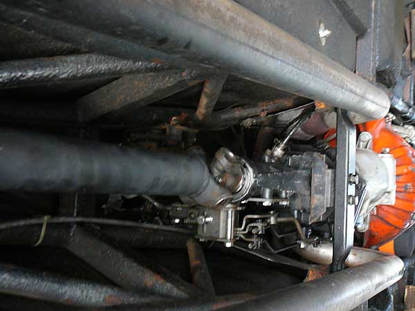

Borg-Warner T10 4-speed
When Martyn purchased the car it had a Borg-Warner T10 4-speed.
external shifter linkage
T10 4-speed transmission's lack an overdrive gear, and the external shifter linkage feels sloppy.
Martyn upgraded substantially by swapping in a rebuilt Borg-Warner T5 5-speed.
Borg-Warner T5 5-speeds have an integral shifter mechanism
The T5 provides a 0.63:1 overdrive gear, yet only weighes about 75 pounds due to its all-aluminum case.
TVR 2500 front suspension and brakes
QA1 coil-over shocks

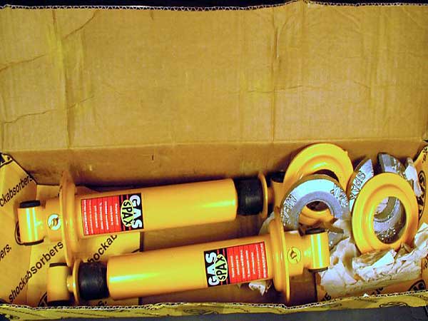

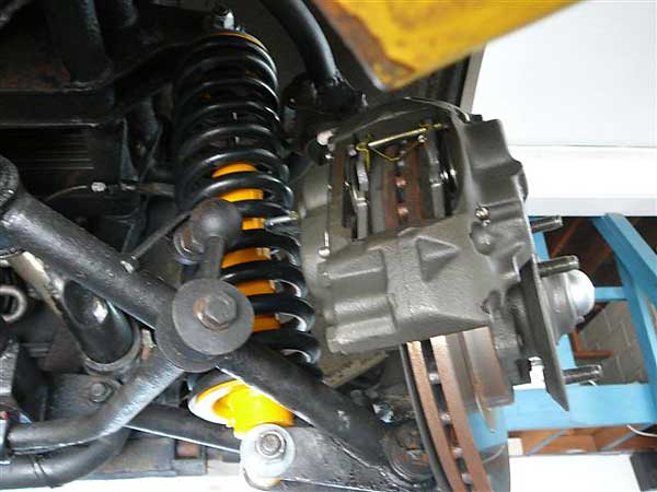

GAS SPAX shocks
Martyn fitted new SPAX gas coil-over shock absorbers in lieu of the QA1 shocks that came with the car.

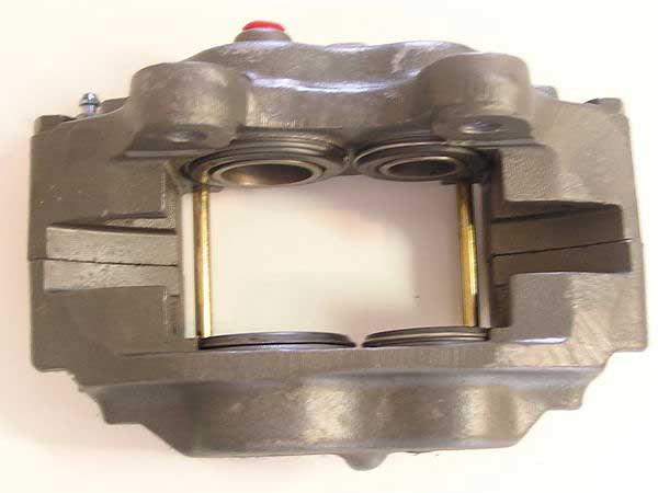

Toyota front brake calipers
Martyn fitted Toyota 4Runner brake calipers and Toyota Cressida rotors in lieu of the original Triumph system.
great big new vented rotors
SPAX coilover shocks
Toyota 4Runner four-piston brake caliper.
1988 Toyota 4Runner four-piston brake calipers (C8554/C8555).

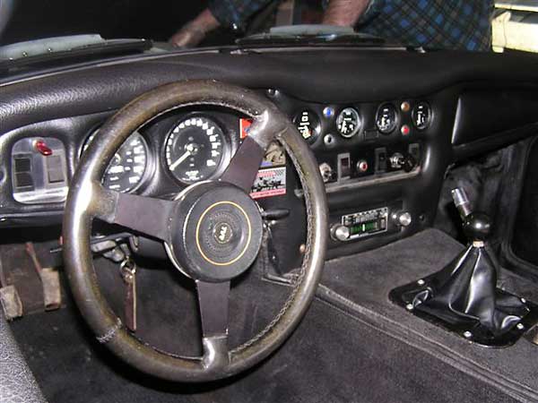

basically stock TVR 2500 interior
