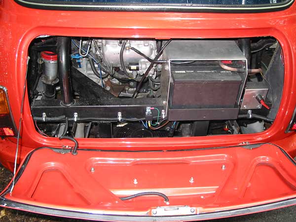

Engine: Acura Integra Type-R VTEC 1.8L
Conversion performed by: Peter Zorge of New Smyrna Beach FL
Intake: stock.
Cam: stock.
Engine Electrical: stock, except Delco alternator (serpentine belt).

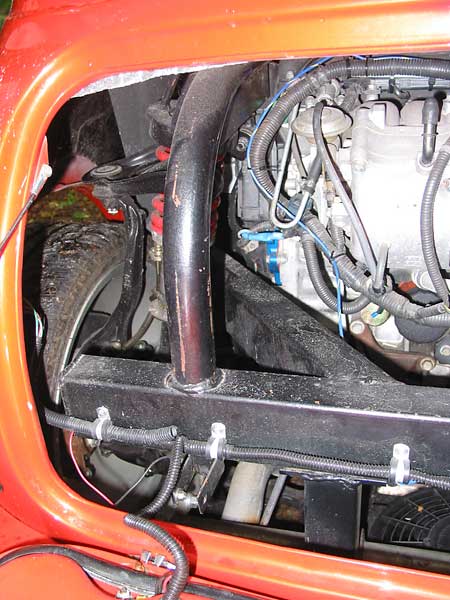

Cooling: Griffin custom aluminum radiator, and 55gpm water pump.
Exhaust: custom fabricated.

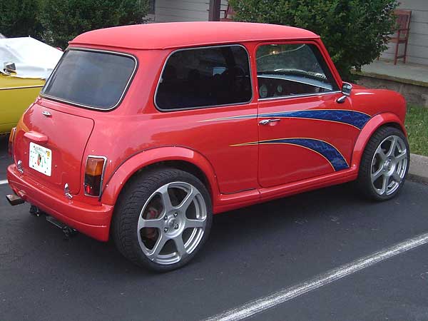

Curb weight: about 1500lbs.

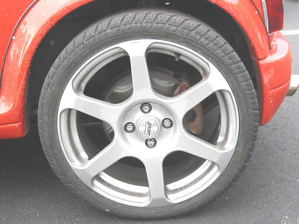

Wheels/Tires: 17" (from Tire Rack).

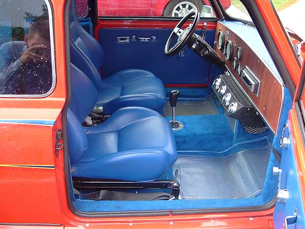

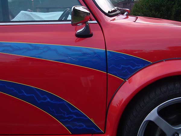

Other: whole frame was custom fabricated... Autometer gauges. Air conditioning.
Custom interior. Custom paint. See pictures!
Performance: 195hp, 130+ mph.
Completed: January 2006.

Austin Mini fuel cell
Austin Mini with Acura Integra Type-R motor
Austin Mini with Acura Integra Type-R VTEC engine
