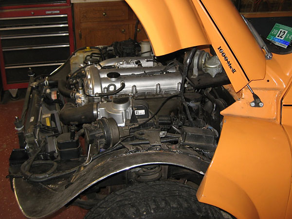

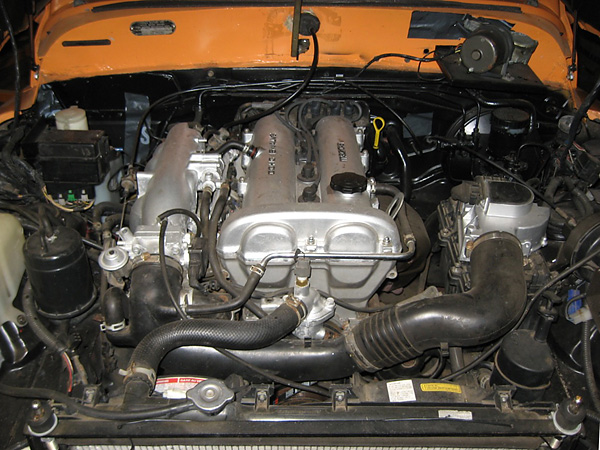

Engine: stock Mazda Miata 1.6L DOHC fuel-injected four cylinder (~186,000 miles).
Cooling: stock Mazda Miata.
Exhaust: stock Mazda Miata, modified from rear axle out to fit shortened rear end.

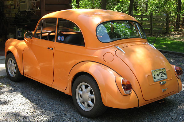

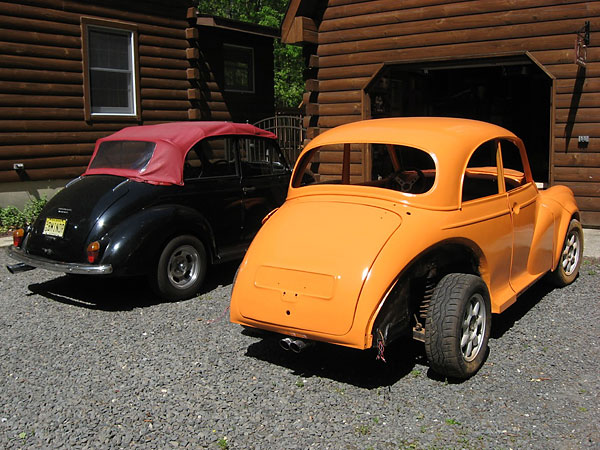

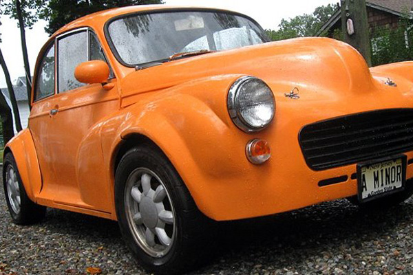

Body: Bumpers removed. Front end welded into one piece unit. Mazda Miata side view mirrors. All original glass. Miata fuel filler lid. 1974 Volkswagen Beetle taillights. Rayflex "Omaha Orange" with a little white added.

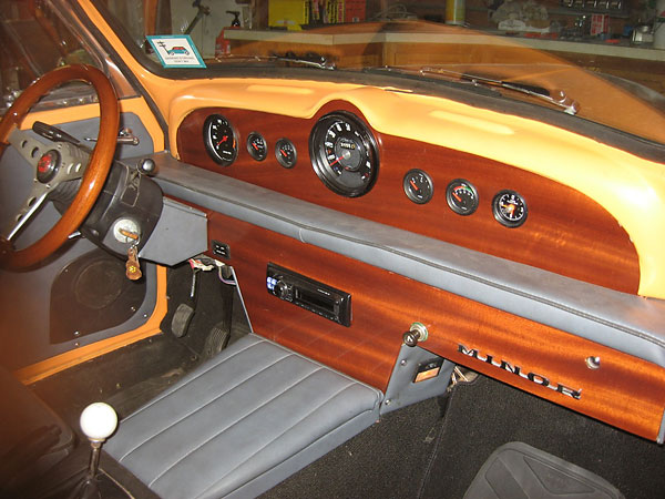

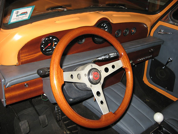

Interior: custom mahogany dashboard. Morris Minor speedometer. MGB tachometer. VDO small gauges. Grant GT steering wheel (with Morris horn button). MGB pedal pads. MGB windshield wipers. Modified Mazda Miata center console. Junkyard seats reuphostered and fitted to Miata rails.

In the end, I basically have a re-bodied Miata. I trimmed about 400 pounds of fat from stock. She's fast, but not V8 fast and handles like a dream. No one has any idea what she is, so she always gets a second look.
Stock 1992 Mazda 1.6L DOHC fuel-injected four cylinder engine.
Original Morris Minor speedometer mated to a Miata cable.
"I found a shop that was able to mate an original Minor speedometer to a Miata cable.
Other gauges were purchased on eBay, including a matching analog clock. It keeps
perfect time and has that period look." MGB tachometer. Grant GT steering wheel.
Clear lacquer, wet-sanded.
"The dashboard mahogany was shot with clear lacquer and wet-sanded between coats."

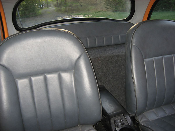

Junkyard seats.
"I already had the seats, I just needed to weld Miata runners to them.
It was tough to squeeze them in because the Miata tunnel is wider."

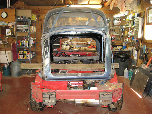

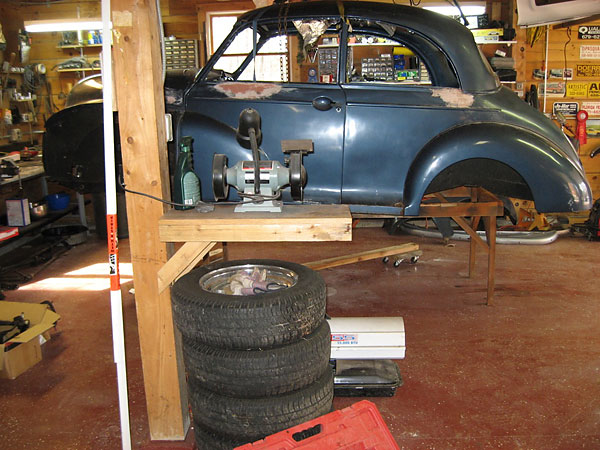

I gutted the Morris Minor until there was nothing but body left.
"I gutted the Morris Minor until there was nothing but body left.
I removed the dashboard, but left the dash cap in place."

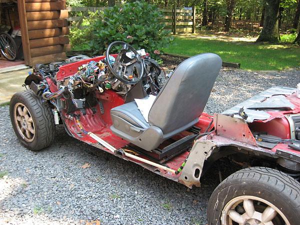

I cut away anything that wouldn't fit under the Morris Minor shell.
"On the Miata, I basically cut away anything that wouldn't fit under the Minor shell.
I bought a small brake and used it to fabricate body mounting brackets. Installing
those brackets gave me much-needed welding practice early in the project."
I removed the air bags, wiring and sensors.
"I removed the air bags, wiring and sensors - that got rid an awful lot of wiring.
The rest of the Miata wiring I left intact, as most of it would be used anyway.
The Miata HVAC unit projected far into the Minor interior. I decided to figure out
heat and defroster later - and that I didn't really need air conditioning."

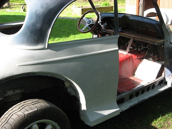

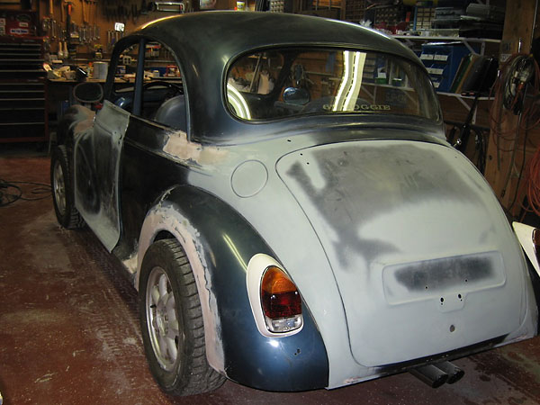

Since the Mazda Miata is longer and wider than the Morris Minor...
"Since the Miata is longer and wider than the Minor, I opted to line up the front tire in the
original spot and re-arch the rear fenders. That way, I wouldn't have to do anything to the
front body of the Minor."

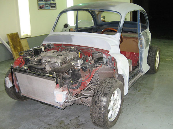

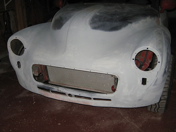

Fenders, hood, and front welded together to make a one piece front clip.
"I welded the fenders, hood, and front together to make a one piece unit.
It mounts on original Morris Minor hinges."
The tires got in the way!
"The one piece front clip came about because there wasn't much structure on the Miata chassis
to hinge from. An, because the Miata is so much wider, I wasn't able to open the hood. The
tires got in the way! That's when I realized if I cut away the rear of the fenders, and
attached them to the body it would work."

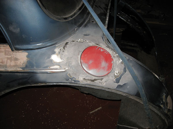

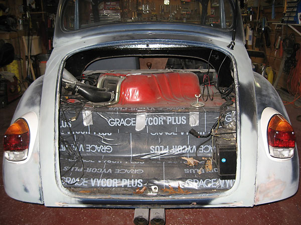

Mazda Miata recessed fuel filler cap.
Generic fiberglass flares.
"A set of generic fiberglass fender flares took care of the tires sticking
out from the body and gave a much wider stance."
1974 Volkswagen Beetle taillights with built-in back-up lamps.
Dashboard sub-structure.
Mazda Miata cooling system and front suspension.

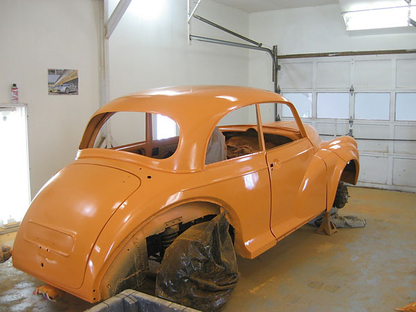

Rayflex Omaha Orange
"Rayflex 'Omaha Orange' paint with some white added to make it a bit lighter.
It's two stage paint, and I shot it in my back garage with an HVLP gun."
