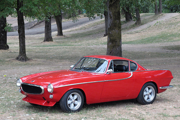

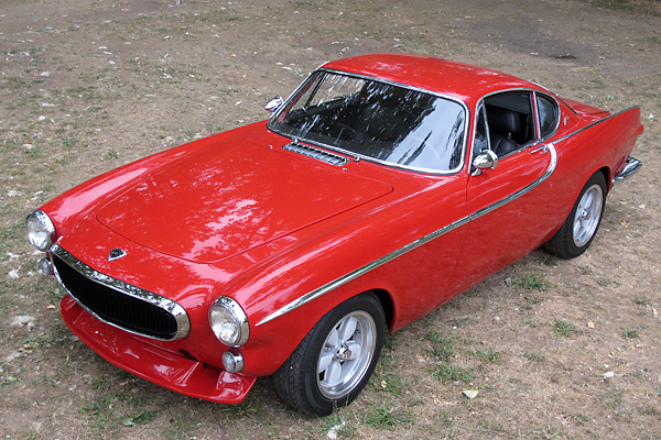

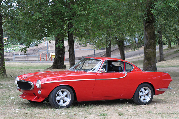

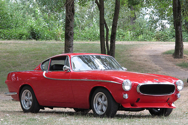

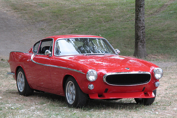

Larry Rembold's Volvo P1800 with Ford 289 V8
Larry Rembold's 1962 Volvo P1800 with Ford 289 V8
Owner: Larry Rembold
BritishV8 UserID: ldrembold
City: Gresham, Oregon
Model: 1962 Volvo P1800
Engine: 1966 Ford 289 V8
Conversion by: see below

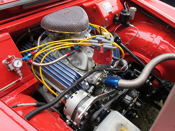

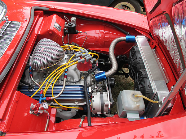

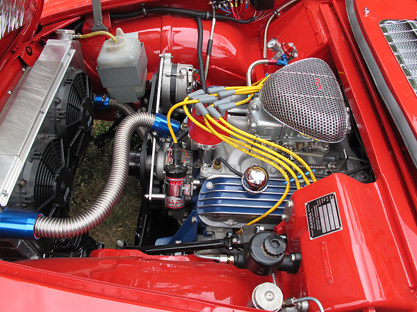

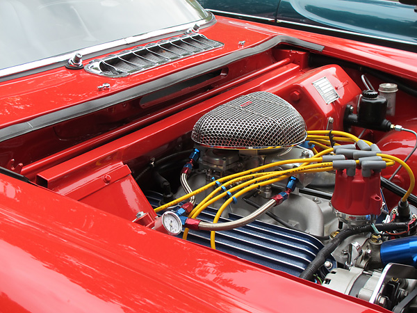

Engine: 1966 Ford 289 V8 from a Mustang. Professional Products "Typhoon" intake manifold. Barry Grant "Speed Demon" 575cfm four barrel carburetor. Mallory Comp 70 electric fuel pump. Aeromotive 5-12psi adjustable fuel pressure regulator and 0-15psi gauge. Edelbrock foam air cleaner. MSD Pro Billet E-curve electronic distributor. MSD 8222 Blaster High Vibration ignition coil. Accel Hi-Temp Super Stock 8mm spark plug wires. Finned cast aluminum valve covers.

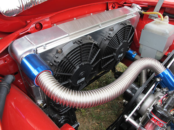

Cooling: Griffin aluminum radiator. Dual Spal electric cooling fans. Aluminum fan shroud. Earl's Form-A-Flex stainless steel upper hose (24", part# 121242ERL) with two reducers (part# 122104ERL). Earl's Form-A-Flex stainless steel lower hose (24", part# 121242ERL) cut To 21".

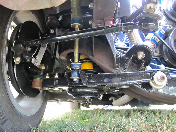

Front Susp.: IPD polyurethane A-arm bushings. IPD coil springs (1.5" lower and 20 percent stiffer than stock). Bilstein shock absorbers. IPD 1" sway bar with polyurethane bushings.

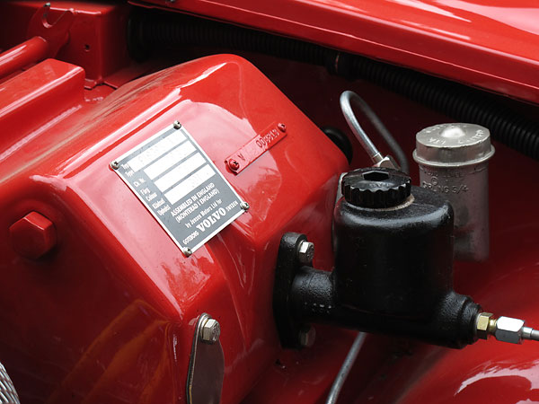

Brakes: (master) original FAG single circuit master cylinder. Russell DOT-5 silicone brake fluid.

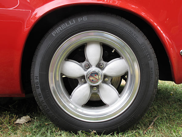

Wheels/Tires: American Racing "Coke Bottle" 15x7 wheels. Pirelli P6 195/60R15 tires.

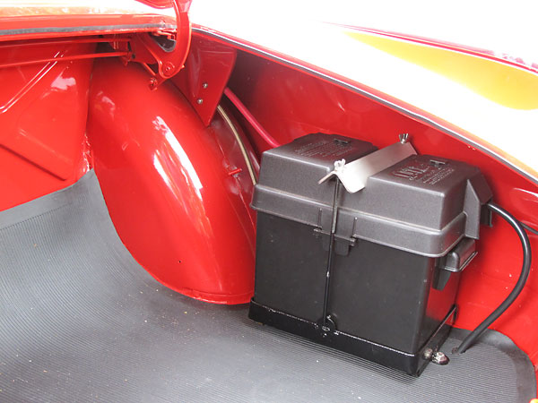

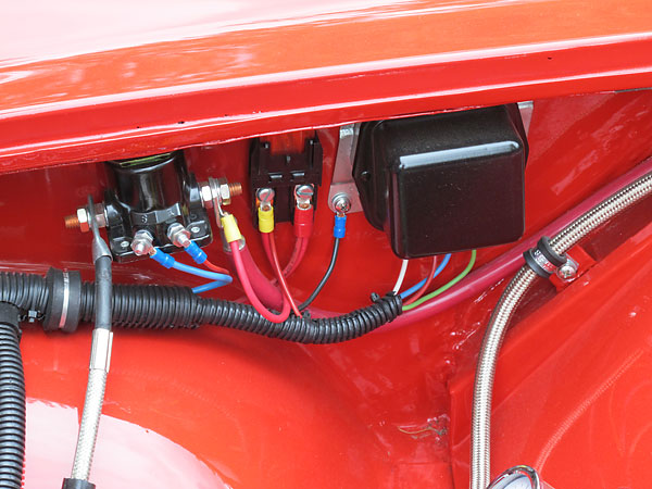

Electrical: Odyssey dry cell, deep cycle, top post battery (530cca, part# PC1200MJT). Battery relocated to a marine battery box, mounted in trunk. Ford remote starter solenoid. Painless 14-circuit microfuse wire harness (part# 10130).

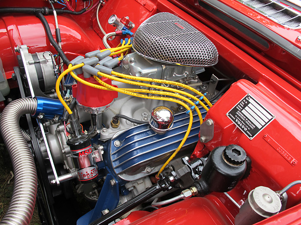

289 cubic inch V8 engine from a 1966 Ford Mustang.

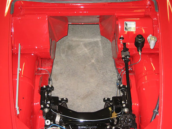

Engine is entirely behind front crossmember for better weight distribution.
Balance: the V8 engine has been situated entirely behind the Volvo's front
suspension crossmember to achieve an excellent distribution of weight.

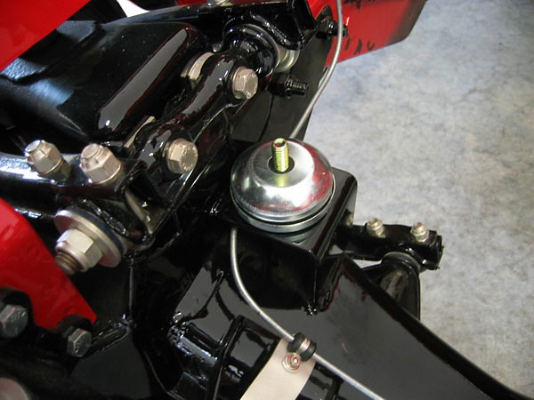

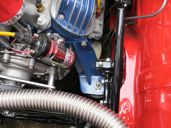

Cylinder head located engine mounts. Lefthand: 3765. Righthand: 3766.
Cylinder head engine mounts. Manufacturer unknown. Left stamped "3765". Right stamped "3766".

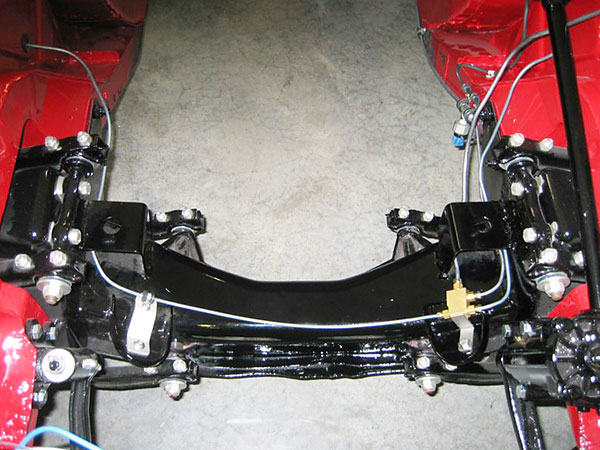

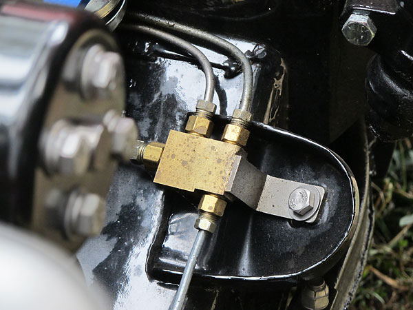

Custom brake line junction block.

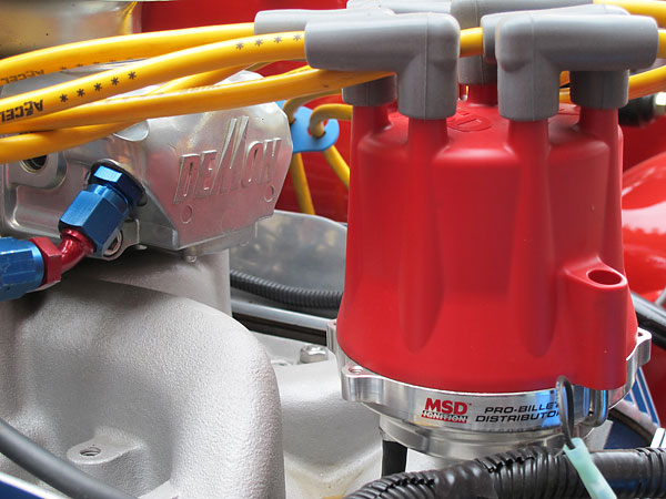

MSD Pro Billet E-curve electronic distributor. Larry says: "The E-curve distributor
is easy to tune and works great!" MSD Blaster High Vibration ignition coil.
Griffin radiator mounted in U-brackets over the frame rails.
Griffin aluminum radiator mounted in U-brackets over the frame rails.
An 18ga stainless bracket secures the top.
Professional Products Typhoon intake manifold.
Barry Grant Speed Demon 575cfm four barrel carburetor.
Earl's Form-A-Flex stainless steel hoses, with aluminum ends.

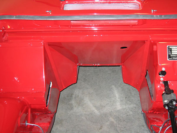

Steel box tubing has been added to reinforce the firewall.
Painless Wiring harness. Ford starter solenoid.

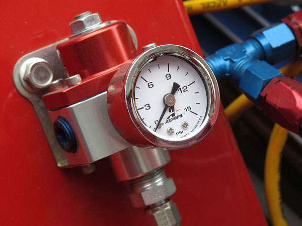

Aeromotive fuel pressure regulator set at about 5psi.

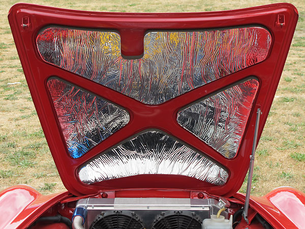

Hood Quiet Kit from IPD in Portland Oregon is about 1 inch thick and has a peel and stick backing.
Hood Quiet Kit from IPD in Portland Oregon is about 1" thick and has a peel and stick backing.

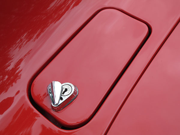

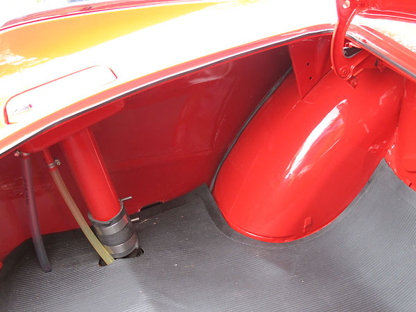

Fuel filler tube.
Fuel filler tube.

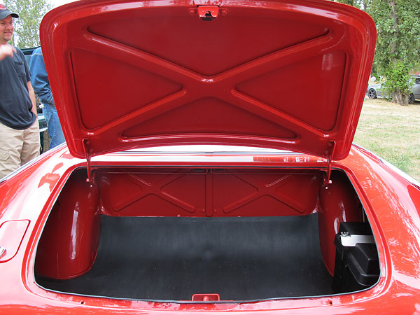

Odyssey battery, located in the trunk.

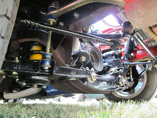

Suspension and Brakes
IPD front suspension with Bilstein shock absorbers and urethane bushings.
Original mounting brackets for the four cylinder engine may be seen.

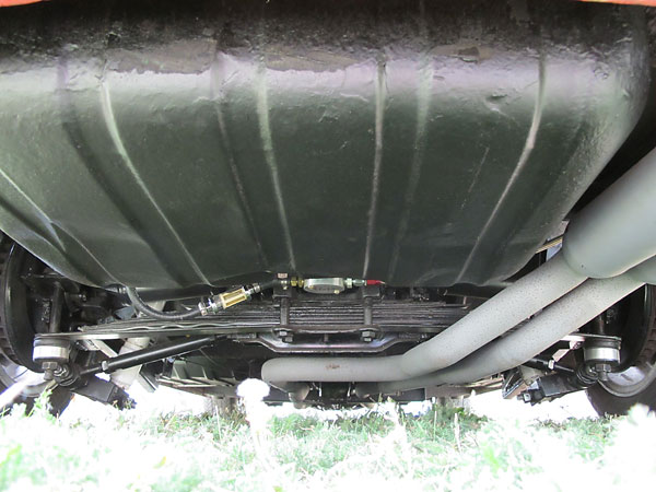

Original 12 gallon fuel tank is a little small for the V8 engine.

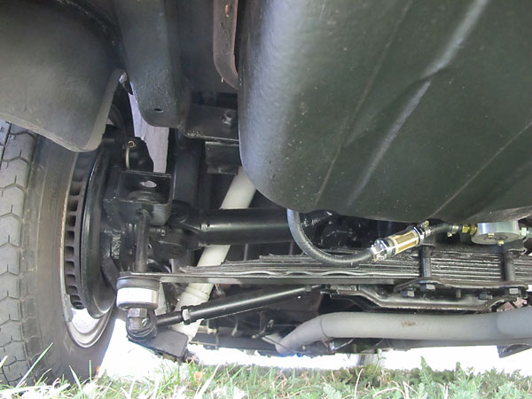

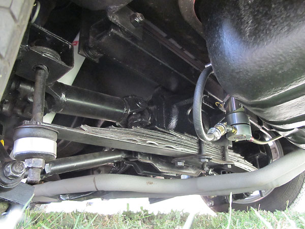

Corvette rear end. Mallory fuel pump.

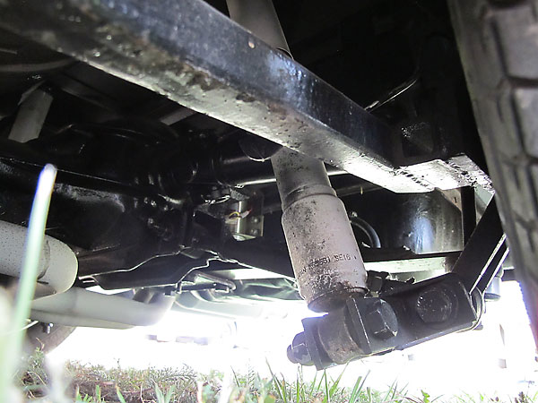

Modified brackets to fit Chrysler Conquest / Mitsubishi Starion shock absorbers.
Very long shock absorbers.
Original upper shock mounts (above differential, under rear package shelf) are used.

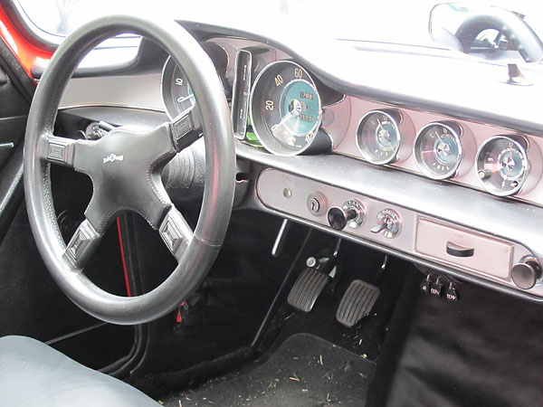

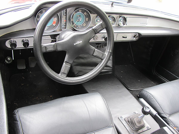

Stock dashboard. Italvolanti steering wheel.
Seats are original from a 1971 1800E, but narrowed 2 inches and reupholstered.

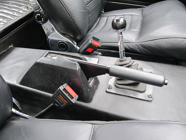

Handbrake assembly from an old Mercedes, shortened. Ford shifter, shortened.

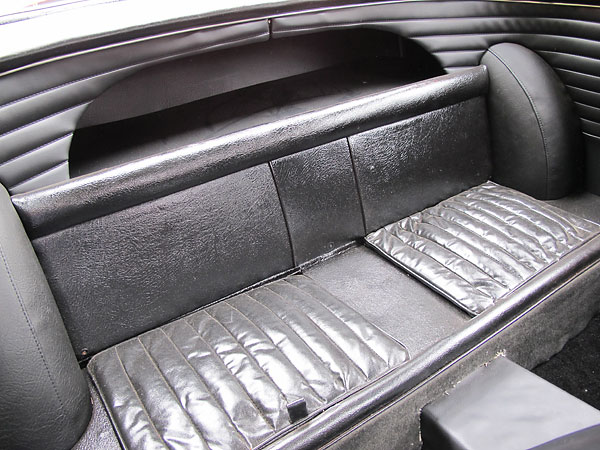

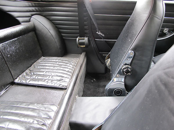

Unusual rear jump/occasional seat arrangement is only found in the first 6000 P1800s.
Unusual rear jump/occasional seat arrangement is only found in the first 6000 P1800s,
which were built by Jensen Motors in England.
Storage cubby over the jump seat's backrest.

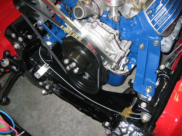

Trans Dapt Performance Products part# 9314.
Engine Mounts are Trans Dapt Performance Products part# 9314.
Rubber sandwiched between steel cups.
They're rubber sandwiched between steel cups. JC Whitney offers them for installing V8s in Jeeps.
Generous oil pan and pulley clearance to front crossmember.

The Super Peanut!
Larry calls his car The Super Peanut!
In Swedish: Lars kallar sin bil De Super Jordnöt!
In Swedish: "Lars kallar sin bil De Super Jordnöt!"
It's sort of a souped down Ferrari.
Volvo's original ads for the P1800 proclaimed:
"It's sort of a souped down Ferrari."
Volvo's P1800 was priced very comparably to Jaguar's E-Type.

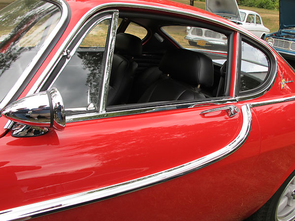

Bold upward-curved side trim was a characteristic feature through 1966.
(From 1967 on, narrower straight pieces of trim were installed instead.)

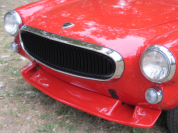

IPD fiberglass front chin spoiler from IPD.
IPD fiberglass front "chin" spoiler from IPD.

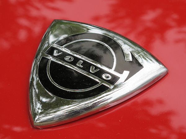

Triangular Volvo badge: installed until a rectangular design arrived for the 1972 model year.

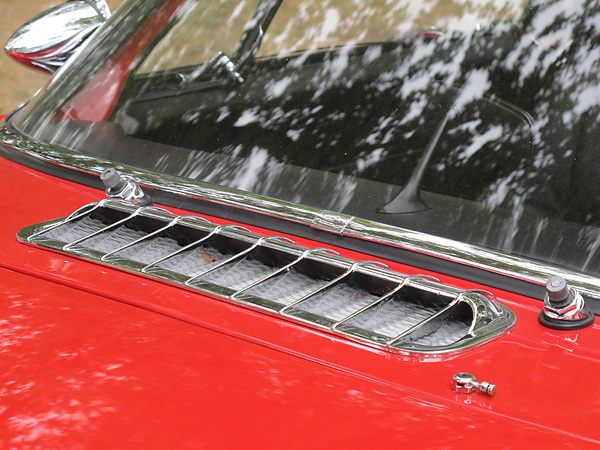

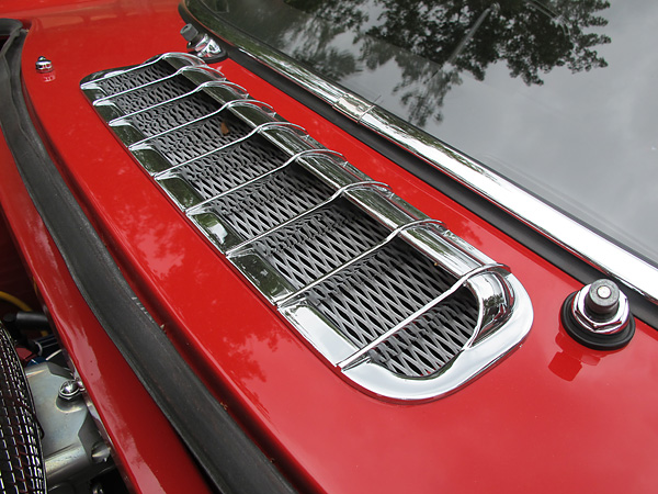

Fresh air inlet grilles were chromed on P1800, but were painted body color on 1800S.
(The expanded metal leaf screen is a factory original detail.)

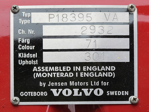

Assembled in England (Monterad I England) by Jensen Motors Ltd. for Volvo, Goteborg, Sweden.
Type P18304 VA, Ch. Nr. 2932, Colour 71, Upholst 301
Assembled in England (Monterad I England) by Jensen Motors Ltd for
Goteborg - VOLVO - Sweden

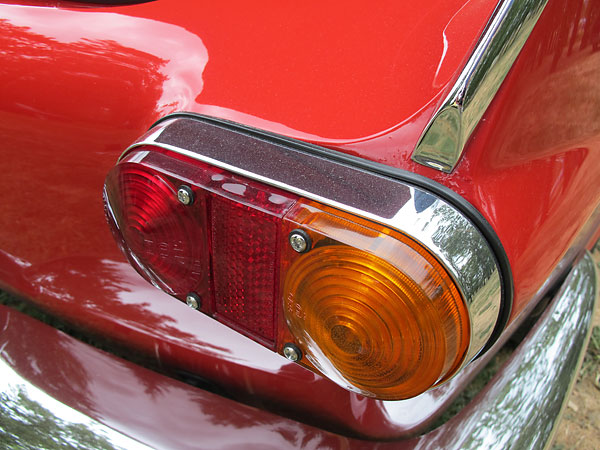

Volvo P1800 tail light assembly. (Current replacement cost: ~$400.)
American Racing aluminum wheels.
Pirelli P6 tires, size 195/60R15.
