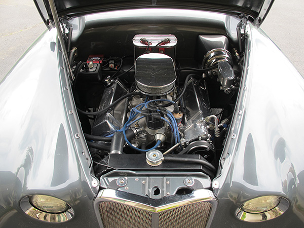

Engine: Ford 460cid V8
Conversion by: Eclectic Rods and Restorations

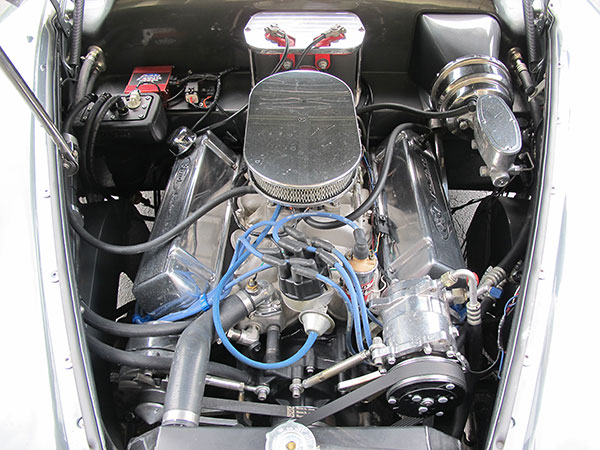

Engine: Ford 460cid V8. Edelbrock Performer RPM intake manifold. Edelbrock Performer RPM camshaft. Trick Flow hardened push rods. Crane roller rockers. Edelbrock E-Street throttle body electronic fuel injection kit. Lokar throttle cable. MSD Pro-Billet distributor. MSD Blaster 2 ignition coil (#8200). Ford Motorsport spark plug wires. March pulley kit. 9 quart cast aluminum oil pan. Custom built 26 gallon stainless steel fuel tank.
Cooling: custom aluminum radiator. Flexalite engine driven fan.
Exhaust: ported Ford F-350 cast iron exhaust manifolds. Stainless Steel 3" exhaust. Flow Master stainless steel Mufflers
Transmission: Ford C6 automatic transmission. Hurst gear selector.

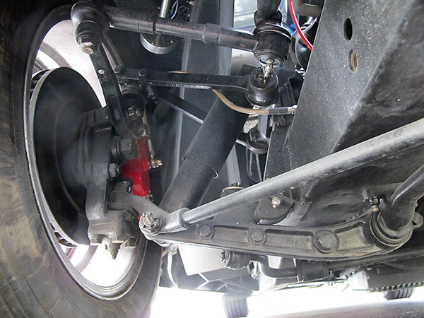

Front Susp.: stock geometry and torsion bars. Unisteer electric power steering. Koni gas shock absorbers.

Brakes: (master) Wilwood tandem master cylinder, with power brake booster. Wilwood bias valve on rear circuit. Braided stainless steel brake hoses and stainless steel tubing for all hard lines.
(front) Wilwood calipers and Cadillac 11" vented rotors.
(rear) Cadillac calipers with cable actuated parking brakes and Cadillac 11" vented rotors.

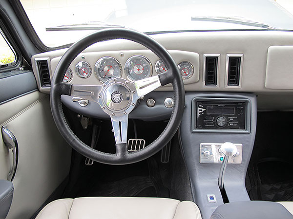

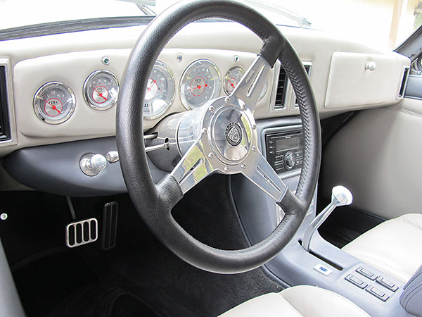

Instruments: Classic Instruments gauges (left to right): fuel level (E-F), oil pressure (0-100 psi), speedometer (0-140 mph), tachometer (0-7000 rpm), voltmeter (8-18 V), coolant temperature (170-220 F).

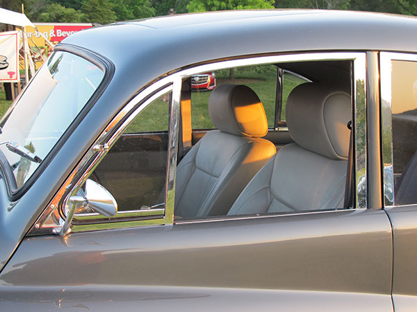

Body: Removed front and rear bumpers. Recessed headlights. Billet Specialities recessed LED turn signals. Stainless steel grille insert. Custom fabricated window glass, with tint. Shaved side trim strips and door handles. Motorcycle side-view mirrors. Hagen recessed fuel filler. Billet Specialities LED high mounted stop lamp. Billet Specialities recessed LED brake lights. Frenched license plate. Dupont basecoat/clearcoat paint, color "Techno Gray Metallic".

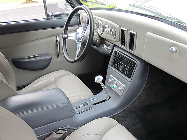

Interior: Custom dashboard. Pioneer sound system (AM/FM, CD, MP3, USB, Bluetooth, and high definition stereo). 2008 Cadillac DTS 8-way power seats, upholstered in Light Titanium. 2005 Cadillac STS center armrest, shortened 6". Custom door cards. Custom headliner. Custom carpets. Specialty power windows (all four doors). Autoloc remote door lock system. Lokar accelerator pedal system and brake pedal. Lokar parking brake lever. Moto-Lita steering wheel. Flaming River tilting steering column. Southern Air air conditioning system. (Sanden compressor.) Billet Specialities interior and exterior mirrors. Digital Shift Indicator Joseph Pollak electric remote-control door locks with solenoid release "poppers". Electrically operated windows. Custom narrowed wheel for space-saver spare tire.

Ford 385 V8 - 460cid version.
Introduced in 1968 and produced through 1997, Ford called their final generation big block
"385" for its 3.85 inch stroke. Ken chose the 460cid variant for his Jaguar. For its size, it's
a relatively lightweight mill because it features a thin-wall, skirtless engine block casting.

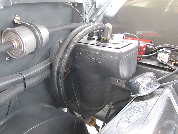

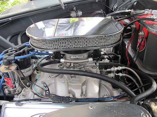

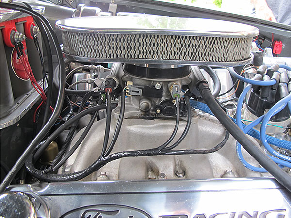

Edelbrock E-Street throttle body electronic fuel injection.

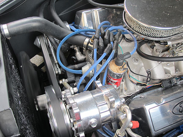

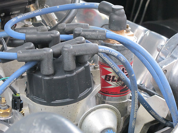

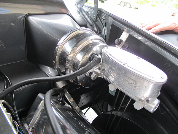

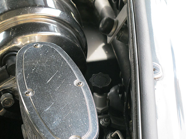

March pulley kit.
Flexalite engine driven fan. March pulley kit.

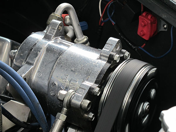

Sanden air conditioning compressor.

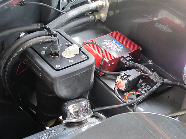

This fuel sump is part of the Edelbrock E-Street electronic fuel injection kit.
The Edelbrock system's electronic control unit (system ECU).

Suspension and Brakes

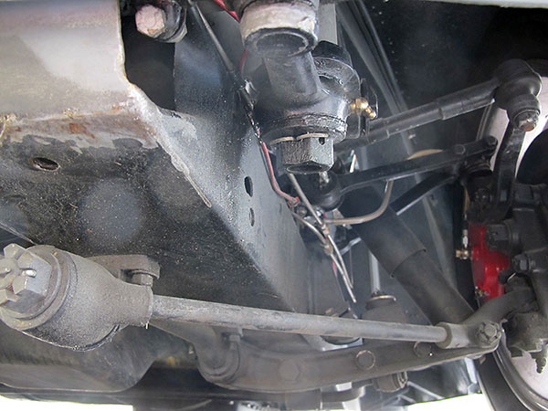

Jaguar torsion spring front suspension.
Unisteer electric power steering system.
After these photos were taken, Ken installed a Unisteer electric power steering system.

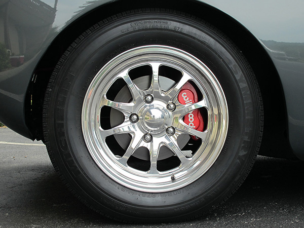

Wilwood calipers and Cadillac 11 inch vented rotors.

Ken selects his shifts with this Hurst gear selector.

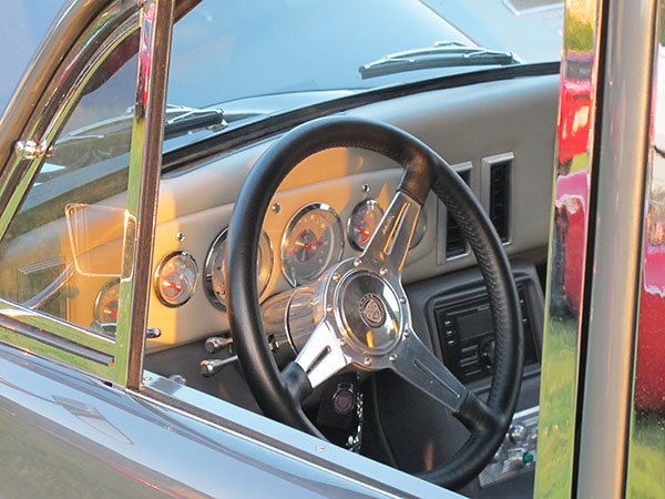

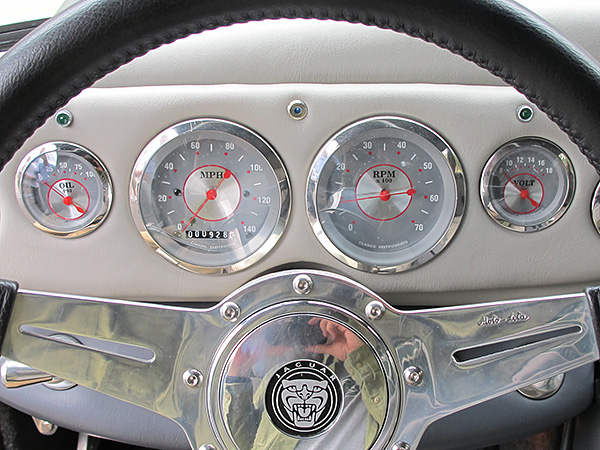

Classic Instruments gauges: oil pressure, speedometer, tachometer, and voltmeter.

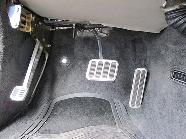

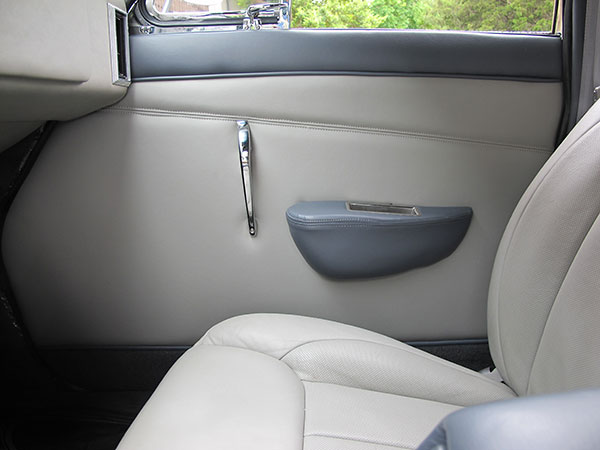

Custom door cards and armrests.

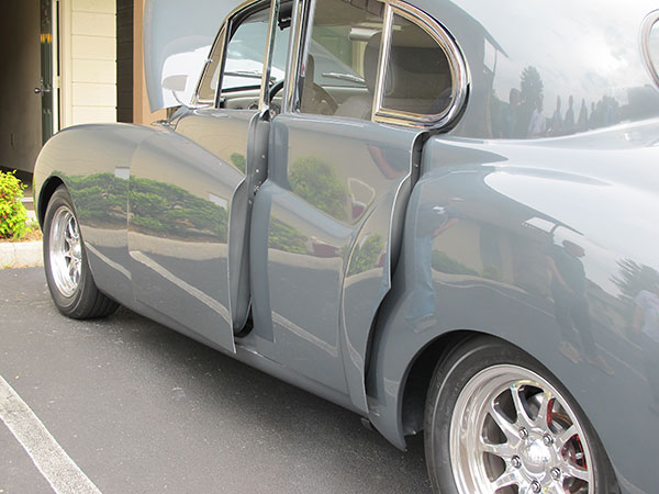

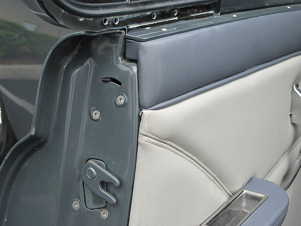

Door hinge details.
Door hinge details.
Rear doors feature child safety latches, about 25 years ahead of most other cars.

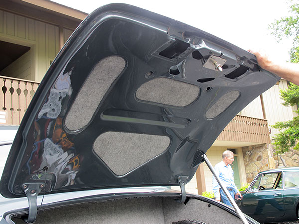

Trunk lid.
Trunk lid.

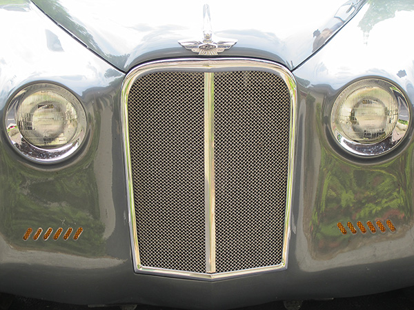

Recessed headlights. Stainless steel grille insert.

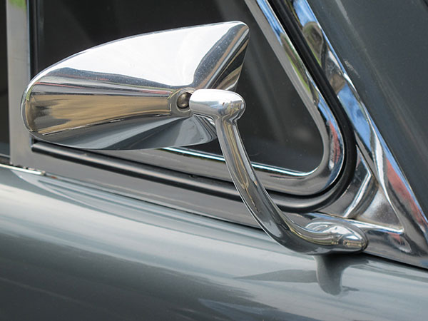

Motorcycle style side-view mirrors.

Side trim strips and exterior door handles have been removed.

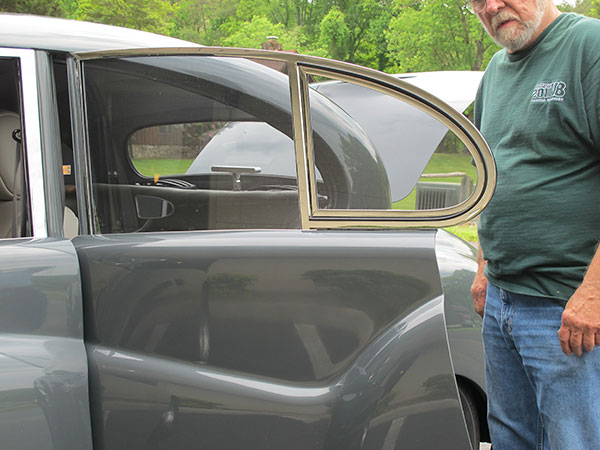

Really cool pivoting back door windows.

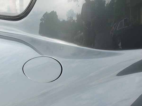

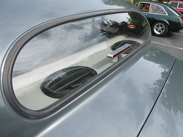

Billet Specialities high mounted stop lamp.

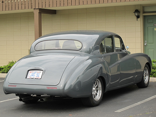

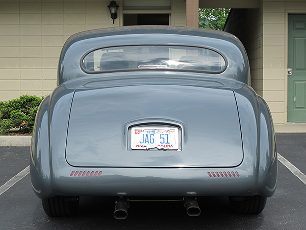

Original bumper, rear lamps, and license plate frame have been removed.
Original bumper, rear lamps, and license plate frame have been removed...
Billet Specialities recessed LED brake lights have been installed, and
a tidy pocket has been fabricated for the license plate.

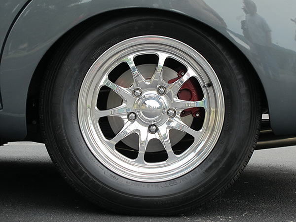

Intro custom aluminum wheels (front 16x7, rear 16x8).
Intro custom aluminum wheels (front 16"x7", rear 16"x8").
Michelin Symmetry tires (front 225/60R16 and rear 235/60R16).
