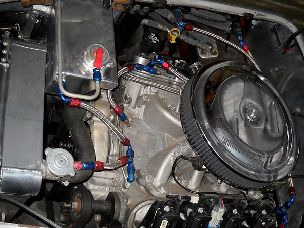

Engine: GM LS2 6.0L aluminum V8, rated 446bhp at 6200rpm. (10.9:1 compression ratio. 6-bolt cross-bolted main bearing caps.) Hydraulic roller camshaft (200 degree intake, 203 degree exhaust, 0.500" lift). Investment cast, roller trunnion, 1.7:1 ratio rocker arms. GM Performance dual plane aluminum intake manifold. Holley 4160 780cfm 4-barrel carburetor. Holley inline electric fuel pump. Russell fuel fittings. MSD6LS programmable ignition system, controlling eight individual GM ignition coils (one per cylinder.)
Cooling: AFCO custom aluminum radiator and expansion tank. Plumbed with aero fitting. Spal electric cooling fans (both pusher and puller.) GM pickup truck (wet sump) oilpan.

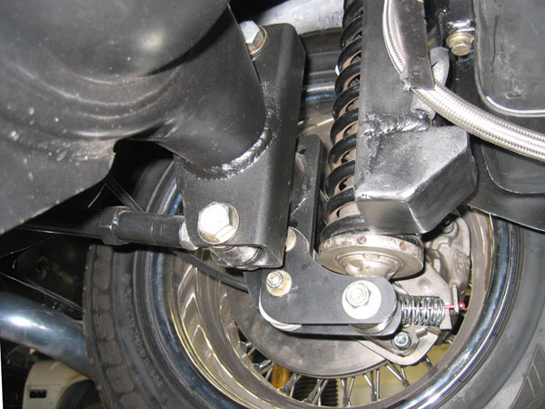

Rear Susp.: custom four-link rear suspension, with coilover shock absorbers. A-link for side-to-side axle location.

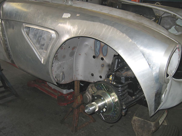

Brakes: Chevy-style dual-pot master cylinder and 7" dual diaphragm power booster from Stainless Steel Brake Corporation. Austin-Healey BJ8 front brake calipers with custom pads. Drilled & slotted front rotors from an early BMW 5 series. Cadillac Eldorado rear disc brakes.

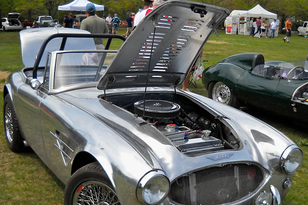

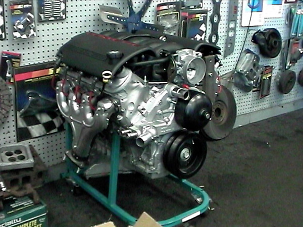

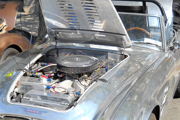

GM Performance dual plane aluminum intake manifold and Holley 4160 780cfm 4-barrel carburetor.
An MSD6AL capacitive discharge ignition module works with the eight GM ignition coils.

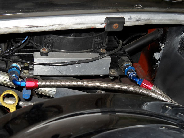

Transmission cooler, with its own electric fan.
Under the righthand side fender: transmission cooler, with its own electric fan.

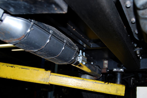

Flowmaster Hush Power 2.5 inch stainless mufflers, with accessory heatshields.
Flowmaster HushPower 2.5" stainless mufflers, with accessory heatshields.
This fuel-injected Chevy Z06 crate engine was originally tested.
The LS2 is the second engine installed in the Elliott-Healey.

Drilled & slotted front rotors from early BMW 5-series. BJ8 front brake calipers.

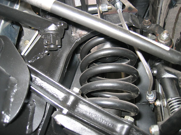

Custom springs.
Custom springs.

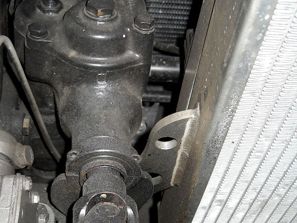

Rebuilt original cam-and-peg steering box. (Stock 15.0:1 ratio. 2.9 turns lock-to-lock.)

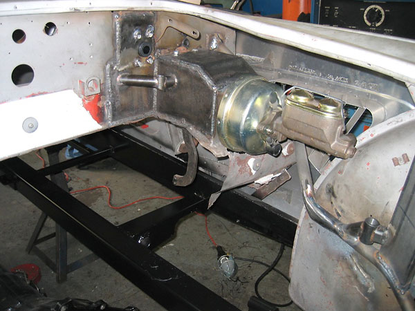

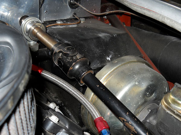

Tandem (two circuit) master cylinder and power brake booster.

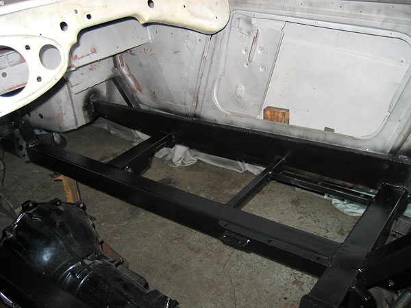

Heavy duty frame.
The new heavy-duty frame was built from scratch by BBC Performance of Linden NJ,
(except for the front crossmember.)

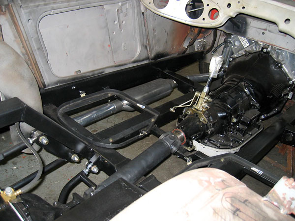

4L80E Bionic manually-shifted automatic transmission with Lokar shifter.
4L80E "Bionic" manually-shifted automatic transmission with Lokar shifter.

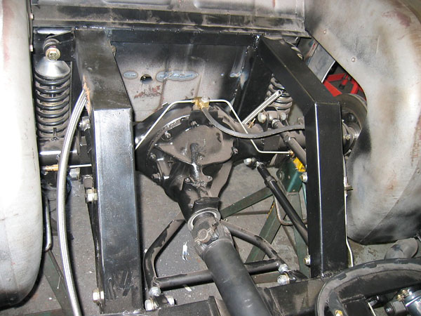

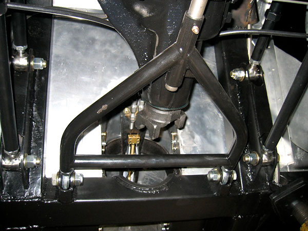

Custom four-link rear suspension, with coilover shock absorbers.
Narrowed Chrysler 8-3/4" axle housing, with limited slip differential.
A-frame pinion travel limiter.
One doesn't expect to see an A-link like this on a car that's also equipped with four-link
rear suspension. Like a Panhard rod or Watts linkage, the A-link restricts side-to-side
movement of the axle. Simultaneously, it helps plant traction for launching the car forward.
Downside? Binding is nearly a certainty within the suspension's range of motion.

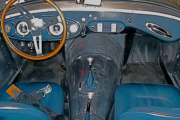

Connolly leather seats and dash in Bermuda blue.
Dashboard and seats are covered in Bermuda blue dyed Connolly leather. In the center of the
dashboard, a small switch panel has been added for power windows, power door locks, and
solenoid-operated bonnet latches.

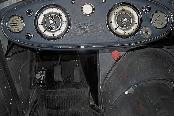

Smiths gauges
Original Smiths speedometer/odometer (which read 5205 miles when the photo was taken), Smiths
tachometer (rev limit set to 5300rpm), Smiths combination oil pressure/water temperature gauge,
and Smiths fuel level gauge. An early Aston Martin provided the turn signal indicator lamps.
Turn signals are operated by the electric OD switch. Electric horn switch is under the left side.

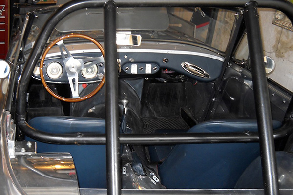

Custom rollover structure.

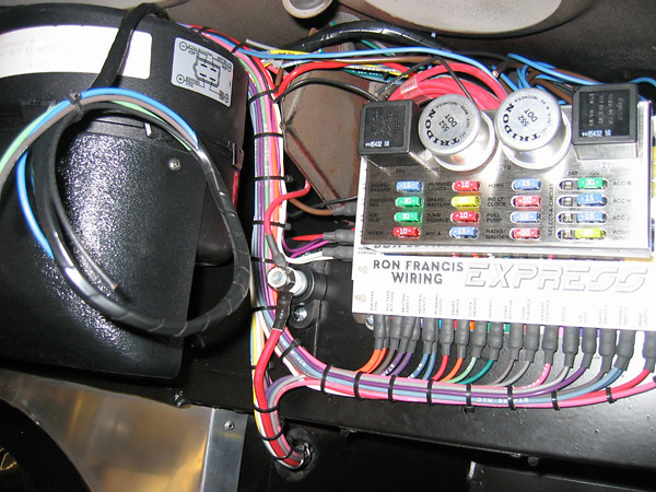

Ron Francis wiring harness featuring two relays, two flashers, and sixteen fuses.

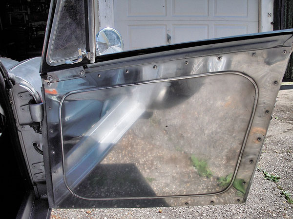

Custom stainless steel door trim panel, with bead-rolled detail.

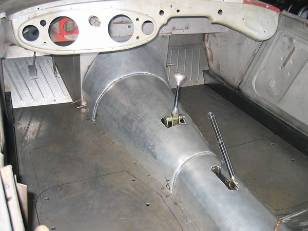

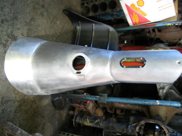

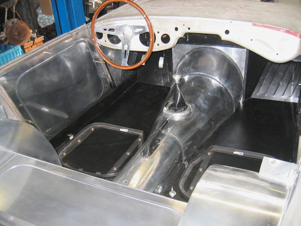

Custom fabricated one-piece stainless steel transmission and driveshaft tunnel.

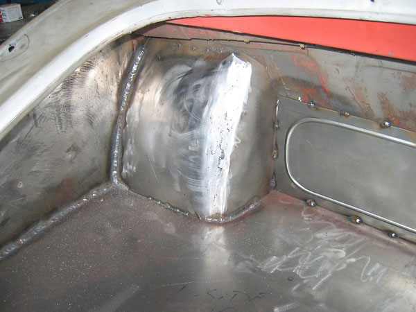

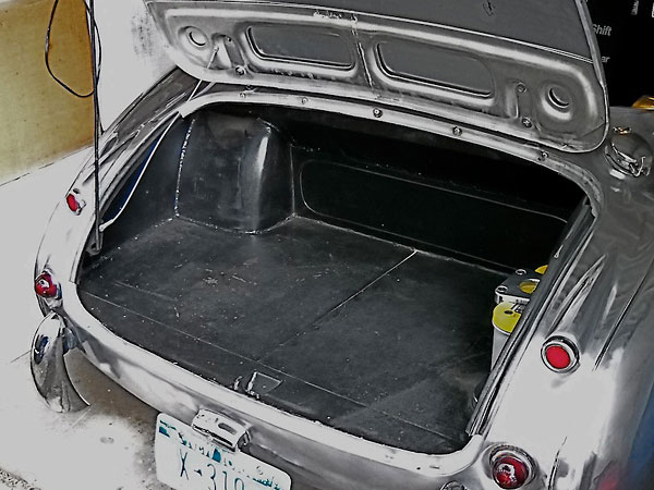

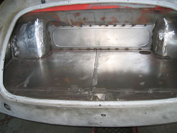

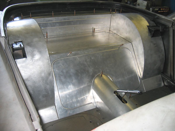

Heavy gauge steel trunk floor.

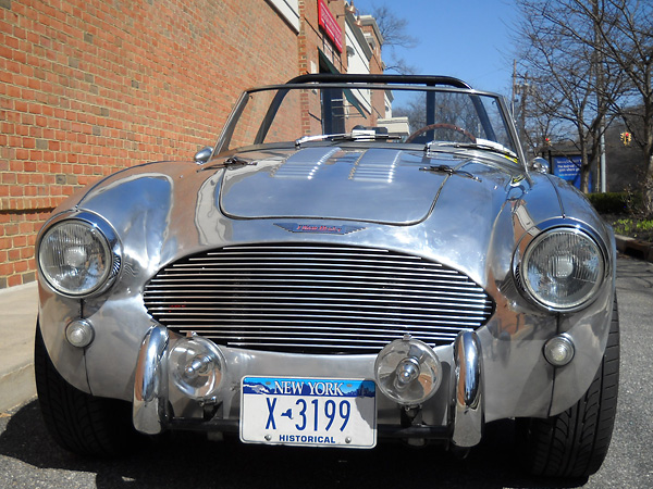

Custom fabricated aluminum grille.

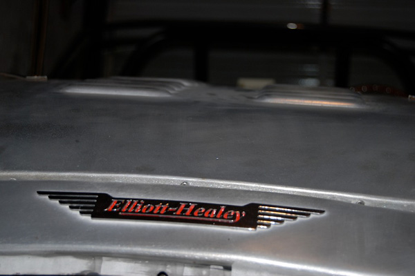

Elliott-Healey
"Elliott-Healey"

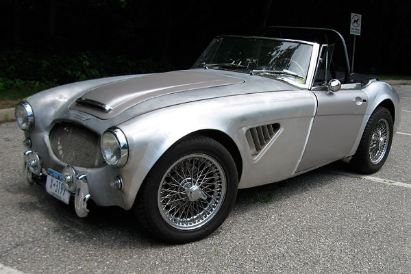

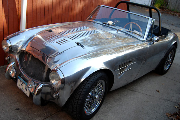

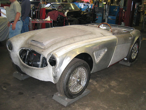

Lightweight aluminum body panels.
Original Austin-Healey 3000s came with a mixture of steel and aluminum body panels.
On the Elliott-Healey 6000, all steel panels except the rocker panels (including the
outer front and rear fenders, the bonnet, the door skins, ands the trunk lid) have
been replaced by new lightweight aluminum panels.
No body filler was used anywhere: this car would not be painted!
Jim wrote: "The only original aluminum panels are the front and rear shrouds which required minimal
hammerwork, but I did leave a ding in the front passenger section as it had been collected at
Bridgehampton back in the day." (Editor: Bridgehampton was a well loved racetrack at the east
end of Long Island. It hosted all levels of racing, including Can-Am, but closed in the mid 1980s.)

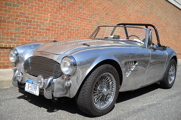

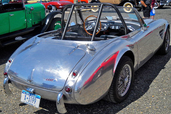

Like airplanes of the 1950s, the Elliott-Healey's aluminum body is buffed to a mirror finish.
Louvered bonnet. Rally-style side vents. Custom fender flares.
