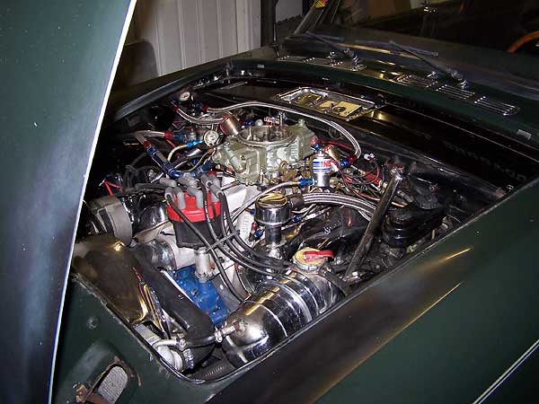

Engine: Ford V8
Engine: 371cid motor from World Products ("Man O War"), featuring Edelbrock Victor Jr. aluminum heads, Edelbrock Super Victor intake manifold, and roller lifters. The engine is plate mounted. It has a 2 stage NOS kit rated at 175hp on the plate and a 175 fogger.

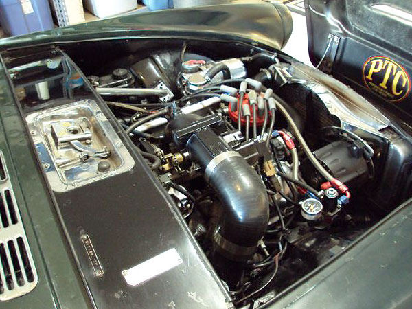

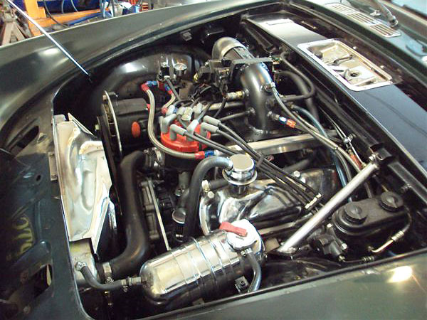

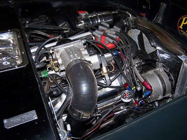

Twin Turbocharged!
new engine photo

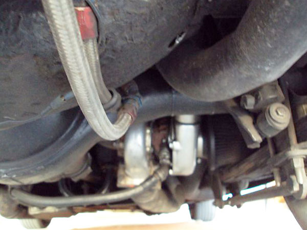

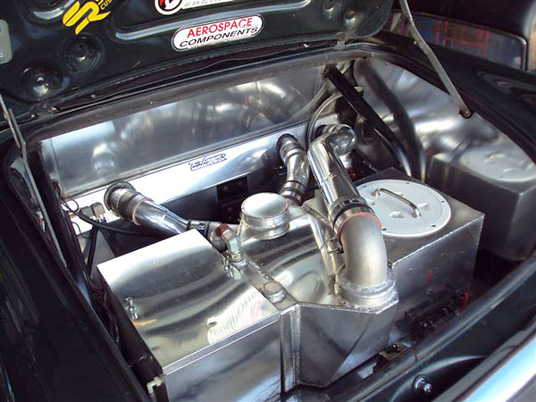

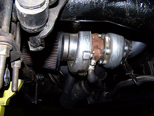

In early 2008 Jerry updated his Tiger with twin turbochargers...
rear mounted turbochargers
The turbochargers were mounted where they'd fit, back near the rear axle.

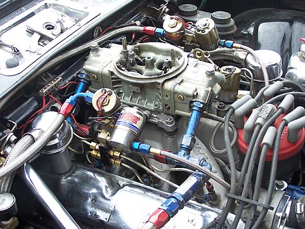

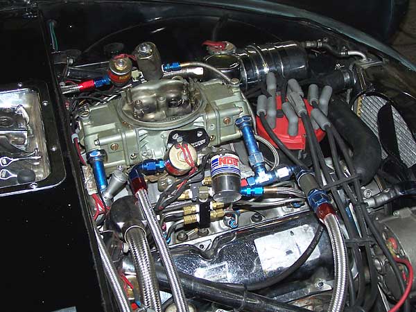

Earlier incarnation: Nitrous Oxide Injection
Ford V8
Nitrous injection
NOS injection

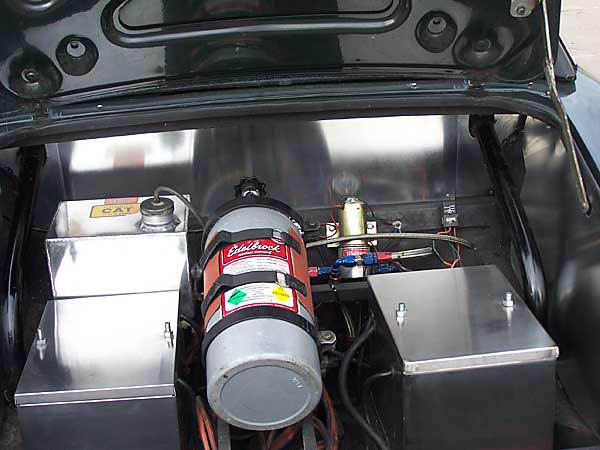

Edelbrock Nitrous tank

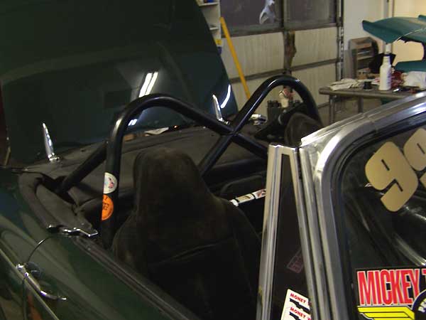

Sunbeam Tiger roll hoop

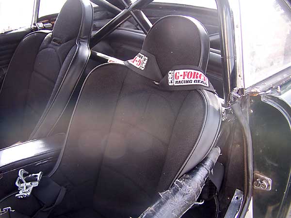

New Racing Seats
(New seats added April 2007.)

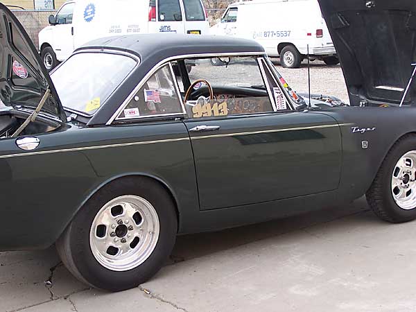

This may be the world's quickest Sunbeam Tiger.
