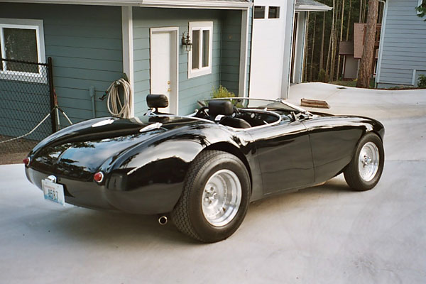

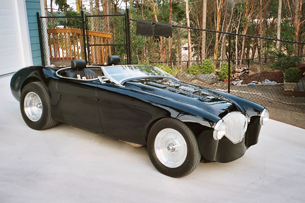

Jerry Johnson's 1955 Austin-Healey 100-4 with Chevy LT-1 V8 engine
Jerry Johnson's 1955 Austin-Healey 100-4 with Chevy LT-1 engine
Owner: Jerry H. Johnson
City: Port Townsend, WA
Model: 1955 Austin-Healey 100-4

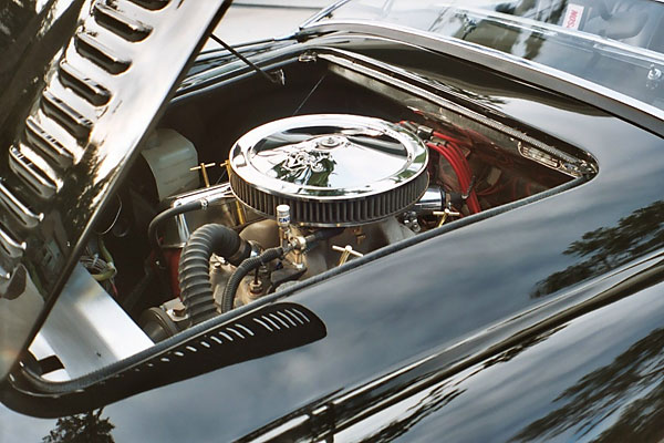

Engine: Chevy LT-1 350cid V8
Conversion completed by: Ben Foster and Rob Dvorsky, Ukiah CA
Engine: LT-1 engine (from ~1970) with Dart heads, forged 10.5:1 pistons, and 7 quart oil pan.
(Built by Baca's Engine Shop, S. San Francisco.)
Induction: Holley double-pumper carburetor.
Cam: Crane.
Ignition: standard GM.
Cooling: aluminum radiator with two thermostatically-controlled electric fans.
Exhaust: tubular headers, 2.25" dual exhaust/mufflers.

Rear Axle: narrowed Ford 9".
Front Susp.: 1979 Triumph TR7, including steering rack.
Brakes: disc.
Wheels/Tires: 15" Centerline wheels and Mickey Thompson tires.
(I also have an extra set of 14" Centerline wheels with Goodyear tires.)
Weight: 2400 pounds.

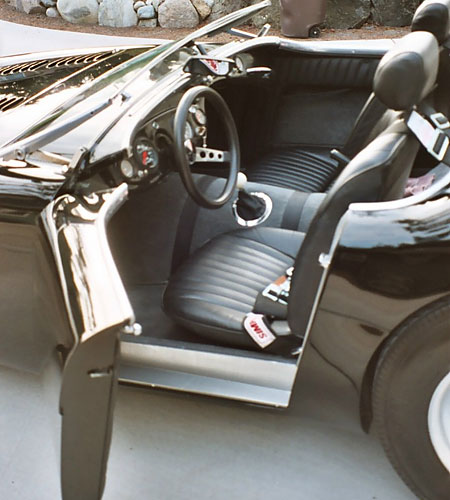

Interior: custom. 1979 Triumph TR7 bucket seats with Simpson safety harnesses. Autometer gauges.
