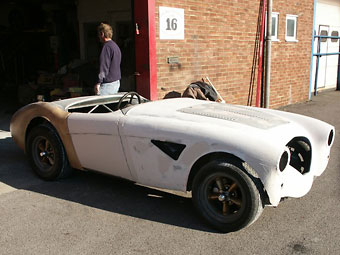

So instead of road trip, it was tear down time. I took the car to Pete Farmer Performance Racing. During the disassembly phase we found a 1964 newspaper in the left front fender, presumably from Greg's first rebuild! A decision was made to keep and repair all the old panels to ensure the best fit. A 5-6 month build estimate turned into a 14 month marathon due to much saying of "What if we did this now?" Luckily, Pete's reputation of not suffering fools gladly did not affect the growing friendship between the builder and his idiot customer.

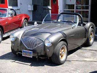

Greg Greathouse's UNCOBRA   UNCOBRA... stripped down for new bodywork
The "before" pictures: (left) as purchased and (right) as stripped down during the new bodywork.

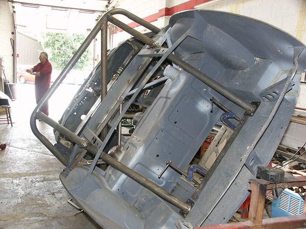

accurate fixture for working on the frame and body
For best results, it's very helpful to have an accurate fixture for working on the frame and body.

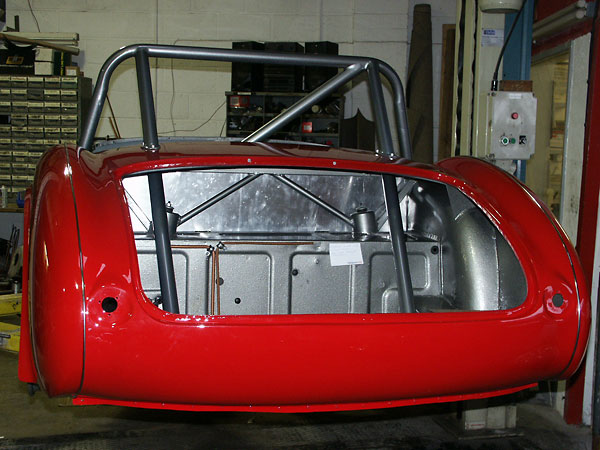

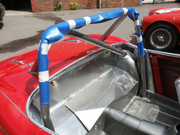

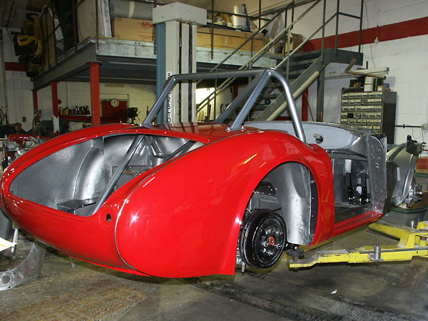

The original Hobrecht roll hoop was less than reassuring, so a triangulated half roll cage was fabricated. The height of the main hoop was chosen to accommodate a hardtop. To get enough angle on the rear struts, they were made in two sections and passed through the rear deck. At the same time the rear telescopic shock mounts were re-sited to make them more vertical.
Replacing the roll hoop was one of the earliest steps in the project.

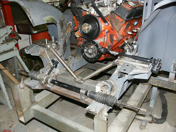

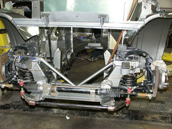

During the rebuild, I decided to convert the car to right-hand drive, and also convert to rack and pinion steering. The new steering column and rally-spec quick-ratio rack came from a Ford Escort (Mk2) and the intermediate shaft is from a Westfield. While the car was on the rotisserie, the chassis was capped full length. Adjustable suspension top mounts were fitted and the suspension towers were triangulated to reduce flex. Pete likes the stock Healey front suspension, so we removed and sold the Koni telescopic shocks that Greg had installed, and replaced them with uprated lever-arm shocks. However, I'm investigating coil-over options for the front suspension.
Ford Escort steering rack.
After the front structure is reinforced, the next step is installing a Ford Escort steering rack.
uprated lever arm shocks and camber adjustable top mounts
20 percent uprated lever arm shocks and camber adjustable top mounts.

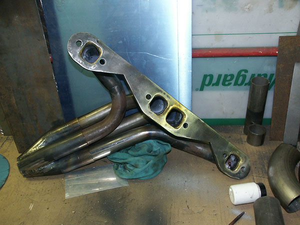

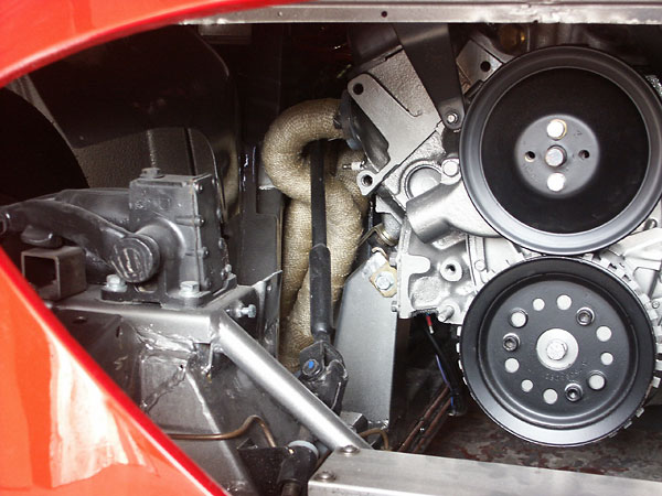

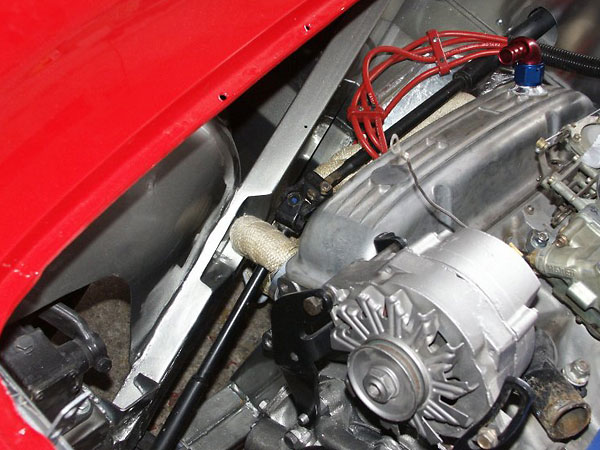

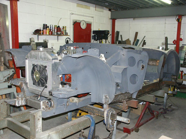

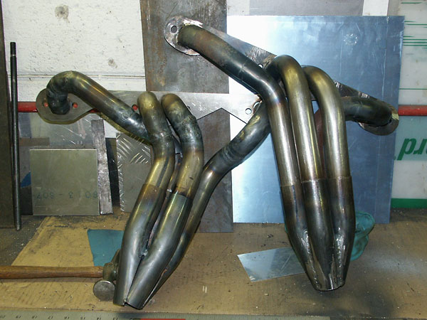

As there was little hope that off-the-shelf headers would fit the very restricted Healey engine bay, custom headers were created.
custom headers pieced together from pre-bent tubing sections
flat header flanges
(The next two photos are out of sequence, but they show how the steering threads through the headers.)
steering intermediate shaft threads through the exhaust headers
the headers are a very tight fit all around

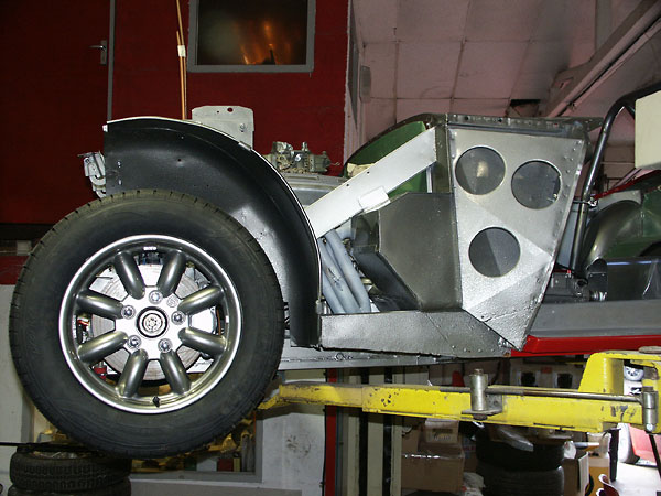

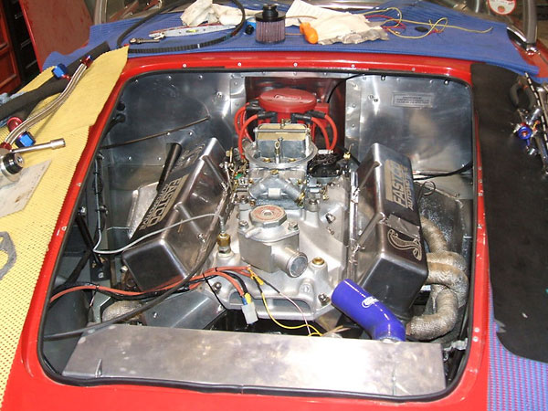

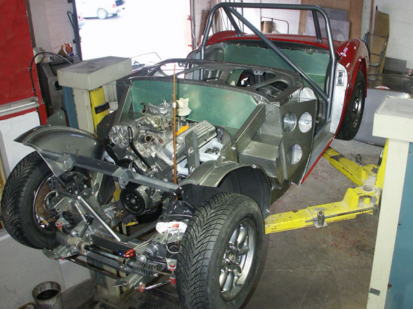

About halfway finished, it looked like this. Behind the crank pulley you can see the timing wheel for a crank sensor, installed in anticipation of a future fuel injection installation. The copper fuel feed and return pipes for the future EFI can be seen standing vertically. Because I insisted on a normal opening bonnet (hood) the stay that holds both the hinges and stabilises the front wheel arches has been made removable to allow easier removal and fitting of the engine.
Notice the new aluminum bulkheads.
I didn't think BN1's came with those three holes.
are the white panels for sound deadening?
isn't she pretty in pink

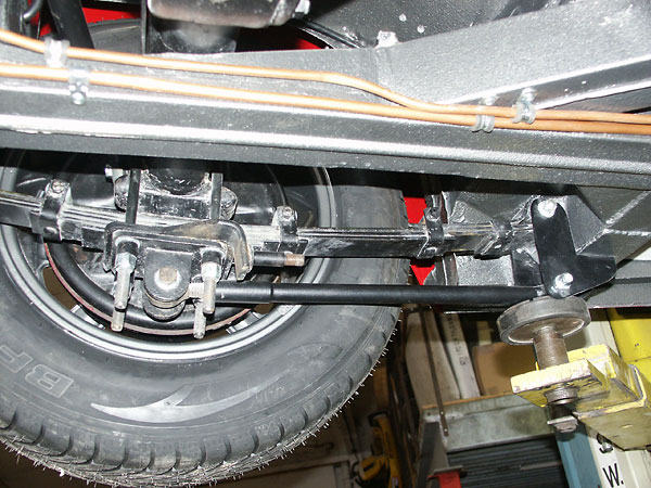

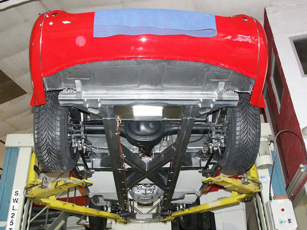

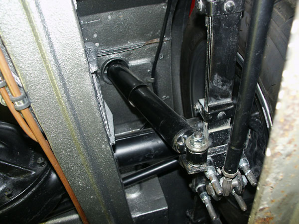

Anti-tramp bars were fabricated and installed to reduce or eliminate wheel-hop during braking due to leaf spring "wind-up". A Panhard rod was installed to restrict side-to-side movement of the body relative to the axle when cornering. Longer term, I'll be looking at a 4-link or maybe a Jaguar rear-end.
Anti-tramp bars reduce wheel-hop during braking due to leaf spring wind-up.
Panhard rods restrict side-to-side movement of the body when cornering.
You'd better get the axle right the first time because it's hard to get to later!

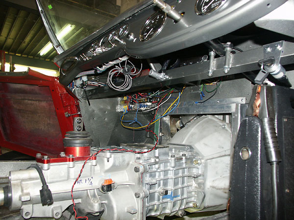

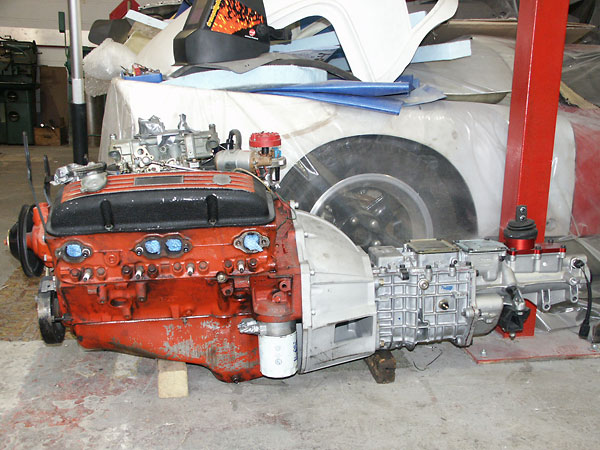

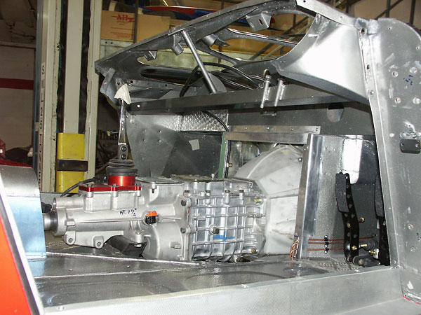

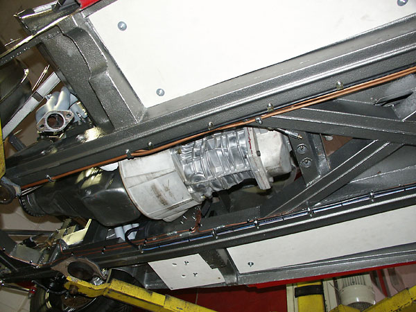

Other parts for the project were coming in left and right. The new transmission is a Tremec TKO600 5-speed. We sold Greg's old Muncie 4-speed, but kept the Hurst shifter. The Tremec transmission is big, so we needed to create a new fibreglass transmission tunnel and at about this time we also installed pedals and built-up a new dashboard.
A test fitting of the Tremec TKO600 5-speed to the old engine. The pair are then temporarily installed.
Tremec five speed transmission

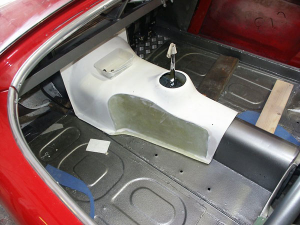

Custom fibreglass transmission tunnel.

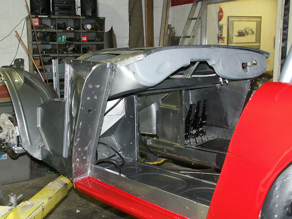

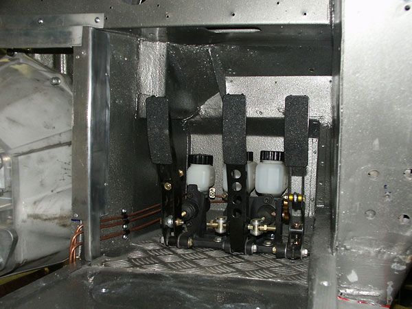

Tilton brake pedal set, featuring twin master cylinders with bias bar.

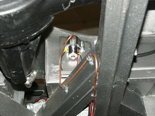

Electric operated line lock solenoid (in lieu of a cable-operated parking brake).
Electrically operated line lock solenoid (installed in lieu of a cable-operated parking brake).

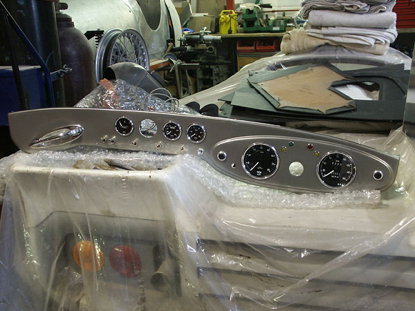

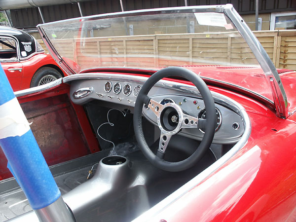

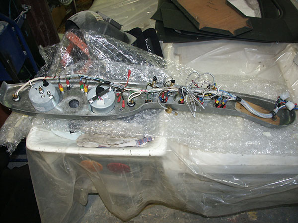

Test fitting the new dashboard.
Custom dash with Cobra gauges.

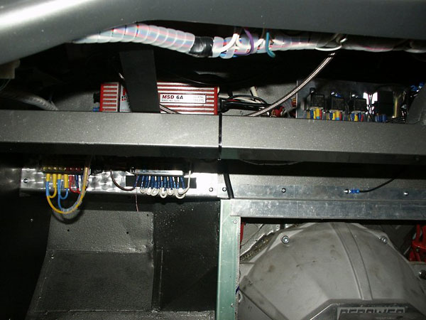

Custom wiring loom.
wiring the custom Austin Healey dashboard
MSD 6A capacitive discharge ignition system.

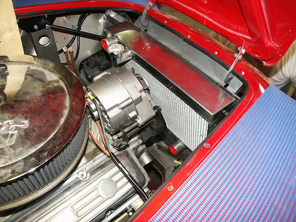

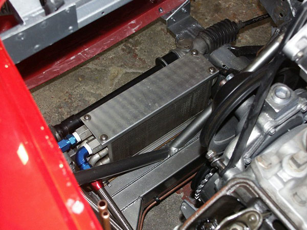

Meanwhile, work continued on the engine installation and particularly on the cooling system...

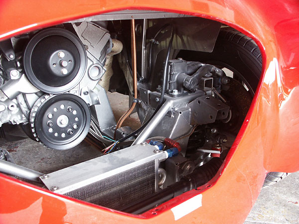

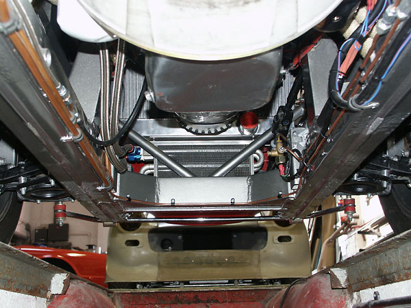

Austin Healey oil cooler
This is what the oil cooler looks like from back side...
radiator will ultimately sit immediately above the oil cooler
...and from above. The radiator will ultimately sit immediately above the oil cooler!
Copper lines for EFI
One more look at the oil cooler, before radiator is installed. (Copper lines are for EFI, later!)

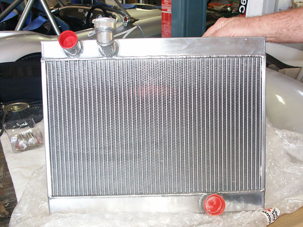

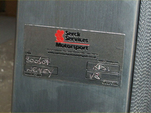

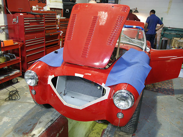

custom aluminum radiator from Serck Services Motorsport
A new, custom aluminum radiator from Serck Services Motorsport.
Serck radiator
recirculation shield at the top of the radiator
Notice the recirculation shield at the top of the radiator that prevents airflow from bypassing the core.

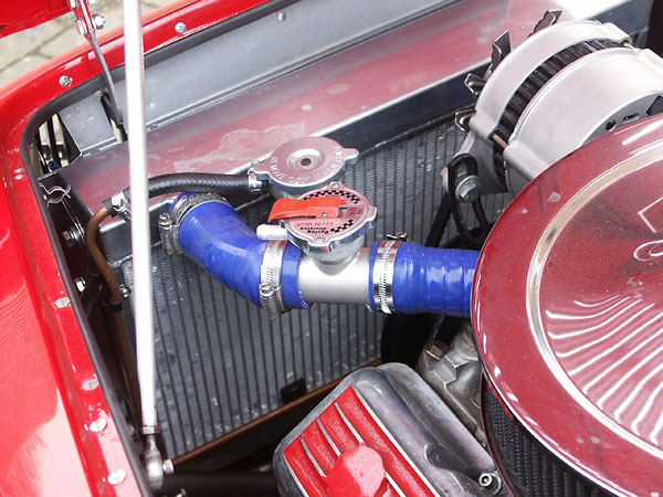

Moroso lever-release coolant pressure cap
Two radiator caps? Apparently the lever-release pressure cap is mounted at the high point in the system.

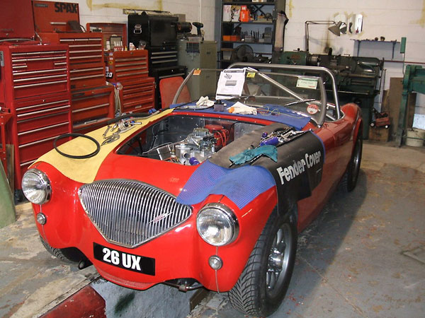

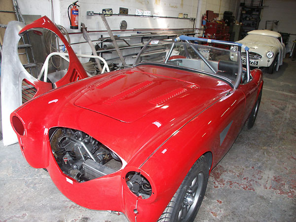

Anticipation built as various body panels and trim were reinstalled.
Minilite wheels
Louvered Austin Healey 100 bonnet.
installing a louvered Austin Healey BN1 bonnet
air cleaner

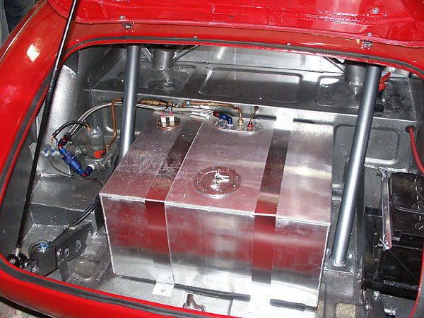

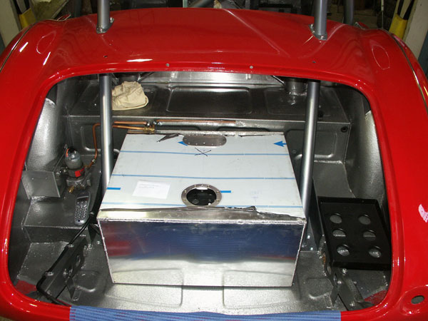

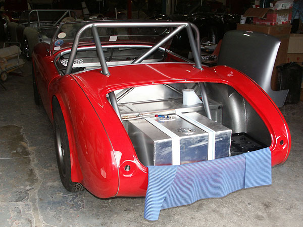

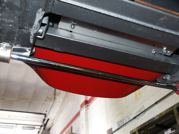

A custom foam-filled high capacity fuel tank was fabricated and installed. The following photos also show the fuel pump wiring, the return lines for a planned/future fuel injection system, the low pressure fuel pump, a battery isolation switch, etc.
shock absorber towers
fuel pump
Austin Healey 100 fuel tank

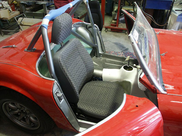

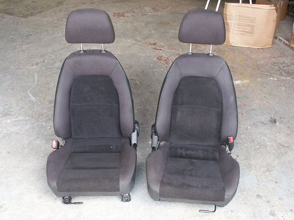

Since the car will be used for track days, safety equipment was a priority. I initially tried Range Rover Discovery seats, as shown below, but Mazda Miata seats were chosen instead. LED taillights (made for retrofitting onto Harley Davidson motorcycles) were also installed at this time.
diagonal support brace of the roll-hoop
Note that the diagonal support brace of the roll-hoop interferes with the seat's headrest...
diagonal cut out and replaced
...so the diagonal was cut out and replaced. Now it goes to the wheel arch.
Mazda MX-5 (Miata) seats.

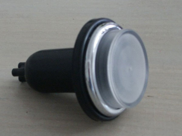

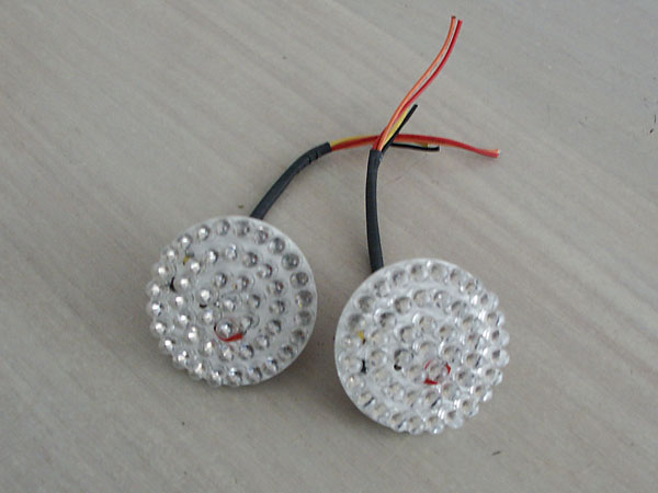

LED taillights for a Harley Davidson.
Ian created custom taillight enclosure and lens.
LED taillight for an Austin Healey

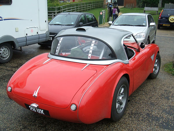

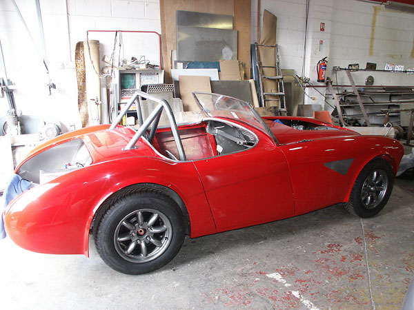

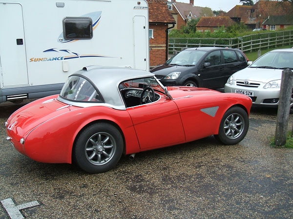

Finally, the renovated Austin Healey V8 was ready for driving!
New hardtop supplied by Pete Farmer Performance Racing.
A new hardtop, supplied by Pete Farmer Performance Racing.
fibreglass hardtop

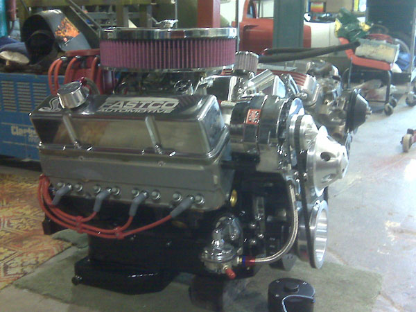

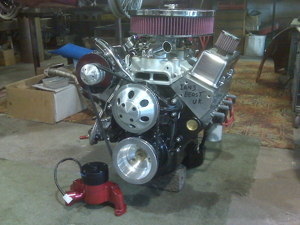

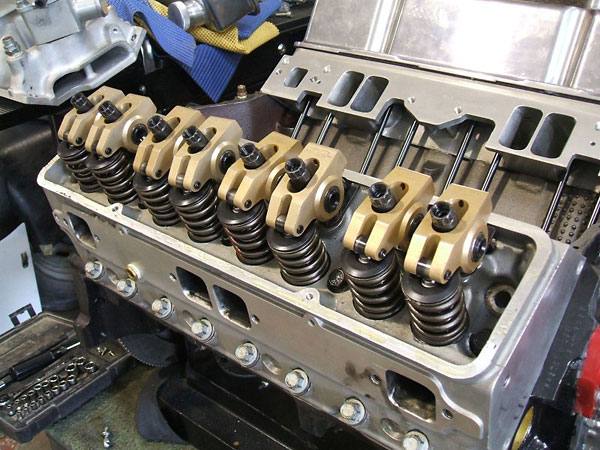

Having lunched the original Chevy 350 at the "Sports and Retro Day" at Castle Combe Racetrack with low oil pressure and a jammed-open throttle, I had a word with Daryl at Fastco Automotive Products in Niagara Falls, New York. They have a waiting list, but Daryl said he had a cancelled-order custom engine that could be modified to my requirements. I snapped it up! My car went back to Pete Farmer Performance Racing for upgrade.
Sports and Retro Day at Castle Combe Racetrack
low oil pressure
Ian's Beast UK

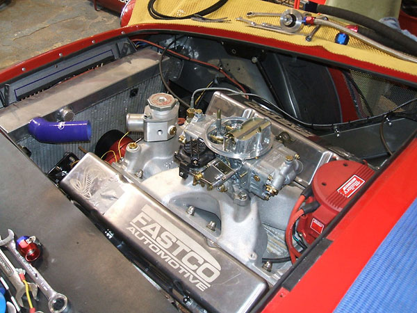

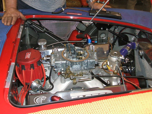

PRW forged aluminium roller rockers, with 1.6:1 ratio.

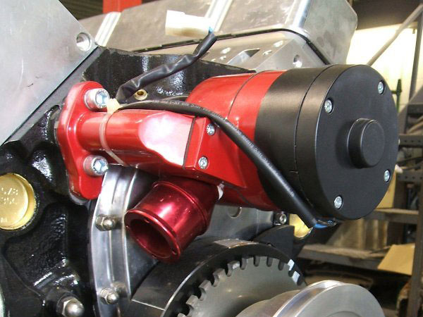

Proform electric water pump.
Fender cover.
Improved location for Moroso coolant pressure cap
Note the new and improved location for the Moroso coolant pressure cap.
The larger HEI-type distributor forced further modification of the firewall.
Mallory HEI-type distributor

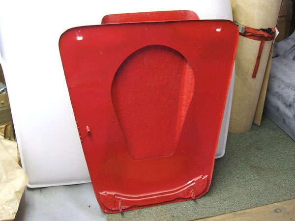

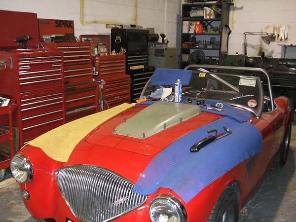

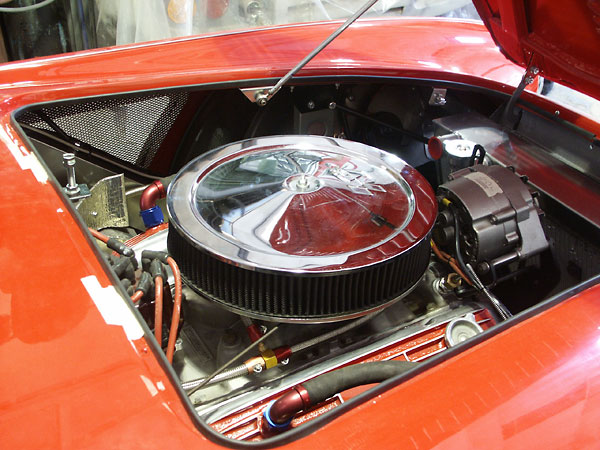

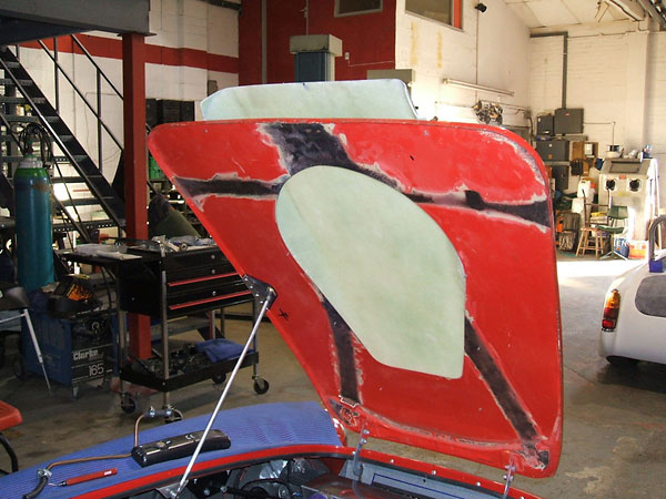

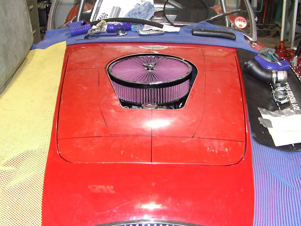

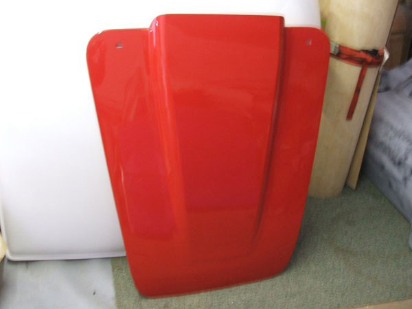

Unfortunately the higher Victor Junior inlet manifold needed a carbuncle on the classic profile of the bonnet (hood). It was the only practical way to go without dropping all the engine and gearbox mounts.
glassfibre Austin Healey bonnet
trial fitting the glassfibre hood scoop
custom made fiberglass hoop scoop
removed glassfibre reinforcements in glassfibre Healey 100 Bonnet
cowl induction hood scoop
cowl induction, from the bottom
