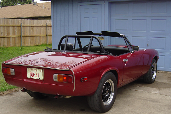

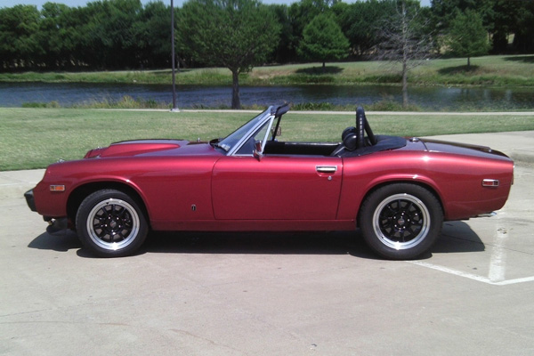

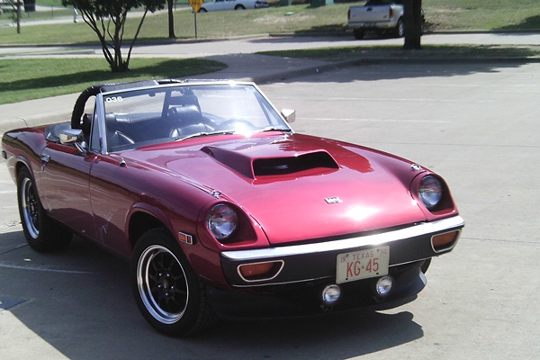

Galen Hazen's 1974 Jensen Healey / Chevrolet V8 Conversion
Galen Hazen's Chevy V8 powered 1974 Jensen Healey
Owner: Galen Hazen
City: Plano, Texas
Model: 1974 Jensen Healey
Engine: Chevrolet ZZ4 V8 (circa 2001)
Conversion performed by: owner.

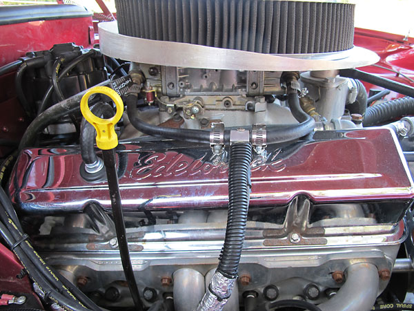

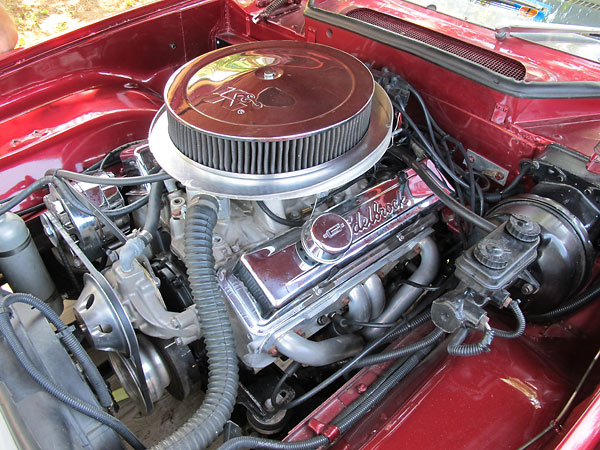

Engine: Chevrolet ZZ4 350 cubic inch V8 crate engine, purchased new in 2001. Forged steel crankshaft. Four bolt mains. Hypereutectic pistons. Edelbrock Performer hydraulic roller camshaft. Edelbrock Performer RPM aluminum cylinder heads (part number 6089, 64cc chambers, ~9.7:1 static compression ratio), slightly ported. Edelbrock valve covers. Edelbrock Air Gap intake manifold. Holley 750cfm double-pumper carburetor. Holley blue fuel pump. K&N gauze air filter. Delco HEI distributor. Accel Super Stock Spiral Core spark plug wires. Delco-Remy alternator. Weiand water pump (part number 8208). Billet aluminum pulleys. Gates XL fan belt. Speedway Motors small block Chevy crossmember-style engine mount (part number 1356023).

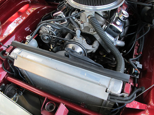

Cooling: Griffin crossflow aluminum radiator. Hayden adjustable electronic fan controller (part number 4003647-01).

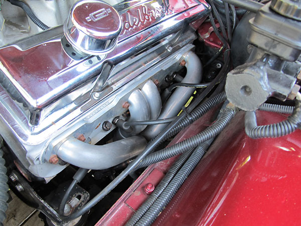

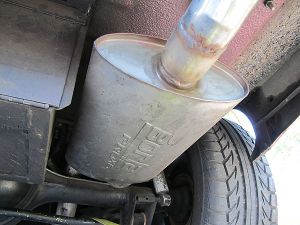

Exhaust: Sanderson mandrel-bent four-into-one block-hugger headers, with 1.625" primaries and 3" collectors. Dual Borla Pro XS mufflers and 2.5" exhaust pipes.

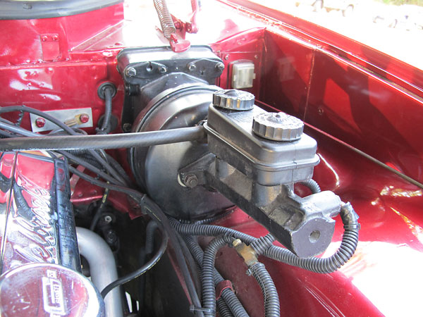

Brakes: (master) Dodge truck master cylinder, with original Jensen Healey power brake booster.

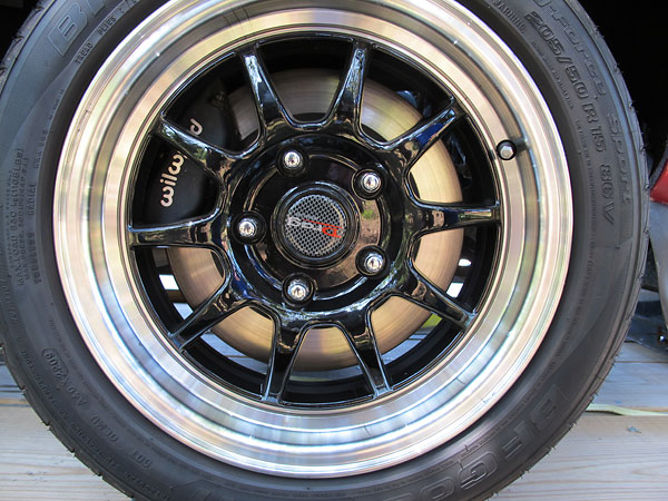

(front) Wilwood 4-piston calipers. Toyota 302mm vented rotors.
(rear) Jensen Healey / Girling 2-piston calipers, relocated from front. Toyota Camry station wagon 11.2" rotors.
Wheels/Tires: Drag Extreme Alloys 10-spoke aluminum wheels. BF Goodrich g-Force Sport 205/50R15 tires.

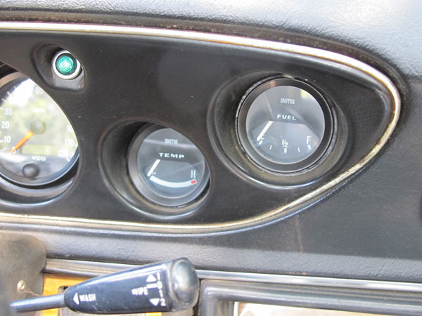

Instruments: VDO tachometer (0-7000rpm) and speedometer (0-120mph). Original Smiths voltmeter, oil pressure, temperature, and fuel level gauges.

Comments: This is Galen's second 1974 Jensen Healey. The first one's original four cylinder engine died after about 1500 miles, so he installed a Chevy 4.3 V6 and an 700R4 automatic. That engine produced ~260hp at the crank. In 2001, the first car was involved in a fender bender, and during the repair process Galen decided to purchase and install this ZZ4 crate engine. Unfortunately, the gold Jensen Healey was more seriously wrecked in 2006 so Galen decided to build this one. He had it all together in just 18 months, and it was on the road in April 2008. In the four years since then, the car has been driven about 6000 miles.
This Chevy ZZ4 engine delivers 312hp and 290ft·lbs on the rolling road.
This engine probably produces about 400hp and 390ft·lbs at the crankshaft.
On the rolling road dynamometer it delivers 312hp and 290ft·lbs.
As currently set up, the engine pulls strongly right up through 6800rpm.
In its previous incarnation, with a very different camshaft, it produced less horsepower
but about 40 foot-pounds less torque. The driving characteristics are quite different.
The ZZ4 engine block is similar to an LT1 block. They're both full roller motors.
The ZZ4 engine block is similar to an LT1 block. They're both "full roller" motors.
They use the same one piece main bearing seal. A key difference is that the ZZ4
engine uses conventional coolant flow routing.

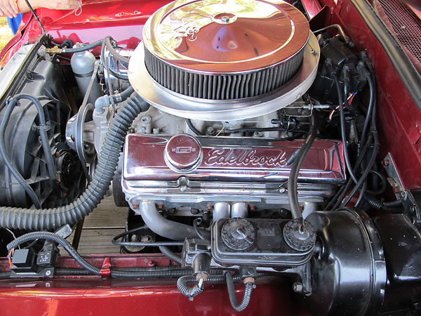

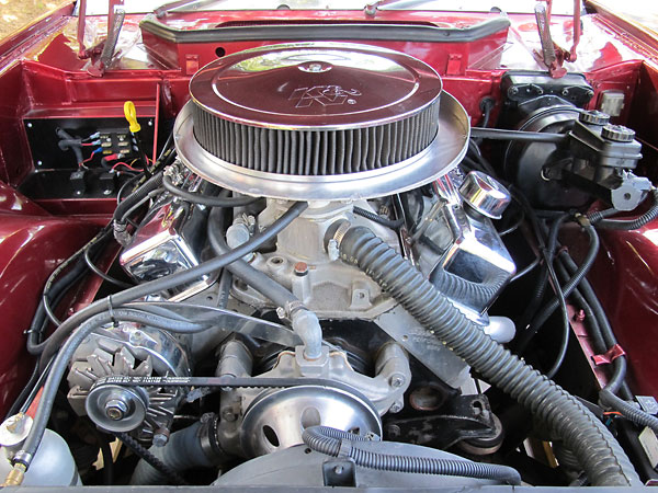

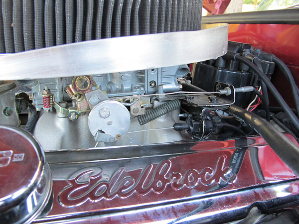

Holley 750cfm double-pumper carburetor. Delco HEI distributor.
Sanderson mandrel-bent four-into-one headers: 1.625 inch primaries and 3 inch collectors.
Sanderson mandrel-bent four-into-one headers, with 1.625" primaries into 3" collectors.

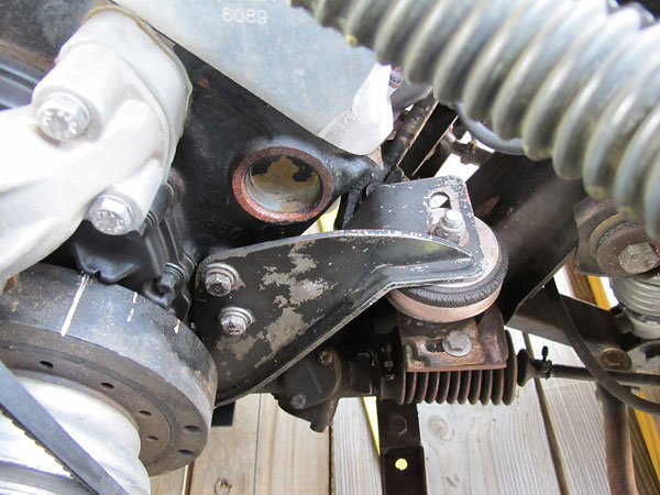

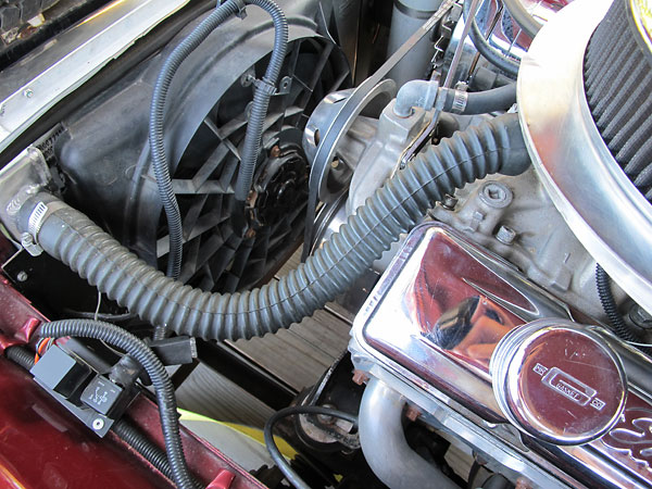

Large electric cooling fan, with shroud.

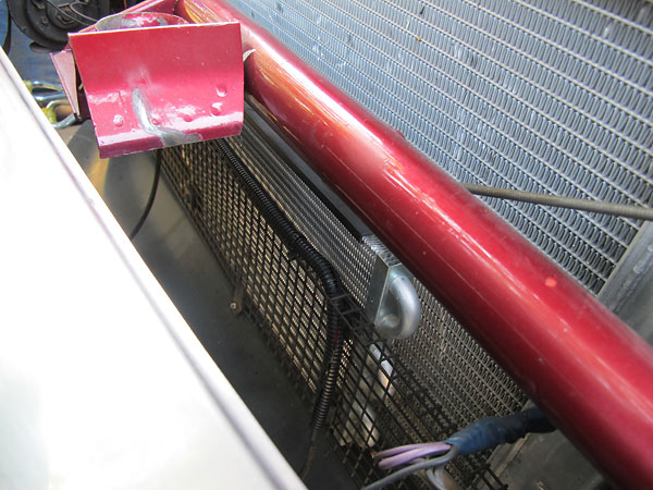

Transmission oil cooler.

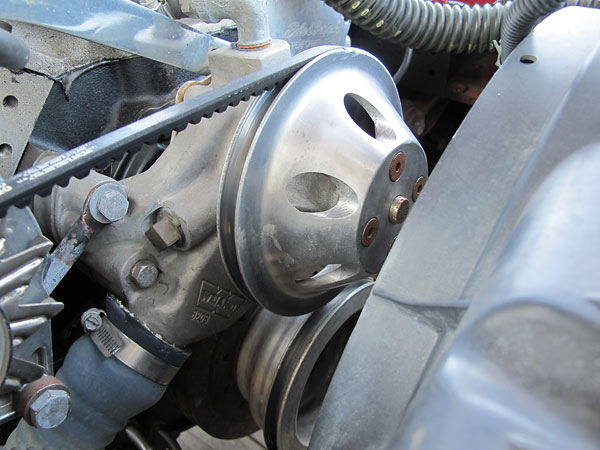

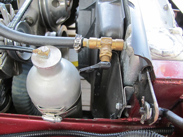

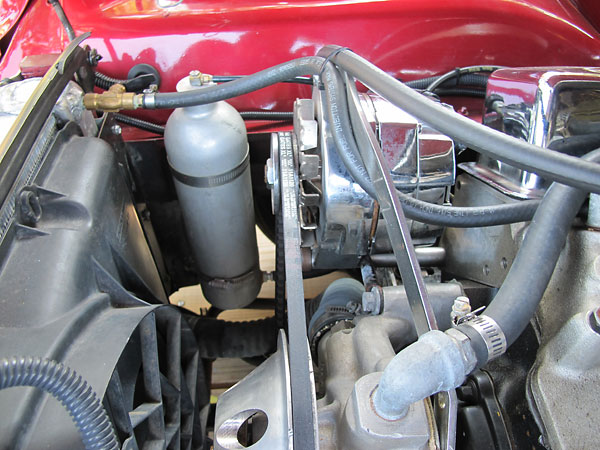

In an earlier life, this coolant system overflow bottle was a fire extenguisher.
The radiator's filler bung has been removed and blocked off.
Galen also installed a valve on the radiator's vent line.
Delco HEI distributor with Accel Super Stock Spiral Core spark plug wires.

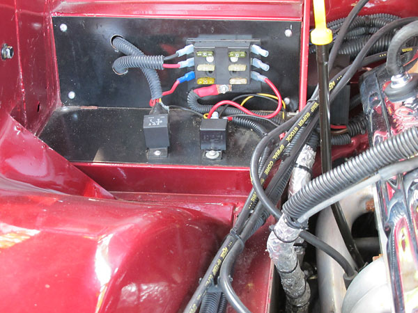

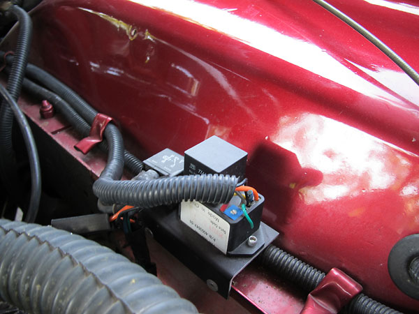

Fuse block and relays.

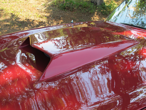

Delta Motorsports fiberglass replacement hood, with custom hood scoop added.

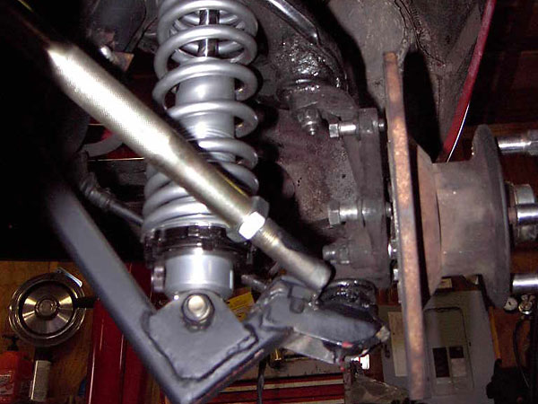

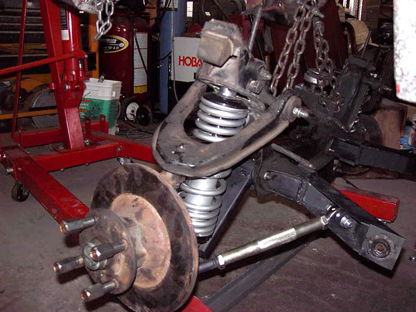

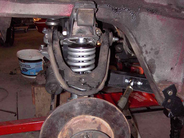

Front Suspension
Adjustable coilover shock absorbers.
Redesigned to utilize adjustable coilover shock absorbers, the front suspension features
specially fabricated lower control arms and also trailing links for easy caster adjustment.
Jensen Healey hub and brake rotor.
(Note: these in-process photos show the stock Jensen Healey hub and brake rotor,
not the special hubs and Wilwood brake Galen later updated the car with.)
The front suspenion mounts to the engine cradle / front subframe.

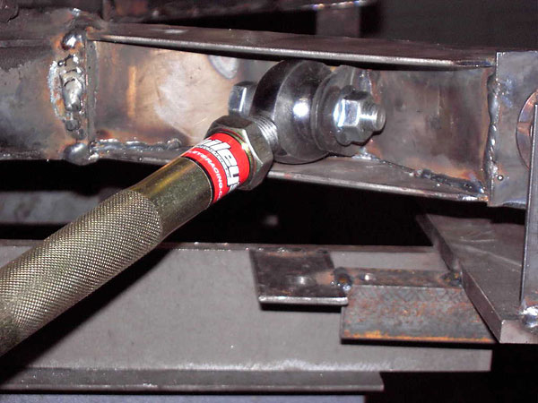

Adjustable link from Smiley's Racing Products.

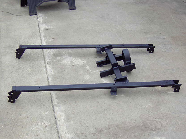

Rear Suspension

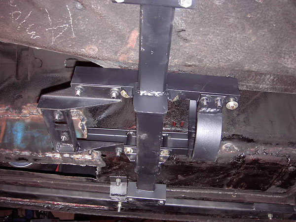

Crossmember/transmission mount/driveshaft loop assembly.
Subframe connectors, shown with but not connected to the crossmember/transmission mount/driveshaft
loop assembly. (The angle you see between these components in the photo is misleading.)
The driveshaft loop is an important safety feature.
The driveshaft loop (at right) is an important safety feature. If the event of a broken
universal joint, its function is to keep the driveshaft from swinging wildly.

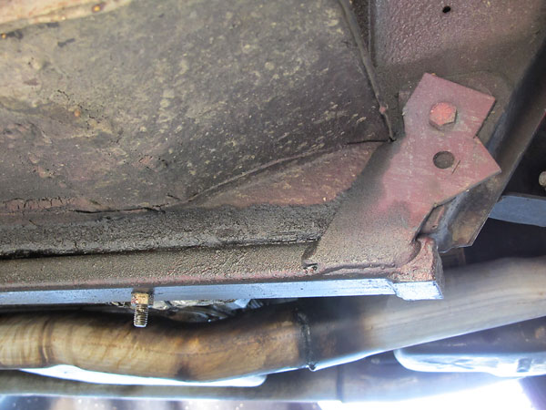

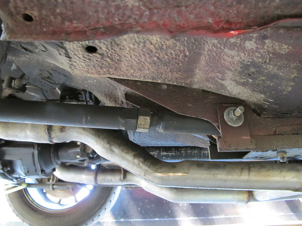

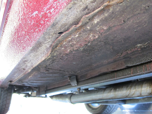

Subframe connectors reinforce a chassis that wasn't originally designed for so much engine torque.
The subframe connectors extend all the way to the rear suspension.

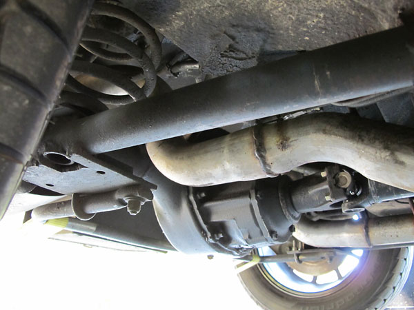

Galen upgraded his rear suspension by making these trailing lengths adjustable.

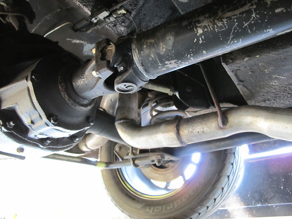

Ford nine inch rear axle with Eaton Truetrac limited slip differential and 3.70:1 gears.
The rear anti-sway bar is stock, but it's been flipped around 180 degrees for exhaust clearance.

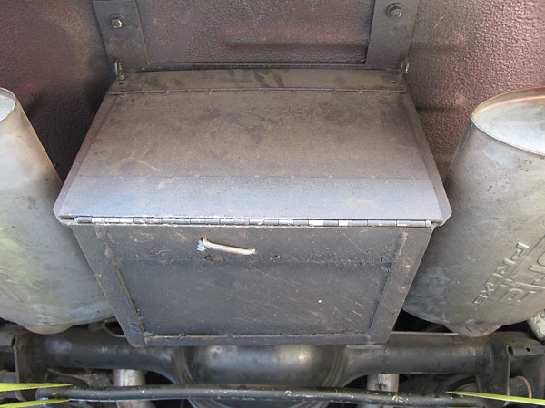

Battery box.
Battery box.
Dual Borla Pro XS mufflers.

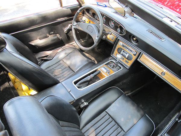

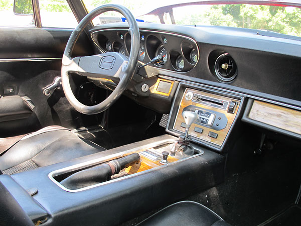

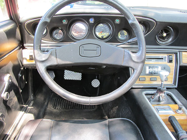

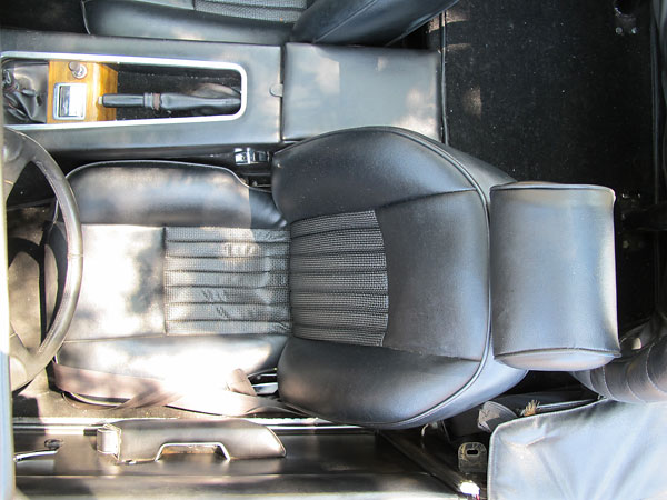

Almost entirely stock Jensen Healey interior.
You can't tell from here, but the tunnel has been widened to suit the 700R4 automatic transmission.
Original Jensen healey ergonomic steering wheel.

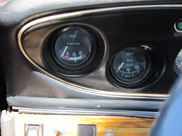

Original Smiths voltmeter and oil pressure gauges.

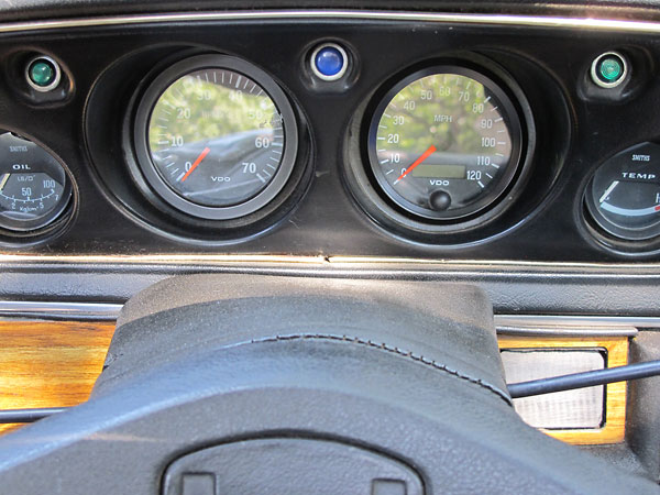

Original Smiths temperature and fuel level gauges.

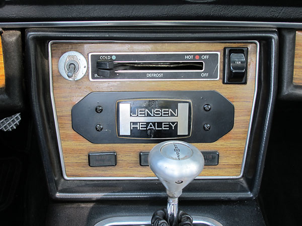

Rare stereo delete option.

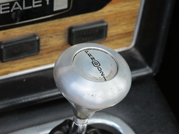

Lokar gear selector knob.

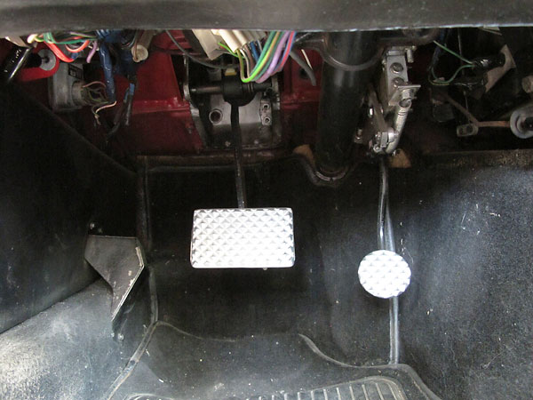

Galen made his own pedal pads.
Stock Jensen Healey seats.

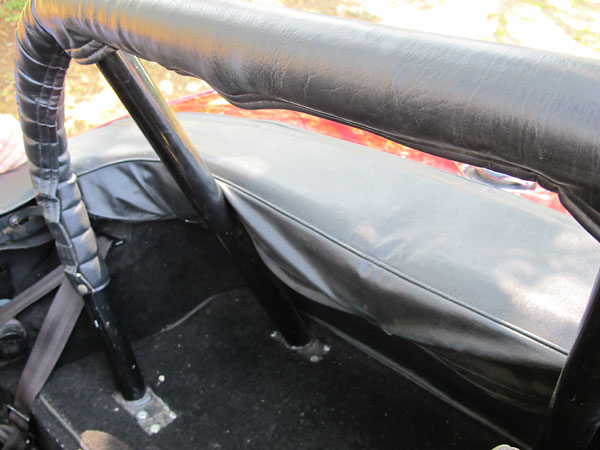

Delta Motorsports roll hoop.
Jazzy
Ships and cars have traditionally been given names. This one is named "Jazzy".

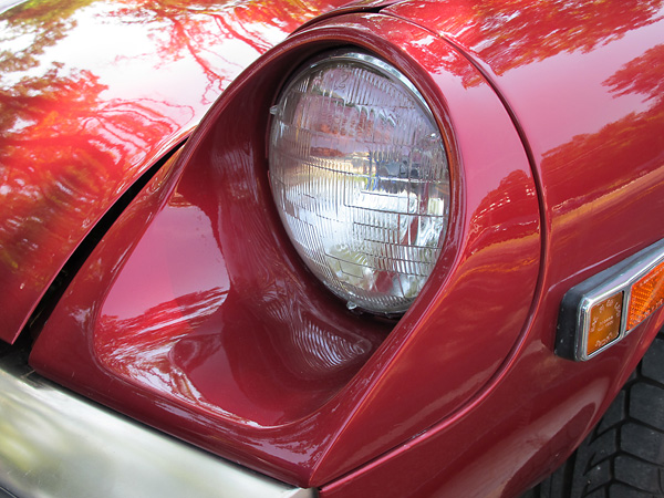

Jensen Healey headlight bucket.

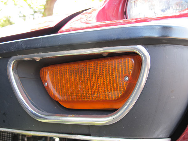

Jensen Healey front turn signal lens.

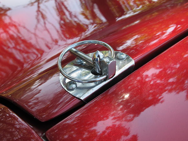

Hood pins on a Jensen Healey.
Galen has used hood pins to hold his hood down ever since having a hood release fail
on a quarter-mile acceleration run. Luckily, the safety catch worked that first time.

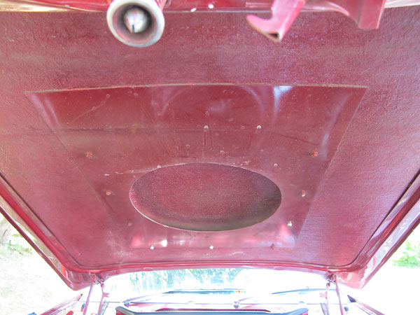

Galen put a lot of time and attention into fitting this hood scoop.
Note how the profile of the hood scoop's leading edge has been echoed in the surface below.

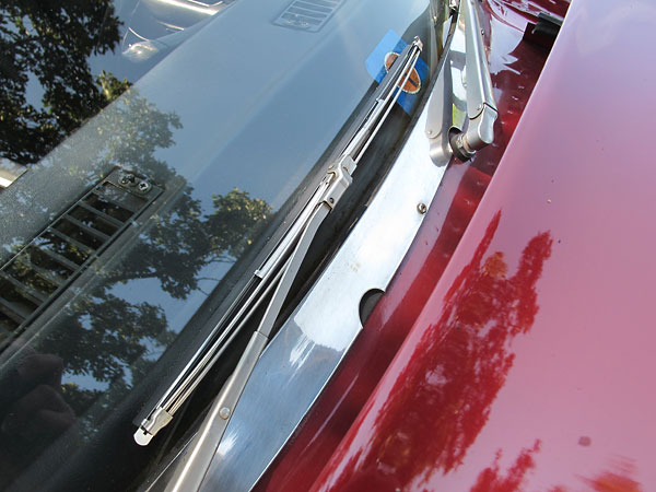

Stainless steel windshield wiper arms.

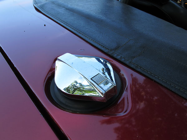

Jensen Healey fuel filler cap.

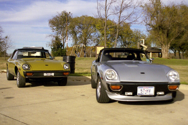

Jensen Healey with Chevrolet 4.3L V6 engine... plus Jody Garcia's Jensen Healey
The gold car is "Jenny mouse," Galen Hazen's first Jensen Healey into which he originally
installed a Chevrolet 4.3L V6 engine and a 700R4 automatic transmission. It would later
be upgraded with a Chevy ZZ4 V8 (as shown above). The silver car is Jody Garcia's 400
cubic inch small block Chevy powered Jensen Healey (also with 700R4 transmission.)
