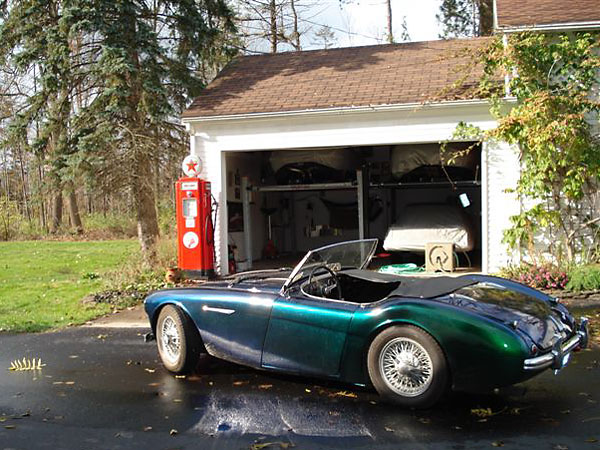

Fred Schade's 1955 Austin-Healey 100 with Chevy 305 V8 engine

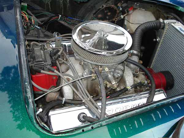

Fred Schade's 1955 Austin-Healey 100 with Chevy 305 engine

Owner: Fred Schade Jr.
City: Buffalo, NY
Model: 1955 Austin-Healey 100
Engine: Chevy 305cid V8

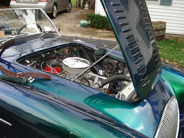

Engine: Chevy 305cid V8 with HEI ignition. It's getting a 350 crate motor this winter.
Induction: Air gap manifold with Edelbrock 650 Performer carburetor.

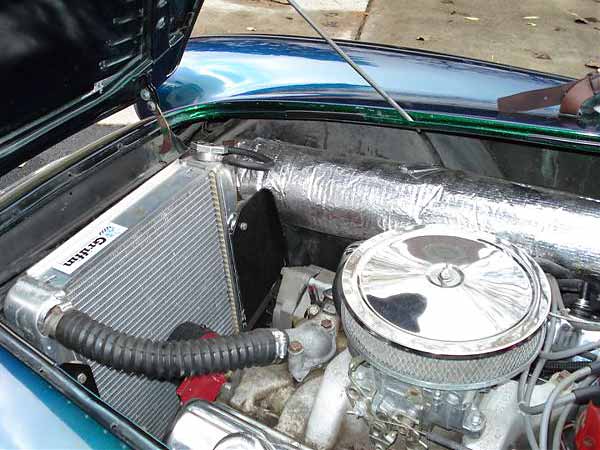

Cooling: Griffin aluminum radiator, electric water pump, and electric cooling fan.

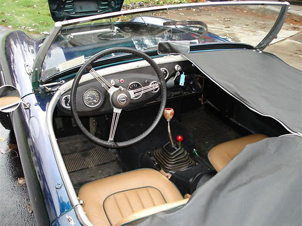

Transmission: Borg-Warner T10 4-speed.
Clutch: stock old-style with Healey pedals, cast iron bell housing cut to work through the lower left.
Driveshaft: Chevy.

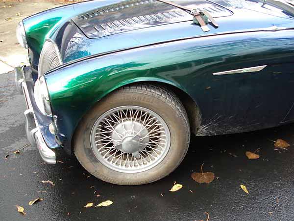

Body Mods: louvered hood, slightly flared fenders, and blue/green swfx color change paint.
Interior: Stewart Warner gauges. No audio.
Comments: I bought the car in 1979 as a dragster and have worked on it on and off for 25 years. A wile back, I decided to get serious and get it on the road. So, I took it to Richard Dawson in Perry NY and had him help with it. The body and paint are all his work. It's been driven about 3000 miles since completion in August 2006. This car has probably always been a race car of some sort. It has sockets for a removeable roll bar. I have an hour commute to my business and love driving it any time weather permits.
Chevrolet 305
Griffin radiator and chromed air cleaner
HEI distributor
louvered bonnet
four speed shifter

color change blue/green paint
spoke wheels

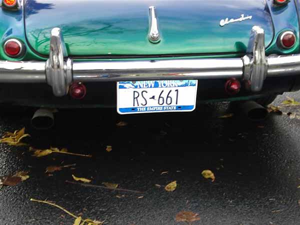

dual exhaust
