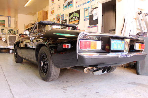

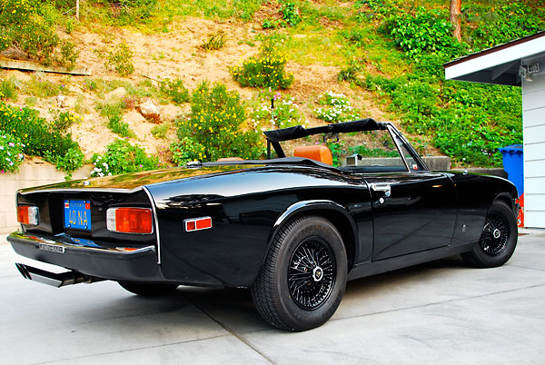

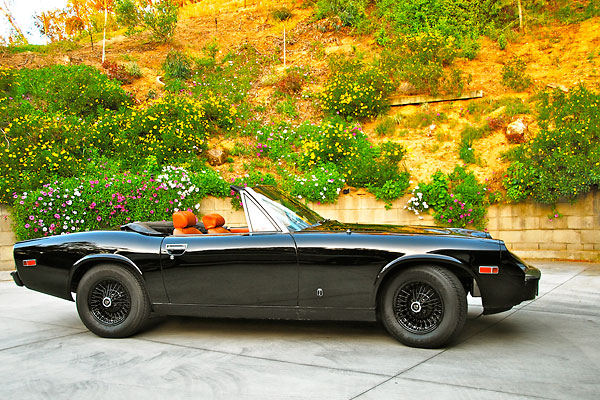

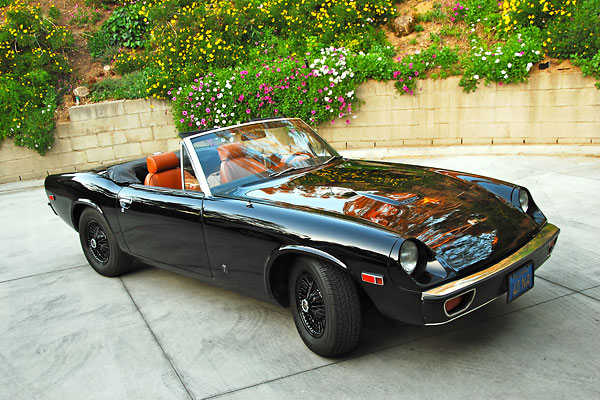

Ernie Vicencio's 1974 Jensen Healey / Rover V8 Conversion
Ernie Vicencio's Rover V8 powered 1974 Jensen Healey

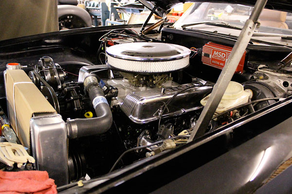

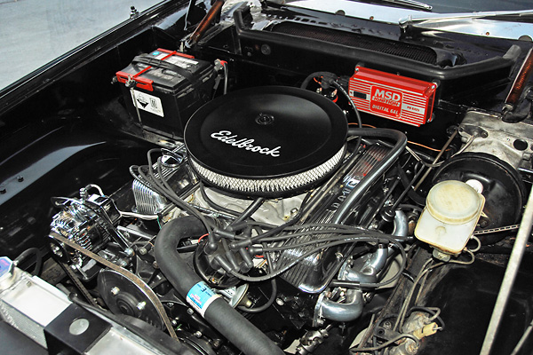

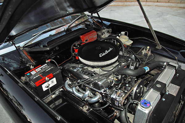

Engine: Rover 3.5L V8, rebuilt by Engine Parts Service of Whittier California. Stock camshaft. Ported cylinder heads. Offenhauser "John Woolf Racing" intake manifold, part# 7001-DP. Holley 390cfm carburetor. Edelbrock air cleaner. Lucas distributor. Pertronix Ignitor breakerless ignition. MSD Digital 6AL controller, part# 6425. MSD Blaster 2 ignition coil. Taylor 7mm spark plug wires. Wix oil filter.
Cooling: Griffin crossflow aluminum radiator. Electric fan.

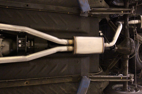

Exhaust: D&D Fabrications four-into-one block-hugger headers. Magnaflow mufflers (two, in series).

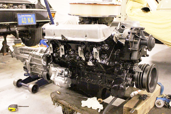

Transmission: Borg-Warner T5 manual transmission. Chevy bellhousing. Steel bellhousing adapter plate. Hydraulic throw-out bearing.

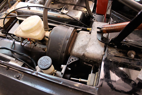

Brakes: (master) stock tandem master cylinder, with booster.

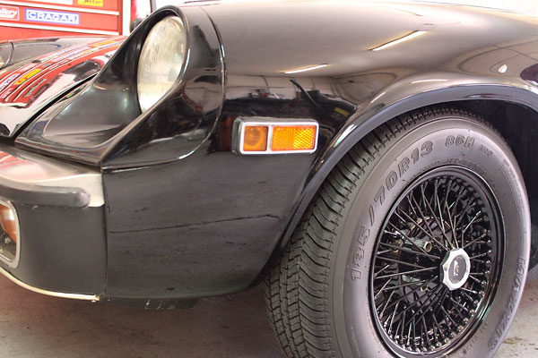

Wheels/Tires: Dunlop direct bolt-on wire wheels, powdercoated black. Maxxis Radial 185/70/13 tires.

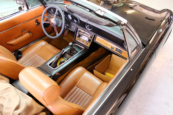

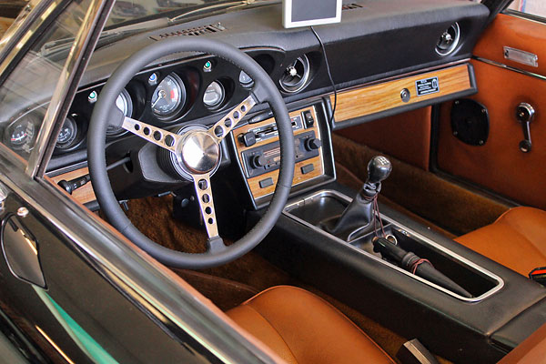

Interior: new (aftermarket) steering wheel.
Instruments: stock.

Rover 3.5L V8 rebuilt by Engine Parts Service of Whittier California.
Offenhauser John Woolf Racing intake manifold, part# 7001-DP. Holley 390cfm carburetor.

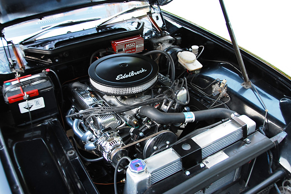

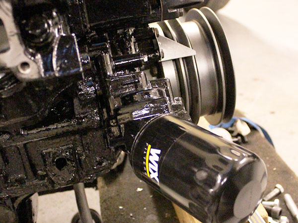

Wix oil filter.
Wix oil filter.

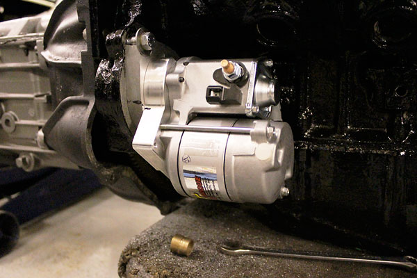

IMI Performance Products Hi-Torque gear reduction starter.
IMI Performance Products "Hi-Torque" gear reduction starter.

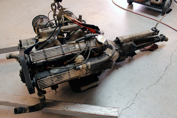

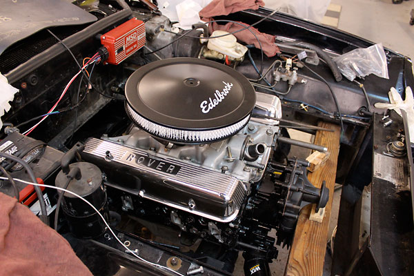

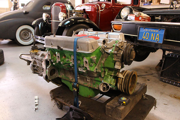

Underneath all that black paint, there's a shiny aluminum engine.
Underneath all that black paint this is a shiny aluminum engine.
Before it was painted black, it was painted green.
Transmission adapter plate.
An adapter plate permits bolting a Chevy bellhousing to the Buick-style bolt pattern.
Note also that this particular Borg Warner T5 transmission has a short bellhousing-
to-shifter dimension: it probably came out of a Chevy S10 pickup truck.

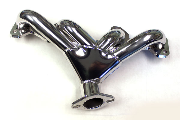

Modified D&D block hugger headers: flanges added and then ceramic coated.
Brake booster and tandem master cylinder.

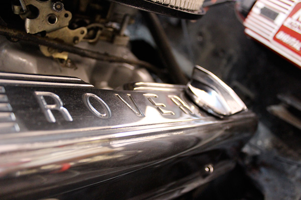

Polished aluminum Rover valve covers.

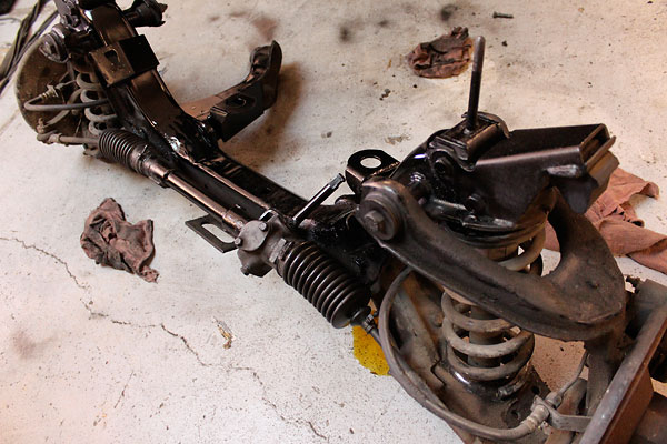

Front Suspension
Stock Jensen Healey independent front suspension.
Telescoping shock absorbers.

Magnaflow muffler.
The Jensen Healey rear suspension features a wishbone upper link and two trailing lower links.
The wishbone keeps the rear suspension centered, so no Watts linkage or Panhard bar is required.
The suspension's roll center is rather high by design: it's at the point where the wishbone
connects to the top of the axle housing. Note also the two Magnaflow mufflers in series.

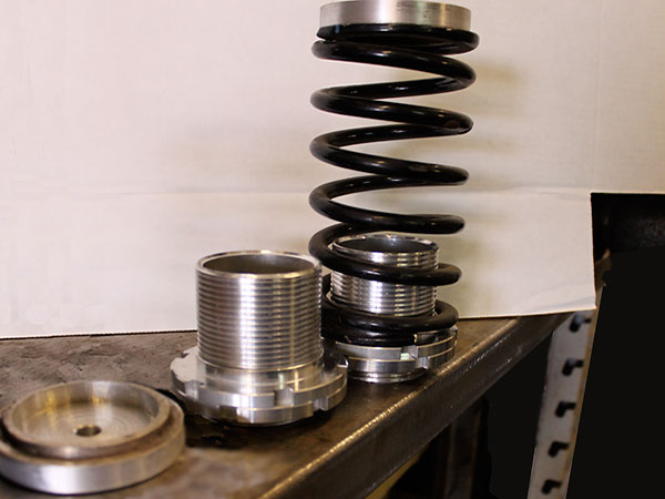

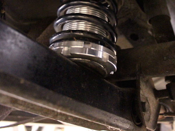

Jensen Healeys have large diameter rear springs mounted on simple non-adjustable perchs.
Original Jensen Healeys have larger diameter rear springs mounted on simple non-adjustable perchs.
Smaller, lighter coilover-style springs and threaded perchs to facilitate fine-tuning ride height.
(Shock absorbers are mounted in the usual Jensen Healey position: outboard, behind the axle.)
Limeworks Speedshop installed a Sprint Car Style steering wheel.
Limeworks Speedshop installed a "Sprint Car Style" steering wheel.
This handsome, understated interior is original to Ernie's Jensen Healey.
Ernie and his wife have owned the car since it was new.

The Rover 3.5 V8 fits nicely under a Jensen Healey's low, low hoodline.
The Rover 3.5 V8 fits nicely under a Jensen Healey's low, low hoodline. This is the car Jensen
should have built in the first place. It's the car they would have built if they could have.
