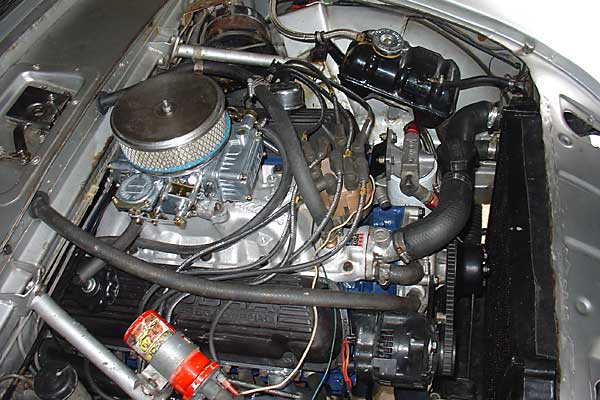

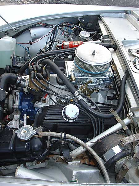

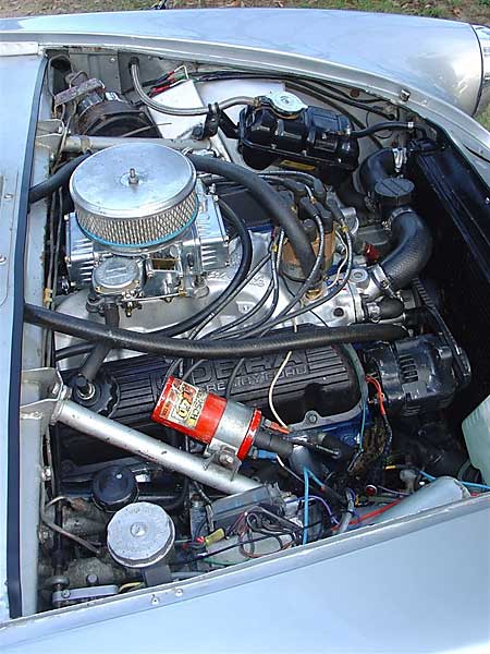

Engine: Ford 302 V8 (rebuilt 2007)
Conversion performed by: Previous owner.
Engine Mods: a total engine rebuild has just been completed, with new rings, bearings, re-ground crank, honed cylinders, etc.
Intake: new Holley 600cfm (center float) carburetor and Edelbrock "Performer RPM" manifold.
Cooling: a modified (shortened) water pump pulley and new alloy water pump have been fitted.

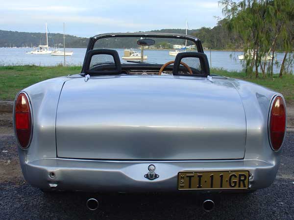

Exhaust: ceramic coated headers.

Body: custom fender flares. Mercedes silver paint.

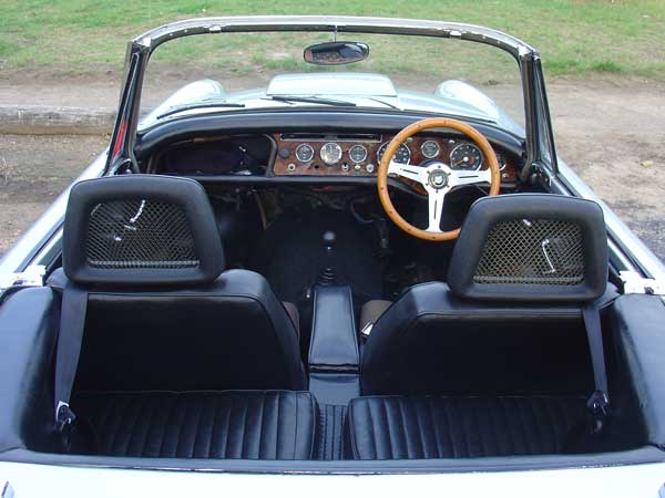

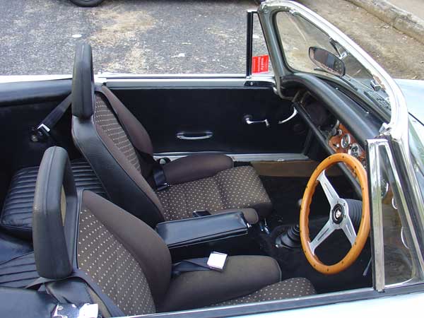

Interior: Recaro seats.
Holley 600cfm center-float carburetor / Edelbrock Performer RPM manifold
modified shortened water pump pulley / new alloy water pump

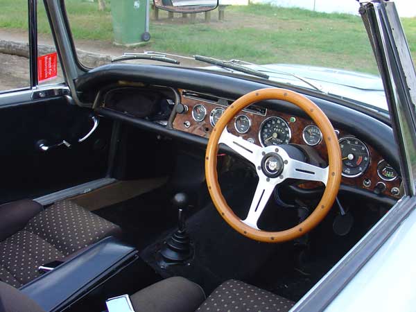

Sunbeam custom wooden steering wheel
Recaro seats
Leather upholstery and trim
TIIIIGR

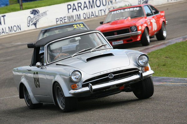

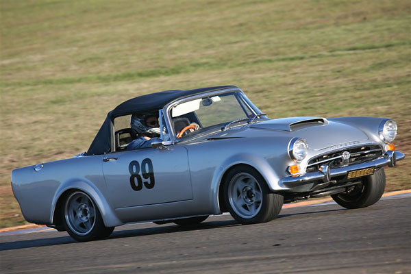

custom fender flares for Sunbeam Alpine and Tiger
Photos from The Festival of Sporting Cars, at Oran Park
Sydney Australia, June 14, 2008
Oran Park Festival of Sporting Cars
David Petrikas at Oran Park Race Track
Oran Park Racetrack
Mercedes silver paint on David's Sunbeam Alpine
