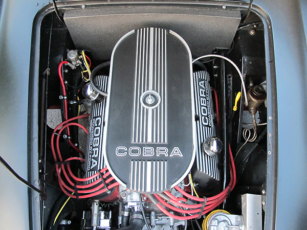

Engine: Ford 302
Conversion by: unknown

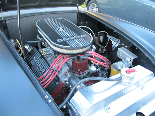

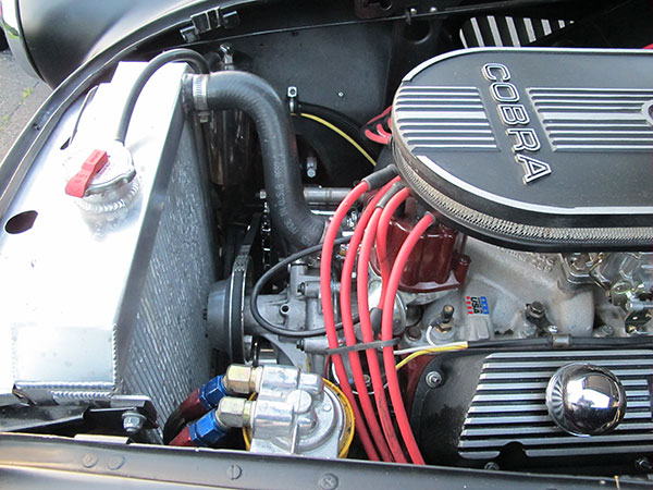

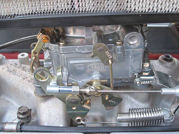

Engine: Ford 302 High Output engine from a 1985 Mustang Cobra, rated 235 HP stock. Edelbrock Performer 289 intake manifold. Edelbrock Performer 500CFM carburetor. Cobra black finish oval air cleaner. Pertronix Flame-Thrower distributor. Pertronix Flame-Thrower 0.6 Ohm ignition coil. Ford Racing spark plug wires. Purolator PureONE PL30001 oil filter, mounted remotely.
Cooling: custom built aluminum radiator. Oil cooler. Custom ducting in grille area.

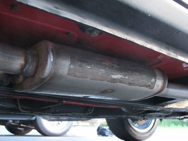

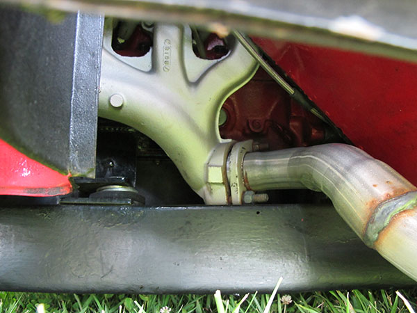

Exhaust: manifolds from 351 Cleveland (similar to the manifold/header from the Shelby Hi-Po 289.) Dual Flowmaster mufflers. Side exhaust.

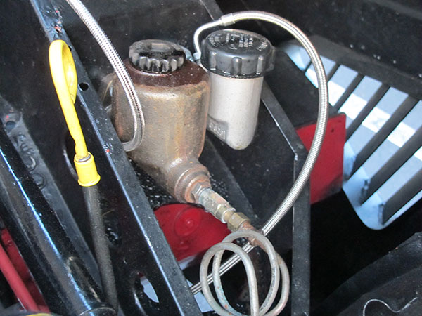

Transmission: T-5z 5-speed manual. Wilwood clutch master cylinder.

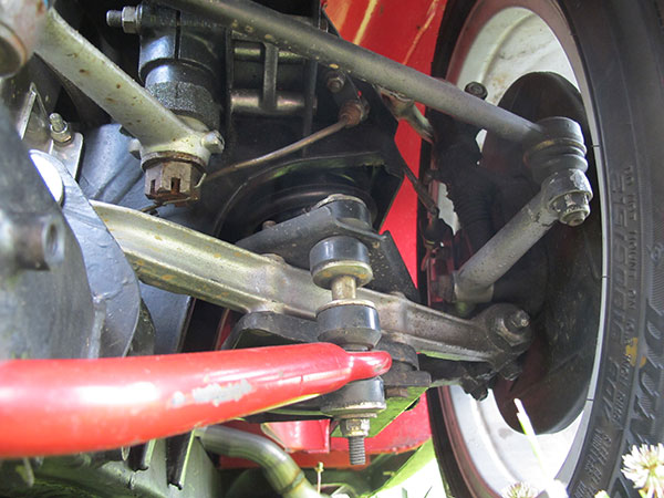

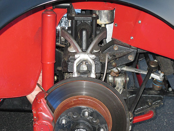

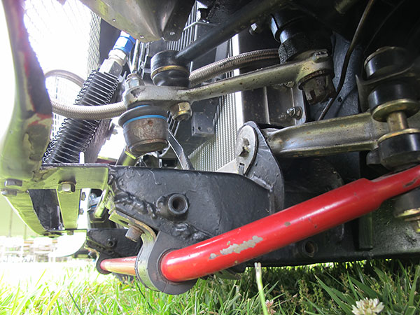

Front Susp.: tube shock conversion. Shorter, stiffer springs. 7/8" sway bar. Polyurethane bushings.

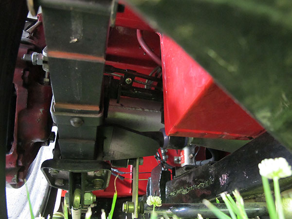

Rear Susp.: tube shock conversion. Uprated leaf springs. Traction bars. 5/8" sway bar.
Brakes: (front) stock Austin Healey disc brakes with ceramic pads.
(rear) disc brake conversion using Jaguar calipers (from Denis Welch in England).

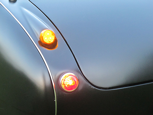

Electrical: Advance Auto Wire harness. Halogen headlights. LED brake lights. LED turn signals.

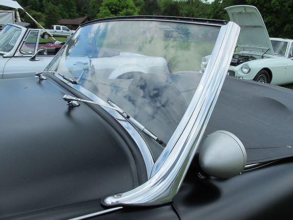

Body: removed bumpers. Custom diamond grille with smoothed and recessed opening. Enlarged hood scoop. Custom front fender louvers. Flared fenders. Shaved door handles. GT Classic side view mirrors. Smoothed rear valance. Hot Rod Black matte finish.

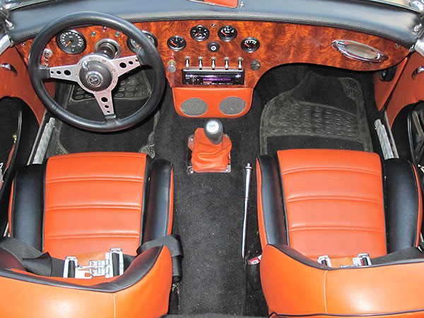

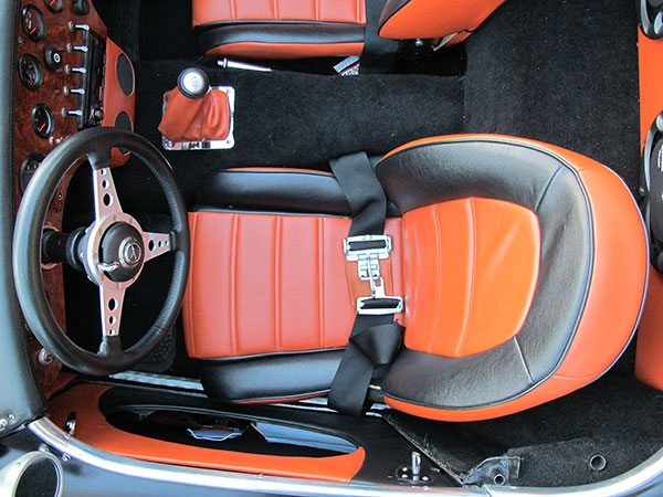

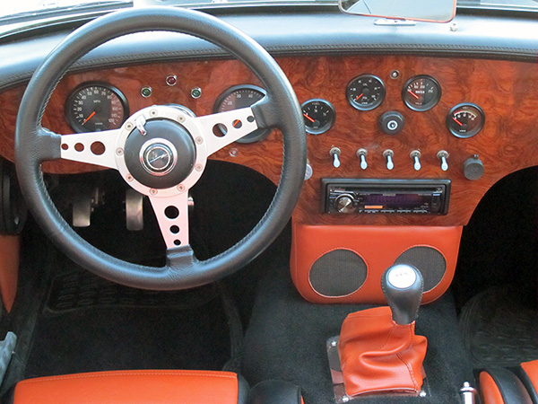

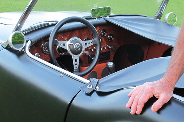

Interior: custom babinga wood dashboard. Mazda Miata seats (with headrests removed for lower profile to match rear cowl). Custom 2-tone upholstery. Leather wrapped 14" steering wheel. Kenwood stereo system.
Instruments: VDO gauges left-to-right: speedometer (0-120mph), tachometer (0-7000rpm), fuel level (E-F), oil pressure (0-100psi), coolant temperature (100-250F), and volt meter (8-16V).

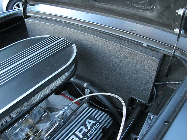

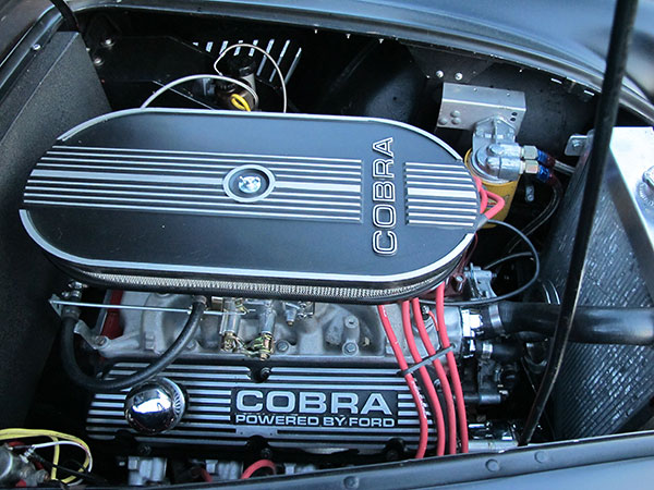

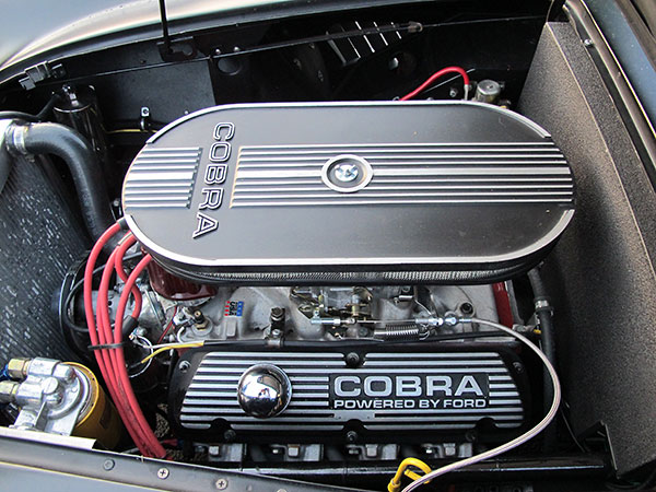

Fabricated cover for electric components and firewall passthroughs.
Stock brake master cylinder. Wilwood clutch master cylinder.

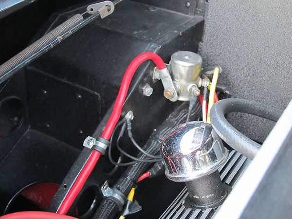

Ford-style starter relay.

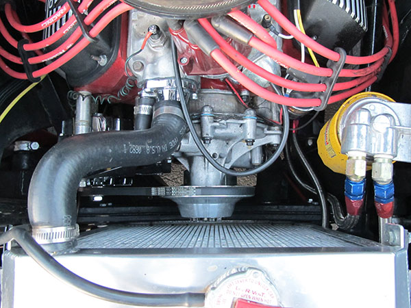

Custom built aluminum radiator.

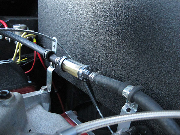

Old-school: glass fuel filter.
Manifolds from 351 Cleveland.

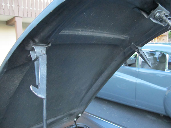

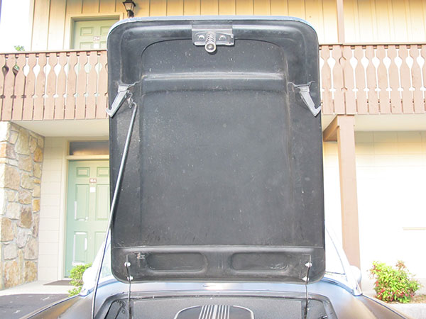

Bonnet and prop rod.
Bonnet safety catches.

Oil cooler.
Oil cooler.
7/8 inch sway bar. Polyurethane bushings
Tube shock conversion.
Traction bars.
Traction bars.

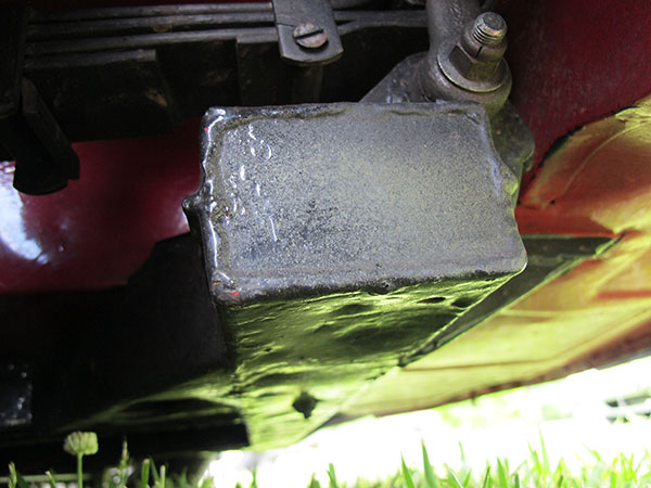

Rear leaf spring mount on frame.
Stock Austin Healey rear end.

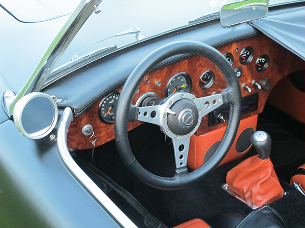

Custom wood dashboard crafted from an African hardwood called Babinga.
VDO speedometer and tachometer.
VDO gauges left-to-right: speedometer, tachometer, fuel level, oil pressure,
coolant temperature, and volt meter.

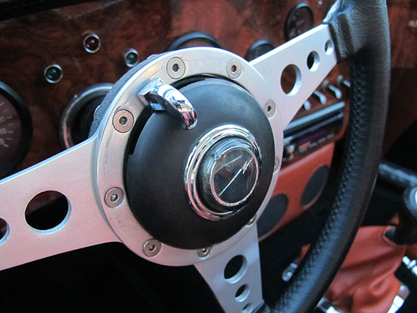

Leather wrapped 14 inch steering wheel.

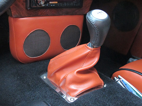

Custom fabricated and upholstered speaker console and shifter boot.

Mazda Miata seats with headrests removed for lower profile to match rear cowl.

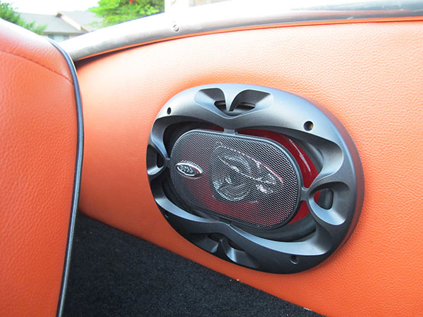

Triaxial 6x9 speakers.

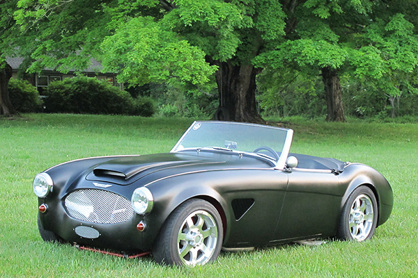

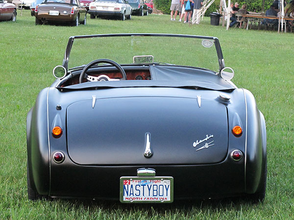

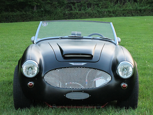

1960 Austin Healey 3000 (Mk 1, BN7).
1960 Austin Healey 3000 (Mk 1, "BN7").
Note: this is the rare two-seater version, as opposed to the four-seater.
Hot Rod Black matte finish. Custom front fender louvers.

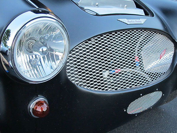

GT Classic mirror.
GT Classic mirror.

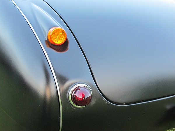

LED turn signals.
LED turn signals.
LED brake lights.
LED brake lights.

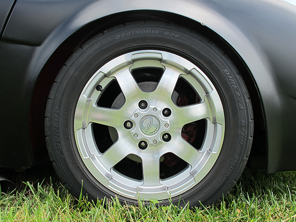

American Racing 7-spoke, 16x8 aluminum wheels.
Dunlop Direzza DZ101 tires (front 215/50-16 and rear 225/50-16).
