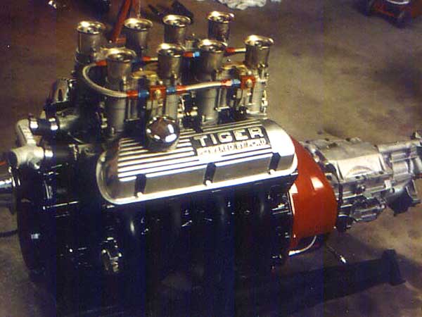

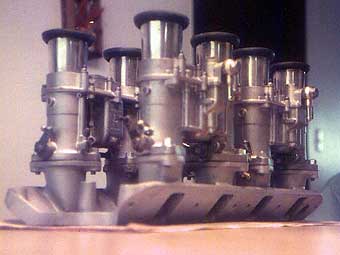

downdraft webers with velocity stacks
To help move T-GRRR down the road I put together, with the help of Ted King of Portland's Larson and King fame, a 322 cu. in. stroker motor using a Boss Ford 302 block with 4 bolt mains. Increased stroke is via a Reath crank connected to Boss rods and modified TRW flat-top pistons. A Crower roller-tappet cam featuring 292 degrees duration and 0.597" lift opens 1.94" intake and 1.60" exhaust valves in a set of Ted's ported 351W heads with Pro Magnum roller rockers.
velocity stacks on downdraft webers

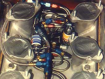

Weber IDA48 carburetors   NOS direct port nitrous system with fogger nozzles
Induction is via a synchronized set of 4 Weber IDA48 carburetors.
Hard to see with the carburetors mounted is a NOS direct port nitrous system with fogger nozzles.

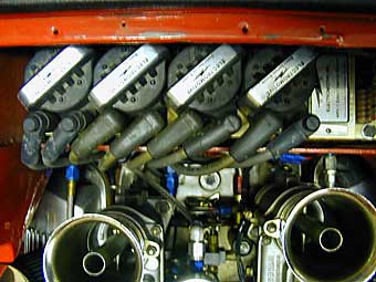

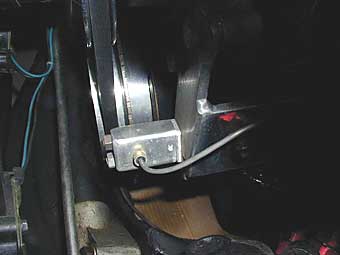

Electromotive direct ignition coil pack   custom crank trigger for Electromotive direct ignition
Remove the polished aluminum panel and beneath lies the coil pack.
Fire comes from an Electromotive distributorless, direct fire unit with a custom crank trigger.

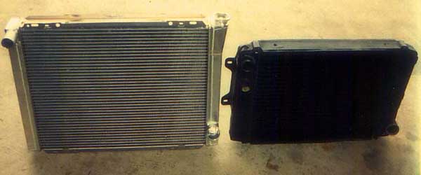

oversized aluminum radiator
Oversized aluminum radiator is shown next to the inadequate 4 row "fat core" it replaced.

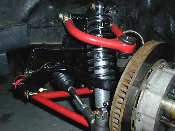

Tiger coilover IFS
coilover front suspension for Tiger
Adjustable coilover IFS with tubular A-arms and improved Ackerman angle.

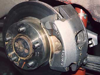

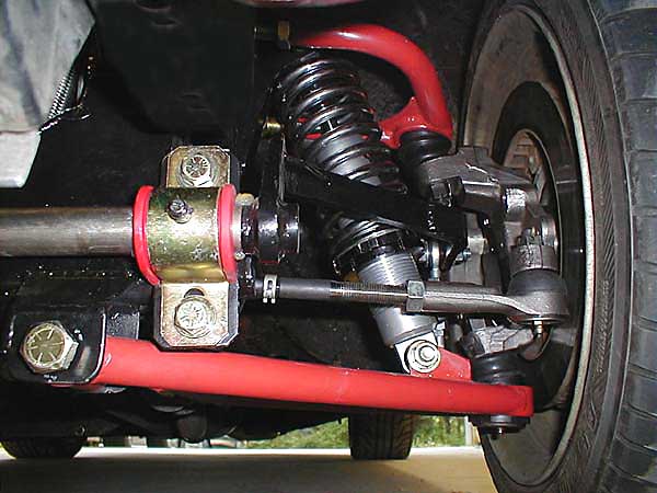

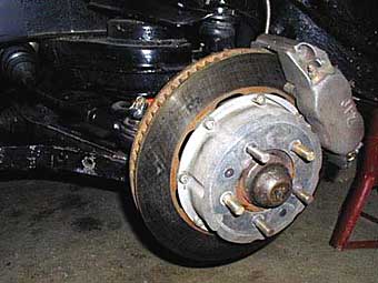

JFZ 4-piston caliper Ford Granada caliper
I decided the brakes could be improved so I changed the fronts to JFZ 4-piston calipers with 12-1/8" rotors.
At the rear, Ford Granada calipers provide a cable-operated parking brake.

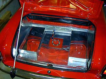

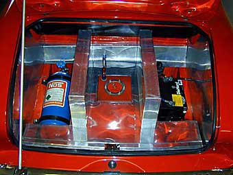

polished aluminum panels   NOS bottle / Harwood fuel cell
Opening the polished aluminum panels in the trunk reveals the locations of the NOS bottle and battery flanking the Harwood fuel cell.

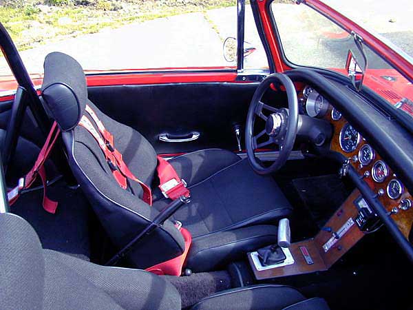

Huntmaster recliners
Huntmaster recliners flank a custom console.

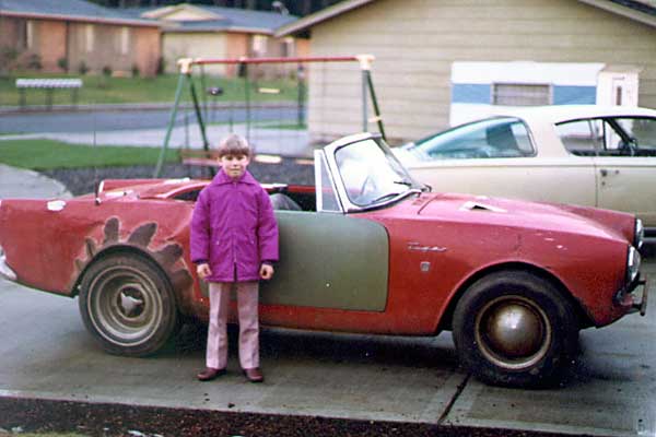

Autumn 1973
The car was originally purchased in the Autumn of 1973. VERY rough, but a Sunbeam Tiger I could afford.
The previous owner told me the car had been in an end-over-end accident.
