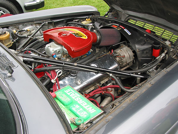

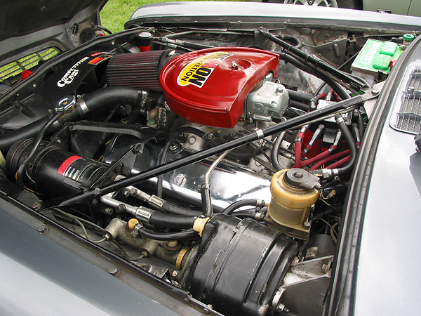

Engine: Chevrolet Big Block V8 (454cid)

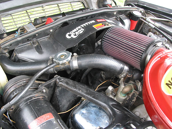

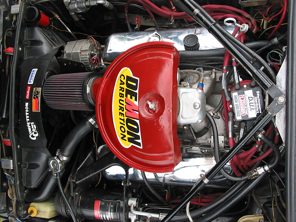

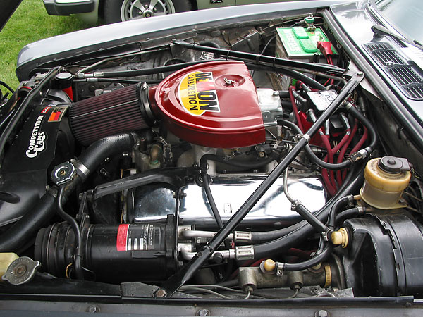

Engine: Chevrolet big block V8 (454cid) installed using a John's Cars "One Stop Deal" conversion kit (including radiator, headers, driveshaft, wiring, etc.). Edelbrock Performer Air Gap intake manifold and Barry Grant "Speed Demon" 750cfm carburetor. Competition Cams hydraulic roller camshaft (number 11-413-8). Performance Distributors brand "Street/Strip DUI" (Davis Unified Ignition) HEI distributor. Stock Delco-Remy alternator. K&N air filter (on custom-modified air cleaner housing.)
Cooling: larger radiator. Engine-driven cooling fan.

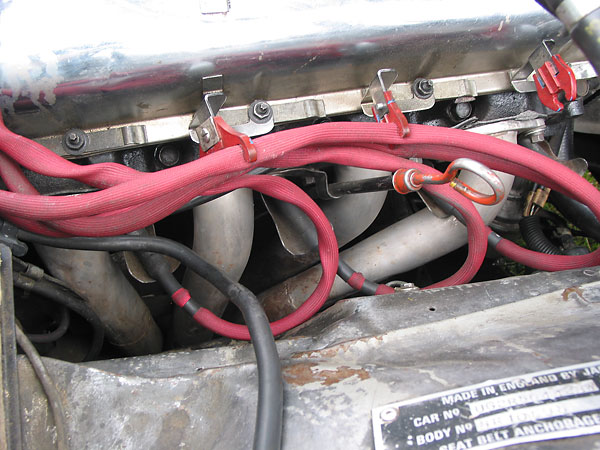

Exhaust: tubular headers from John's Cars Inc. in Dallas TX. Note: I cut the driver-side header into two and modified the header into a 2-piece design. (If a small block Chevrolet engine had been used, headers wouldn't have been required. For example, Chevy "Rams Horn" style iron exhaust manifolds could have been installed.)

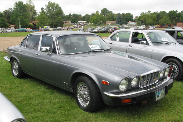

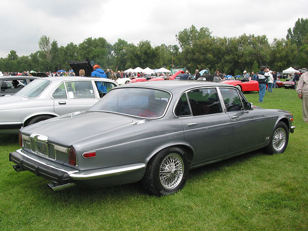

Wheels/Tires: 5-lug Dayton wire wheels with 215/65R15 tires.

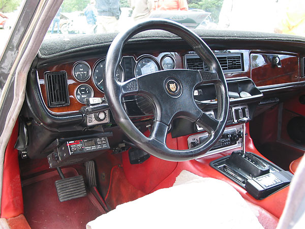

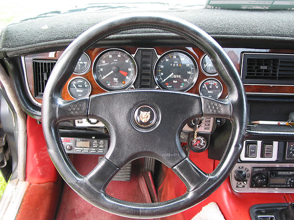

Interior: Momo steering wheel. The original Jaguar gear selector was only slightly modified to work with the GM automatic transmission. The air conditioning system works as well as new.
air conditioning compressor
K&N air filter (on custom-modified air cleaner housing).
engine driven cooling fan
Barry Grant Speed Demon 750cfm carburetor
Johns Cars headers

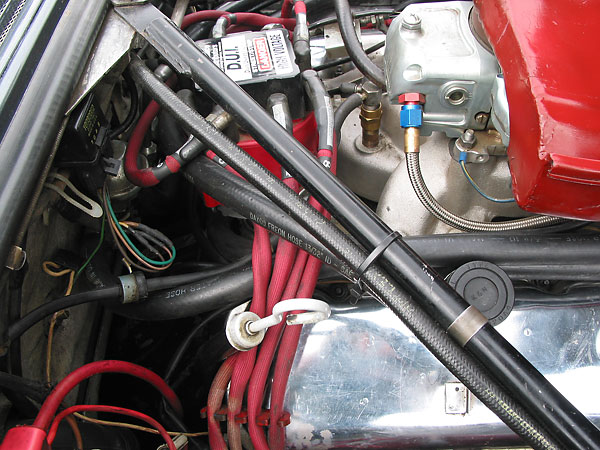

Performance Distributors brand Street/Strip DUI (Davis Unified Ignition) HEI distributor
Performance Distributors "Street/Strip DUI" (Davis Unified Ignition) HEI distributor.

Jaguar gear selector mates to Chevrolet 700R4 automatic transmission
The Jaguar gear selector was only slightly modified to suit the Chevrolet automatic transmission.
Momo steering wheel

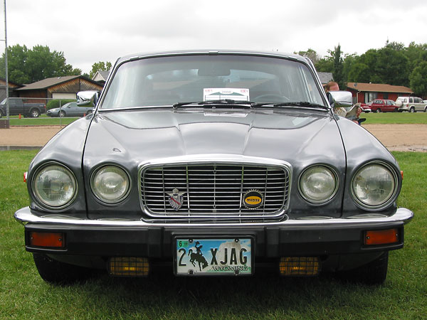

1976 Jaguar XJ12 grille
Seven inch headlights weren't offered in U.S.A. in 1976, but they were available in England and Europe
(so that's an easy upgrade). The grille's center bar was omitted to give a more elegant appearance.
Dayton wire wheels

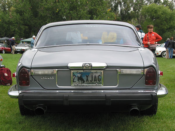

great big glass-pack mufflers
Several badges were removed to "clean up" the rear end. Darker red taillamp lenses have been installed.
