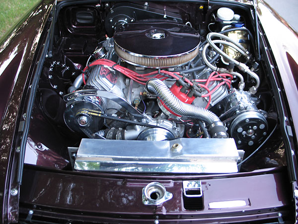

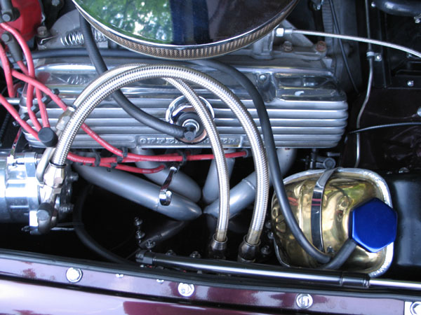

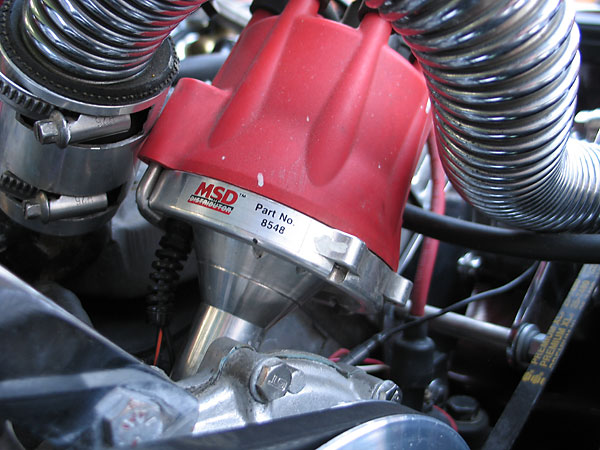

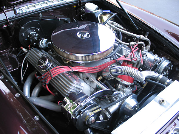

Engine: 1962 Olds 215, rebuilt to 266cid/4.4L with 10.3:1 static compression ratio. Buick 300 crankshaft (3.4" instead of 2.8"). 3.524" bore. (Pistons are TRW part number 464F.) Modified Buick rods. Ported Olds 215 cylinder heads with special upgraded valve springs (conical, undamped, 100# closed, 210# open.) Crower 280 camshaft (112 degree lobe center, 0.488/0.501 lift). Olds intake manifold with Edelbrock 1404 manual choke 500cfm carburetor. MSD Pro-Billet distributor (part# 8548). MSD6AL electronic ignition with MSD Blaster 2 coil (part# 8202). D&D Fabrications swivel oil filter mount. Offenhauser finned aluminum valve covers. The engine was built by Ron Hopwood.

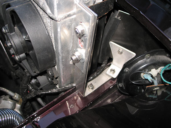

Cooling: custom Griffin radiator with four Spal electric fans (one large and two small fans mounted behind the radiator, plus one more fan mounted in front.) Buick 300 water pump.

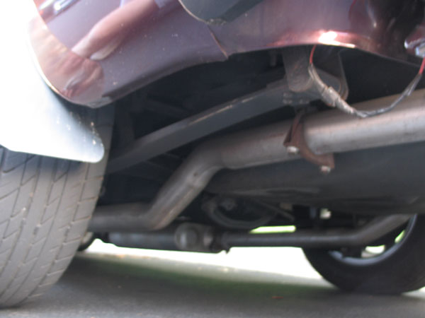

Exhaust: RV8 style through the fender four-into-one headers with 1 5/8" primaries, ceramic coated. 2.25" pipes with crossover, exiting on either side of the (centered) fuel tank. Flowmaster 50 series mufflers.

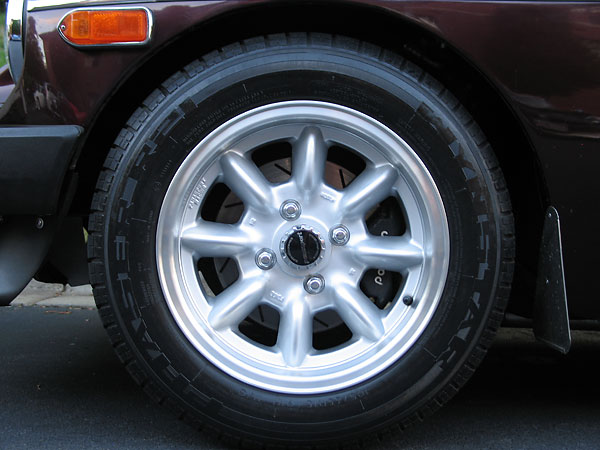

Wheels/Tires: Panasport 15x7 wheels with Wynstar Phaser R21 (195/65R15) tires.

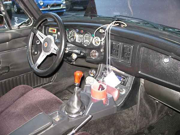

Instruments: stock, except for AutoMeter temperature gauge.
Interior: air conditioning. Miata seats. Mota Lita slotted leather steering wheel.

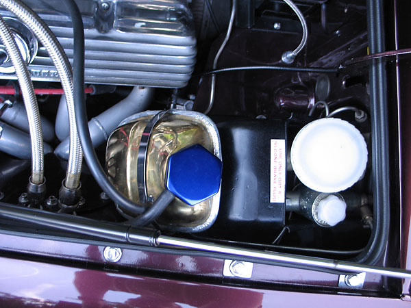

MG brass cooling reservoir.
Ceramic coated RV8-style headers.

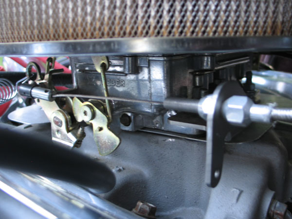

Weber/Edelbrock model 1404 500cfm carburetor.

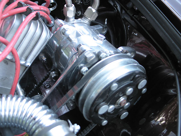

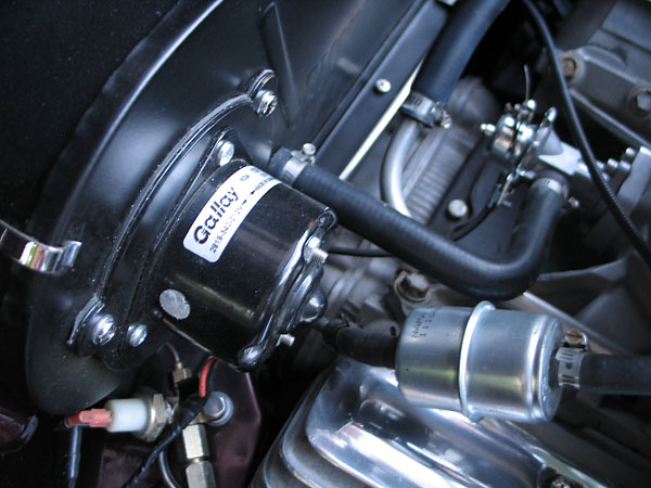

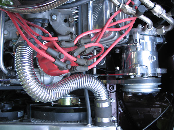

Sanden air conditioning compressor.
One large and two small Spal electric cooling fans, pulling.
MSD Pro-Billet Distributor (part# 8548)

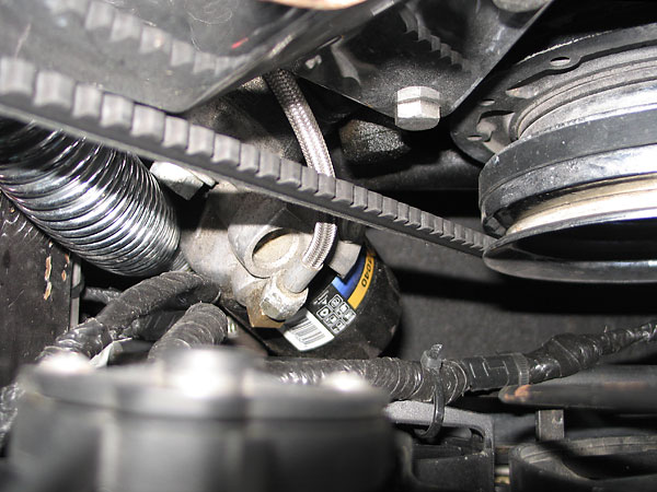

Custom Griffin aluminum radiator.

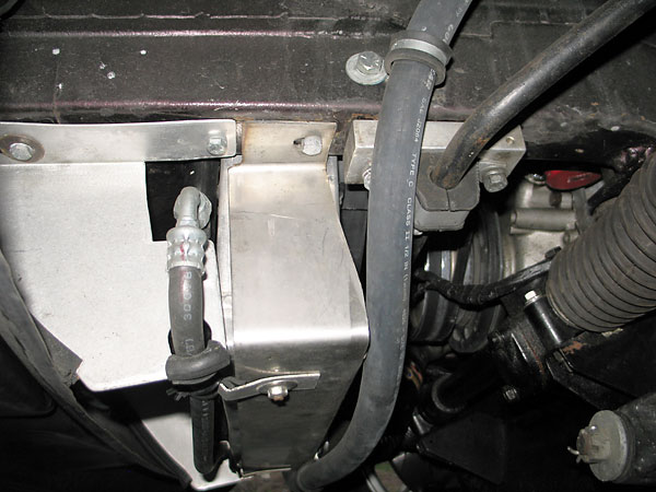

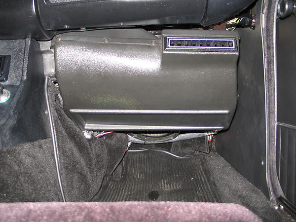

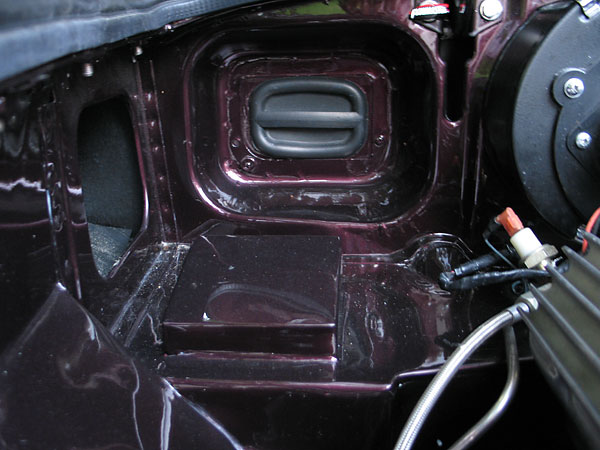

Passenger side footbox was modified to make room for air conditioning.

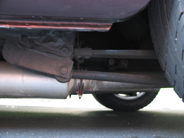

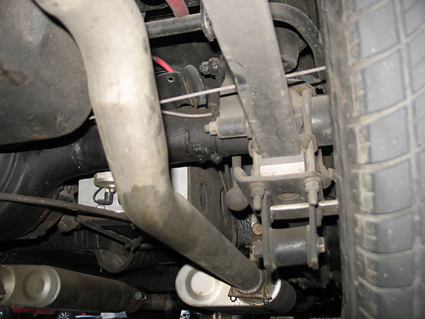

Anti-tramp bars.
Anti-tramp bars.

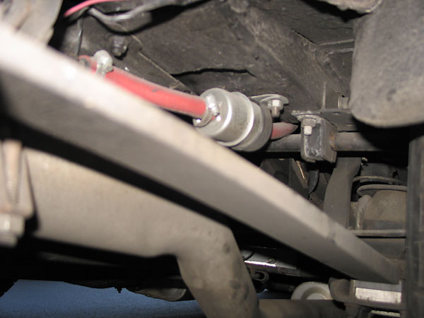

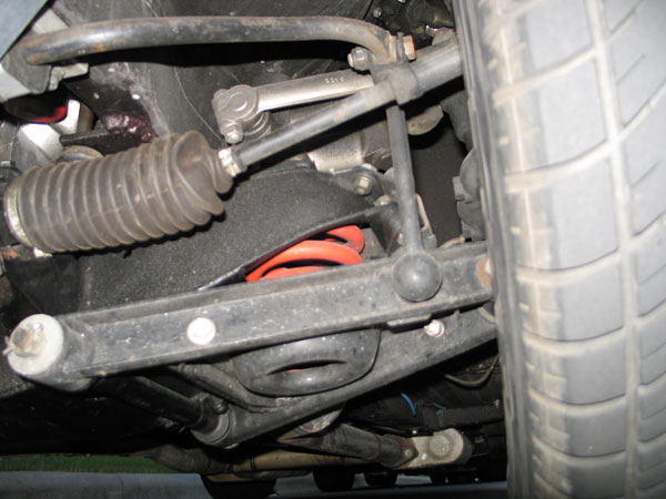

Rear anti-sway bar.
Rear anti-sway bar.
Rear anti-sway bar mounting bracket.

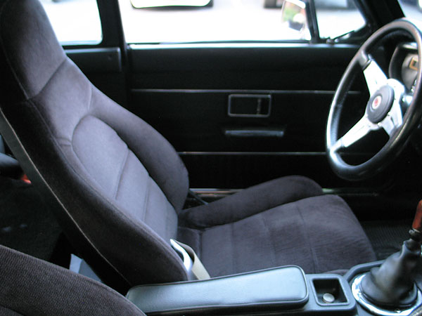

Miata seats.
Miata seats.

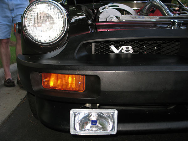

Driving lamps.
Driving lamps.

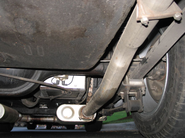

Centering the fuel tank facilitated dual exhaust.

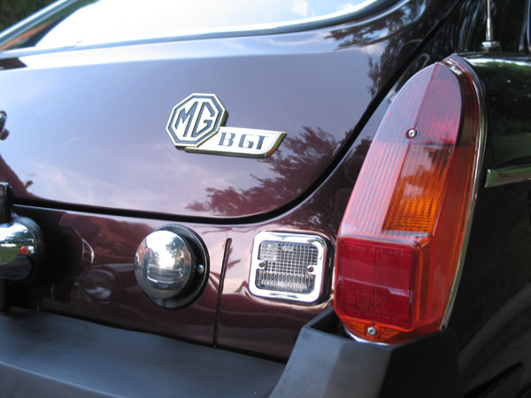

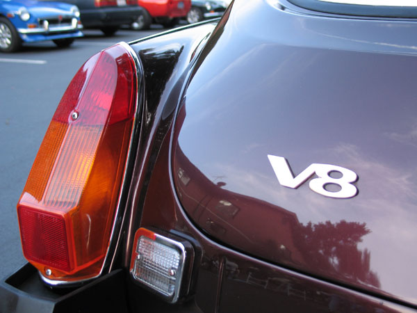

V8 badge.
V8 badge.

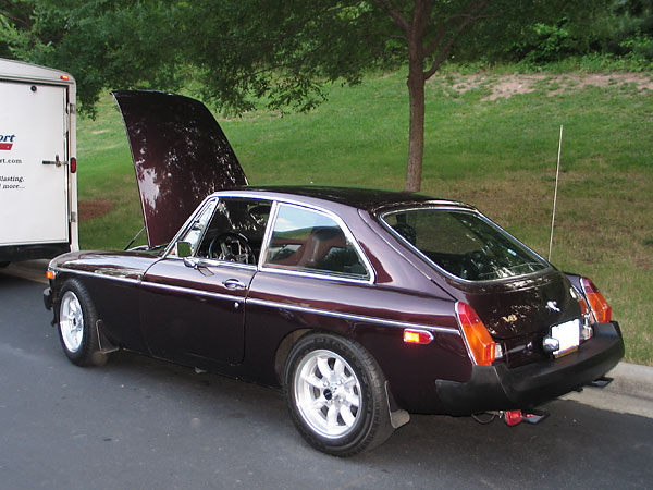

Rubber bumper MGB-GT's are comparitively rare in North America.

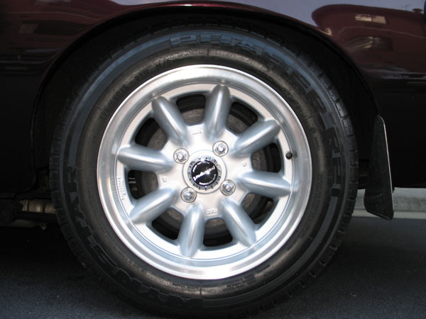

Panasport 15x7 wheels.
