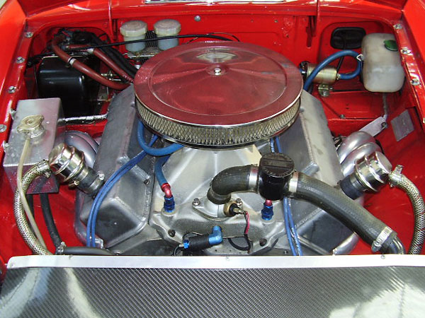

Engine: small block Chevy V8
Conversion by: Paul Knott

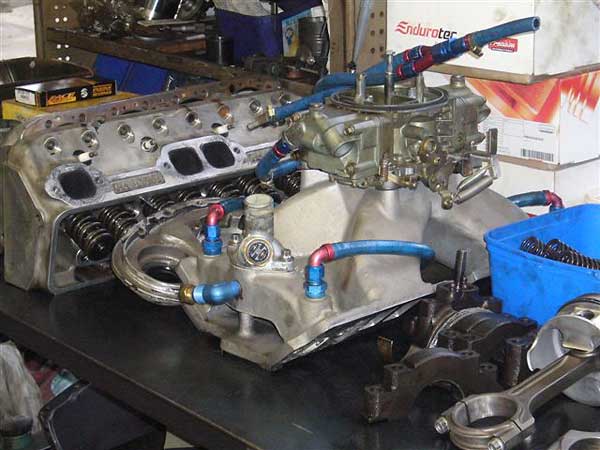

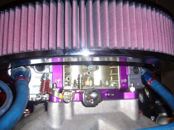

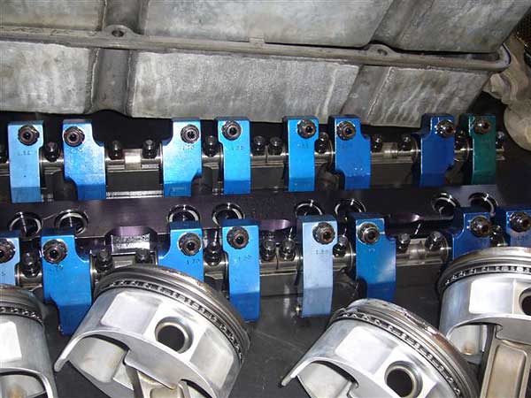

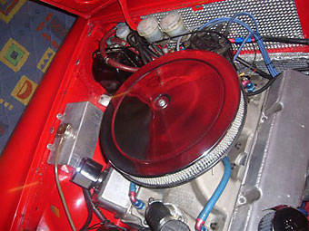

Engine: small block Chevy V8 (fully rebuilt since purchase) with 4-bolt mains, over-bored 0.040" and stroked to 383cid, 18 degree aluminium heads, Scat crankshaft, Crower I-beam rods, T&D shaft mount roller rockers. Clive Cams camshaft (360A, 332 lift-lobe, 246 degrees duration at 0.50"). Manley stainless valves. Edelbrock Victor Jr intake manifold. Proform 750cfm Race Series carburetor (with mechanical secondaries.)

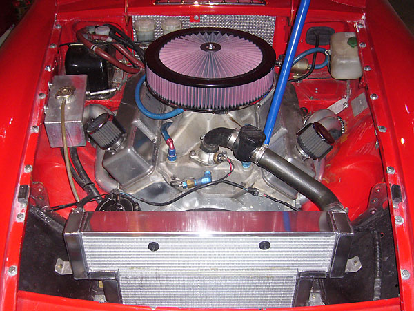

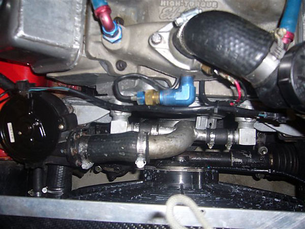

Cooling: custom aluminium radiator, with 17" thermostatically-controlled electric fan.

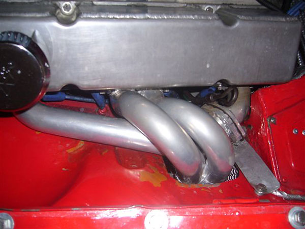

Exhaust: custom headers and dual exhaust system.
Transmission: Tremec 5-speed.

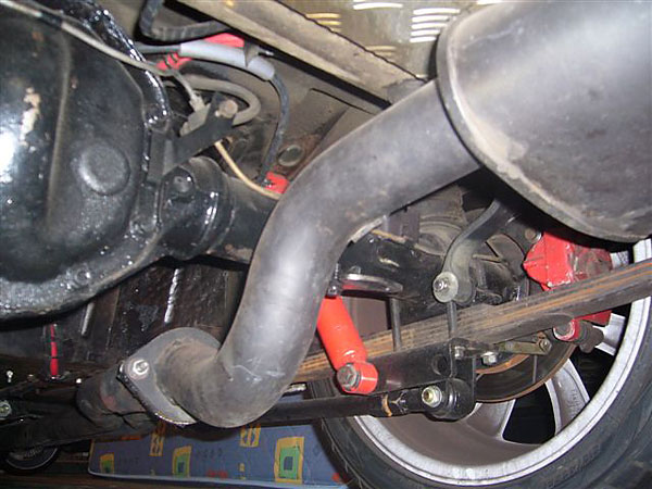

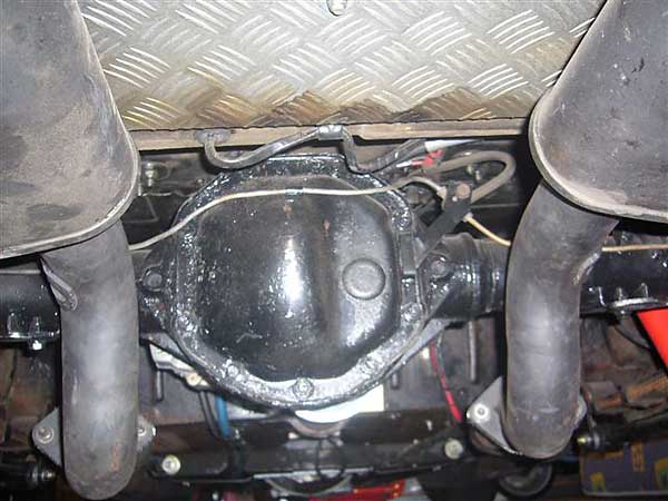

Rear Axle: Borg Warner 9-bolt axle with 28 spline axle shafts, limited-slip differential and 4.11:1 gears.
(The axle was originally from a Holden Commodore V8.)
Front Susp.: uprated springs.

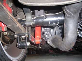

Rear Susp.: Koni telescoping shocks. Traction bars.

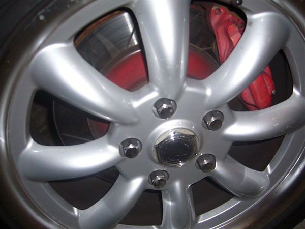

Brakes: HSV (Holden Special Vehicles) "Group A" disc brakes, front and rear.
(The front brakes utilize 4-pot calipers and vented rotors.)

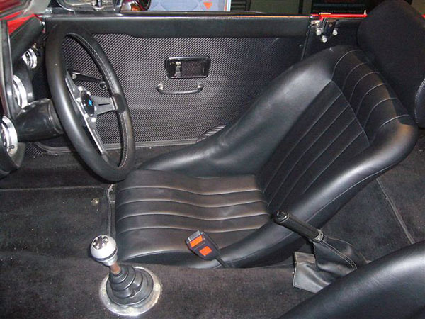

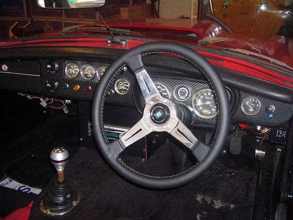

Interior: Autometer gauges. Nardi steering wheel. Cobra seats. Carbon fiber trim for the instrument panel, door skins, and boot liner. Roll hoop and fuel cell.

radiator shroud
A shroud helps direct air into the radiator core, and prevents recirculation.
unique custom aluminum radiator
With the shroud pulled off, we can see the unique custom aluminum radiator.

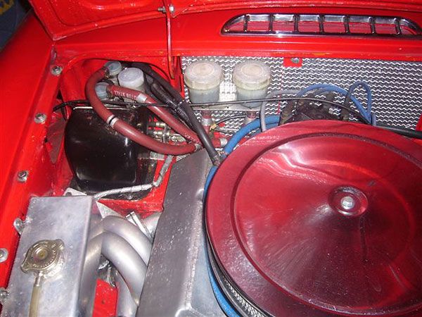

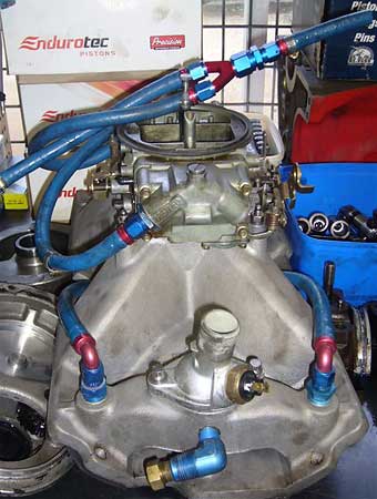

Proform 750 carburetor

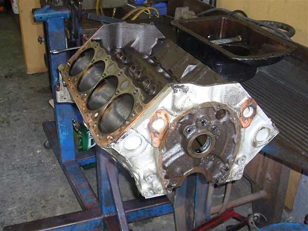

small block Chevy engine block
4 bolt main bearing cap
roller rockers

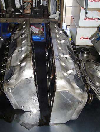

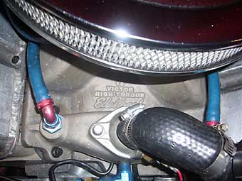

18 degree aluminum heads   Holley 750 carburetor
custom aluminium radiator, with 17 inch electric fan
ACL double corrugated aluminum heat shield (Race Series HR140-GTR)   Edelbrock 18 Victor High-Torque Manifold

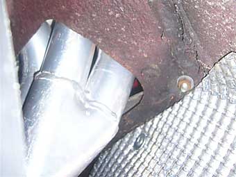

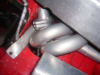

custom through-the-fender headers
modified-tri-y headers   ACL corrugated aluminum exhaust heat shield
remote reservoirs for the brake master cylinder
Holden Commodore 9-bolt with limited-slip differential and 4.11 gears

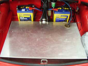

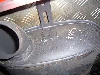

rear disc brakes   muffler mount... moving the fuel tank made a lot of room!

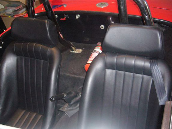

Cobra seats and carbon fiber door skins
notice that the emergency brake lever has been swapped and relocated

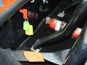

roll hoop and battery disconnect switch   fuel cell

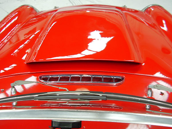

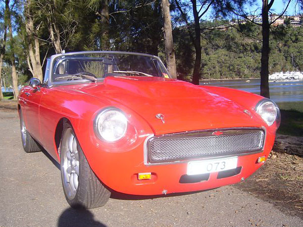

MGB hood scoop
Sebring headlight fairings
wire mesh grille for MGB
Sebring front valance

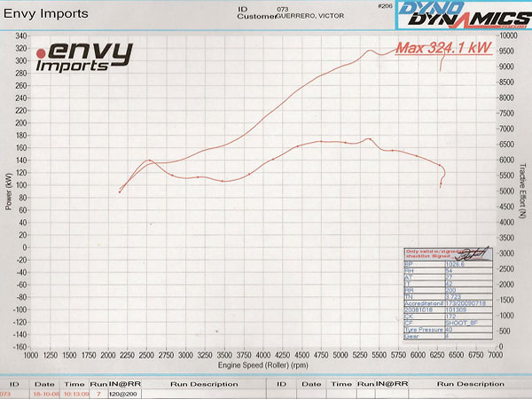

Dyno Results
324.1 Kilowatts equals 434.6257 Horsepower...
