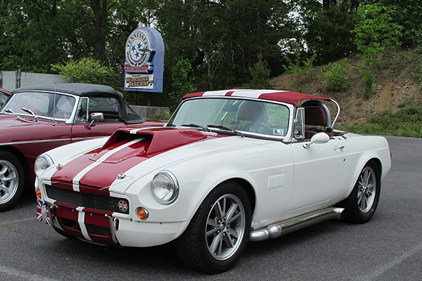

Tony Gentile's 1974.5 MGB with stroked Ford 302 V8 Engine
Owner: Tony Gentile

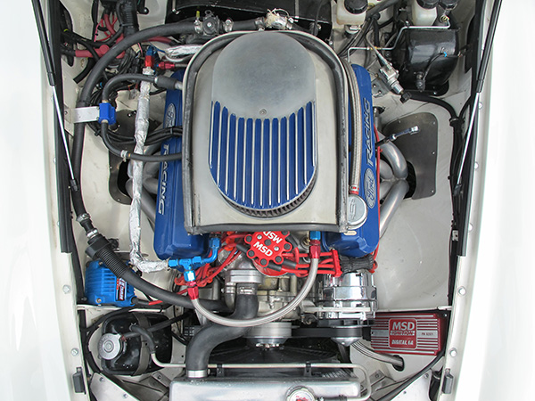

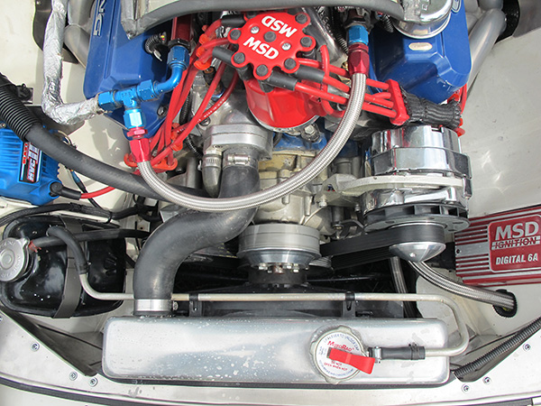

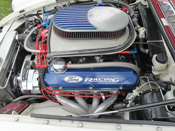

Engine: Ford 302, stroked to 347cid. Engine assembled by Todd's Automotive Machine Shop in St Louis. Bessel Motor Sports race prepped block with splayed 4-bolt mains and 1/4" gusset plate in the lifter valley. The crank is a no twist forged unit, custom ground by Bessel. Manley H beam connecting rods. Speed Pro digital diamond domed pistons with valve relieve. 11:1 compression ratio. Spin balanced rotating assembly. AFR 205 aluminum cylinder heads with minor flow work. Crower roller rockers 1.65:1 ratio. Dual conical valve springs. Erson RL962 hydraulic roller lifters. Erson hydraulic roller camshaft, 234°/242° at 0.050", 0.584" lift. Ford Racing valve covers. Edelbrock Super Victor intake manifold. FAST XFI 2.0 electronic fuel injection control module. MSD billet distributor. MSD Digital 6A capacitive discharge ignition. MSD HVC Blaster II ignition coil. Taylor Spiro Pro 8mm spark plug wires. MSD RPM Module Selector (8670). MSD RPM Activated Switch (8950). Fuel and Spark Technology (FAST) four-barrel throttle body. FAST fuel rails (model 30351). Precision Flow 39# fuel injectors. Tanks Inc. 15 gallon fuel tank, built for fuel injection.

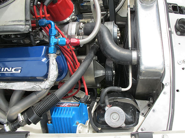

Cooling: Griffin aluminum radiator (Ford Mustang size, part number 7-565BC-FXX). Electric fan.

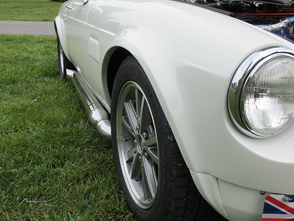

Exhaust: Fast Cars Inc. "RV8-style" four-into-one headers and collectors. Doug's Headers side pipes for Corvette.

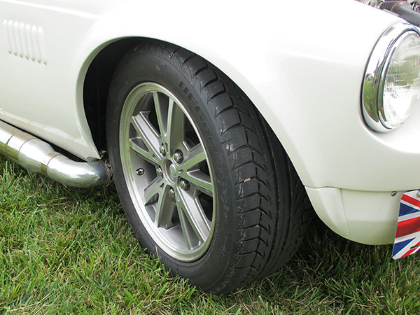

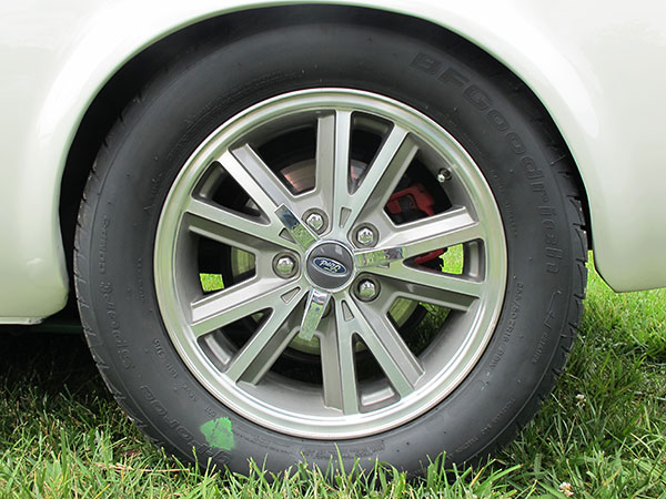

Wheels/Tires: Ford Mustang GT V6 aluminum wheels (16x7, 5x4.5" lug pattern, offered 2005-2008). BF Goodrich G-Force Sport Comp-2 tires, size 215/55ZR16.
Body: bumpers deleted, both front and rear. Custom paint job (GM white number 8554. Ford red number 6726.) Custom crate style grille. Driving lights hidden behind grille. Mk3 (vented) front apron Austin Healey style recessed/round front turn signals. Shaved side marker lights. VW Rabbit rear fender flares, installed front and rear. Louvered front fenders. Hood pins. Two level hood scoop. Stainless steel cowl vent screen. Polished windshield surround. Vitaloni "California" side view mirrors. Bimini style soft top. Frenched license plate. Alpena LED (hidden) license plate lamps. Shaved back-up lights. Shaved exterior fuel filler. Preform Resources rear valance. MGB Mk1 taillamps. Custom nerf bars, front and rear.

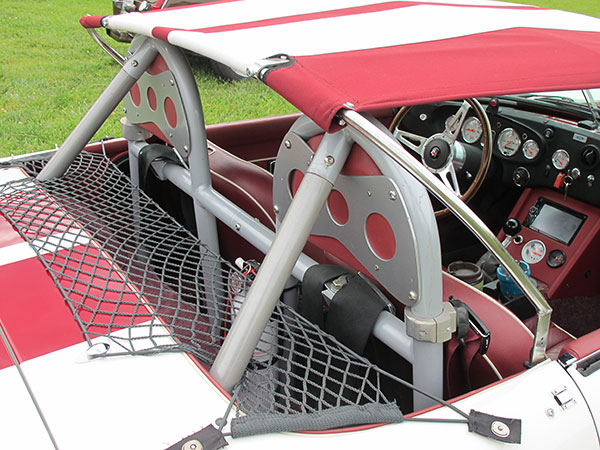

Interior: stripped down and painted Abingdon-pillow style dashboard. Custom glovebox. Custom center console. GM-style tilting steering column. Lokar parking brake lever (EHB-7000F). Clarion NX405 CD/DVD player. Aiskaer antenna. MGB seats with headrests removed, reupholstered by Classic Car Studio. Electric seat and back heaters. Custom dual roll hoop with integral headrests.

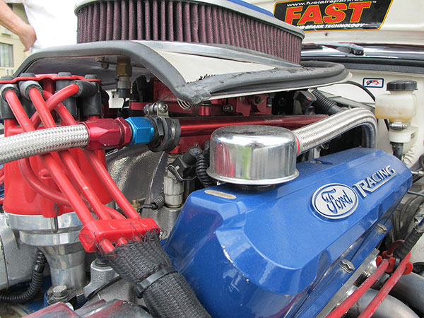

Ford 302, stroked to 347cid, delivers 375 rear wheel horsepower at 6600 RPM.

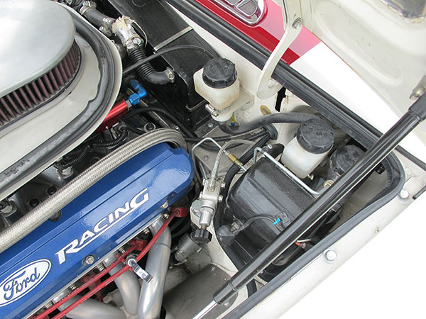

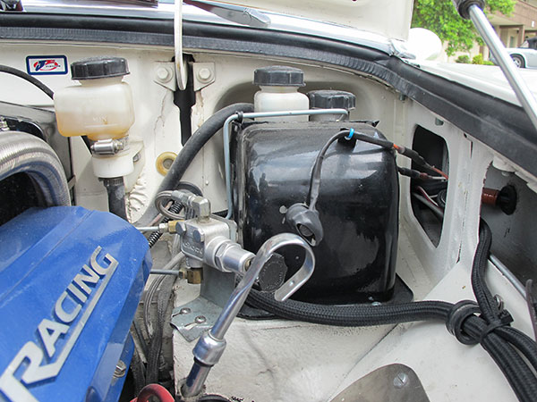

Wilwood brake and clutch master cylinders. Note: one remote reservoir required.
Wilwood adjustable brake proportioning valve.

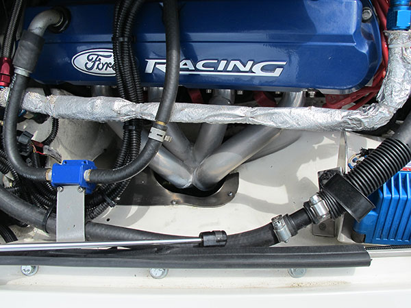

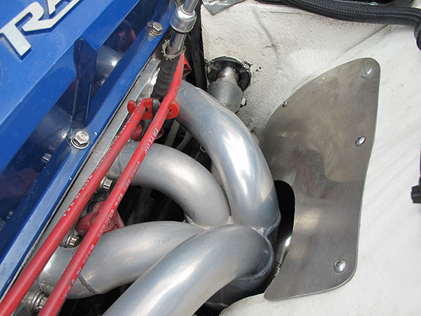

Fast Cars RV8-style through-the-fenderwell, four-into-one headers.
Fast Cars "RV8-style" through-the-fenderwell, four-into-one headers.

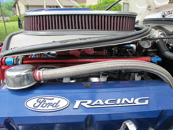

Fuel and Spark Technology (FAST) four-barrel throttle body and fuel rails.

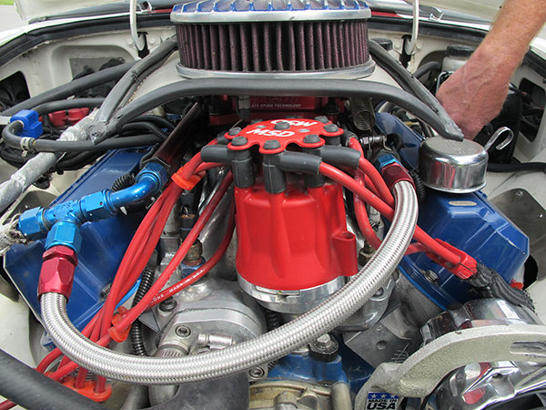

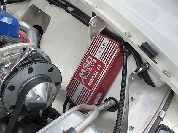

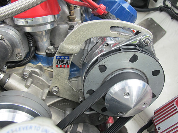

Delco-Remy alternator.
Delco-Remy alternator, on a heavily reworked mounting bracket.

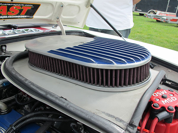

Finned air cleaner.
Finned air cleaner.
Idler pulley for the serpentine belt set-up.

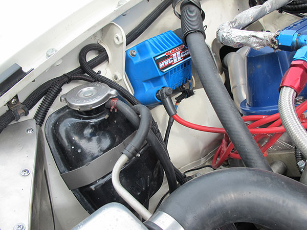

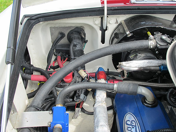

Oil separator.
Pollak battery disconnect switch.
Pollak battery disconnect switch, mounted upside down so its terminals are
accessible in engine bay, whilst it's lever can be reached from the cabin.

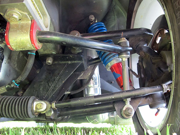

Front Suspension
Fast Cars coilover front suspension.

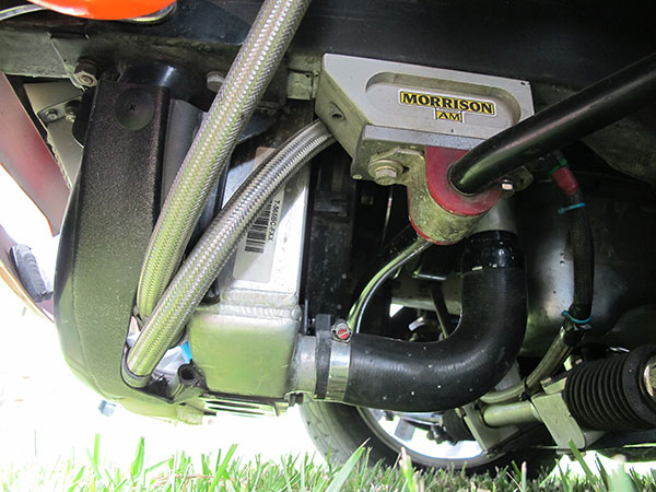

Art Morrison Enterprises sway bar spacers.

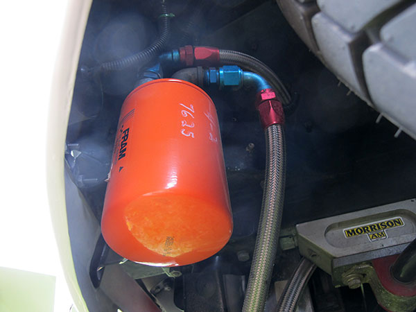

Fram Racing oil filter, mounted remotely behind drivers-side headlight.

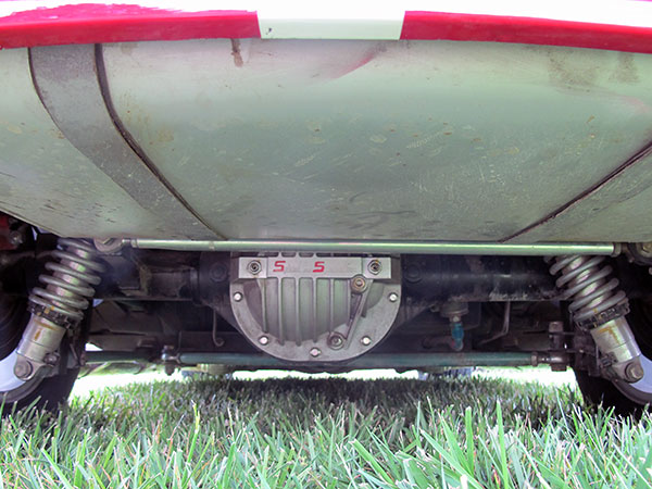

Rear Suspension

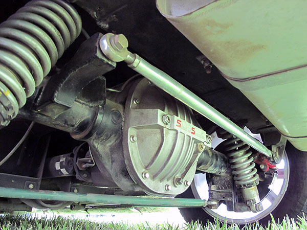

Narrowed Ford 8.8 axle.

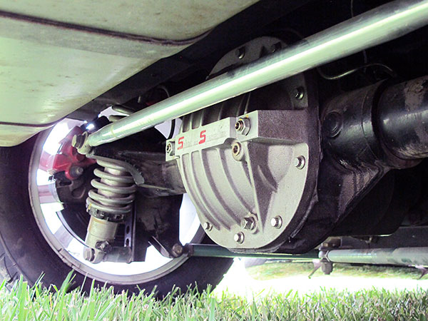

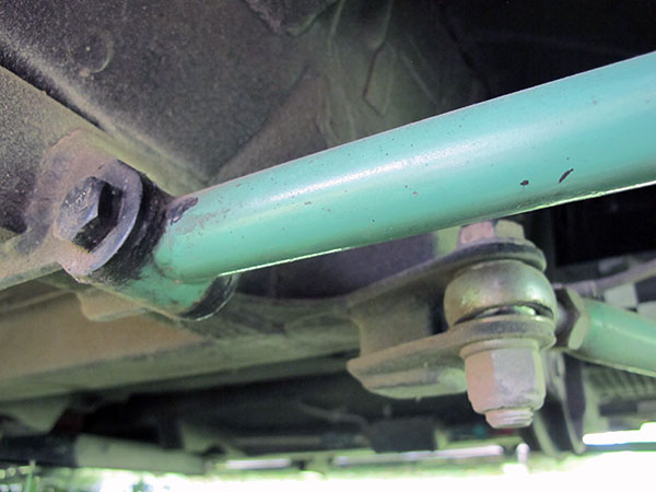

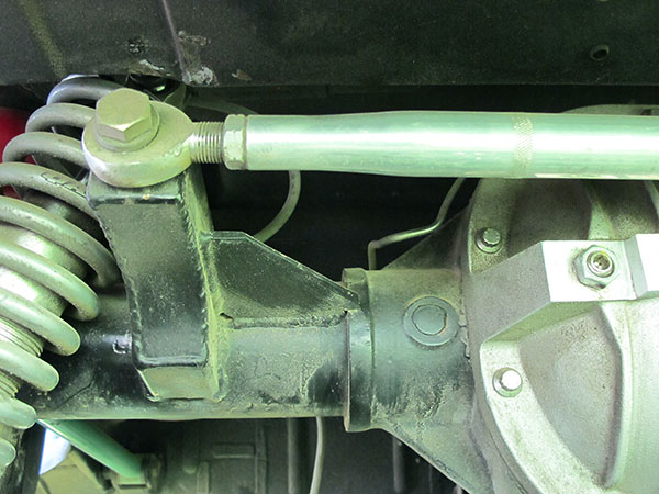

Panhard rods define rear suspension roll center.
Four link rear suspensions are often supplemented by a fifth link, called a Panhard rod
to locate the axle side-to-side and also define the roll center of the suspension design.
Panhard rod mount rearward of the rear axle.

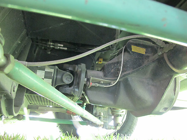

This car is unusual because it has two different Panhard rods installed. This one
is rearward of the axle, level to the ground, and at about the same height as the axle.
Secondary, redundant Panhard rod forward of the rear axle.
A secondary (apparently redundant) Panhard rod is installed forward of and below the axle.

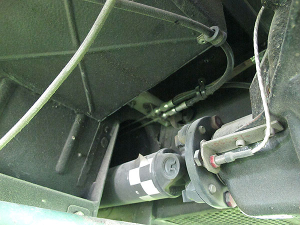

Vehicle speed sensor on axle's propshaft flange.

Speed and Specialties finned aluminum differential cover.

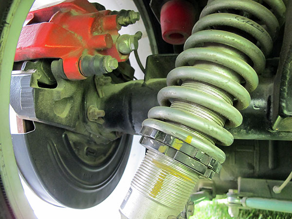

Strange Engineering adjustable coilover shock absorbers (#81587) and QA1 springs.

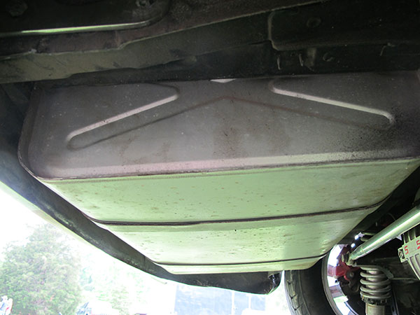

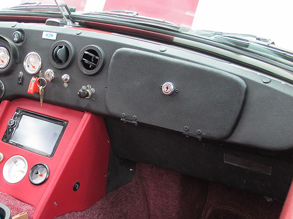

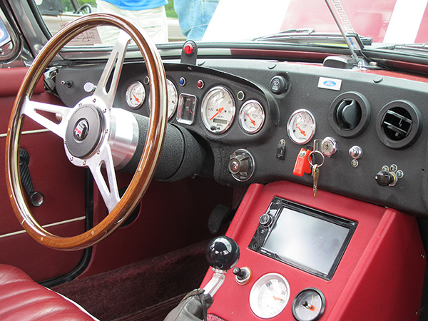

Stripped down and painted Abingdon pillow-style dashboard.
Stripped down, highly modified, and painted Abingdon pillow-style dashboard.
Custom glovebox added. Note also custom center console.

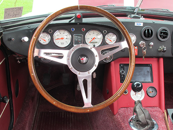

Autometer volt meter, tachometer, speedometer, coolant temperature, and fuel level gauges.
Smiths oil pressure gauge. AutoTech oil temperature gauge. VDO clock.

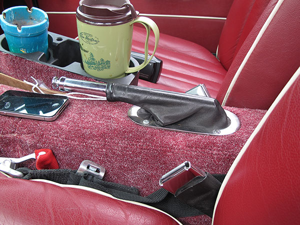

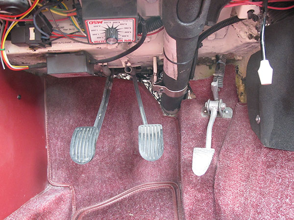

MSD RPM Module Selector (8670) and MSD RPM Activated Switch (8950)
MSD RPM Module Selector (8670) and MSD RPM Activated Switch (8950).

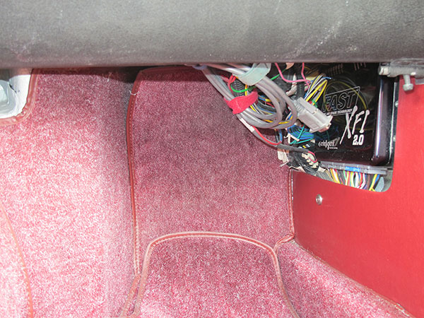

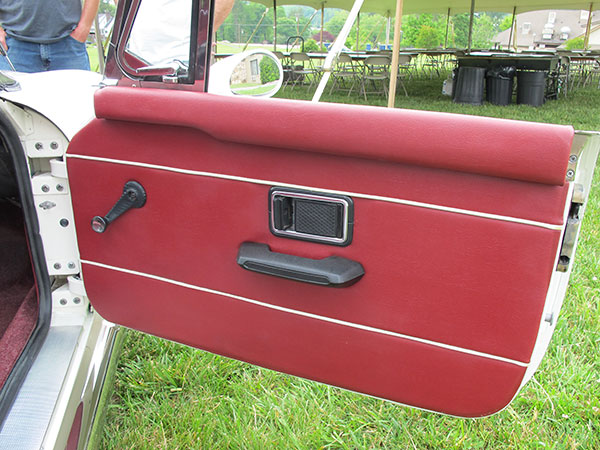

Door card.
Door card.

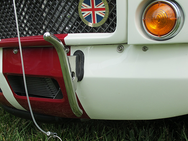

Custom nerf bars.
Custom nerf bars. Recessed, round front turn signals.

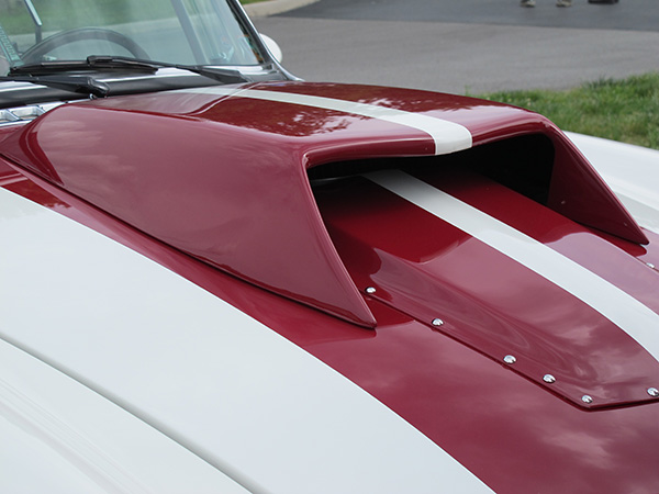

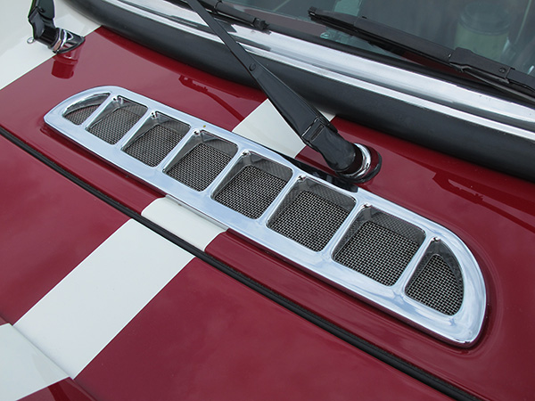

Stainless mesh keeps debris out of the cowl vent.

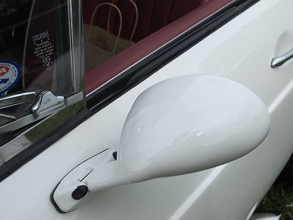

Vitaloni California side view mirror.
Vitaloni "California" side view mirror.

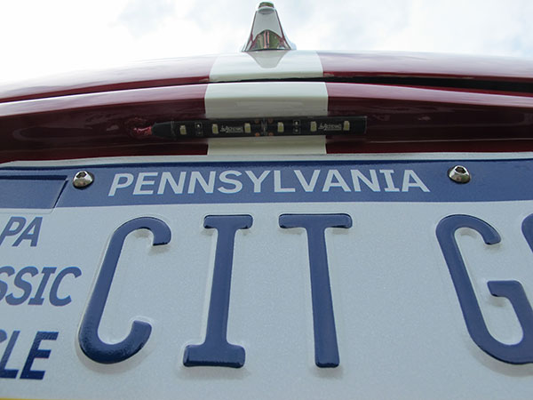

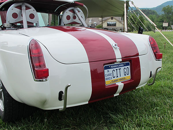

Alpena LED hidden license plate lamps.

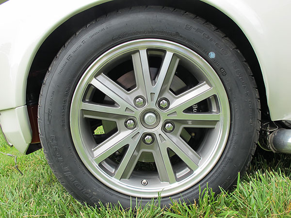

Ford Mustang GT V6 aluminum wheels (16x7, 5x4.5 lug pattern, offered 2005-2008).
