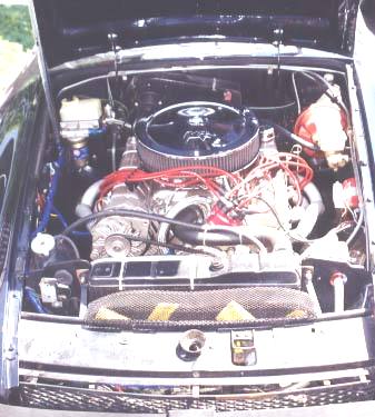

MODIFICATIONS:   Crower cam & dual valve springs, silicon-bronze valve guides with teflon oil seals, Kenne-Bell high volume oil pump, Holley 4160 390cfm carburetor, Offenhauser JWR dual port intake manifold, Mallory Unilite distributor, Allison Red coil

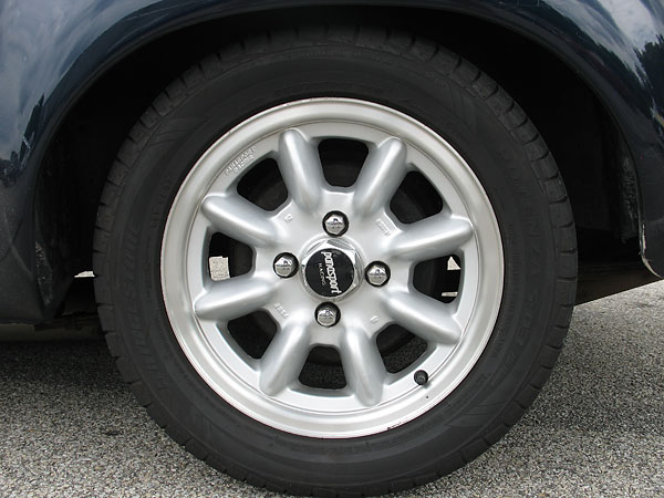

WHEELS/TIRES:   Enkie 14 x 7, Copper Viper 205/60HR14

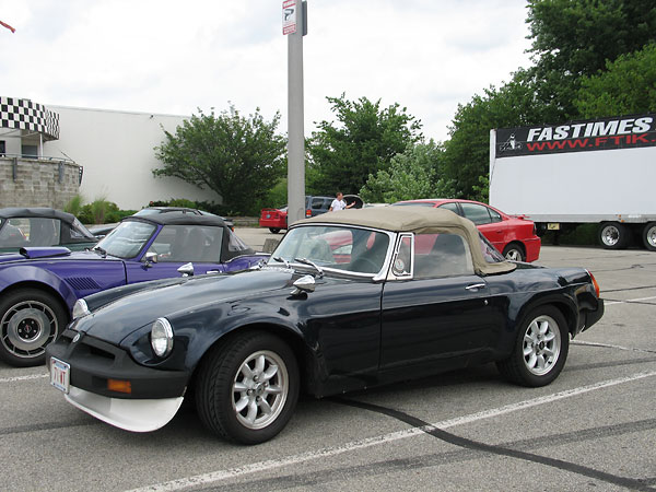

    Tim Duhamel's '79 MGB with Buick 215 V8

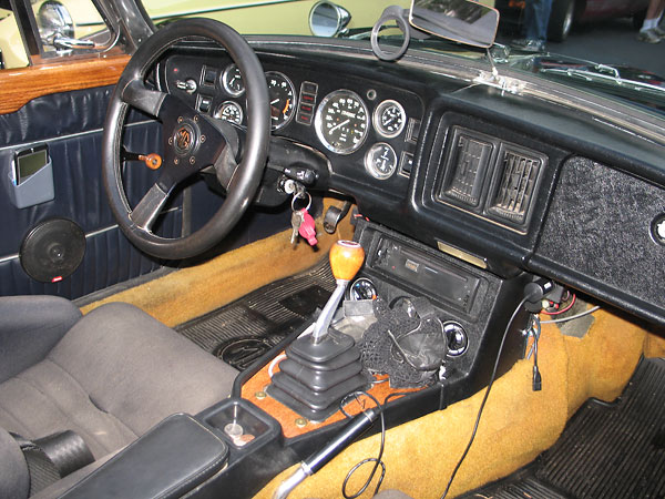

Custom wood interior trim.

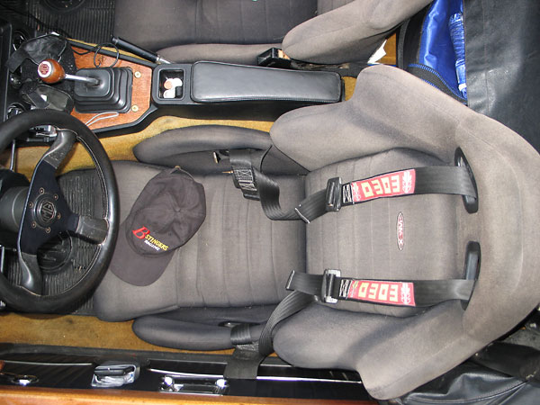

Momo Corse safety harness.

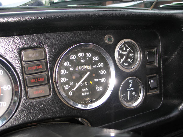

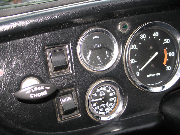

Stock MGB Smiths gauges.
Sun manifold vacuum gauge.

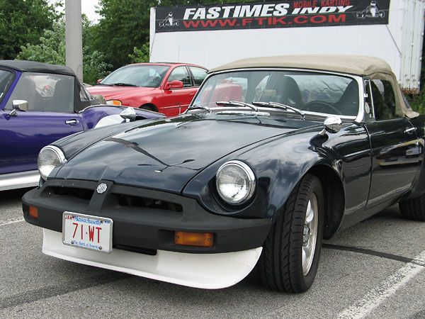

Sebring style fender flares.
Fiberglass ST air dam.

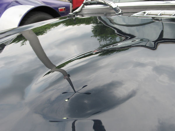

Custom hammer-formed hood blister.

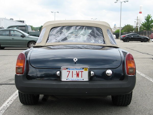

Back-up lamps relocated to the taillamps (in lieu of reflectors).

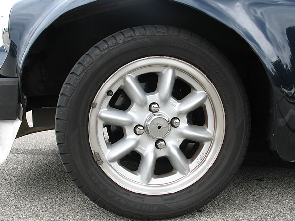

Panasport Racing wheels.
Bridgestone Potenza tires.
