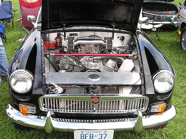

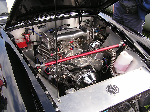

Engine: Chevy 350 with Edelbrock aluminum heads. Edelbrock intake manifold and carburetor. Holley Hi-Tek air cleaner. MSD ignition and coil. Delco alternator.
Cooling: Griffin aluminum radiator.
Exhaust: custom, with headers.
Transmission: automatic.
Rear Axle: Ford 9".

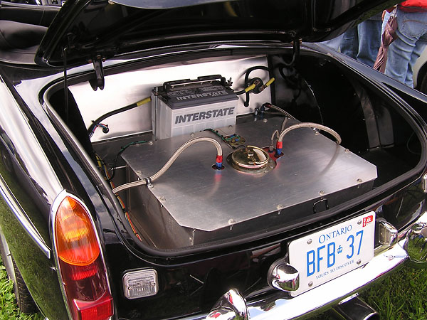

Chassis: 3" box tube frame, fabricated inner wings, fabricated transmission/driveshaft tunnel, and tubbed rear. Racing fuel cell.

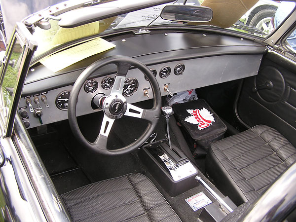

Interior: custom aluminum dashboard.
