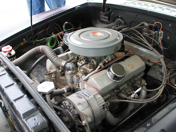

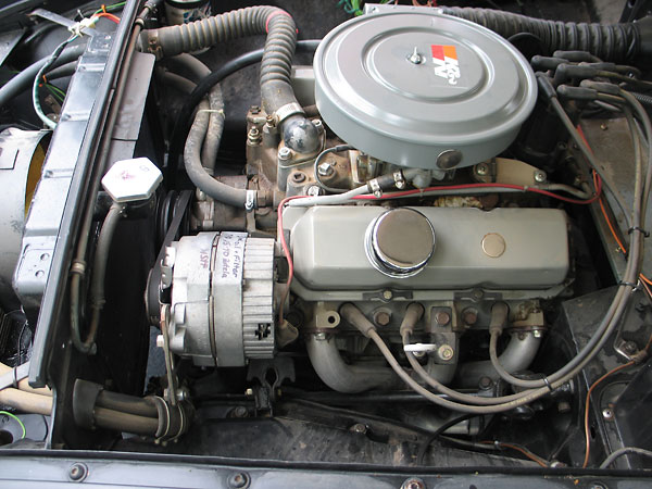

Engine: Chevy 2.8L V6
Built by: owner.

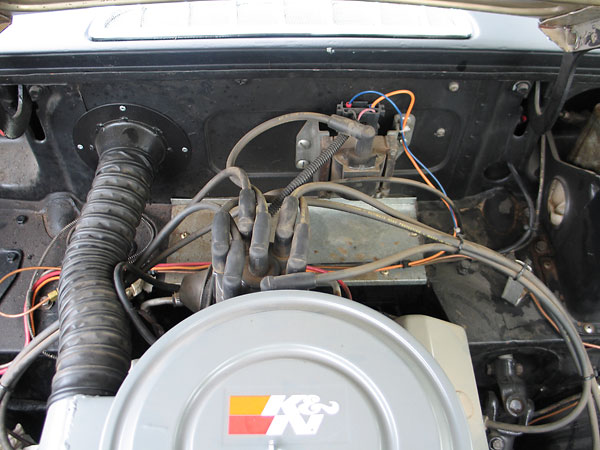

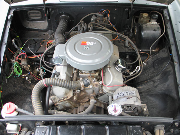

Engine: Chevy V6 2.8 litre. (The model year is unknown, but it features the "big journal" crankshaft and large valve cylinder heads.) Stock camshaft and valve train. Stock GM intake manifold, modified to suit a Weber DGV 32/26 carburetor. Yugo air cleaner, modified to provide cowl induction. K&N air filter. Stock GM HEI ignition system. Triumph GT6 motor mounts.

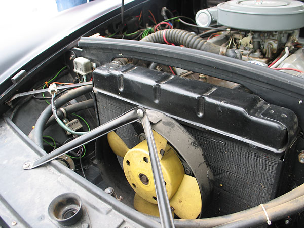

Cooling: stock MGB radiator. An 8" by 10" heater core has been mounted underneath the radiator shelf, plumbed to serve as an auxiliary radiator. MGB oil cooler utilized with Permacool adapter. Electric cooling fan (from a Fiat), manually switched.

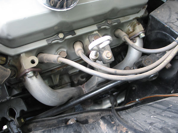

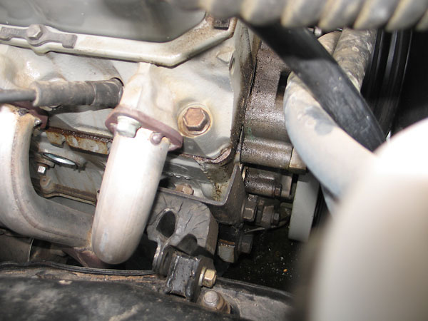

Exhaust: homemade custom three-into-one headers. Single muffler.

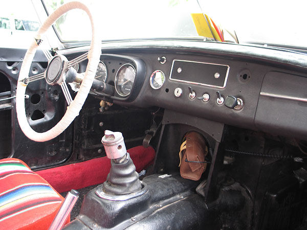

Instruments: stock MGB tachometer and speedometer from a 1977 MGB. (The tach was modified by a local shop to work with the V6 ignition system.)
Misc.: shaved side molding and door handles. Omitted windshield wipers and washers. Omitted heater. Omitted door glass. Omitted interior door trim. Industrial mats in lieu of carpet. Custom seat upholstery, made from a Mexican blanket. MGA banjo style steering wheel, wrapped with white cord. Chromed bicycle mirrors. Amco white vinyl convertible top. Omitted bumper overriders.

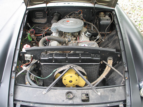

Compact sixty-degree Chevy 2.8L V6 engine.
This compact sixty-degree Chevy 2.8L V6 engine is mated to a similarly compact T50 transmission.
This engine/transmission can be installed with hardly any modification of the MGB Mk.1 bodyshell.
General Motors (Delco-Remy) alternator.

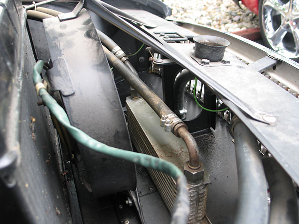

Oil cooler hoses on shown here, at right. Hoses for an auxiliary radiator can be seen on the left.
Electric cooling fan from a Fiat.
MGB oil cooler (plumbed via Permacool adapter).

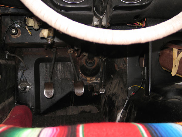

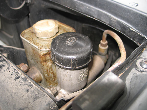

PBR clutch master cylinder. (PBR mainly serves the Australian aftermarket and service parts market.)

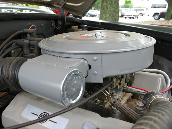

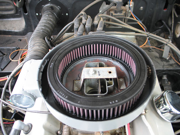

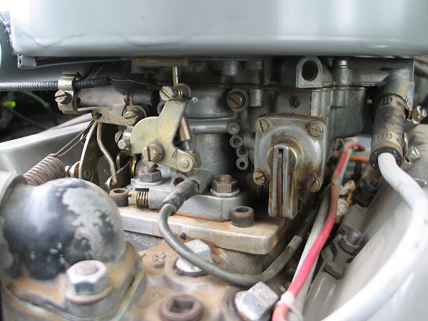

Weber DGV 32/26 carburetor sits atop an adapter plate, above a modified Chevy intake manifold.
K&N air filter.
K&N air filter.
Homemade custom three-into-one block hugger headers.

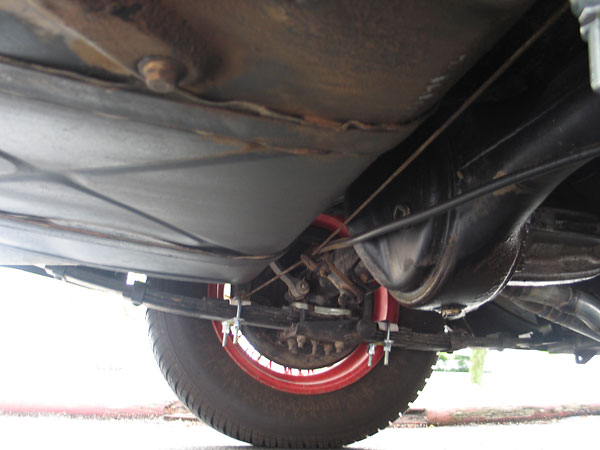

Suspension
re-stacked leaf springs
"I installed new Moss rear springs, and the car sat way too high, so I modified them by placing the bottom two
leafs on top, upside down. It works okay, but the springs seem pretty poor quality. You get what you pay for.

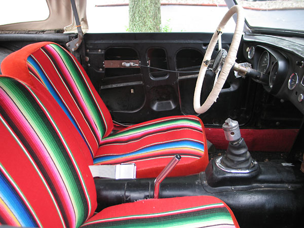

An old piston from a two-stroke outboard boat motor serves as a gear shifter knob.
Another cool old-school hot-rod detail: cord wrapped (MGA banjo style) steering wheel!
Pedals and footbox sheet metal are completely unmodified.

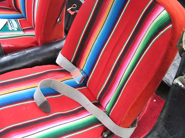

Custom seat upholstery, made from a Mexican blanket. (Steve's buddy Ron Bender did the stitching.)
Safety Fast? Vintage lap belts!

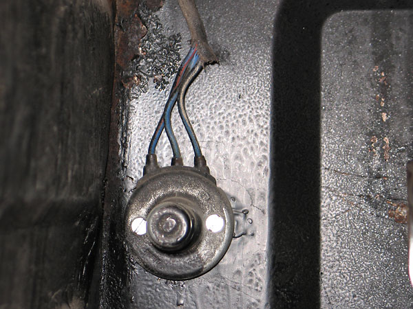

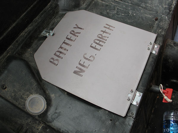

Battery disconnect switch.

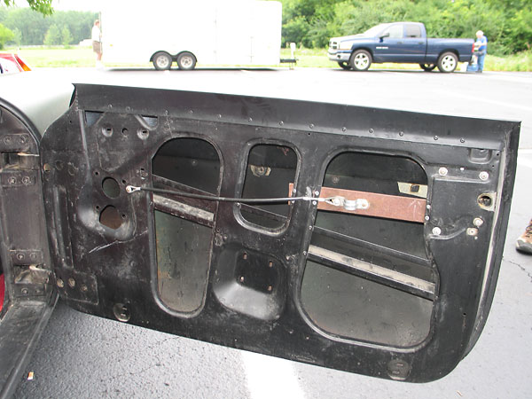

Simple pull-cables release the door latches.

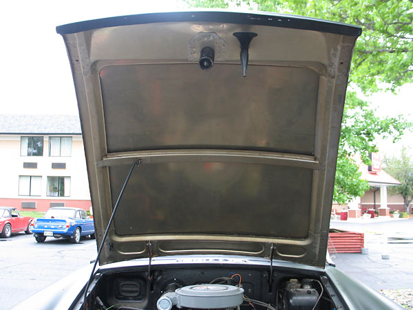

Steve removed the hump that used to be on centerline above the grille badge.
This original all-aluminum MGB hood previously suffered a bump on its nose. Steve decided to remove the
hump that used to be on centerline above the grille badge. (Flush rivets provide a refined appearance.)
Steve removed the paint on the underside of the hood, using paint stripper and paint brushes/soft clothes.
"It took a long time but I didn't want to scratch the surface using Scotchbrites, etc."

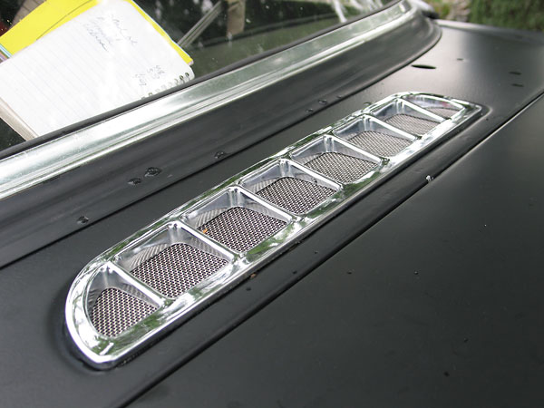

The cowl inlet has been repurposed... It's now for engine air induction.

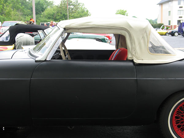

Shaved side moldings and door handles.

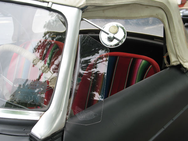

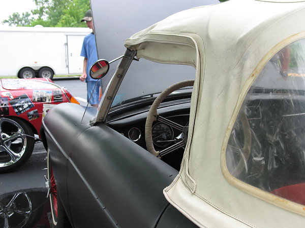

Chrome bicycle mirror and custom acrylic air deflectors.)
Chrome bicycle mirror and custom acrylic air deflectors. (Heavy original vent windows have been removed.)
Door window slots have been filled.

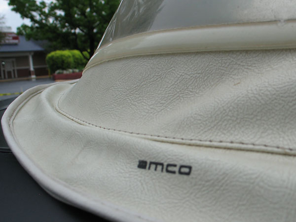

Vintage AMCO white vinyl convertible top.

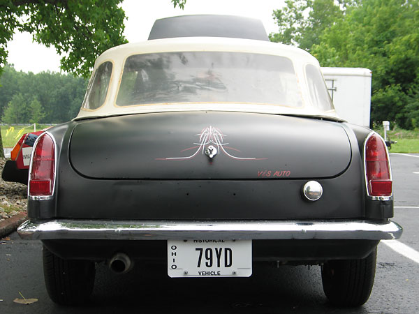

Omitted bumper overriders help make the car look wider and lower.

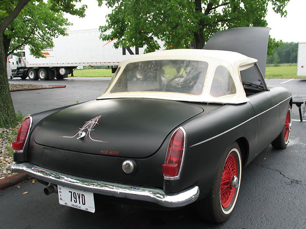

V&S Auto
V&S Auto
Custom hand-painting by Bandit
Custom hand-painting by "Bandit"

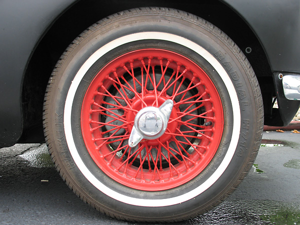

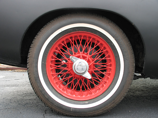

Stock MGB wire wheels, painted red. Hankook H714 radial tires (185/75-R14).
Stock MGB wire wheels, painted red. Hankook H714 radial tires (B/185-75-14).
Note that the wheel spinners have been drilled and safety wired.
