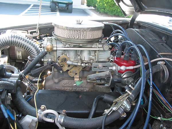

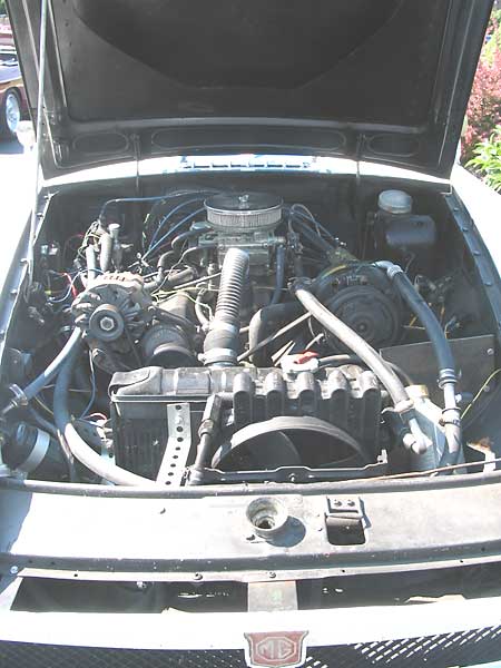

Engine: 1991 Chevy 3.1L V6
Intake: Edelbrock manifold, Holley 390cfm carburetor.
Cam: stock.

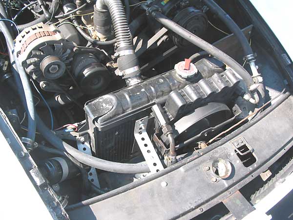

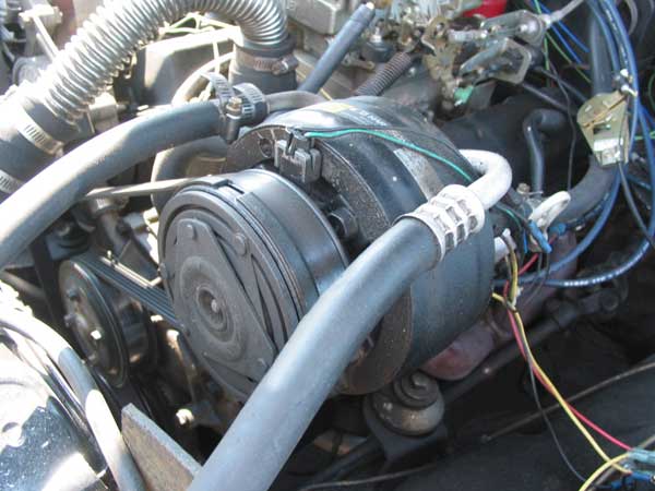

Cooling: Ford V8 radiator.

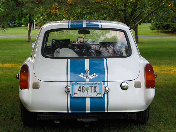

Exhaust: Headers and single exhaust.

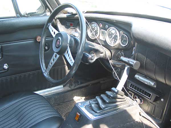

Transmission: 700R4 auto with 0.7 overdrive.
Rear axle: stock MGB (3.909:1)

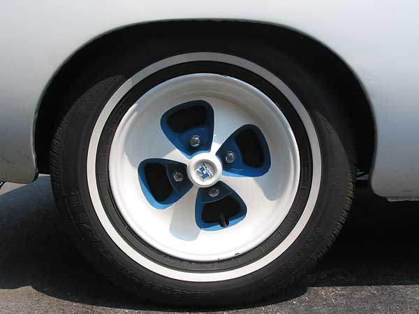

Wheels/Tires: 14" Keystone aluminum wheels with MasterCraft A/S IV tires.
Other: Classic Instruments gauges, air conditioning, front spoiler, rear Sebring roll pan, matching trailer.

Edelbrock Torker Manifold

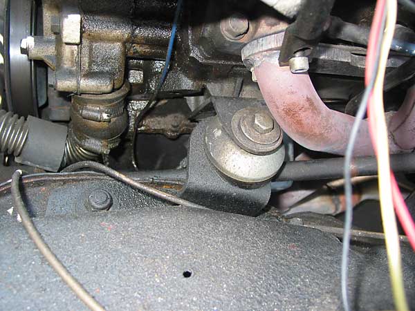

Classic Conversions motor mounts and headers
Ford Falcon radiator
(14" Keystone aluminum wheels, as of British V8 2007)
