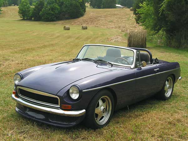

Steve Carrick's 1974 MGB, with 375 horsepower Ford V8

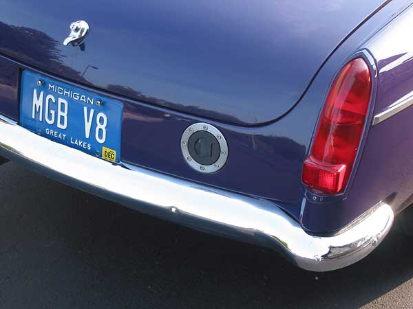

Frenched license plate

Model: 1974 MGB roadster

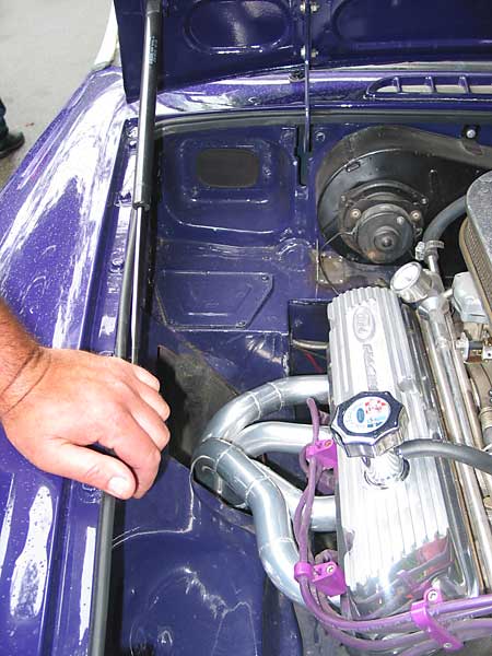

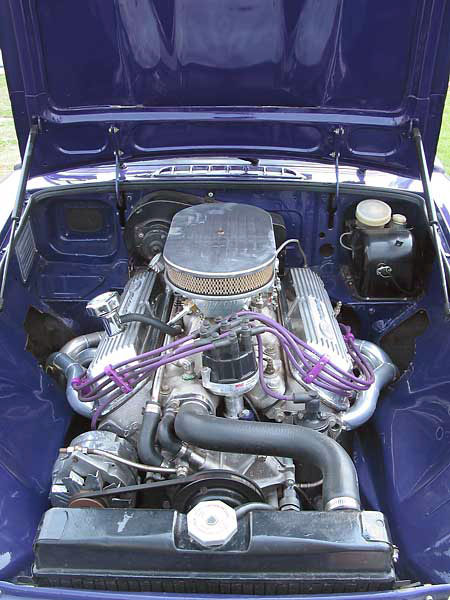

Engine: Ford SVO 302 V8
Engine: Ford Motorsport (SVO part number M-60070-B40) crate engine.
Heads: GT-40 aluminum heads (SVO part number M-6049-Y302) weigh 22 pounds each, 25 pounds lighter than similar iron heads. Intake valves: 1.94". Exhaust valves: 1.54".

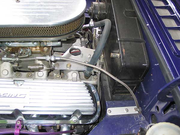

Induction: a single 4bbl 625cfm Road Demon carburetor sits on an Edelbrock "airgap" 7121 aluminum manifold. Throttle cable by Lokar.
Cam: hydraulic roller type (SVO part number M-6250-B303) with intake and exhaust duration of 284 degrees (224 degrees at 0.050" lift). Intake and exhaust lift = 0.480".
Oil pan: a rear sump pan was fitted, but the front crossmember required extensive modification for clearance. Even the rear sump pan on a Ford has a small front "sump" to allow room for the oil pump drive. This front sump can cause difficulties in some installations, interfering with the front crossmember as in this application.
Power: An identically configured engine was tested by Car Craft magazine recently, and their engine produced 375HP!

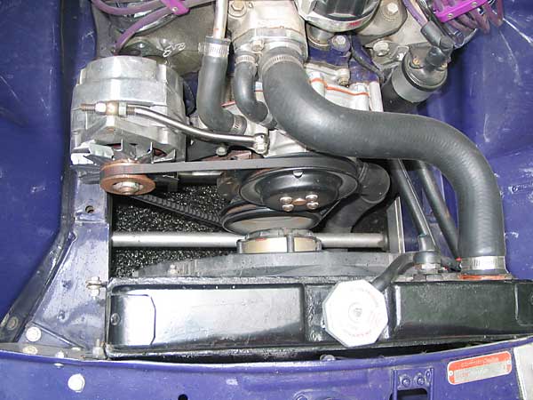

Water pump: stock Ford, configured for V-belt operation (with opposite rotation from the normal serpentine belt drive).
Cooling: Griffen brass construction radiator, designed as a stock replacement for a '65 Mustang. Spal electric fan in a puller configuration. Note: car runs way too cold at highway speeds. (150 degrees at 80 MPH.) The thermostat is a modified Robert-Shaw 180 degree thermostat. The bypass was opened up to 1/2". Will go back to a stock Robert-Shaw 180 degree and stock 3/8" bypass opening to try and get the temperature up to normal.
Alternator: Delco 100 amp, one wire.
Starter: gear reduction type from PA Performance.
Wiring: re-routed to clean up engine bay.
Headers: custom made with 1.50" primaries. Mufflers are chambered, and 48" long.

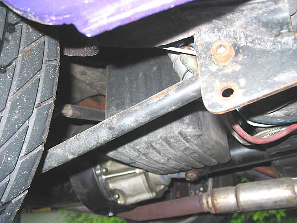

Rear axle: Ford 8.8", with a 2.73:1 final drive ratio. (I plan to upgrade to a Ford 9".)

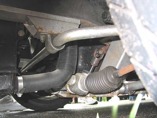

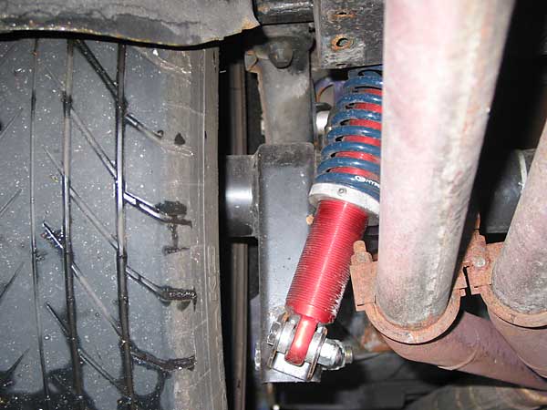

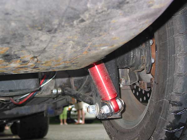

Suspension: (Front) lowered one inch. Currently running a Ron Hopkins (Bilstein telescoping shock conversion), but will soon upgrade to a Fast Cars, Inc. front suspension setup. (Rear) lowered one inch. Composite springs and Koni shock conversion supplied by British Automotive, Inc.

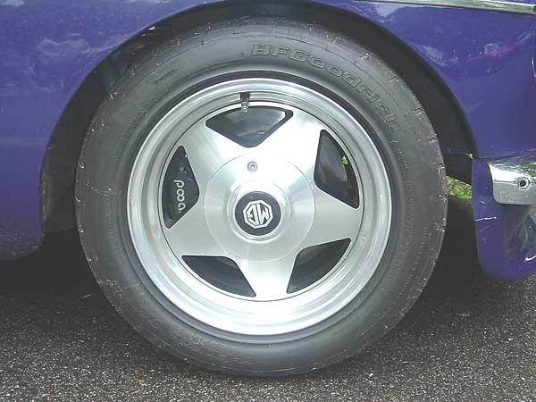

Brakes: (Front) stock for now, but will be upgraded to Wilwood four piston calipers and 12 3/4" diameter rotors as part of the Fast Cars front suspension upgrade. (Rear) stock Mustang as part of the Ford 8.8" axle assembly.
Wheels/Tires: ARE 15x7, with BF Goodrich TA 225R15 tires.

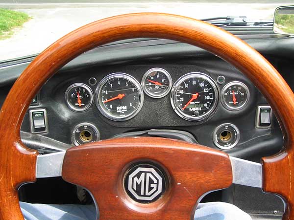

Interior: Fiero seats. Other interior improvements are a future project.

Ford Motorsport crate engine
Ford Mustang radiator
Coyote headers
Lokar throttle cable
steering rack
forward mounted Panhard rod
three link rear suspension
coilover shocks
steering wheel

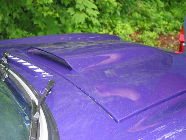

MGB hood scoop

Suzuki Katana fuel cap
ARE wheels
