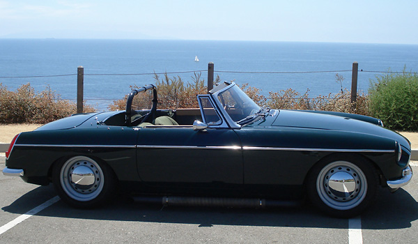

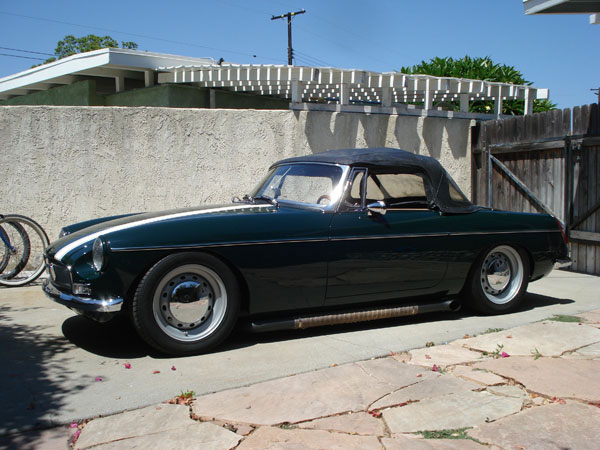

Stephen Blackburn's 1971 MGB with Chevy 283cid V8
Owner: Stephen Blackburn
BritishV8 UserID: sjblack13
City: California
Model: 1971 MG MGB
Engine: Chevy 283cid V8.
Built by: owner

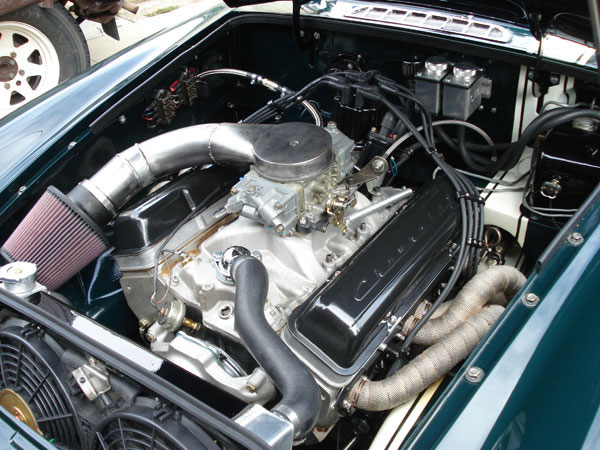

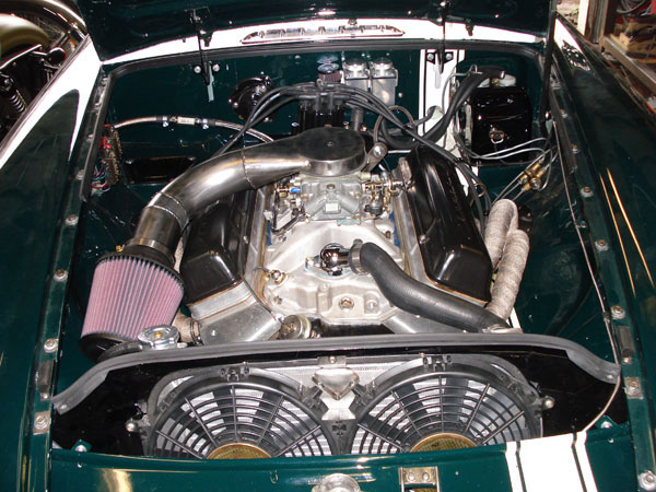

Engine: Chevy 283 small block engine, rebuilt and blueprinted. 358 hp at 6400rpm and 322 ft-lb at 4900rpm, at the flywheel. Steel crankshaft. Dome top pistons. I-beam connecting rods. Comp Cams solid lifters and roller rockers. Custom 202 aluminum cylinder heads. Edelbrock Performer intake manifold. Holley 650 double-pumper carburetor. Pertronix Flame Thrower distributer. Flame Thrower ignition coil. Pertronix 8mm spark plug wires.
Cooling: Be Cool aluminum radiator with two 10" pusher fans and two 8" puller fans.
Exhaust: custom four into one headers. 3" side pipes (as pictured). Also have a 2-into-1 oval 2-1/2" system with Spin Tech muffler.

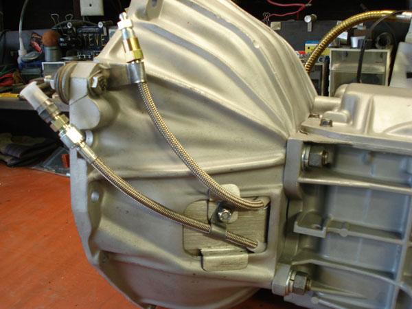

Transmission: Borg Warner T5 with a 0.67 final drive. Lakewood bellhousing. McLeod pressure plate and hydraulic throw out bearing. Tilton master cylinder with remote reservoir. Custom driveshaft.

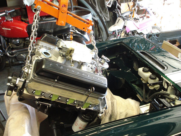

Be Cool aluminum radiator with two 10 inch pusher fans and two 8 inch puller fans.

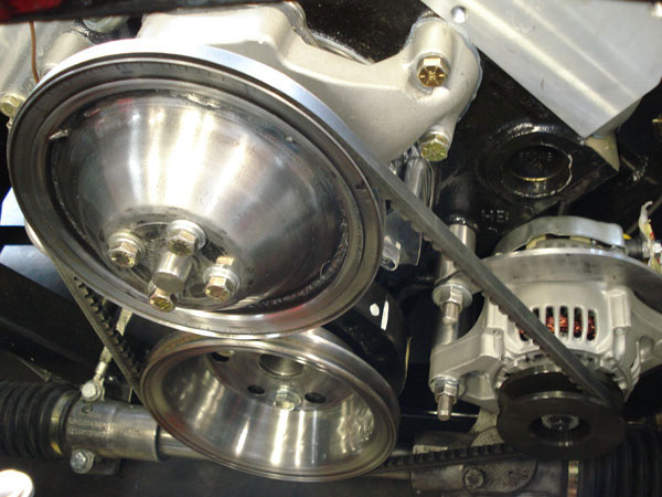

Nippondenso 60 amp mini alternator.

This little Chevy engine is rated 358 hp at 6400rpm and 322 ft-lb at 4900rpm (at the flywheel).

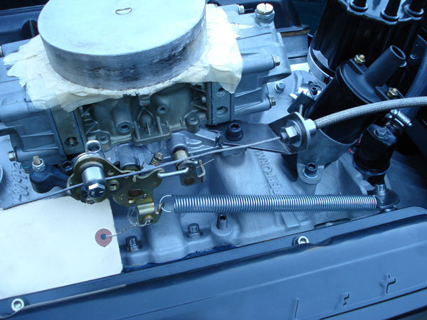

Custom 202 aluminum cylinder heads. Note spacers under the valve covers.

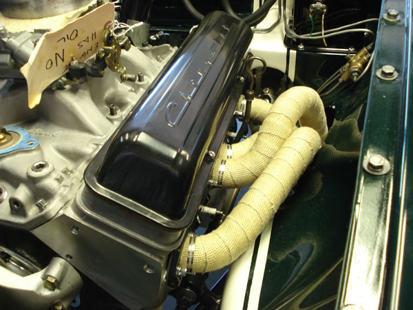

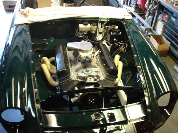

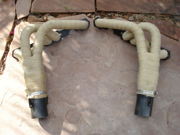

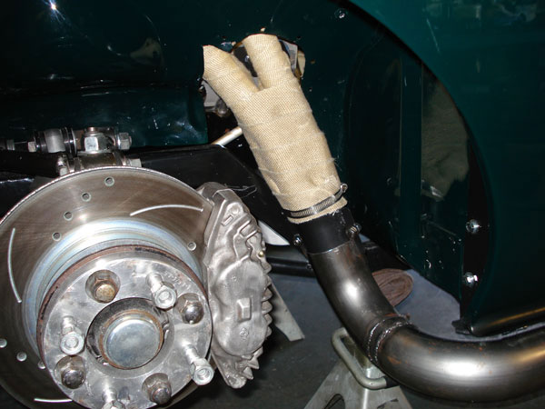

Old school: header wrap over mild steel headers.

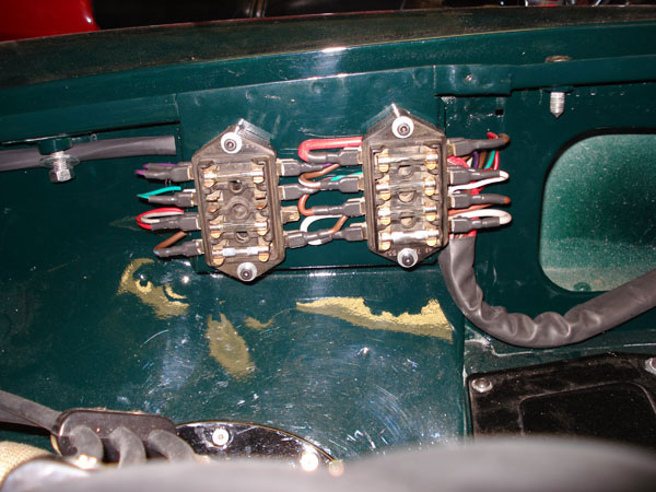

Custom wiring with eight fuses where once there were four. (Note also heat shrink tubing.)
Chevy bellhousing on Borg Warner T5 transmission and plumbing for McLoed hydraulic throw-out bearing.
(This bellhousing later cracked, and was replaced with a Lakewood steel belldhousing.)

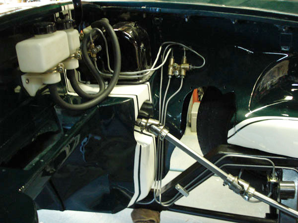

Brake plumbing for Wilwood master cylinders with remote reservoirs, and steering shaft routing.
Beautifully detailed engine compartment.

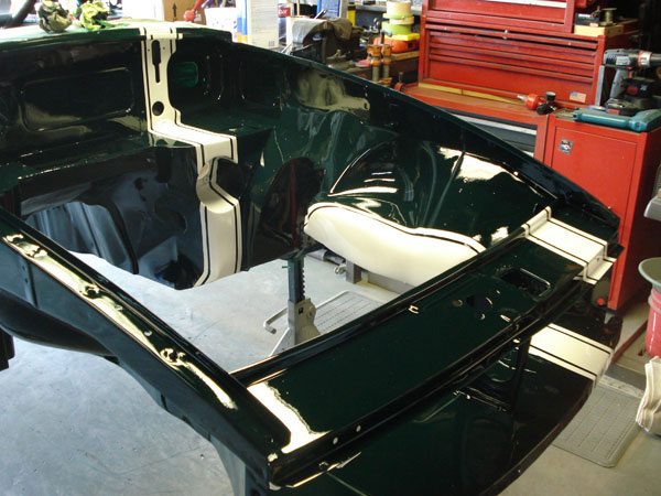

When the stripe is offset to the side like this, some of us call it a Sebring stripe.
When the stripe is offset to the side like this, some of us call it a "Sebring stripe".

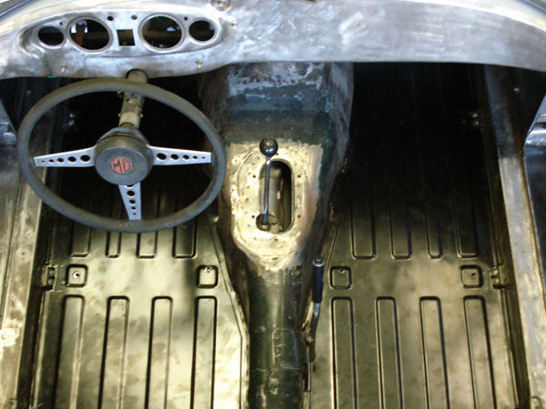

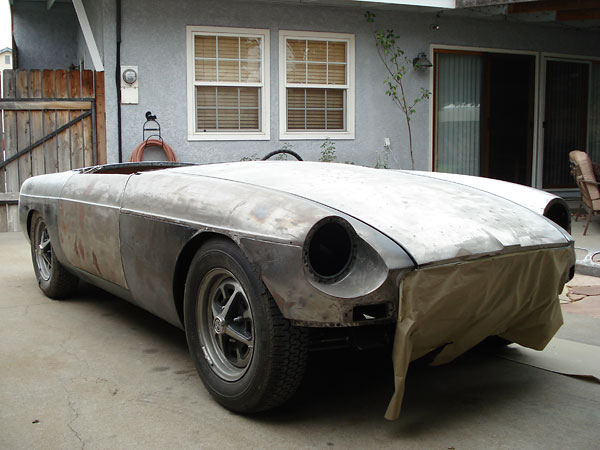

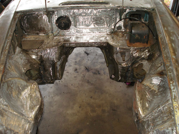

Mechanically stripping all that paint was obviously a lot of hard work!

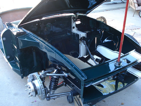

Front Suspension
Custom designed and fabricated double A-arm front suspension with Aldan coilovers.

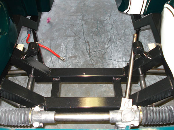

Original MGB front crossmember deleted in lieu of lightweight tubular structure.
Original MGB front crossmember deleted in lieu of lightweight tubular structure. The
MGB's built-in subframe has also been removed. Motor mounts now mounted on crossmember.

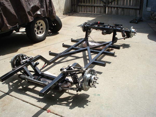

Completely new frame for what was once a unibody car.

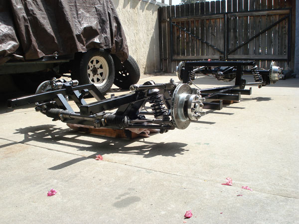

Custom front and rear suspension.

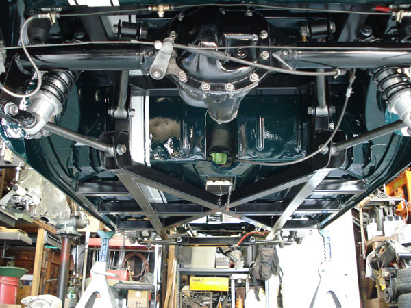

Rear Suspension
Triangulated 4-link rear suspension featuring Aldan coilovers. Stock MGB axle.

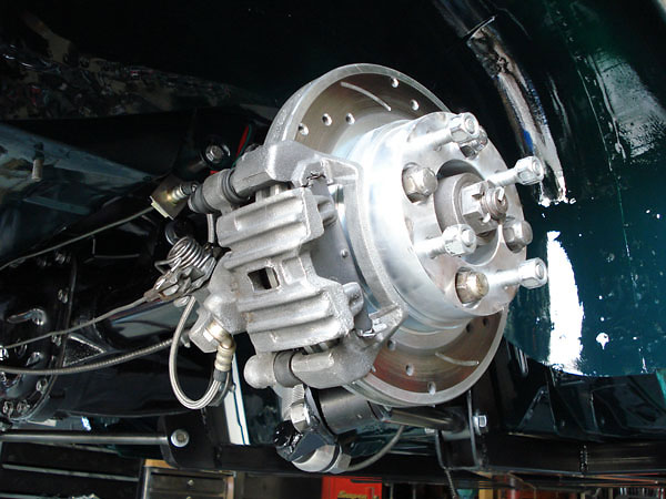

Single piston calipers with integrated E-brake and 10.75 vented disks.
Single piston calipers with integrated E-brake and 10.75" vented disks.

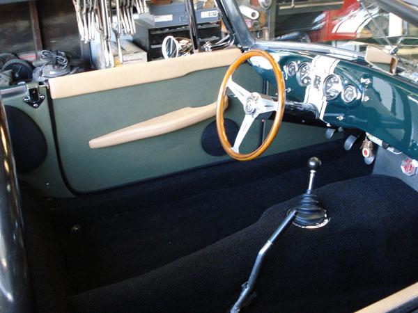

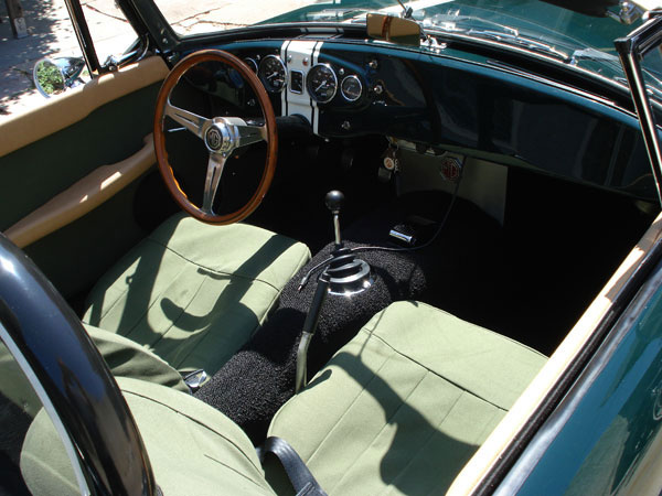

Fabric seat covers.
Fabric seat covers.

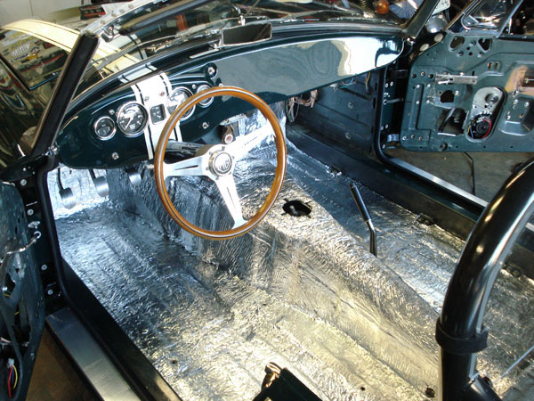

Custom interior trim details.
Remodeled Abingdon pillow style dashboard with its padding deleted.
Remodeled "Abingdon pillow" style dashboard with its padding deleted.
New floorboards.
New floorboards.

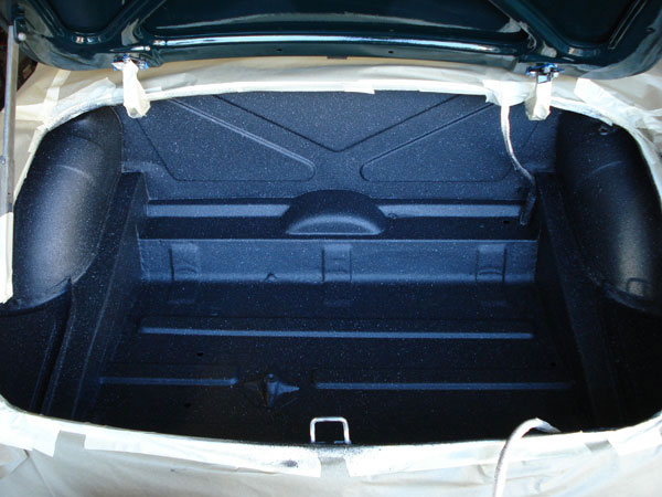

Trunk paint.
Trunk paint.

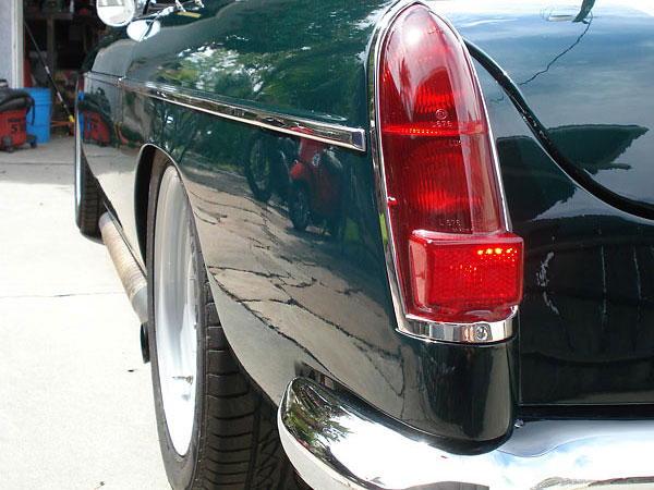

Mark one taillights on a mark two MGB.

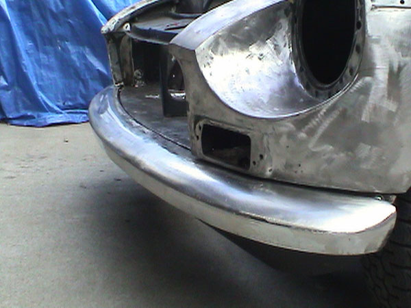

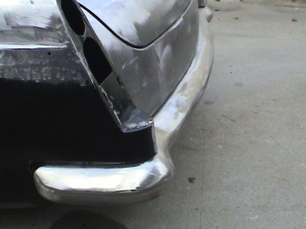

Checking bumper fit.
Checking bumper fit. Note that bumper bolts have been welded-on, grinded down, and smoothed over.
(Later the bumpers were re-chromed.)
Bumper over-riders will be deleted.

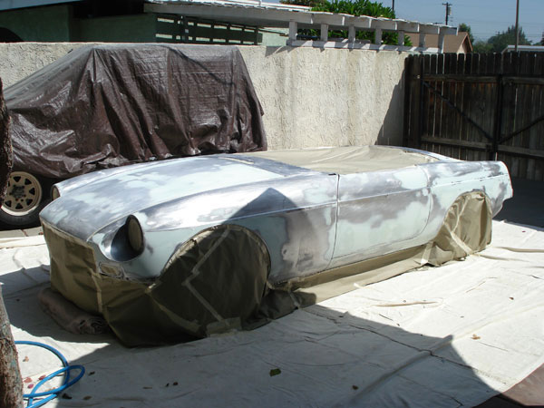

Ready for glazing.
Ready for glazing.
Ready for primer.
Ready for primer.

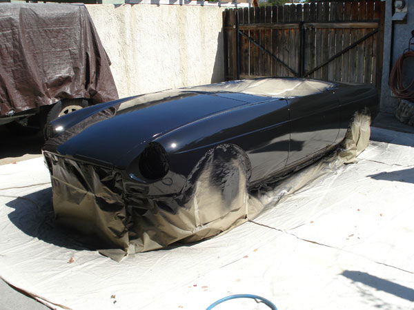

Epoxy primer.
Epoxy primer.

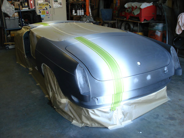

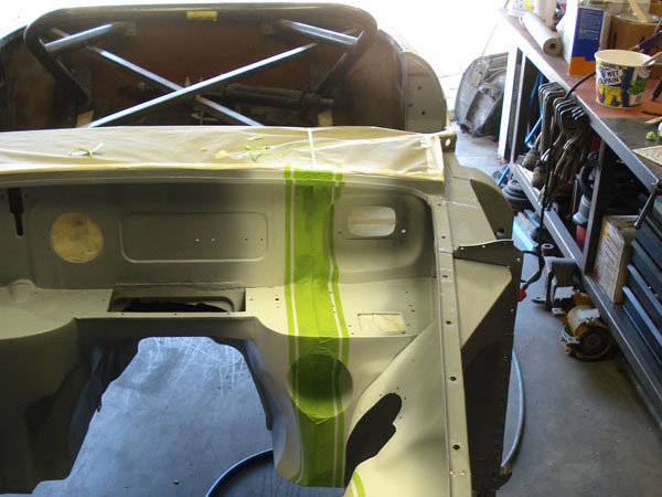

Stripes before color.
