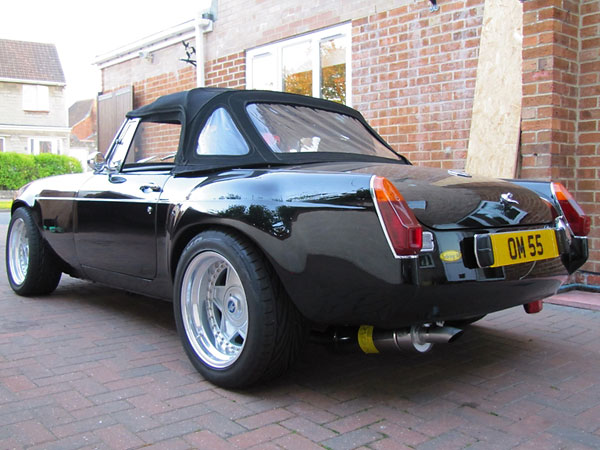

Shaun Hateley's 1980 MGB, upgraded with Rover 3.5L V8 and LT77 5-speed
Shaun Hateley's 1980 MGB with Rover 3.5L V8 and LT77 5-speed

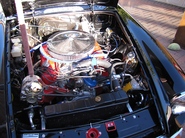

Engine: Rover 3.5L V8
Built by: owner.

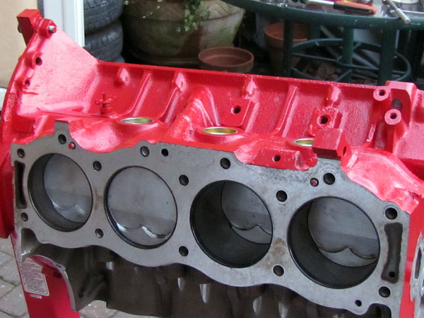

Engine: Rover 3.5L V8 engine. Omega cut-away pistons. Kent 214 camshaft. Stage 1 polished and lightly ported cylinder heads. Waisted valvestems. Upgraded valvesprings. Double roller timing chain. Edelbrock Performer intake manifold. Edelbrock 500cfm carburetor. Opus electronic ignition. Wet sump with upgraded oil pump.

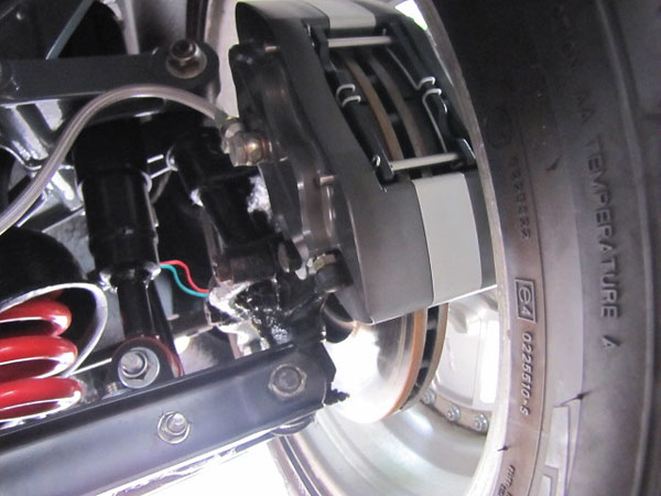

Front Susp.: Frontline Costello telescopic shock absorber conversion. Standard steering rack. Castor reduction wedges. Uprated anti-roll bar.

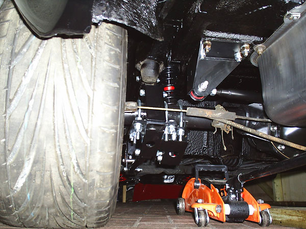

Rear Susp.: Frontline four-link coil-over suspension, with Panhard rod.
Brakes: Wilwood four-pot front calipers and vented rotors. Stock rear brakes.

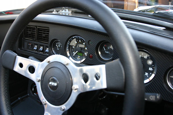

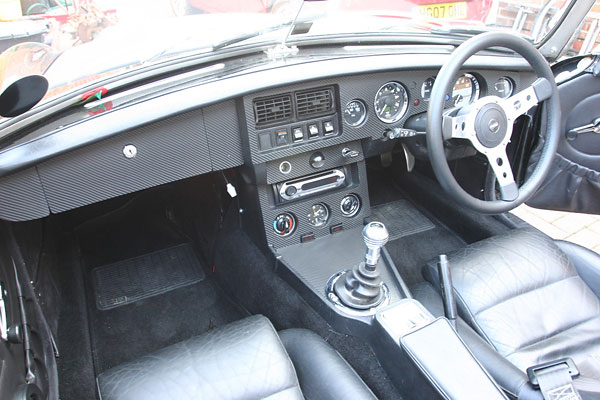

Instruments: Smiths Classic tachometer and electronic speedo conversion.
Interior: converted to righthand drive. Aftermarket steering wheel. Stereo radio.

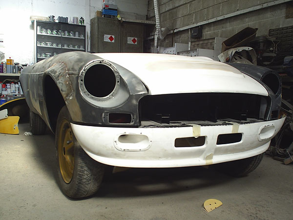

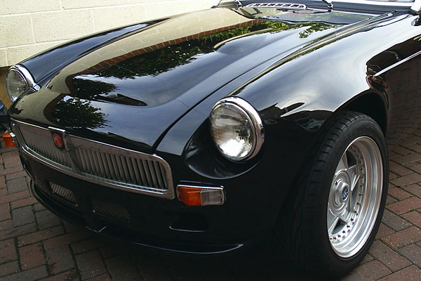

Exterior: steel front fenders with fabricated steel flares. Costello front fiberglass spoiler/valance. Modified MGC-style fiberglass bonnet. Sebring-style fiberglass rear fenders and valance. Swage lines removed and side trim holes welded-up. New mirrors mounted on the quarter lights.

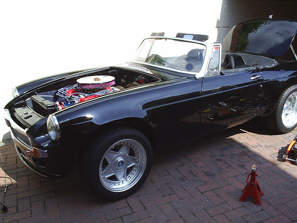

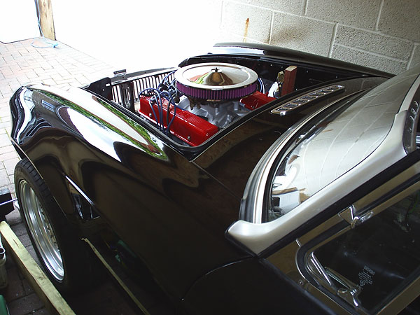

Rover 3.5L V8 engine with Edelbrock 500cfm carburetor.

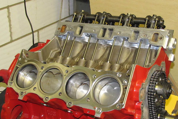

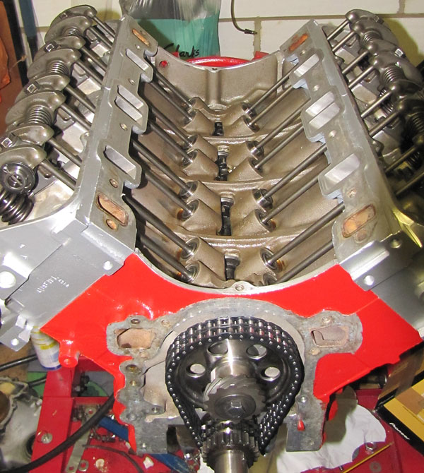

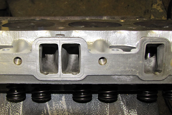

Front Suspension
Frontline Costello telescopic shock absorber conversion. Wilwood big brakes.
Rear Suspension

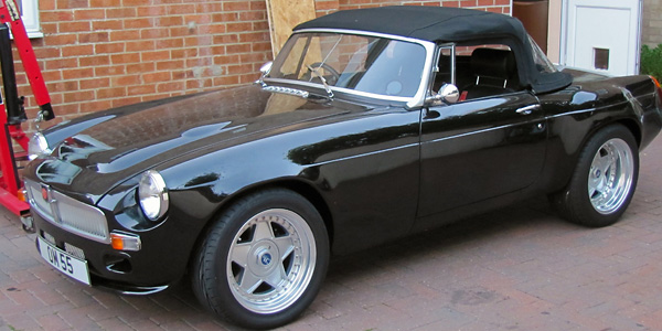

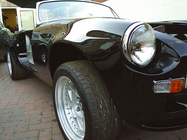

Steel front fenders with fabricated steel flares.

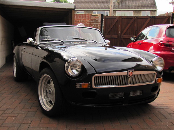

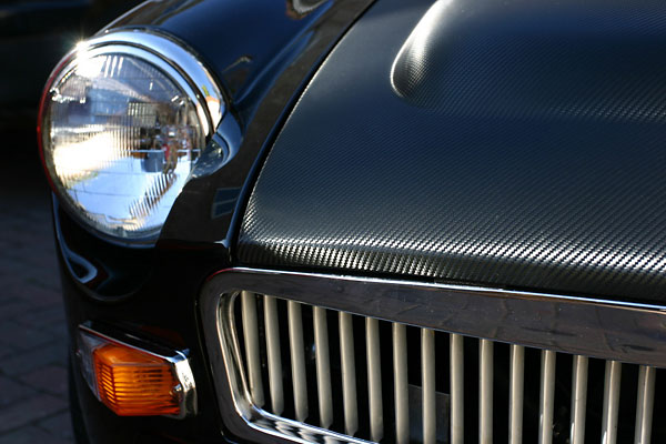

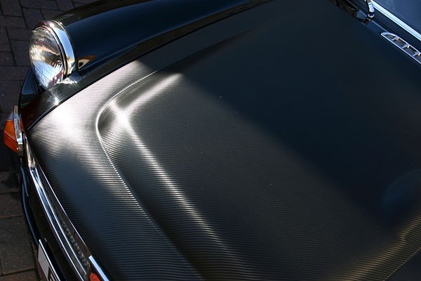

A textured film has been applied over the bonnet to present the appearance of carbon fiber.

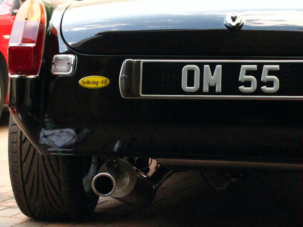

Sebring-V8
Sebring-V8
