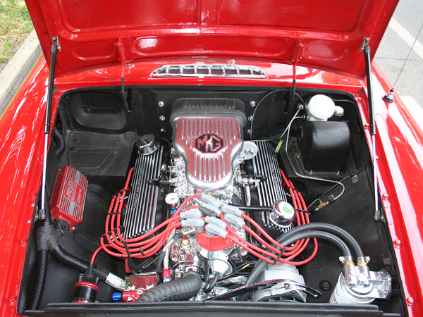

Engine: Ford 289 V8 (from a 1966 Mustang), rebuilt. All engine machine work done by Paul's Custom Grinding in Denver. Engine balanced by Doug's Balancing in Denver. Comp Cams High Energy 268H hydraulic flat-tappet camshaft (part# 31-218-2). Comp Cams High Energy flat tappet lifters (part# 832-16). 1965 Ford 289 stock cast iron cylinder heads. (Ported and polished, and machined for screw-in studs and guide plates.) All new valve seats and guides. Manley stainless steel valves. Comp Cams valve springs, locks and retainers. Comp Cams Ultra Pro Magnum roller rockers, 1.6:1 ratio. Comp Cams High Energy push rods. Edelbrock Performer 289 intake manifold with Endurashine finish (part# 21214). Edelbrock Thunder AVS 500cfm carburetor with manual choke and Endurashine finish (part# 18044). Cowl air induction air cleaner. Carter electric fuel pump. Mr Gasket fuel pressure gauge. Professional Products fuel filter. MSD Pro Billet distributor (part# 8479). MSD Digital 6A (part# 6201). MSD Blaster 2 ignition coil (part# 8202). Accel Hi-Temp Super Stock Spiral Core 8mm spark plug wires. Edelbrock Victor Series water pump with Endurashine finish (part# 88414). Melling high volume oil pump (part# 10688). Ford Motorsport double sump oil pan (for '79-'93 Mustang, modified to relocate drain plug to back). Motorcraft oil filter (part# FL-1A).
Cooling: Northern aluminum radiator. 180° thermostat.
Exhaust: modified Ford iron exhaust manifolds. Jet Hot ceramic coated. FelPro exhaust gaskets. All-stainless steel dual exhaust, featuring flexible couplings. Crossover pipe. Pype's M-80 bullet style stainless steel mufflers. Cherry Bomb double wall exhaust tips, cut short and welded directly to the mufflers.

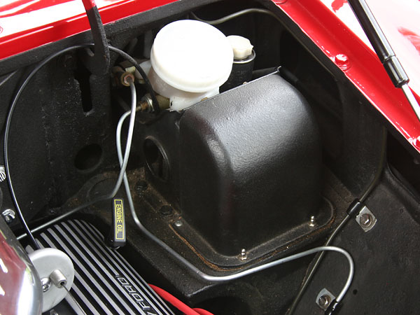

Brakes: stock, with new Lucas master cylinder. New brake lines throughout.

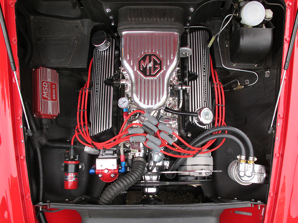

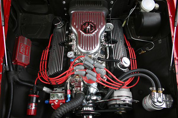

This is a Ford 289cid V8 from a 1966 Mustang. Balanced by Doug's Balancing in Denver.
Let this be a lesson to you!

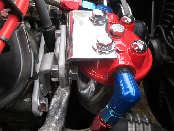

This is actually the second Ford 289 that Scott built for his MGB V8. The first engine died
on initial start-up due to a misplumbed remote oil filter. Scott found a second 289 V8
on CraigsList, and paid just $200 for it. He used the cylinder heads from his first build.

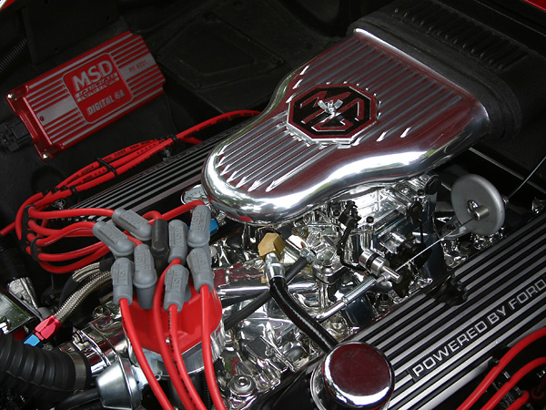

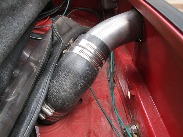

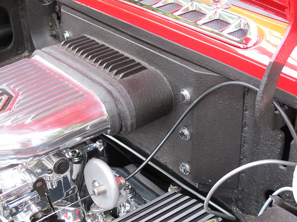

Cal-Custom finned aluminum bug catcher.
Vintage Cal-Custom finned aluminum "bug catcher" carburetor cover (mock Enderle fuel injection
throttle body for a supercharger) modified to serve as part of a cowl induction system.
Air cleaner housing for a rectangular panel air filter.
Air cleaner housing for a rectangular "panel" type air filter.

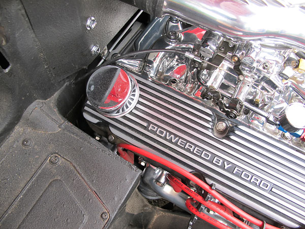

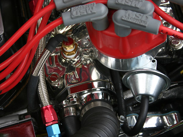

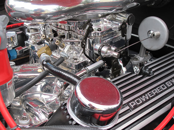

Positive crankcase ventilation.

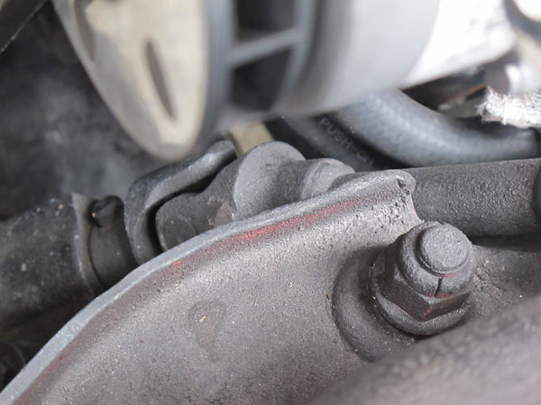

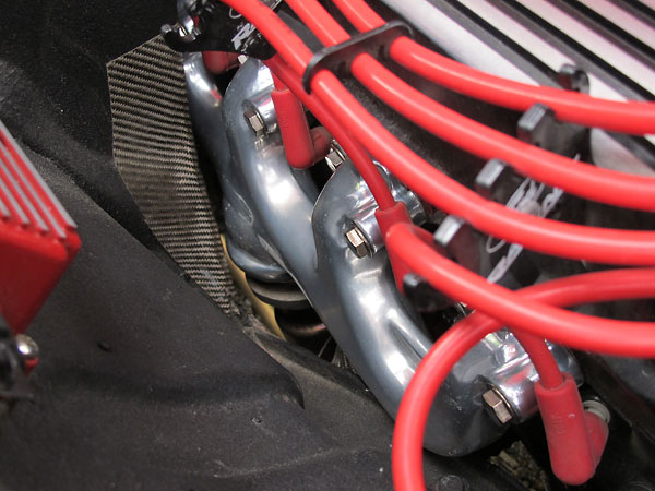

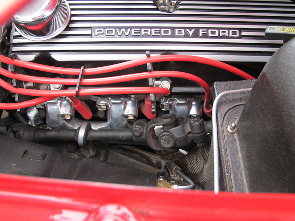

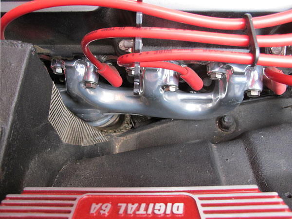

Cast iron exhaust manifolds are trouble-free and quiet.
Scott prefers cast iron exhaust manifolds to tubular headers because they're trouble-free and quiet.
On the driver's side he milled 1/8" off the flange surface for clearance to steering components.
Borgeson steering universal joint.

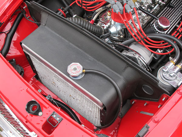

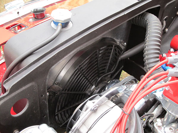

Electric radiator fan mounted on fabricated aluminum fan shroud.
This radiator is shifter about eight inches forward from the stock location.

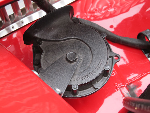

Lucas horn.
Lucas horn.

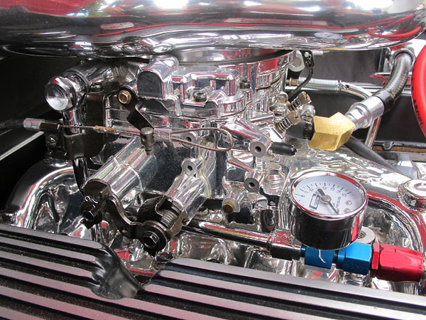

Edelbrock carburetor and Mr Gasket fuel pressure gauge.

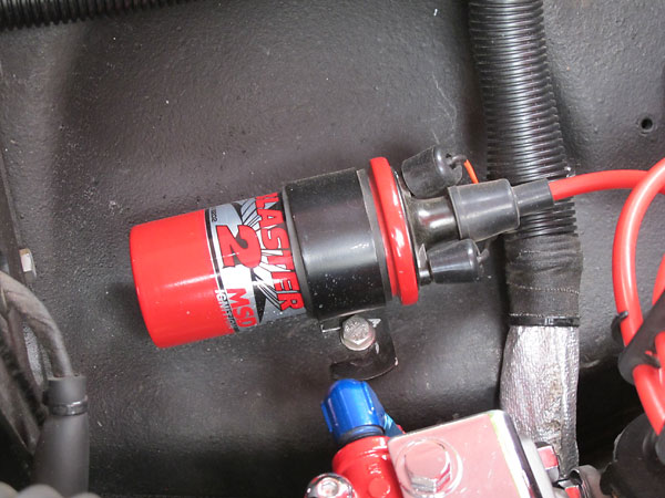

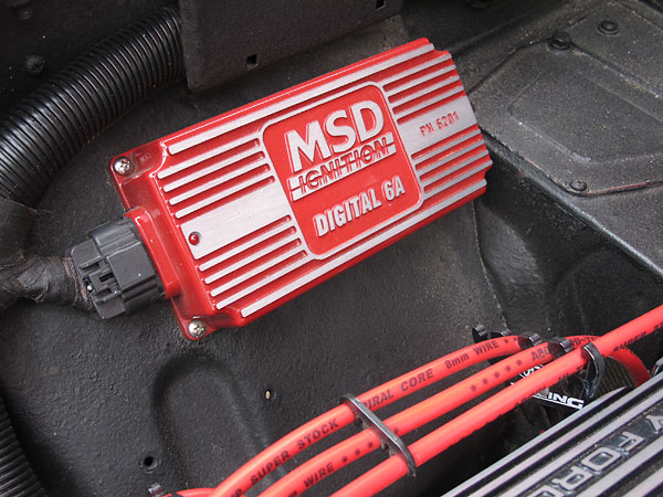

MSD Digital 6A ignition controller (part# 6201).
Fabricated cast-iron exhaust manifold.
Finding a suitable passenger-side manifold proved difficult, so Scott made one by sectioning and
welding together two manifolds. He cut the outlet off the forward half of one and welded it onto the
rear half of the other. Cast iron welding is done with a stick welder and nickel rod, after the parts
are first preheated with an oxy-acetylene torch. The weldment must be allowed to cool slowly too.
Both exhaust manifolds were Jet Hot ceramic coated, and they were installed with Fel-Pro gaskets.

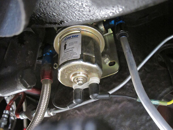

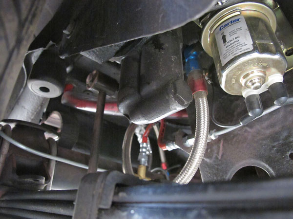

Carter fuel pump needs to be mounted upright, so that the motor is bathed in fuel during operation.
operation. This pump produces a steady 5.5psi, no external regulator is required.

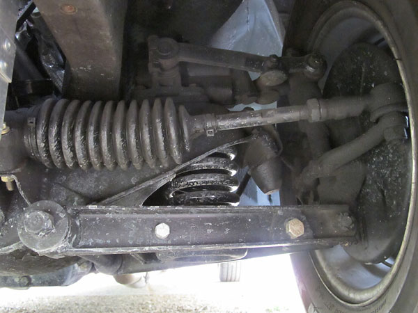

Front Suspension
Stock MGB front suspension, rebuilt with heavy duty lever shock absorbers.

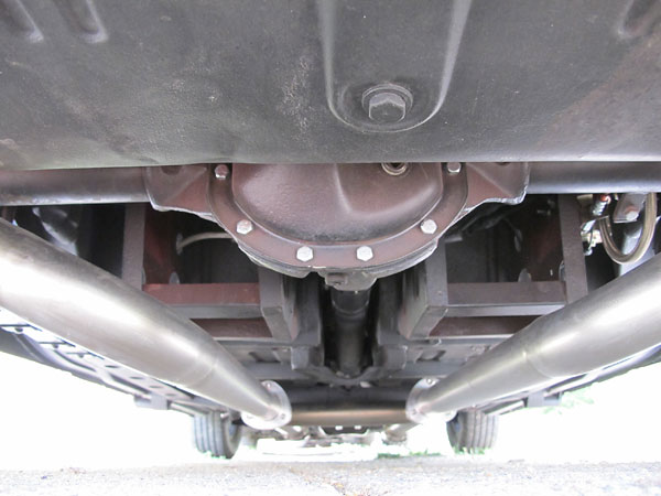

Stock Salisbury (3.909:1) axle. Background: exhaust crossover tube.

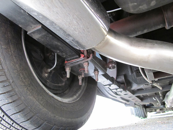

Stock rear suspension, except for red polyurethane bushings and spring pads.

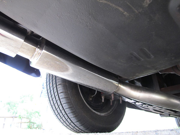

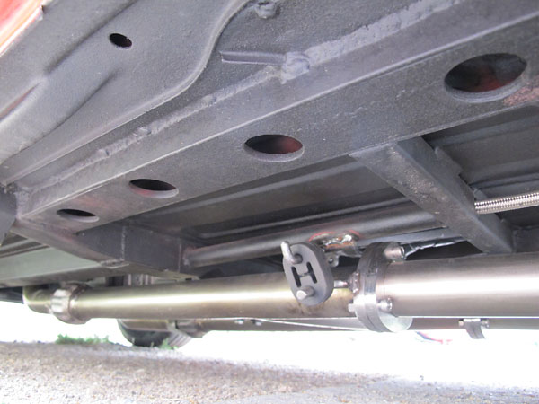

All-stainless steel dual exhaust, featuring flexible couplings and rubber exhaust mounts.

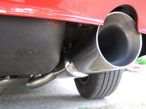

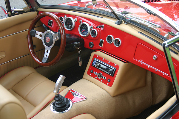

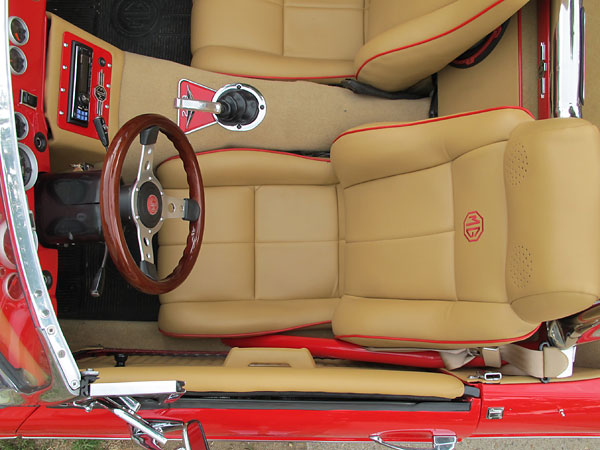

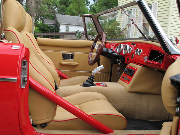

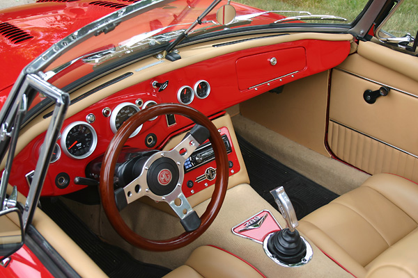

1970 MGB restored with all-new upholstery and carpet.

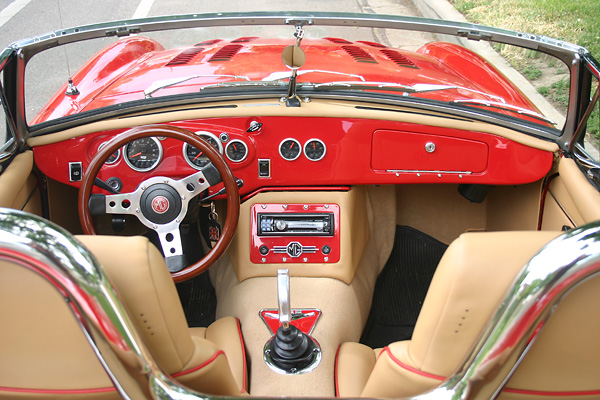

he original Abingdon-pillow style dashboard (circa 1968-72) had been stripped of its foam covering
The original Abingdon-pillow style dashboard (circa 1968-72) had been stripped of its
foam covering, and the underlying steel structure has been modified and refinished.
Scott relocated holes for the gauges, added a glove box, and created a fabric-covered eyebrow.
Custom center console.

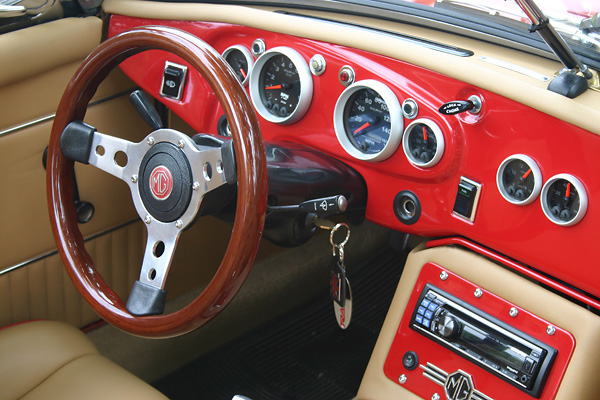

Autometer Elite Series 2 instruments.

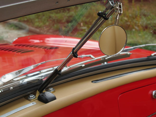

The inspection mirror was temporary... but Scott likes it and he now plans to keep it.
The inspection mirror was "temporary"... but Scott likes it and he now plans to keep it.

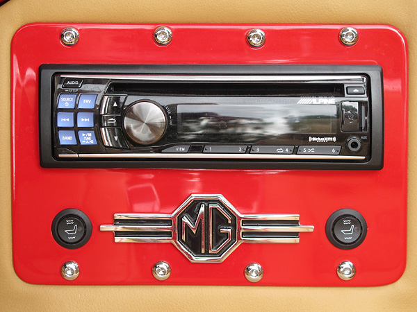

Alpine AM/FM/CD/MP3/Sirius stereo radio. Switches for electric seat heaters.

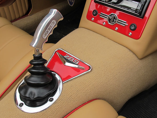

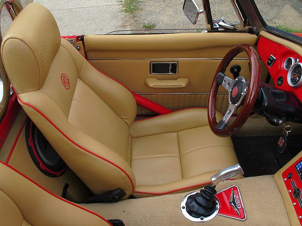

Hurst shifter.
Hurst shifter.

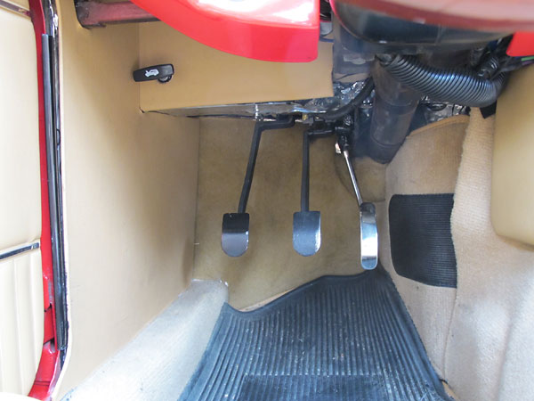

Clutch and brake pedals have been cut-and-rewelded to shift them to the left.
Throttle pedal was made from scratch.

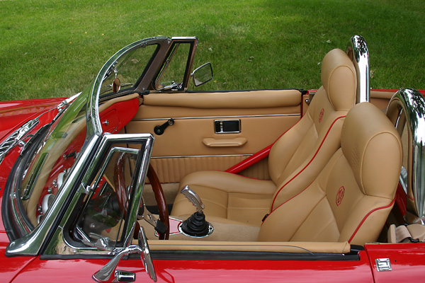

Pontiac Fiero seats.
Pontiac Fiero seats. Seat upholstery by "Mr Mike".

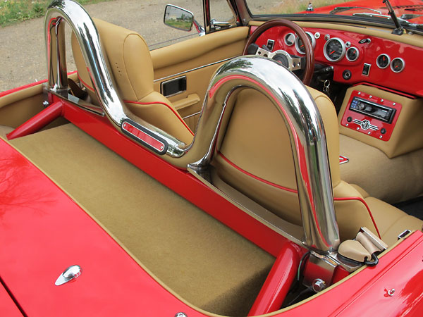

Twin-loop 1990-98 Mazda Miata spec roll hoop.
Scott purchased an inexpensive twin-loop 1990-98 Mazda Miata spec roll hoop
from an eBay vendor, and then created a tubular structure to mount it to.
Forward braces may give a little extra protection in side impacts, and also help stiffen the chassis.
Forward braces may give a little extra protection in side impacts, and they also help stiffen the chassis.

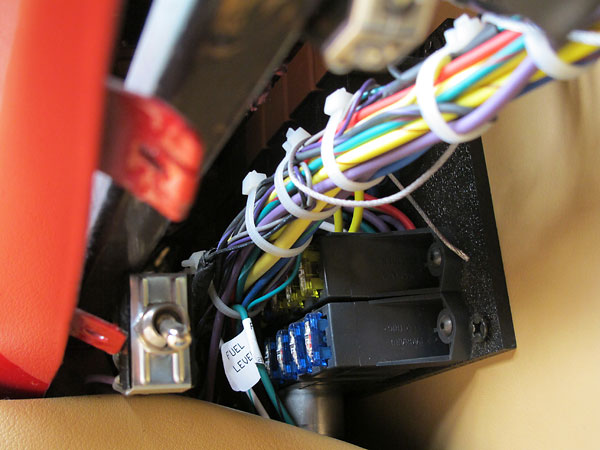

Scott recommends the Advance Auto Wire wiring kit; its relays and fuses may be seen here.
Toggle switch under dash is for 4-way flashers. Scott will move it into the glove box eventually.

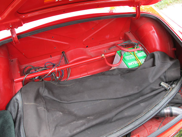

Relocated battery.
The subwoofer enclosure blocks access to the regular MGB battery boxes, so Scott relocated
his battery to the trunk. A large audio system amplifier will be installed here soon.

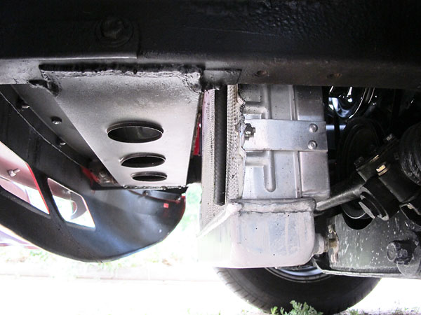

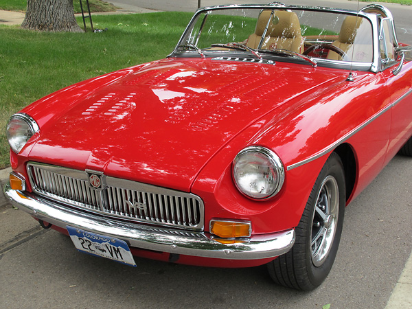

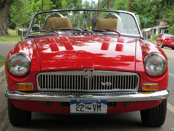

MGB Mk1 front grille. 1973-4 style front valance (with holes for oil cooler.)

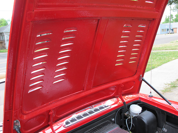

Louvered hood.
Louvered hood.
Scott decided that the louvered hood would benefit from a longitudinal stiffener.

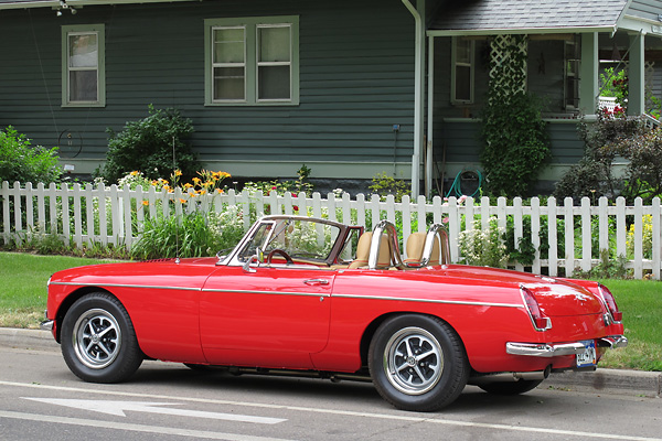

Scott removed ~7 coats of old paint. This MGB was originally painted bronze yellow.
Scott removed ~7 coats of old paint. His MGB was originally painted "bronze yellow".
The new color is Ferrari's Rosso Corsa
The new color is Ferrari's "Rosso Corsa".

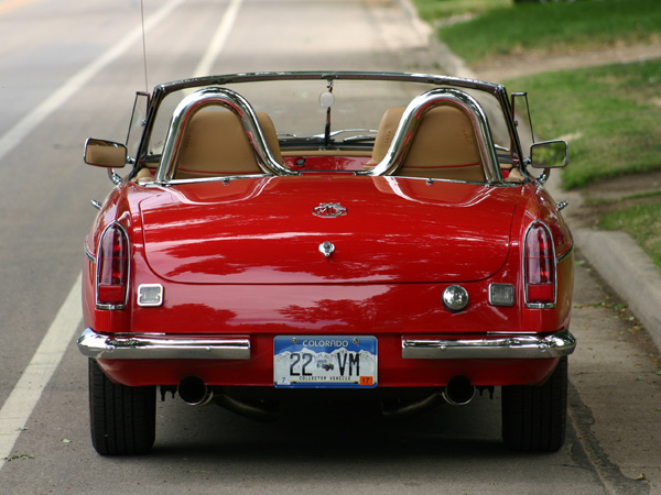

1970-only split rear bumper
Split rear bumpers were only provided on MGBs for one model year - 1970 - and
replacement split bumpers haven't been availabe for years.
The gap in the middle of the split bumper is sized for a U.K.-spec license plate.

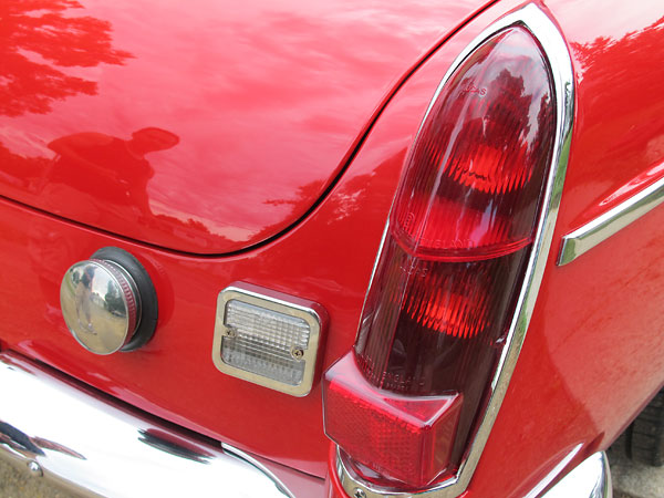

Early MGB taillights. Chromed covers on the backup lights are an accessory.

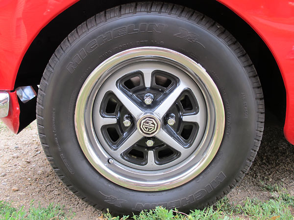

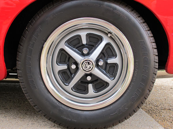

Stock Rostyle 14 x 5.5 steel wheels.
Stock Rostyle 14" x 5.5" steel wheels.
Michelin X-One P185/70R14 tires.
