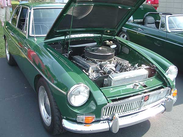

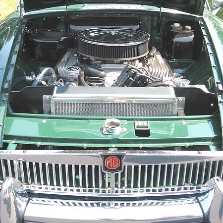

Robert and Susan Milner's 1967 MGB GT with Rover/Buick (293cid)
Robert Milner's 1967 MGB-GT with Rover/Buick 293cid V8
Owner: Robert Milner
City: Manteca, CA
Model: 1967 MGB/GT
Engine: Rover/Buick 293cid V8 (built by D&D)
Engine: Offenhauser intake manifold and valve covers, Isky cam, custom headers (soon to be redone).
Transmission: T-5 5 speed.
Clutch: Centerforce.
Tires/Wheels: 1989 Jaguar XJS wheels, BF Goodrich g-force T/A tires.
Front suspension: Fast Cars Inc.
Rear suspension: Fibreglass springs, tube shocks.
Cooling: custom aluminum radiator (by Air Mobile, AZ), Sidewinder electric fan.
Rear end: 1969 MGC (3.07:1), open differential.
Brakes: Wilwood Vented Rotors and 4-pot calipers (front) / MGC (rear).
Instruments: Stock.
Body/interior mods: air conditioning, cup holders (ex. Toyota, they're hidden in the old speaker console), Les Leston steering wheel.
Weight: 2218 pounds.
Date Completed: Never. (Started 1978.)
Miles Driven: About 150,000 as of the British V8 2006 meet.
Editor's Note: Robert and Susan drove approximately 6500 miles round trip to attend the meet!

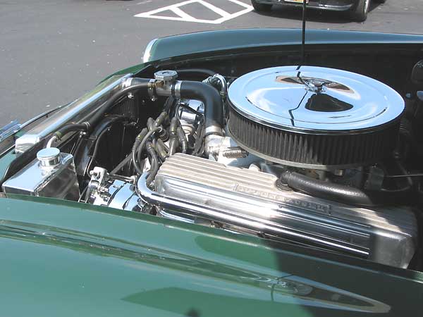

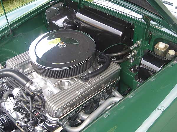

air conditioning system cover made from MGB master-cylinder covers

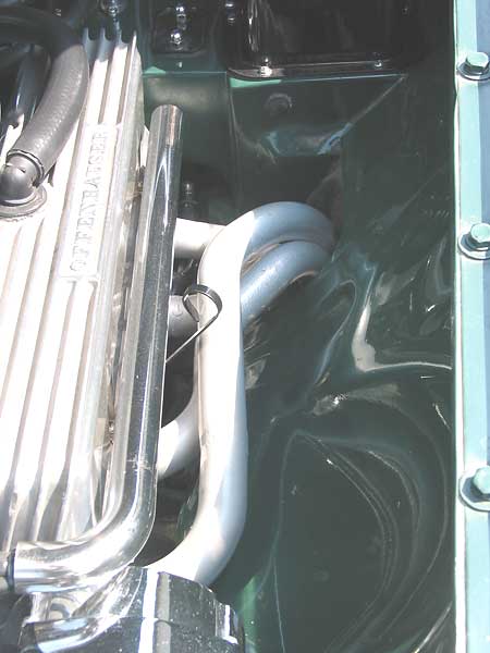

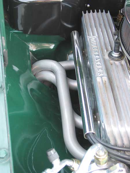

spark plug wire routing, and pre-RV8 through-the-inner-fender headers

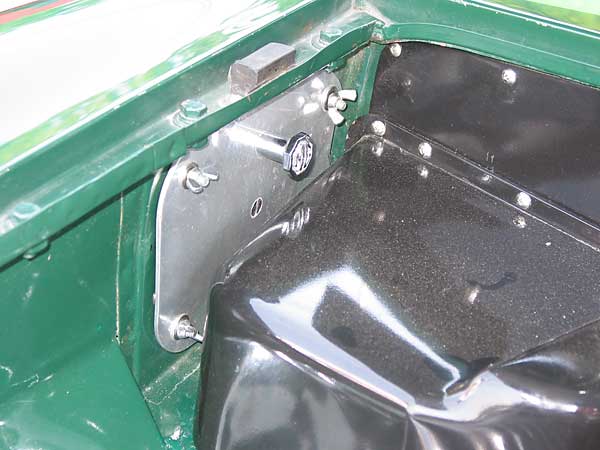

access cover for electrical center (fuseblock, etc.)

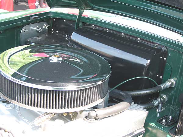

MGB-GT V8 air cleaner

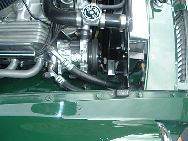

compact air conditioning compressor

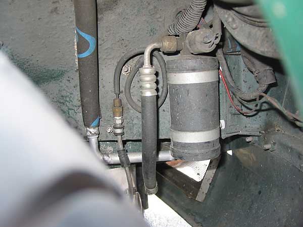

convenient and serviceable location for AC receiver-drier

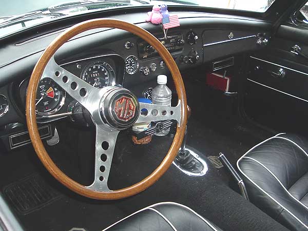

very discrete looking air conditioning vents
very discrete looking air conditioning vents, and cute love-bird mascots on dashboard brow
(NOTICE: the parking brake on this car actually works, so don't forget to disengage it!)

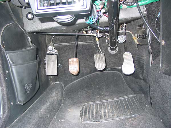

dead pedal, foot-operated high-beam switch, clutch pedal extension
dead pedal, foot-operated high-beam switch, clutch pedal extension...

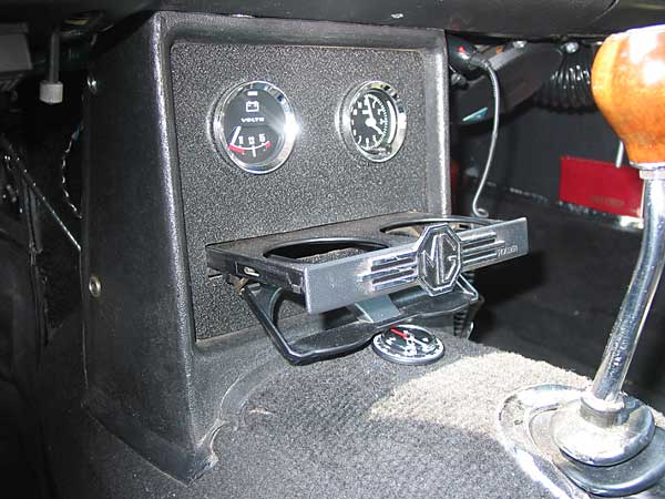

nifty tuck-away cup-holders (ex: Toyota)

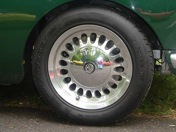

late-model Jaguar wheels

Exhaust system: Headers were home-made with parts from "Headers by Ed" (Minneapolis, MN 612-729-2802). They have flanges, custom collectors, and have all U-bends and miscellaneous parts to make any header for any service. Mine are not a tuned length and are not equal length because of restricted space. They exit out the inner fenders (sounds awful) because of the early body. They "Y" at the transmission to a single 2 1/2" pipe in the original location.
Tires/Wheels: 195/60-15 on spline drive repro Minilites (5.5" by 15").
