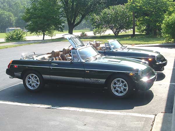

Robert McLain's 1980 MGB-LE with Rover V8
Robert McLain's 1980 MGB-LE with Rover 3.5L V8

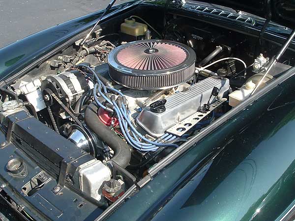

Engine: Rover 3.5L V8 from a 1980 Rover 3500 sedan. Crane camshaft (#621262) with 0.445" lift. Crane lifters (#202HY). Offenhauser intake manifold (#7001). Edelbrock 500cfm 4bbl carburetor. Mallory Unilite distributor (#3764301). Mallory Pro-Master ignition coil (#29440).

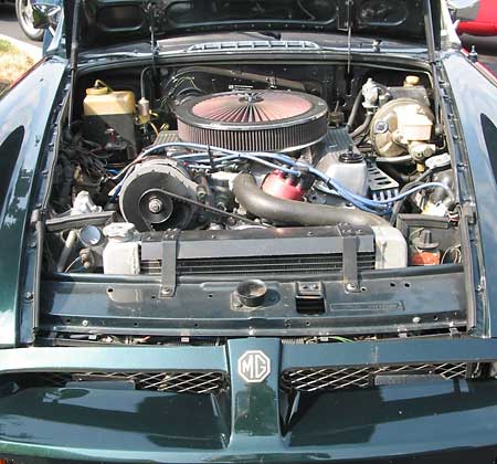

Rover 3.5L V8 from a 1980 Rover 3500 sedan. Offenhauser intake (#7001) & Edelbrock carburetor.
aluminum crossflow radiator
Evidently Bob upgraded to an aluminum crossflow radiator after the original HIWD write-up.

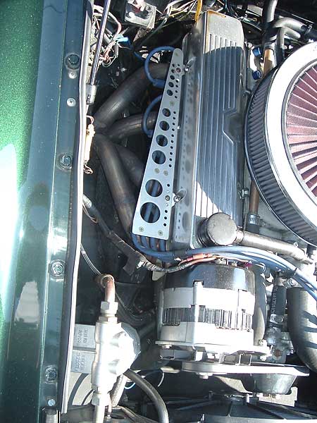

These stainless steel RV8-style (through the fender) headers are a nice upgrade too.
These stainless steel "RV8-style" (through the fender) headers are a nice upgrade too.

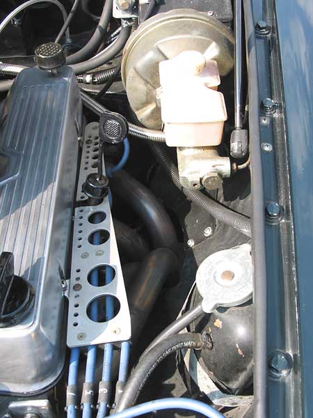

Fancy spark plug wire routing.

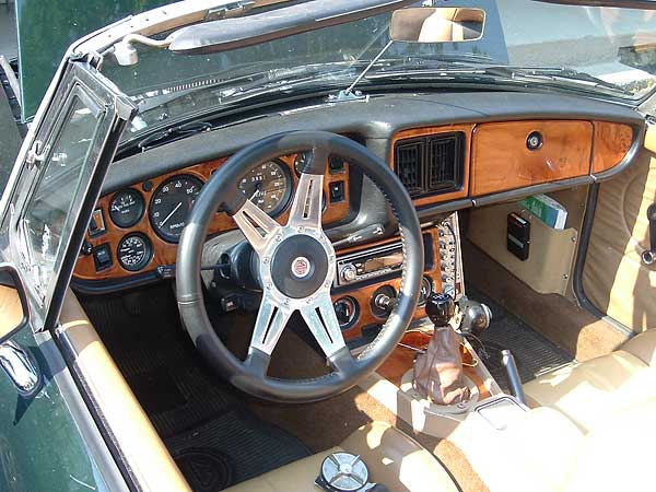

Wood veneer dashboard inserts.
