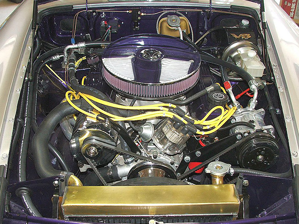

Engine: 3.9 litre Rover; bored and stroked by D&D Fabrications to about 5 litres. Buick 300 crankshaft. Ford pistons. Buick 300 aluminum cylinder heads. Crower camshaft. Stock Buick 300 valve train. Buick 215 4-barrel intake manifold. Edelbrock 500cfm 4-barrel carburetor (model 1404). Delco-Remy (Buick) distributor with Pertronix Ignitor. MSD 6AL capacitive discharge ignition. D&D swiveling oil filter adapter.
Cooling: D&D copper and brass radiator. Brass header tank. Electric fan, pulling.

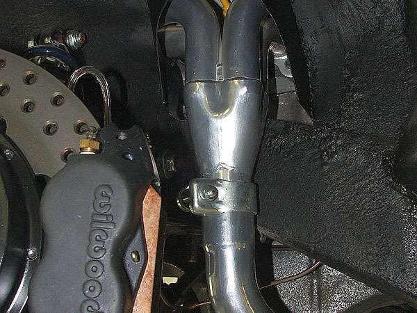

Exhaust: stainless steel RV8-style headers into single exhaust. Magnaflow 20"x6" stainless steel muffler.

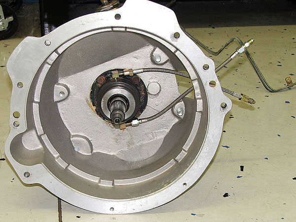

Transmission: Borg Warner T5 5-speed, with 0.63:1 fifth gear. D&D bellhousing. Stock MGB master cylinder. Weber HTOB-style slave cylinder. Chevrolet Camaro clutch disc and pressure plate. Prop shaft from Denny's Driveshaft shop in New Jersey.

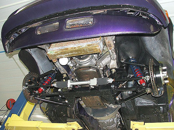

Front Susp.: Fast Cars front suspension assembly (standard width).

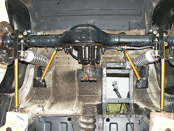

Rear Susp.: Classic Conversions Engineering four-link w/200# springs.

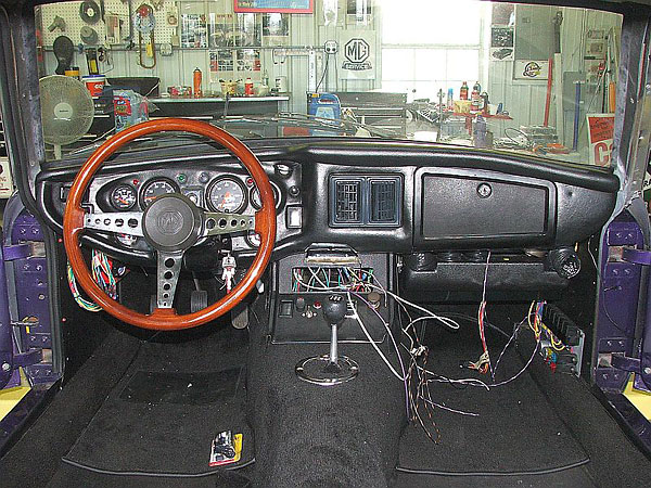

Electrical: aftermarket Delco 100 amp alternator. Stock lighting. Alpine audio system.
Interior: Autometer gauges. Wood rimmed steering wheel. Pontiac Fiero seats, updated with Mr Mike's upholstry. Nostalgic Air a/c unit with heater/defroster. Advance Auto-Wire wiring kit.

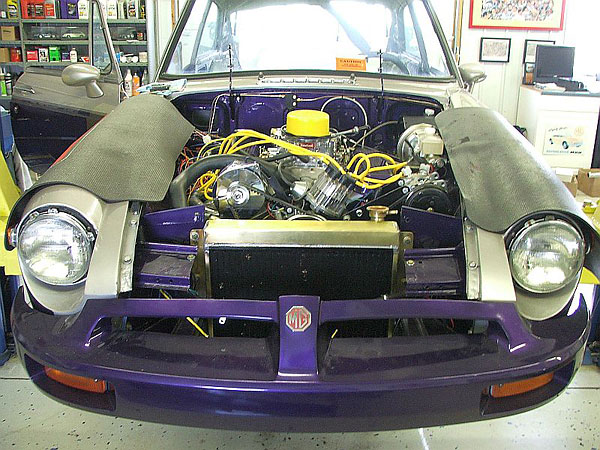

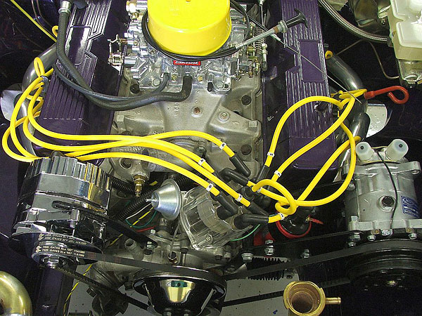

3.9 litre Rover; bored and stroked to about 5 litres.
Buick 215 intake manifold. Edelbrock model 1404 four barrel carburetor.

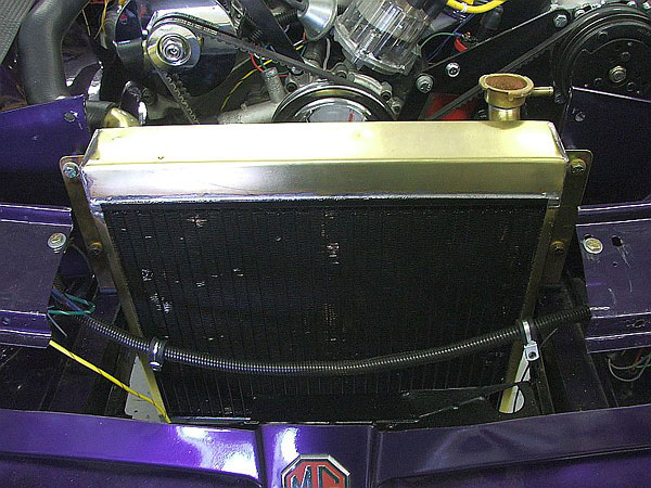

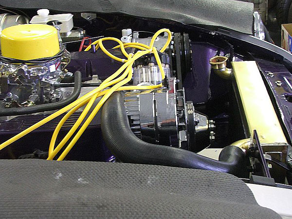

Aftermarket Delco-style 100 amp alternator.

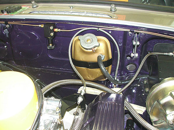

At left: Wilwood brake bias valve. At right: brass coolant header tank.
D&D bellhousing. Weber HTOB-style slave cylinder.

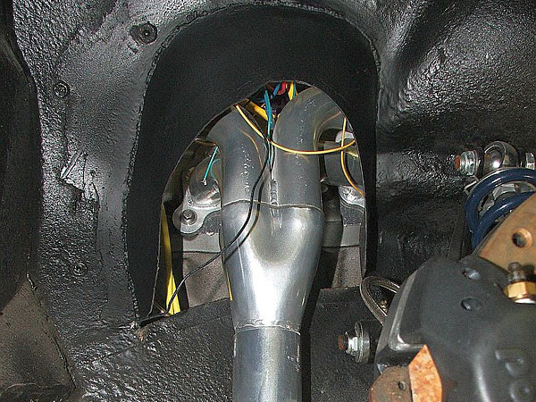

Stainless steel RV8-style exhaust headers.
Stainless steel RV8-style through-the-wing, 4-into-1 exhaust headers.
The headers come down through skirted openings in the inner wings.

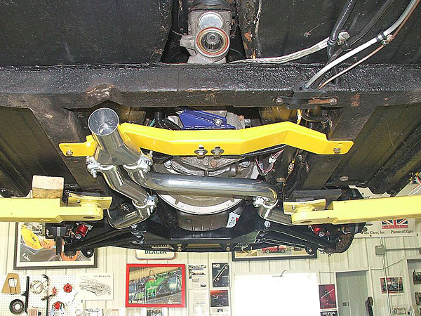

Transmission crossmember, and an adapter for the T5 transmission (in body color!)
Front Suspension

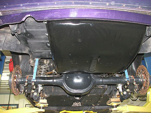

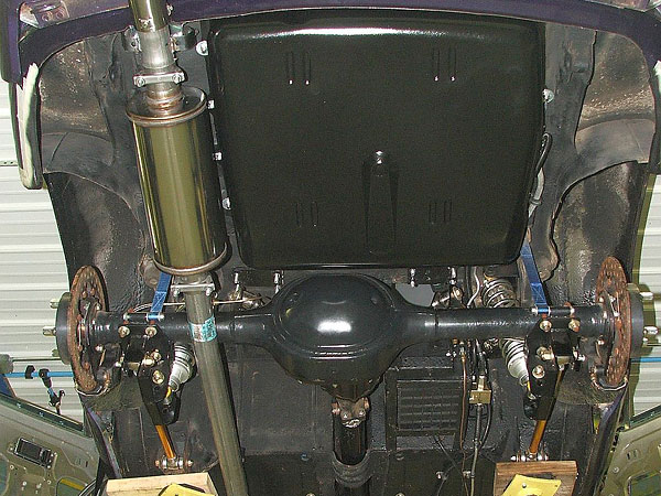

Rear Suspension
Ford 8 inch with Auburn posi and 3.27:1 final drive ratio.
Ford 8" with Auburn posi and 3.27:1 final drive ratio.
Magnaflow 20x6 stainless steel muffler.
Classic Conversion four-link rear suspension with 200# springs.
Classic Conversions Engineering four-link rear suspension with 200# (GT-spec) springs.

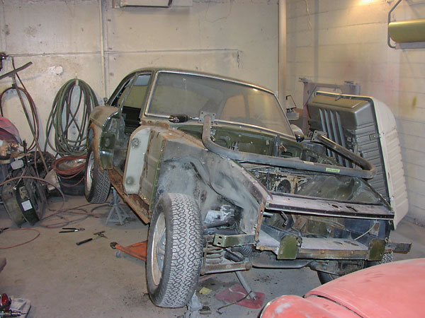

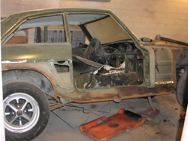

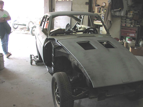

Stripped down rubber bumper MGB GT.
Rust repair in process.

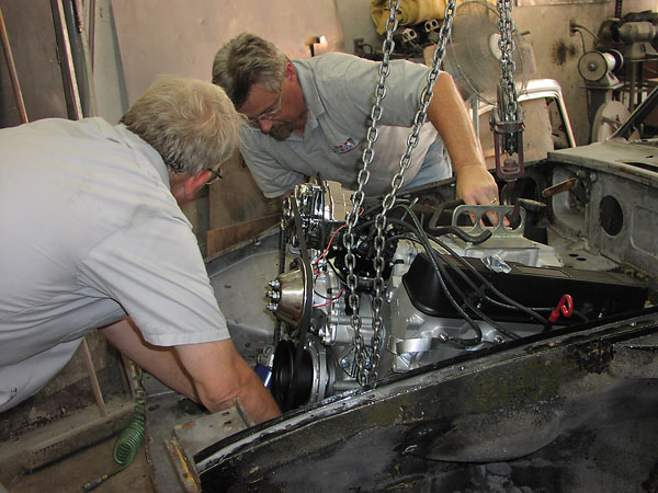

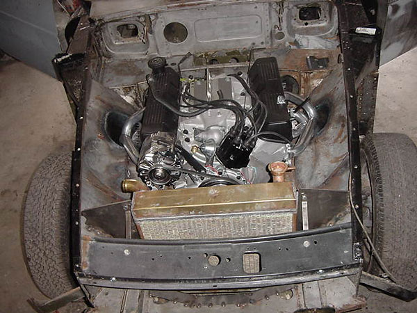

Careful trial installation of the Rover V8 engine.
Trial installation of the radiator on its newly fabricated bracketry.

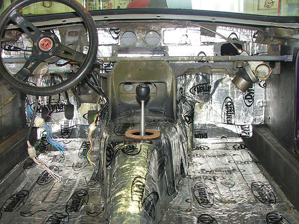

Generous application of Dynamat foil covered sound-deadening mastic.

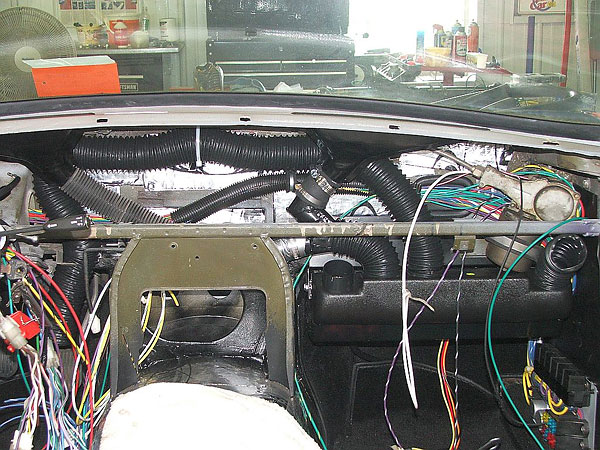

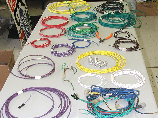

Air conditioning ducts.
Autometer gauges.
Autometer gauges.

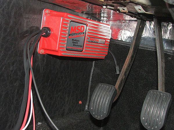

MSD 6AL multi-spark capacitive discharge ignition controller.

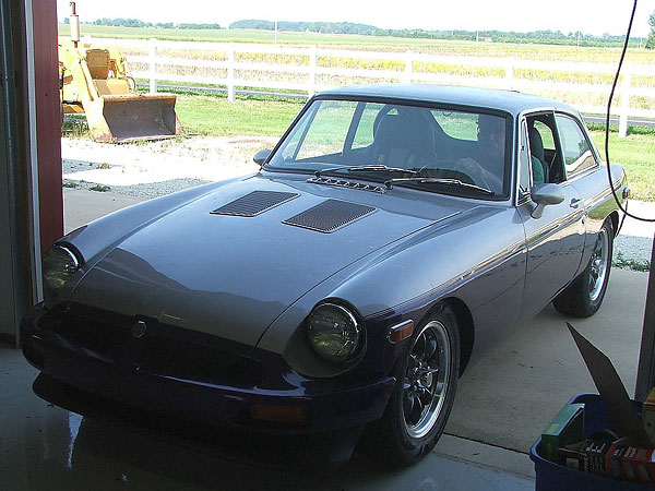

Mid-1980s Chrysler New Yorker bonnet louvers.

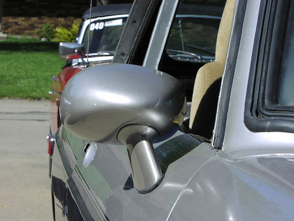

Late 1970s Buick LeSabre mirrors.

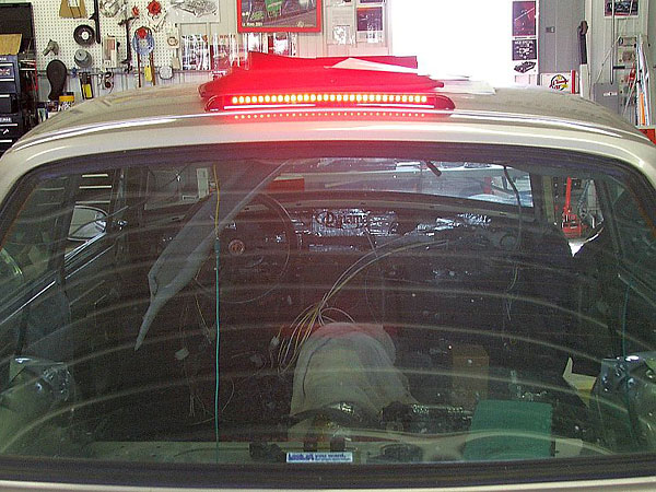

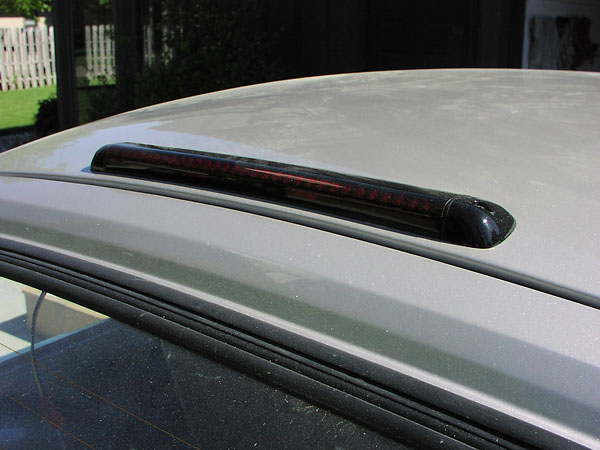

2002 Chevrolet Blazer third brake light.
Illuminated light emiting diodes.

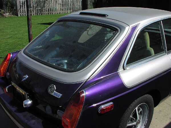

Two-tone DuPont paint (silver over purple).
