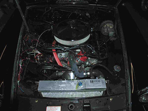

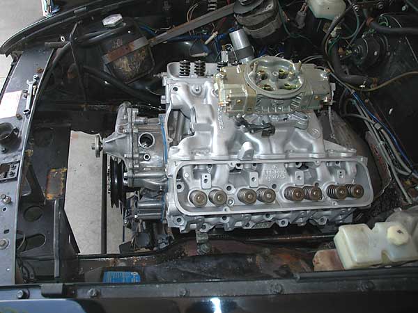

Engine: Started with 1988 Range Rover. Bored it 0.020" over and installed 10.25:1 pistons. Mallory dual point distributor. Balanced to 7500 rpm.
Intake: Offenhauser 5165 (good to 7500 rpm), Holley 390 double-pumper Nascar carb. Works very well!
Electrical: Bought alternator from D&D (Delco, I think) as well as their bracket for it.
Cam: Isky 621270 cam (2500-6500 rpm).

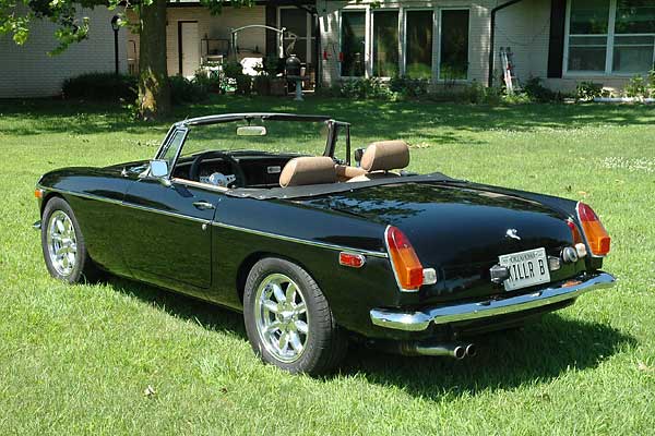

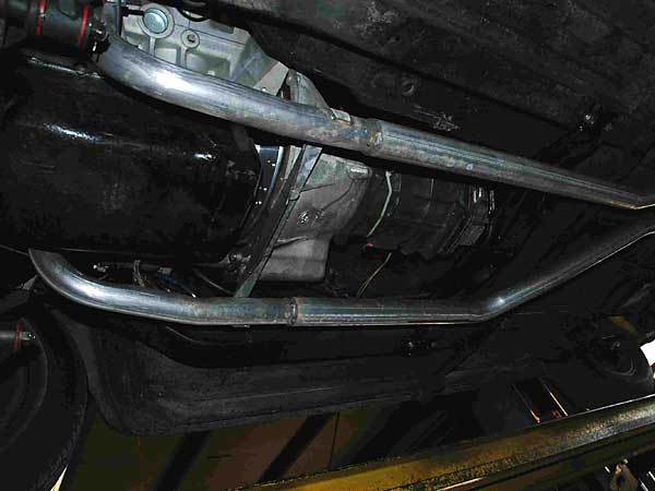

Exhaust: 2.25" stainless steel to Magnaflow (MPE-11378) 2" inlet / 2" outlet muffler. Nice sound and muffler fits where stock rear muffler was.

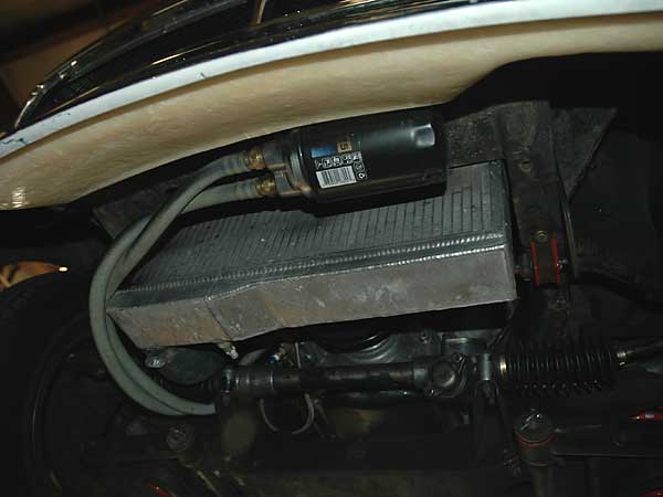

Cooling: Custom made Howe Racing Radiator with 3" core. Electric fan. No cooling issues at all.

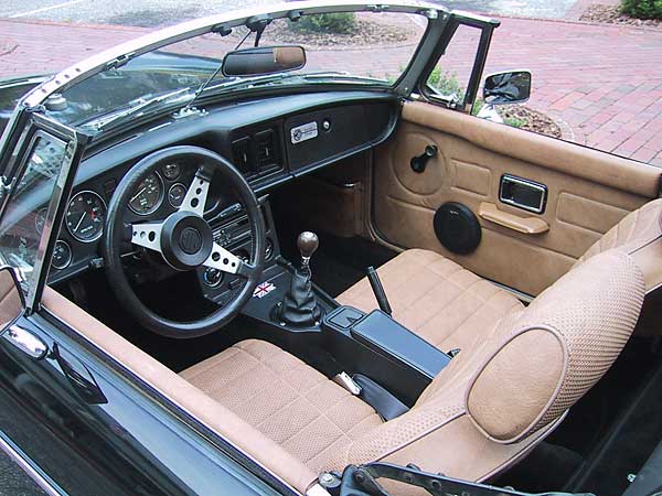

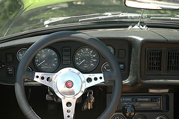

Electrical: I have standard Smiths gauges but my speedo is a 170 mph and the tach is an 8000 range Smith. Looks great, like stock.
Transmission: Rover LT77 5-speed, rebuilt. Custom made driveshaft.

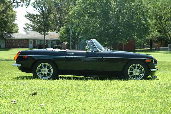

Rear Axle: Stock MGB wire-wheel rear (to get the narrower width) but putting in 3.07:1 gears this winter.
Front Susp.: 550 springs, urethane bushings stock otherwise. (Springs lowered it 2" in front.) It has a nice firm ride and the steering is very light with a balanced quick feel.
Rear Susp.: Special tuning rally springs, with reversed bushing "eyes", they lower the suspension two inches. Urethane bushings and tube shocks. (The changes do add up to a somewhat harsher ride from the rear suspension.)

Comments: Car now sits lower than a stock chrome bumper B, and with the suspension mods it takes corners like it's glued to the road. It's unbelievable how much better it handles.

Wheels/Tires: Minilite polished 15x5.5 wheels (bought from GB) have been installed in lieu of the original LE wheels.
New (larger) Michelin 195/65 HR15 Pilot Exalto tires have also been installed.
1988 Rover 3.5L V8
MGB-LE Interior
170mph speedometer and MotoLita steering wheel
170mph Speedometer and (new) MotoLita Steering Wheel
