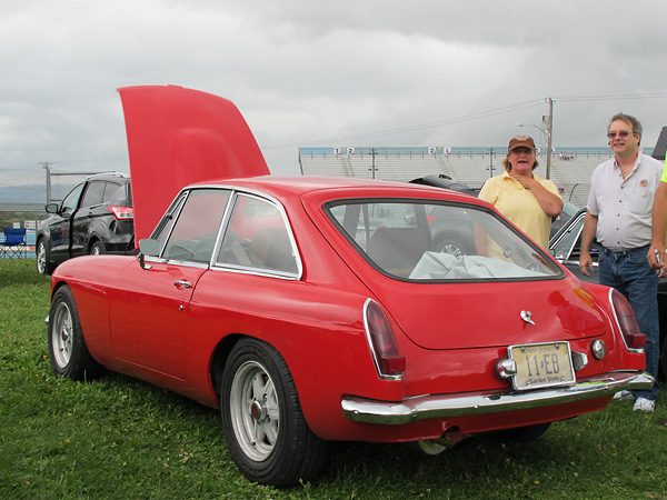

Caroline and Ray Waugh's 1967 MGB GT with GM 2.8L V6 Engine
Owner: Caroline and Ray Waugh
City: Phillipsburg, New Jersey
Model: 1967 MGB GT
Engine: GM 2.8L V6
Conversion by: Bill Guzman, Classic Conversions

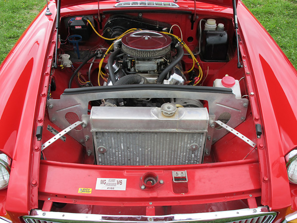

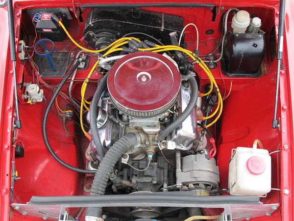

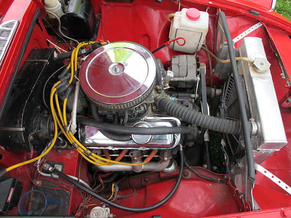

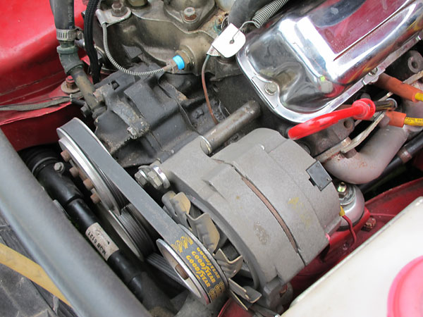

Engine: GM 2.8L V6. Edelbrock lower intake manifold. Classic Conversions Engineering upper intake manifold. Holley 390cfm carburetor. Mallory ProMaster ignition coil. Accel 8mm spark plug wires. Classic Conversions CNC-machined billet aluminum pulleys. Classic Conversions Engineering motor mounts.

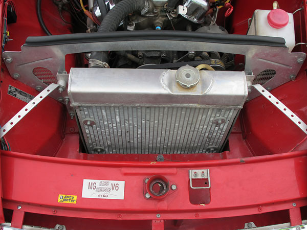

Cooling: aluminum radiator. Electric cooling fan. Custom fabricated aluminum radiator bracket.

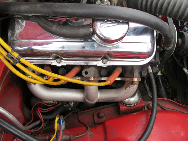

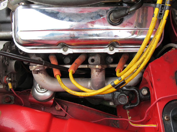

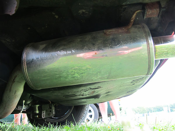

Exhaust: Classic Conversions Engineering headers. Magnaflow muffler.

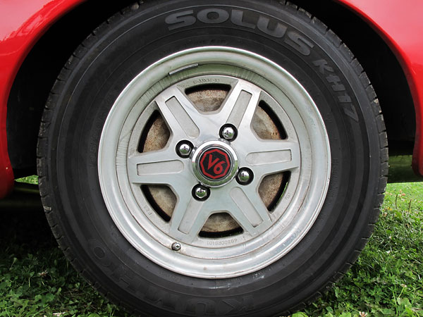

Wheels/Tires: 1981 Datsun 280ZX (14x6) aluminum wheels. Kumho Solus KH17 tires (195/70R14 91H).

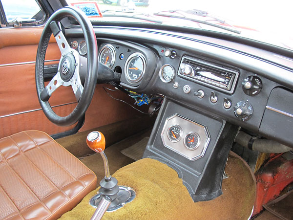

Interior: JVC KD-HDR30 stereo radio/CD. Electric windows.
Instruments: AutoMeter speedometer, tachometer, voltmeter, and clock.

GM 2.8L V6 with Edelbrock lower intake, Classic Conversions upper intake and Holley carb.
GM 2.8L V6 with Edelbrock lower intake, Classic Conversions upper intake and Holley 390cfm carb.

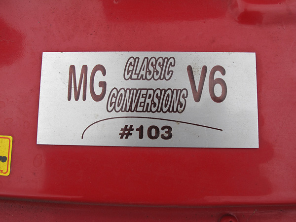

Classic Conversions MG V6 #103
This car was formerly owned by Bill Guzman of Classic Conversions Engineering, who
used it to test and evaluate various parts he has developed for MGB.

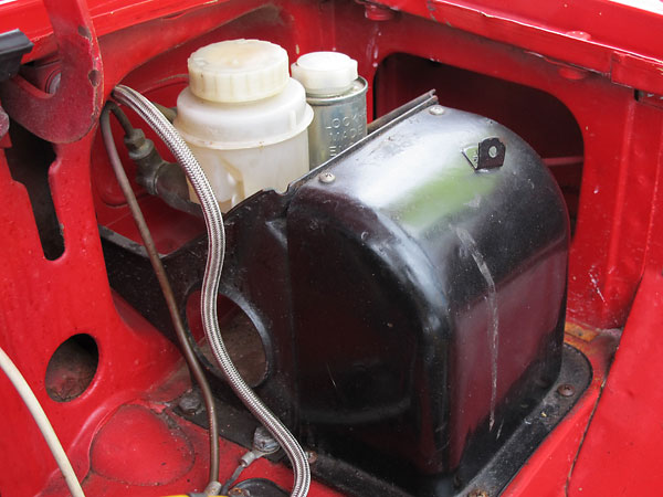

Brake and clutch master cylinders.
Classic Conversions Engineering exhaust headers.

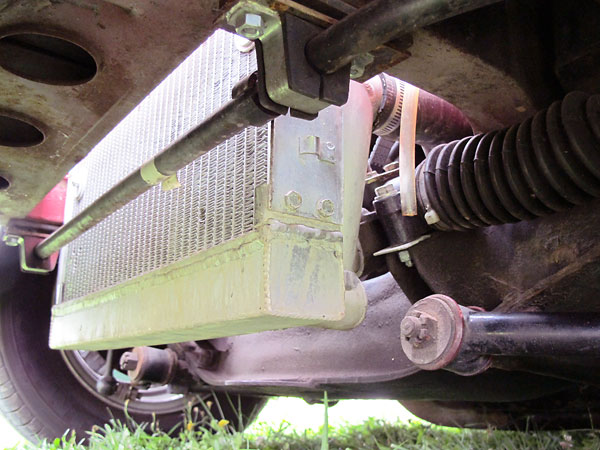

Aluminum radiator.
Aluminum radiator.

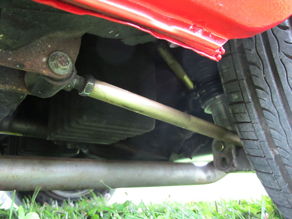

Front anti-sway bar.

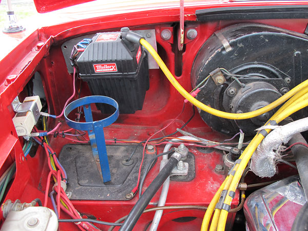

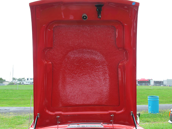

Preform Resources MG RV8 style fiberglass hood.

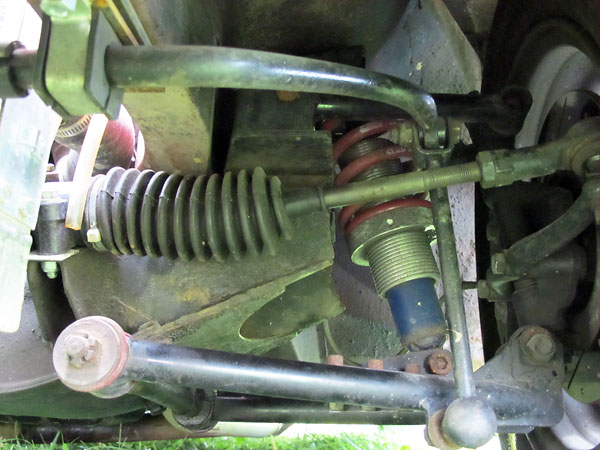

Suspension
First generation Classic Conversions Engineering coilover front suspension.
First-generation Classic Conversions Engineering coilover front suspension.
(CCE now offers a very different design featuring ball joints in lieu of kingpins, etc.)

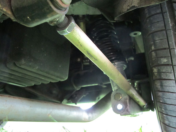

Classic Conversions Engineering 4-link coilover rear suspension.

Magnaflow muffler.
Magnaflow muffler.

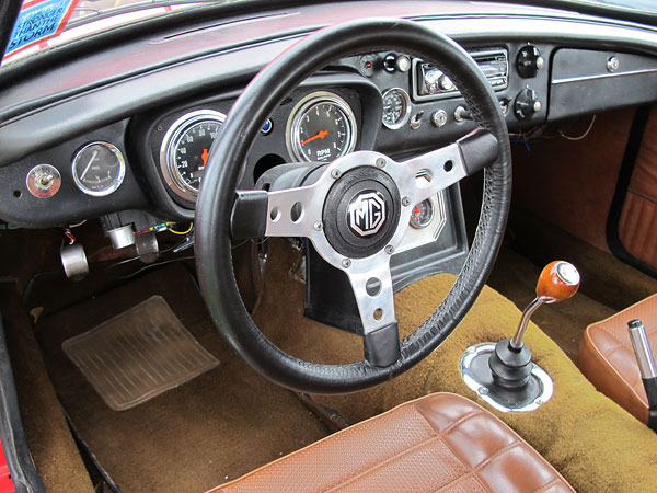

AutoMeter speedometer, tachometer, voltmeter, and clock. JVC stereo.
Leather wrapped aftermarket steering wheel.

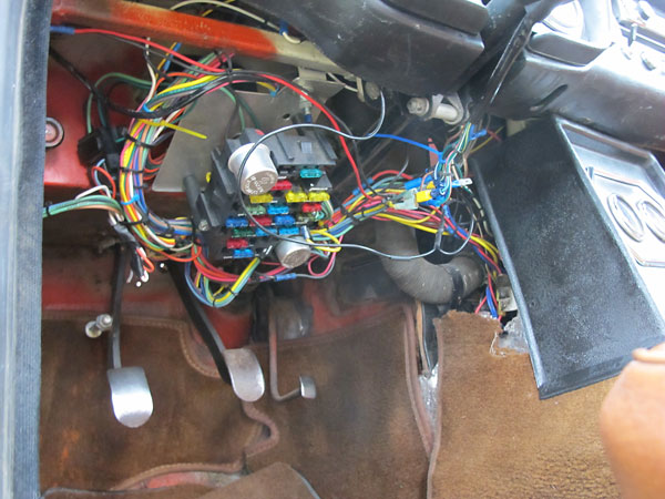

The fuseblock of a Painless Performance Products wiring harness.

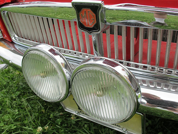

Driving lights.
Driving lights.

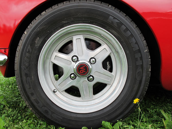

1981 Datsun 280ZX (14x6) aluminum wheels. JWL logo.
1981 Datsun 280ZX (14x6) aluminum wheels. Note: if you look very closely you'll see a stylized
"JWL" logo at 4 o'clock. Nearly every alloy wheel manufacturer in the world casts that same mark
into their wheels to indicate their compliance with a Japanese government safety standard.
Photos by Curtis Jacobson for BritishV8.org. Copyright 2014. All rights reserved. Use by written permission only. (Do not print, copy to your hard drive, or post these online without permission.)
