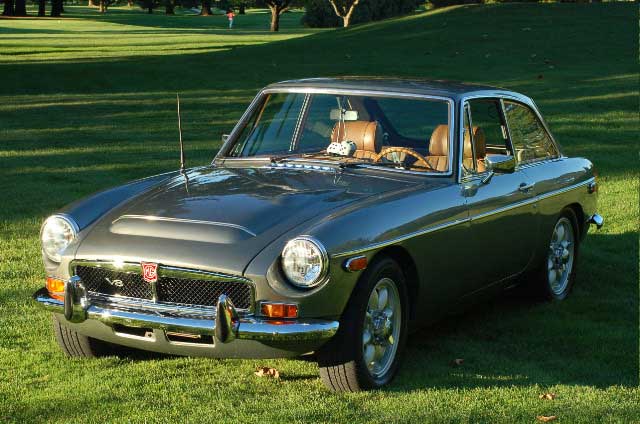

Phillip Taggart's 1973 MGB-GT with Buick 215 V8
Owner: Phillip Taggart
City: Eugene OR
Model: 1973 MGB-GT
Engine: Buick 215 V8
Conversion by: Joe Potter, at "Sports Car Shop" in Eugene OR

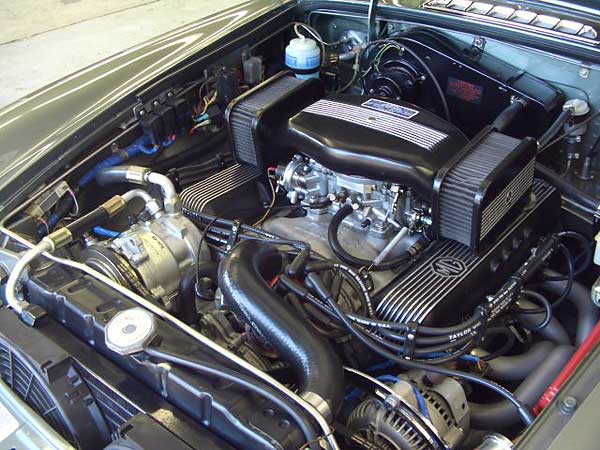

Engine: 215 cid Buick V8 (rebuilt and balanced),
mild aftermarket cam,
500cfm Edelbrock carb,
dual-port Offenhauser manifold,
Holley "Hi-Tek" air cleaner,
Mallory electronic ignition.
Transmission: Borg-Warner T5 5-speed.
Rear Axle: MGC (with 3.07:1 gear ratio).
Interior: air conditioning,
power windows (with switches installed on side of center console),
Alpine keyless entry and security system,
real wood door cappings, door pulls, shifter knob, and steering wheel.
Body/Paint: MGC bonnet. The firewall from a rubber-bumper MGB was grafted in, so no other firewall modifications were necessary. (The front crossmember is also from a rubber-bumper car.) 1999 Ford Crown Victoria "Spruce Green" two-stage urethane paint.
Wheels/Tires: Minilites with true knockoffs.
Miles: 16190, as of June 2007.

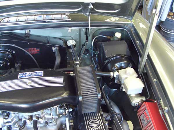

Holley Hi-Tek Air Cleaner
Holley "Hi-Tek" Air Cleaner
RV8-Style Thru-The-Wing Headers

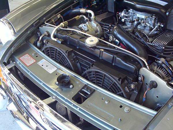

Twin electric cooling fans

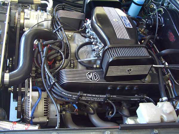

MSD ignition
MSD ignition

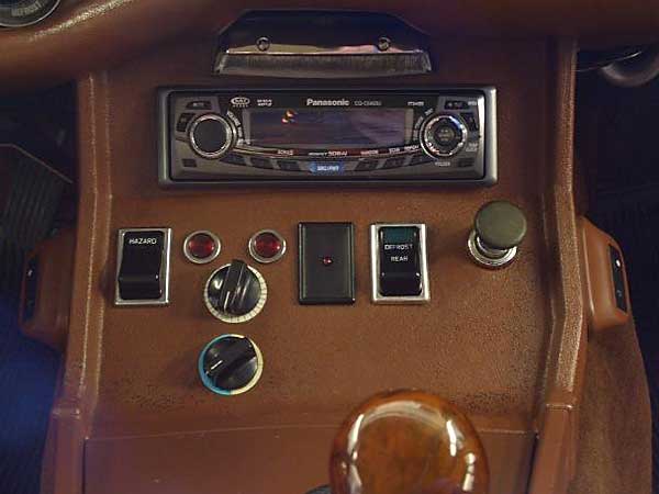

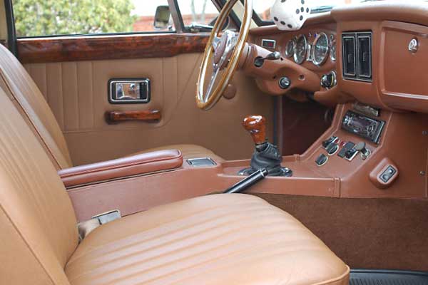

MGB-GT interior with custom wood trim
MGB-GT Interior with Custom Wood Trim
MGB Center Console with HVAC Controls

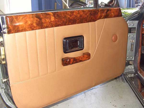

Burled walnut door trim.

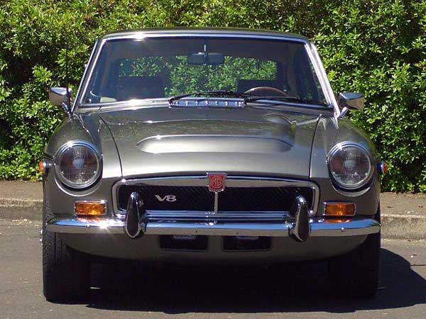

MGC-style bonnet.
MGC-style bonnet.

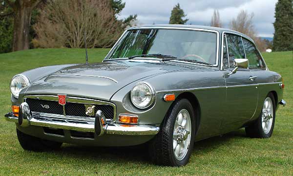

1999 Ford Crown Victoria Spruce Green paint
1999 Ford Crown Victoria Spruce Green paint.

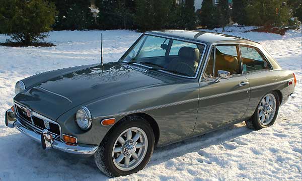

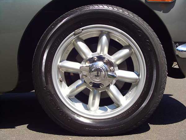

MGB-GT in the Snow
MGB-GT in the Snow.
