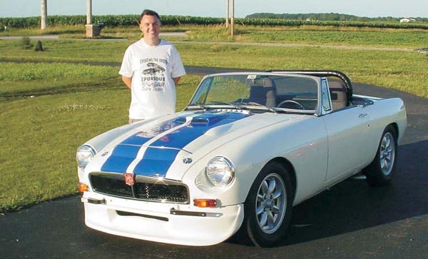

Pete Mantell's 1969 MGB with Ford 302 V8

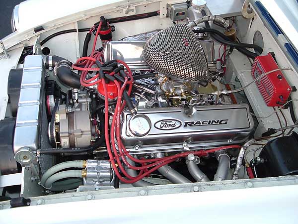

Engine: Ford 1990 302 (5 liter)
Engine: 2004 Ford 302 (stroked to 342cid) crate motor M-6007-A342, dynoed at factory 400HP, 390ft.lbs. torque. (Previously Pete had installed a 1990 Ford 302 with Edelbrock cam and aluminum SVO x303 heads.)
Intake: Edelbrock "Performer 289" manifold and 600cfm Edelbrock carburetor (electric choke).
Cam: F303.
Engine Electrical: MSD 8579 distributor, 6AL ignition box with rev limiter, and MSD "Blaster" coil.
Cooling: Griffin aluminum radiator, Ford Motorsport short neck regular flow pump, and twin 10 inch Summit cooling fans.
Motor Mounts: 64 Comet 289.
Exhaust: Mantell Motorsport headers stainless Summit Racing mufflers exiting just in front of rear wheels.

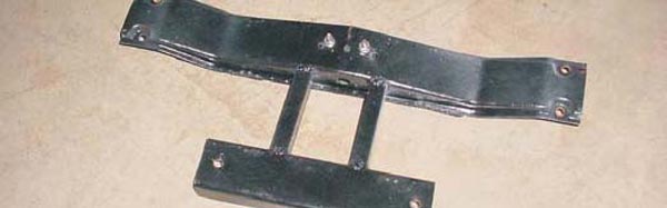

Modified and strengthened MGB tranny crossmember.

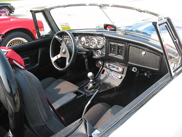

Interior: Miata Seats with RCI 4 point harnesses. Grant steering wheel.

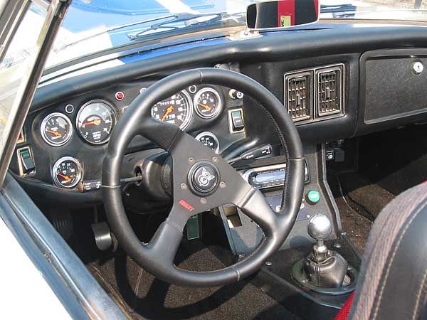

Electrical: Autometer gauges. 12-circuit Painless universal wiring harness.

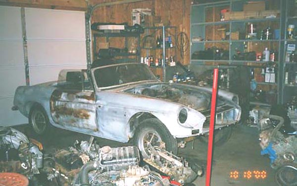

From this lowly beginning!
From this Lowly Beginning!

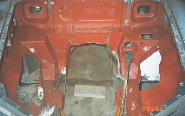

Body modifications
Body Modifications

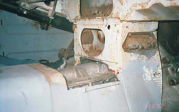

Transmission tunnel mods
Transmission Tunnel Mods

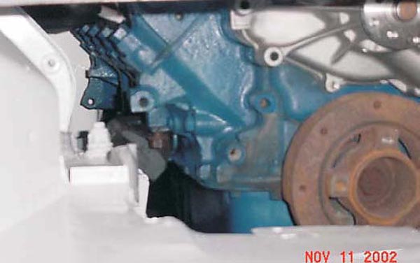

Motor mount, passenger-side
Motor Mount (passenger-side)

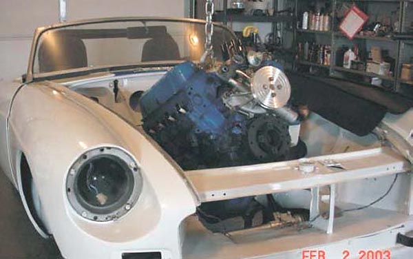

Engine in place for a trial fitting
Trial Fitting of the Engine

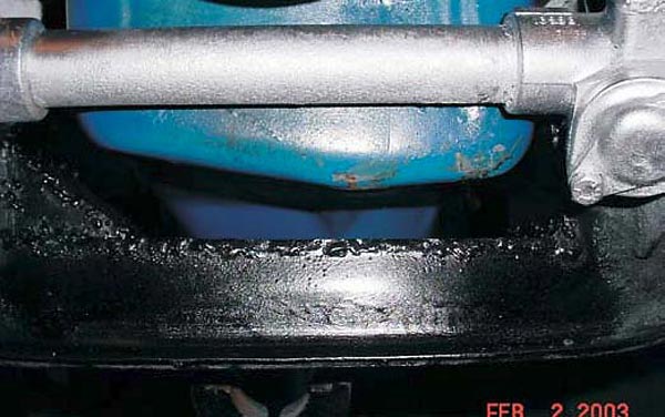

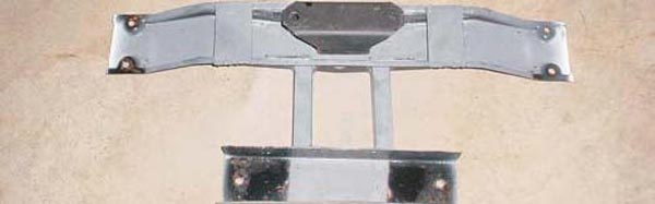

Modified crossmember to allow for oil pan clearance
Modified Crossmember for Oil Pan Clearance

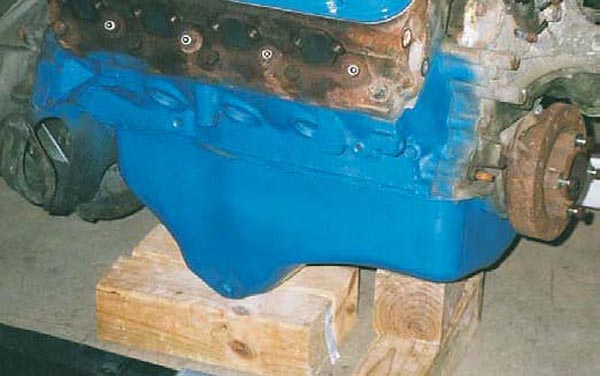

Bronco oil pan (rear sump)
Ford Bronco Oil Pan (rear sump)

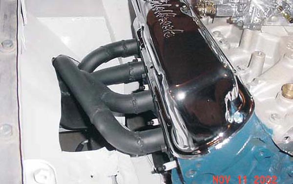

Fender cutouts for the exhaust
Cutouts for Exhaust

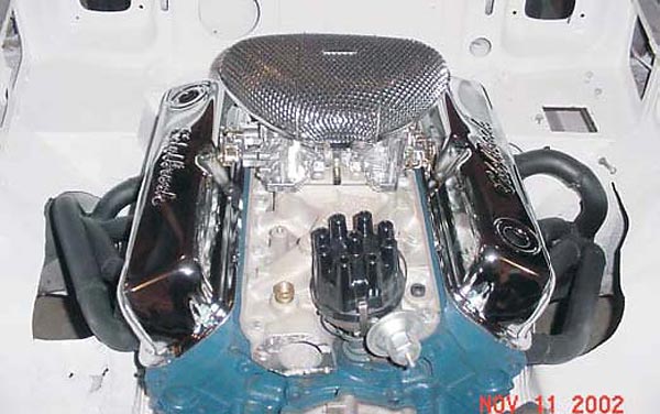

Engine going in one more time, for one more trial fitting
Another Trial Fitting

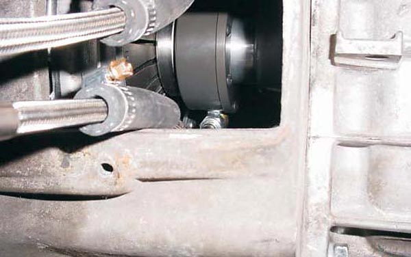

Hydraulic throw-out bearing and fittings
Hydraulic Throw-Out Bearing (HTOB) and Fittings

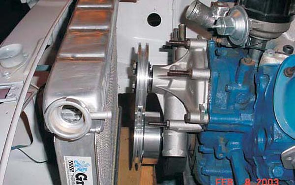

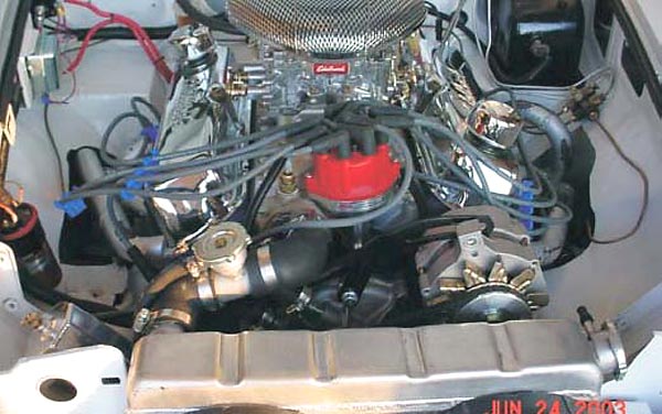

Crossflow radiator installed as a downflow to ease installation
Crossflow Radiator Installed as a Downflow to Ease Installation

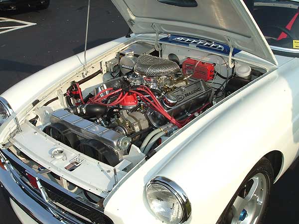

Engine in Place, Ready to Run
Engine in Place, Ready to Run!

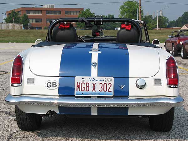

sculpted leather wrapped steering wheel

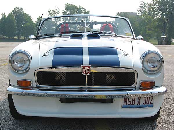

MGB front view
MGB X 302

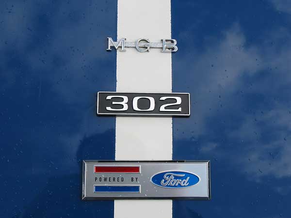

Powered-by-Ford badge

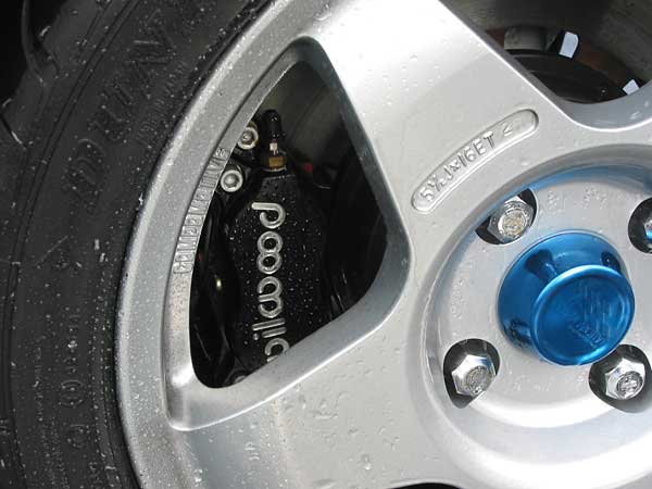

Compomotive MO wheels and Wilwood brakes
Pete Mantell
