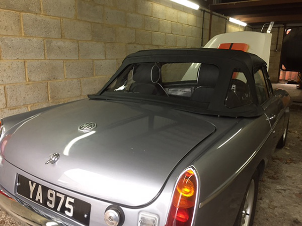

Nigel Cooper's 1967 MGB with Small Block Ford V8

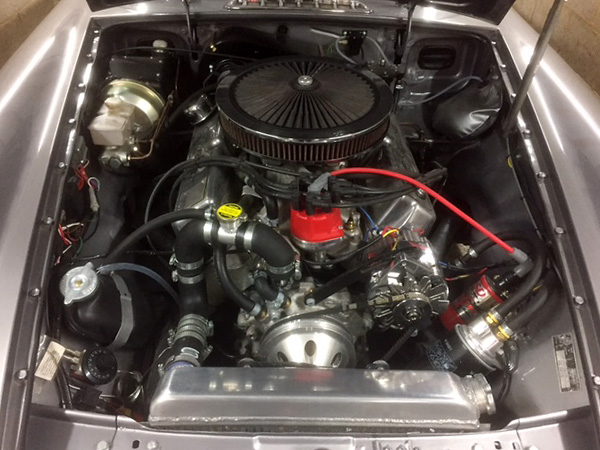

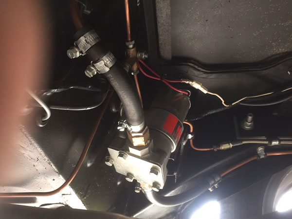

Engine: crate engine from Roadcraft UK (rated 367bhp). Hydraulic roller camshaft. Edelbrock Performer aluminum cylinder heads with 2.02" inlet and 1.60" exhaust valves. Ford Racing aluminum valve covers. Edelbrock Performer intake manifold. Edelbrock Performer carburetor. Electric fuel pump. MSD 8579 distributor. MSD Blaster 2 ignition coil. Aluminum pulleys. Remote oil filter.
Cooling: Griffin aluminum radiator. Electric cooling fan, shrouded and pulling.

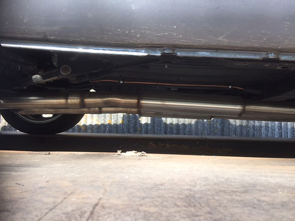

Exhaust: four-into-one headers. Crossover pipe. Custom exhaust pipes by Redhill Classics. Dual stainless steel glass-pack style mufflers.

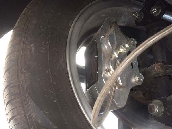

(front) vented rotors. 4-pot aluminum calipers. Braided stainless steel hoses.

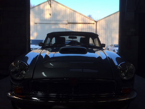

Exterior: Frontline air dam. Removed bumper overriders, front and rear. MGC style fiberglass bonnet, with hood scoop added. Polished windscreen surround. All new chrome trim from The MGB Hive. Late-model MGB stainless steel side-view mirrors 1979 MGB front bulkhead (a.k.a. firewall) was grafted in to ease engine installation. Deseamed body and seam-welded bodyshell. (See photos.) Frenched rear license plate.

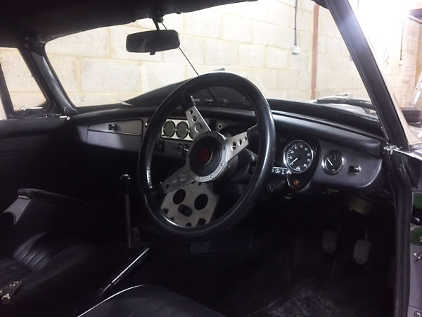

Instruments: full ETB gage set. Custom center console and central gauge panel.

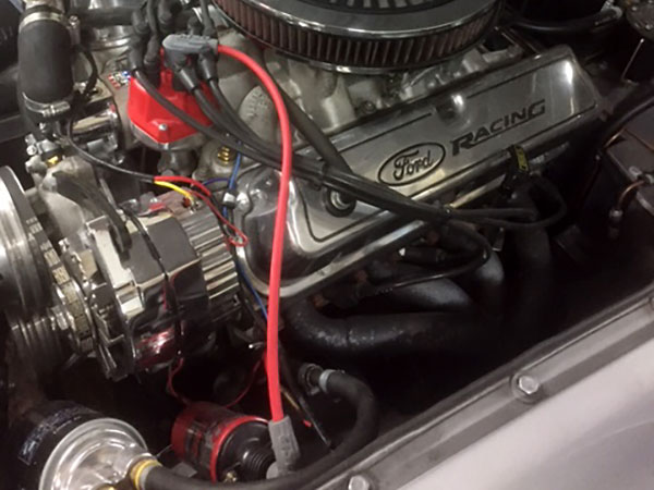

Ford 302 crate engine from Roadcraft UK (rated 367bhp).

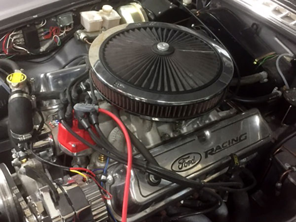

Edelbrock Performer intake manifold. Ford Racing aluminum valve covers.

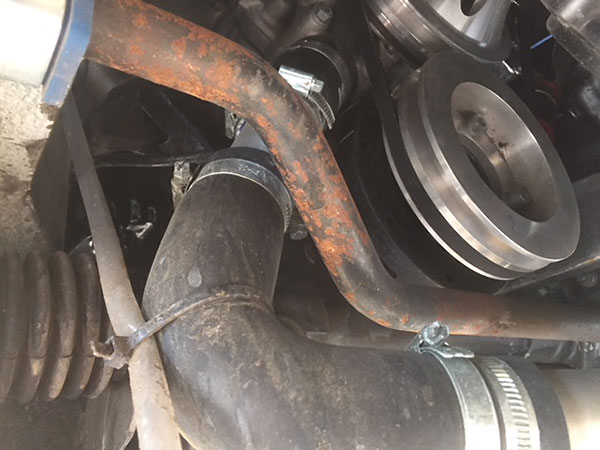

MG RV8 sway bar. Aluminum crank pulley.

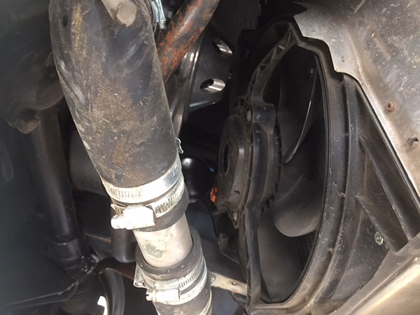

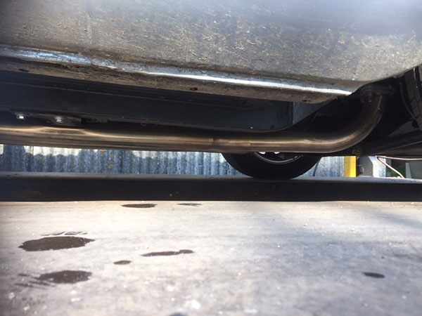

Exhaust routing.
Exhaust routing.

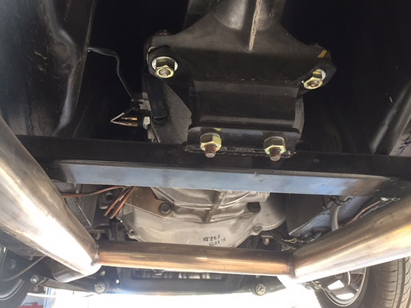

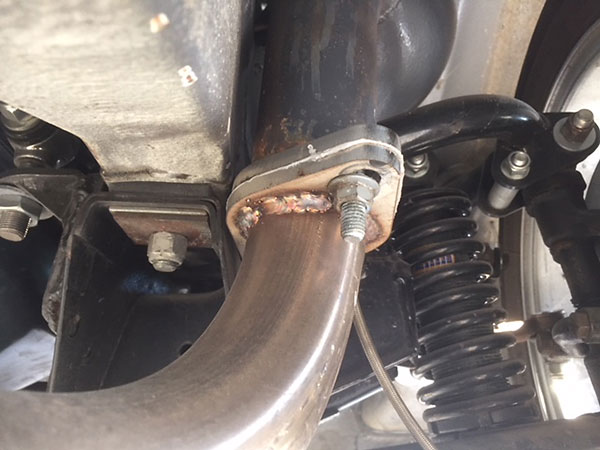

Crossover pipe.
Crossover pipe.

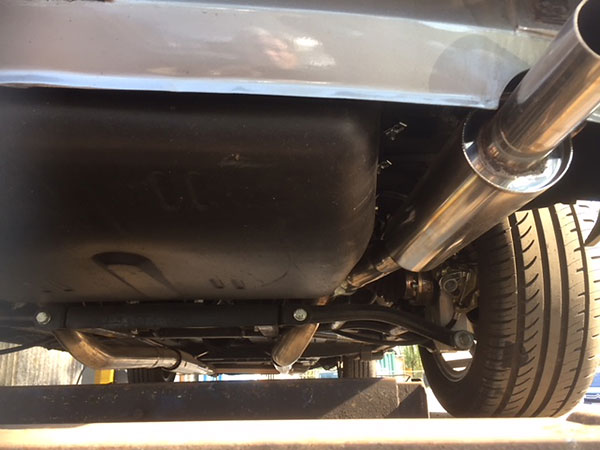

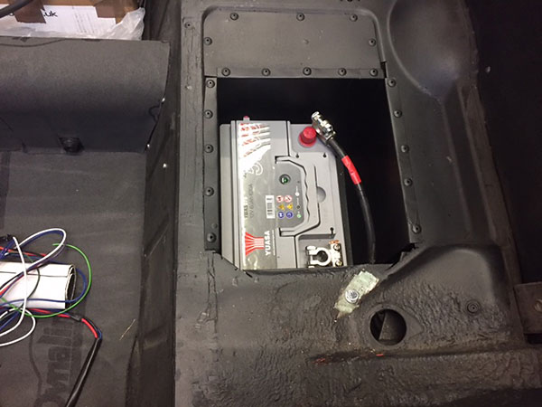

Single Yuasa 12V battery, mounted passenger side on specially fabricated bracketry.
Electric fuel pump.
Electric fuel pump.

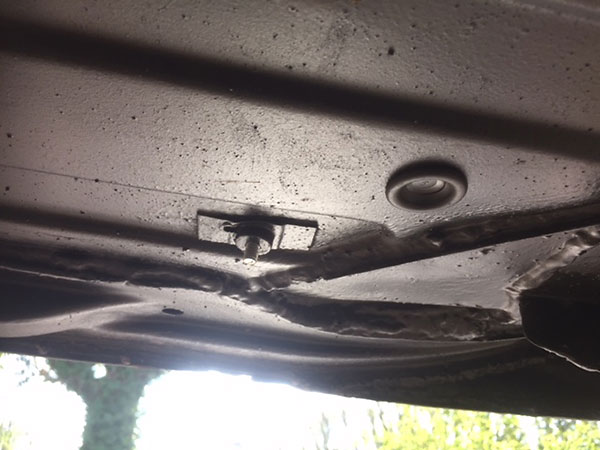

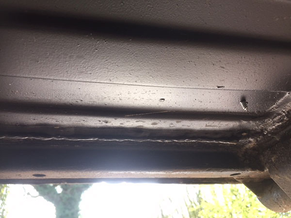

Seam-welded bodyshell.
Seam-welded bodyshell flanges, in the vicinity of the forward leaf spring hangers.
(This area is highly stressed, even after conversion to independent rear suspension.)

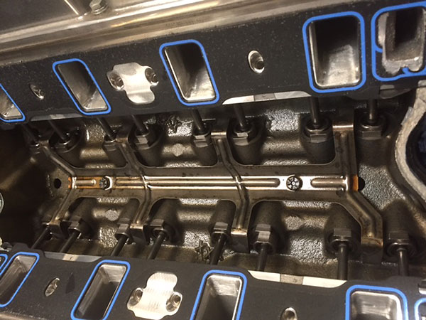

Hydraulic lifters.
Hydraulic lifters.

Vented rotors. 4-pot aluminum calipers. Braided stainless steel hoses.

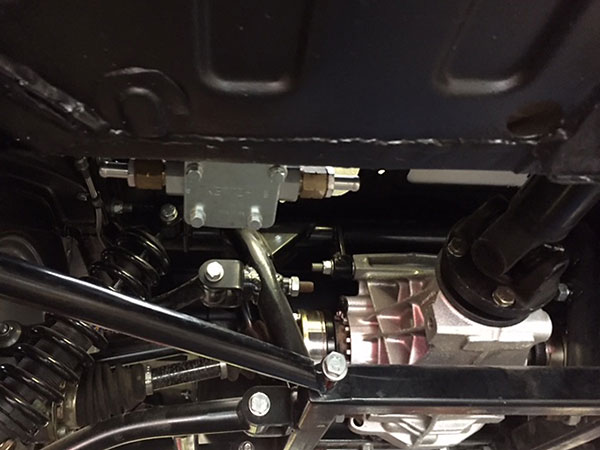

Rear Suspension
Hoyle coilover independent rear suspension.

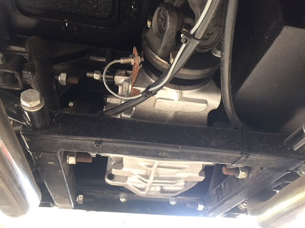

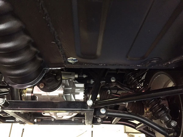

Cosworth rear end with limited slip differential.
Full ETB gage set. Custom center console and central gauge panel.

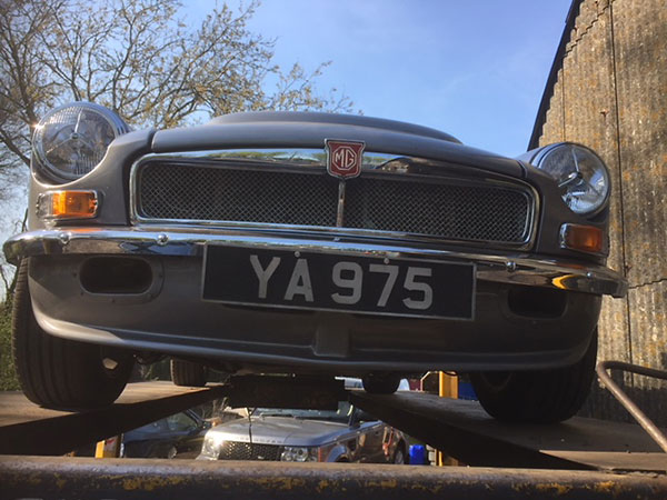

Frontline air dam. Removed bumper overriders.

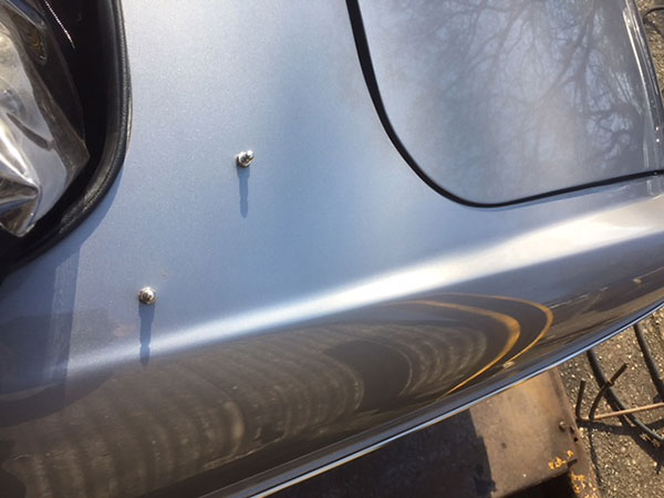

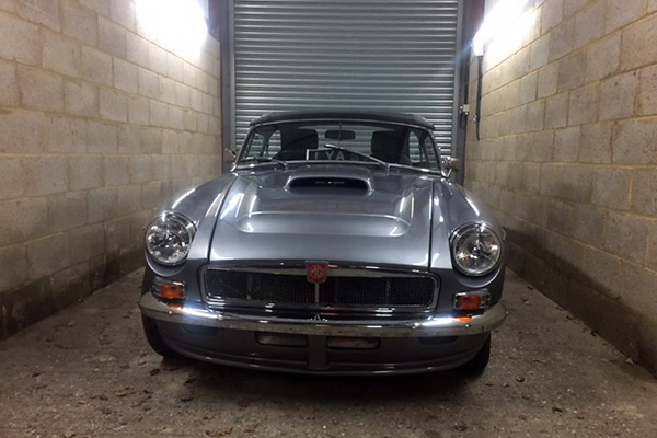

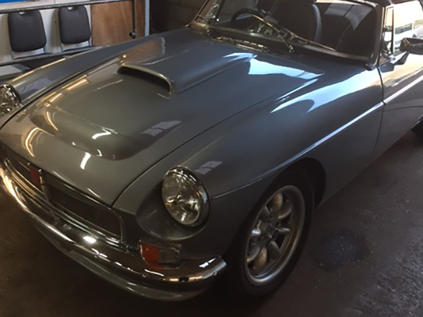

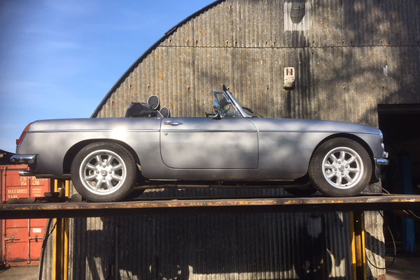

minilite replica 15 aluminum wheels
Minilite replica 15" aluminum wheels.

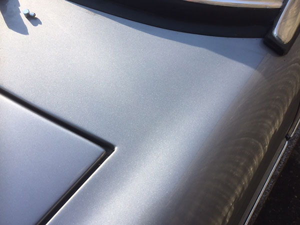

Deseamed joints between front fenders and cowl.
Deseamed joints between rear quarter panels and rear deck.

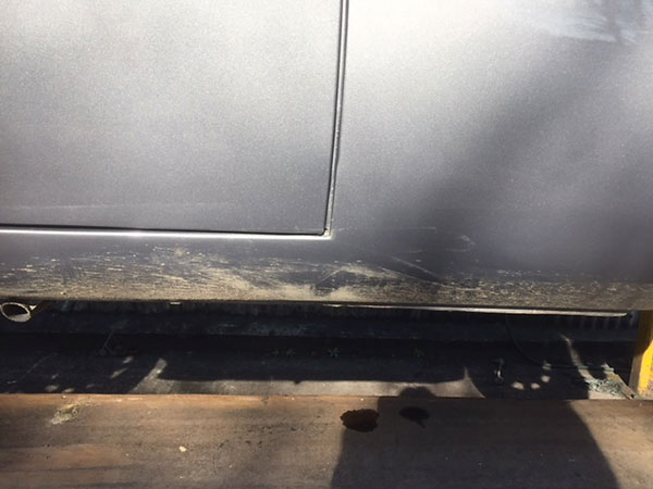

Deseamed joints between rocker panels and rear quarter panels.
