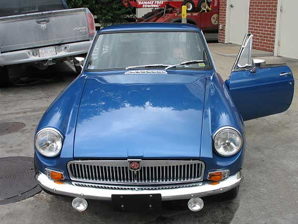

Nick Baxter's 1967 MGB-GT with Buick 215 V8
Owner: Nick Baxter
City: Omaha, NE
Model: 1967 MGB-GT
Engine: Buick 215 V8
Conversion by: John Mangles

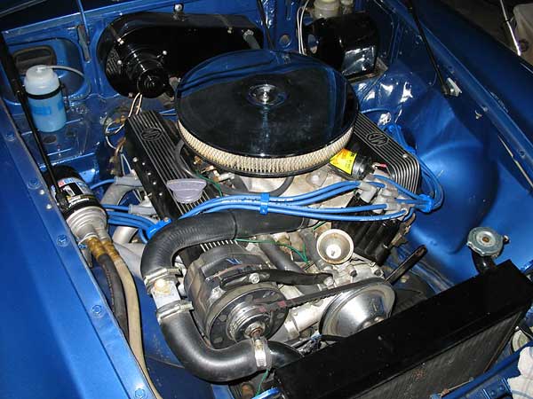

Drivetrain

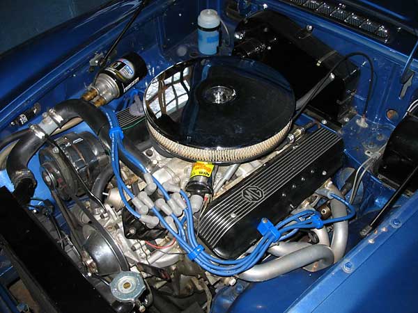

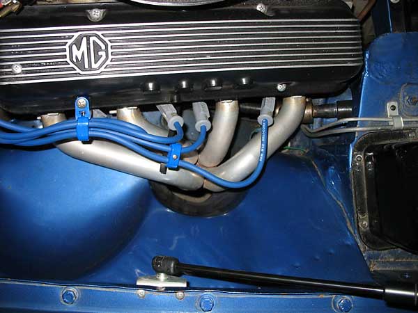

The engine came from D&D Fabrications in MN, I don't have details of the build specs, but know that it came with heads which were subsequently replaced with Rover SD1 heads from Peter Burgess in England. (These were apparently his "EconoTune" heads.) The carburetor is a Carter 400, sitting on a Buick barrel intake manifold. The headers came from Clive Wheatley in the UK, who coincidentally operates from a facility not 5 miles from where I grew up and less than a stone's throw (long cricket throw) from the favorite public house of my younger years. The previous owner sourced a T-5 gearbox from a now defunct establishment in Chicago. The engine was capped off with some nice MG valve covers.
John Mangles rewired the engine bay to remove all externally visible wires and also fabricated beautiful "wells" for the through-the-fender headers. He also modified the bulkheads and radiator mounting to make it all fit. The oil filter was relocated to a remote location on the passenger-side inner fender.

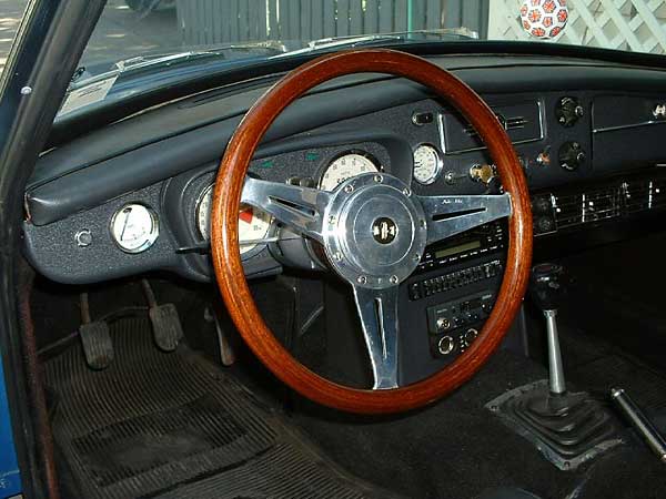

When I purchased the car, it came with an air conditioning unit installed. It wouldn't run, so I removed it. I have the parts and may re-install it one day. The one area, that I really need to re-do is the dashboard and under dash wiring. Although it works, it doesn't instill the same level of confidence as the rest of the car.

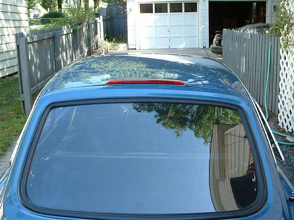

The car has "tripod" replica headlamps which look cool, and combined with the "modern" small driving lights" beneath the bumper, provide adequate lighting. The coolest feature is the roof mounted LED third brake light. It's a great idea that I have not often seen on MGBs.
The interior is pretty stock, I need to put in new carpets, and recover the Fiero seats some time, but it is great for now and for general driving.

While the car has always run smoothly, it really died when it hit 3750 rpm. I always put this down to a tight "newish" engine and didn't really worry about it. I also noted that the plugs seemed to soil more than normal with oil. A visit to my local British car mechanic, suggested that running modern engine oils in a 40 yr old engines didn't make too much sense so a change to a thicker oil would be appropriate. I made that change, and it made a slight difference, but nothing incredible.
After reading several posts on the MG Experience message board, I decided that maybe I had the wrong type of spark plugs. This research led me to the slightly unnerving realization that I had little to no paperwork on the heads on the engine, and that D&D had supplied a long block with Buick heads. The previous owner had clearly told me that he had bought Rover heads from the UK. After much research, telephone calls, and e-mails, it became clear that I did indeed have Rover heads, not Buick ones, and that the plugs from the Buick heads had been transferred into the Rover heads at the time of the swap. And as everybody was kind enough to tell me, my Buick heads needed plugs with a half inch reach. Rover heads require a three-quarter inch reach. A quick trip to the local auto parts store for plugs, and now my car runs like I added four more cylinders!
cooling system air purge in upper radiator hose
coil mounted to absorb maximum heat and vibration
Clive Wheatley RV8 headers
