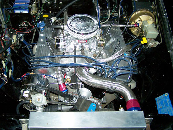

Engine: 1998 Rover 4.0L engine block, 1964 Buick 300 cylinder heads, 1982 Ford 255cid (1980-1982 truck) pistons, and 1962 Olds 215 connecting rods. Buick 215 intake manifold. Edelbrock 500cfm carburetor. Crower camchaft, Buick pushrods. Rover 4.0 rocker arm assemblies. Polished Rover valve covers. Balanced. High volume oil pump from D&D Fabrications. Moroso remote oil filter mount.
Cooling: D&D Fabrications aluminum radiator.
Exhaust: D&D Fabrications block-hugger headers. Cherry Bomb muffler. Side dump exhaust pipe.

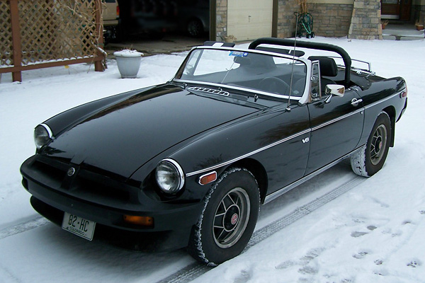

Comments: This car, with its original Buick 215 engine swap, was featured in How-It-Was-Done article number 20. I kept re-reading about the affordable stroker, and I found a few key parts, so I started to modify. It took six months and cost more than I estimated, but this motor is a monster. It's made from parts from '62, '64, '82 and '98, I hope it lasts for awhile!
The motor sounds like an aircraft radial engine.
I stripped two bolt holes along the way, but repaired both with Helicoils.
This Buick/Rover stroker motor displaces 295cid (4.9L).

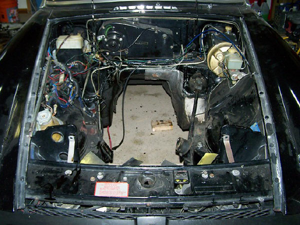

The 1980 MGB-LE engine bay requires only minimal modifications.

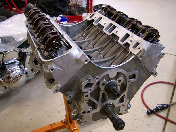

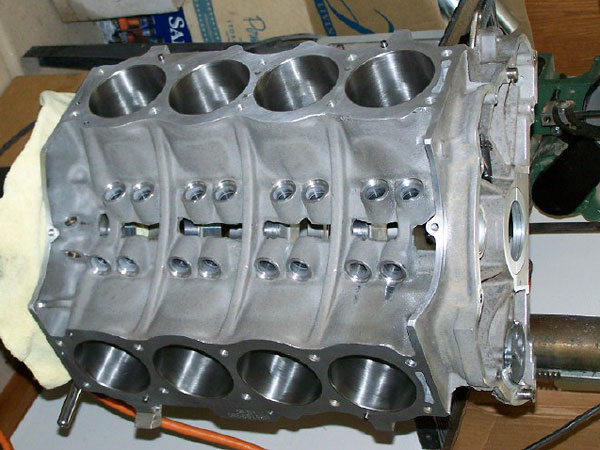

Rover 4.0 engine block.

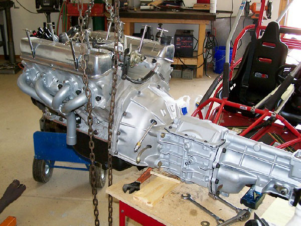

D&D Fabrications bellhousing and block-hugger headers.

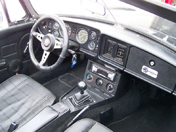

Basically stock interior.

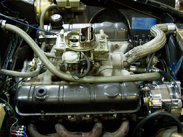

Engine: Buick 215
Engine Mods: 1963 Buick Skylark 11:1 compression, 200hp, standard overhaul, Offenhauser intake manifold, Holley 390 cfm carburetor, ported exhaust ports, oil system boosted to 60 psi, Mr. Gasket low-profile air cleaner, block and heads hand polished, stainless steel braid over new rubber hoses, remote oil filter.

Previous engine conversion: Buick 215.
