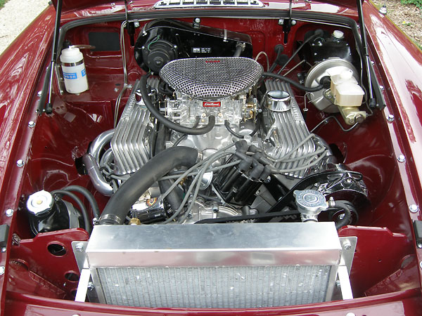

Engine: 1962 Buick 215cid aluminum V8, bored 0.030" over. Rover 4.0L cylinder heads. All new stainless steel valves, valve guides, rocker arms, and rocker shafts. Rocker shaft reinforcements. Crower camshaft, springs and lifters. Buick four barrel intake manifold. Edelbrock 1405 500cfm carburetor, with electric choke. Edelbrock air filter. Grommet-mounted S.U. fuel pump (Jaguar spec). Rebuilt Delco Remy distributor with Pertronix Ignitor module (in lieu of breaker points.) Pertronix Flame Thrower ignition coil. D&D swivel mount oil filter adapter. Oil cooler. Offenhauser finned aluminum valve covers.
Cooling: D&D Fabrications aluminum radiator. 14" electric fans.
Exhaust: ceramic coated RV8-style through the fender headers. Dual Cherry Bomb Turbo mufflers, part# 16802. The fuel tank was centered to accomodate dual exhaust.

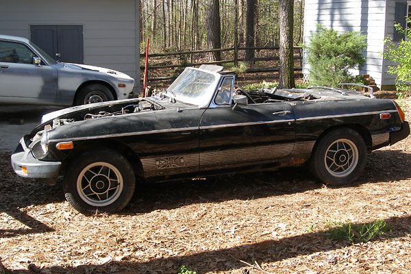

Preparing the 1980 MGB Bodyshell
Derelict 1980 MGB LE, as originally purchased.

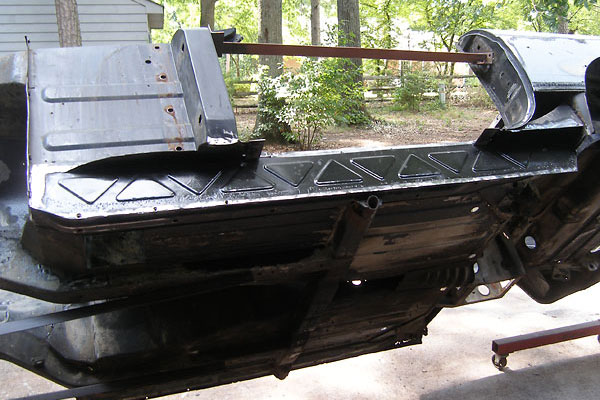

Beginning of rust repair: replacing the rocker panels, door sills, and inner rocker ("castle") panels.
Notice that temporary braces have been installed to keep the body straight while working.

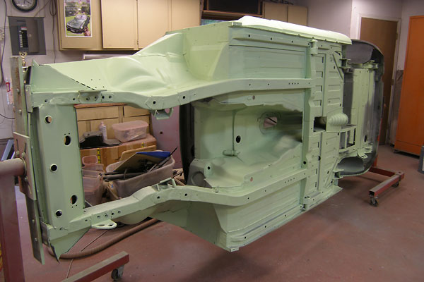

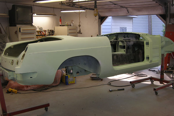

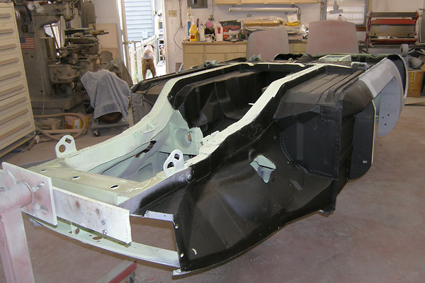

Bodyshell repairs and modifications are complete, and it's time for primer.
Epoxy primer was sprayed over the entire bodyshell.

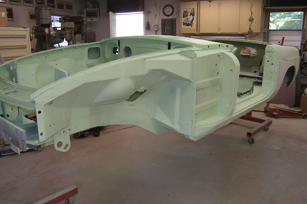

A very good view of the unibody construction of the MGB model.

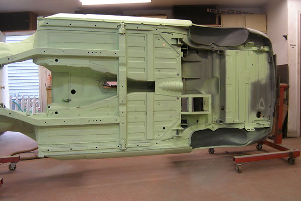

Underside was sprayed with undercoat.

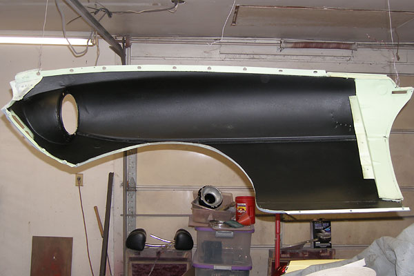

A peek inside a front fender.
A peek inside a front fender. It's hard to see the patch panel, even in this view.

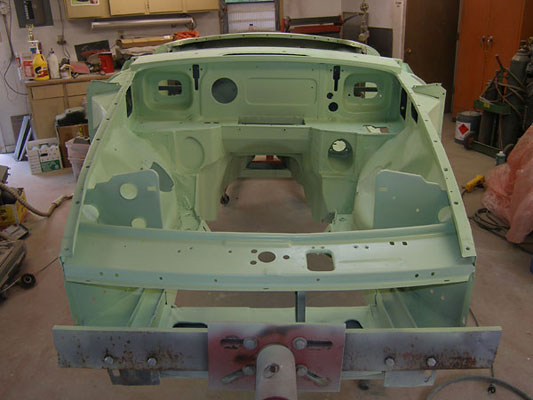

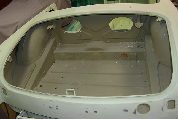

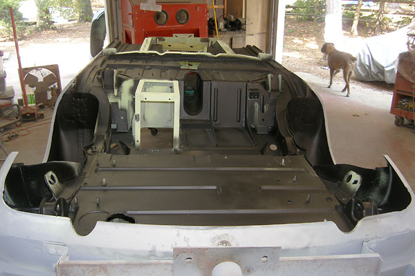

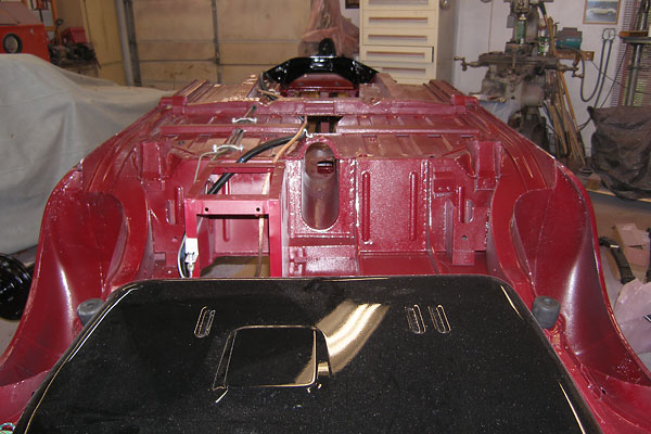

The body has been modified to suit a centered fuel tank and dual tailpipes.

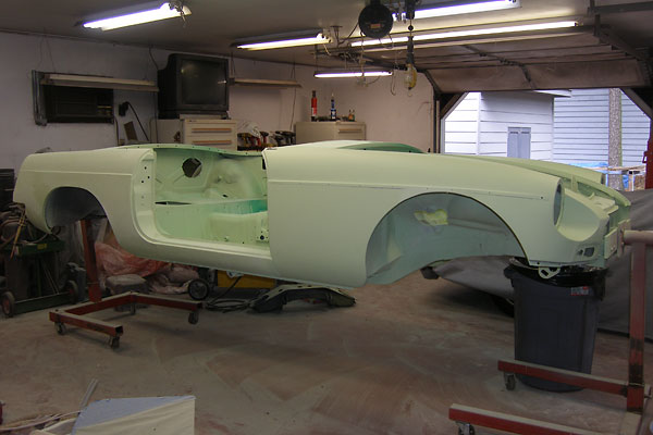

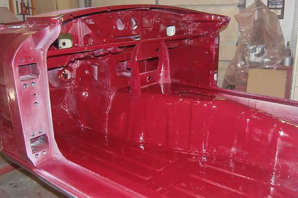

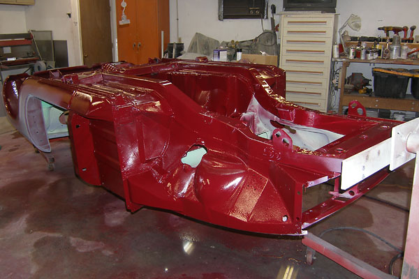

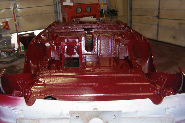

Painting Hidden Surfaces

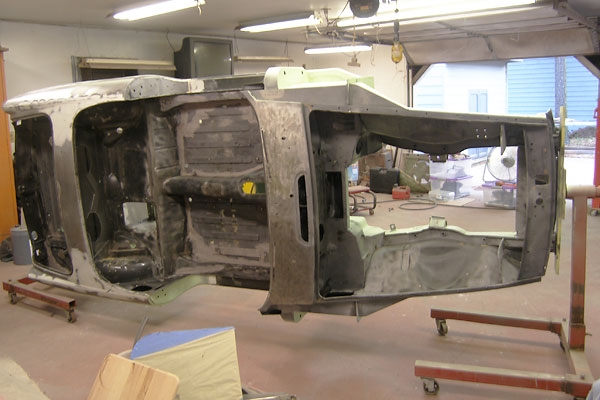

A rotisserie is very helpful throughout the process, including painting.
The dreaded scuttle shake of more primative sports cars was never a problem for MGB.
The dreaded "scuttle shake" of more primative sports cars was never a problem for MGB.
The MGB's unibody bodyshell was conservative and robust by design, as illustrated here.

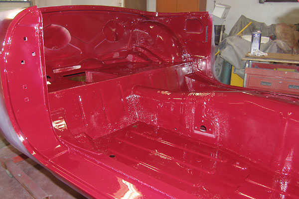

(Driver's side interior paint, including dashboard.)
(Passenger's side interior paint, including rear seat area.)

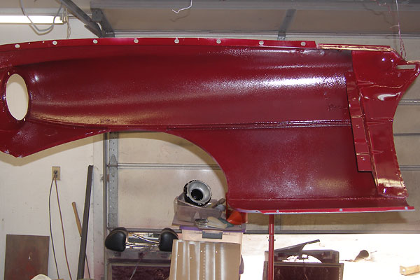

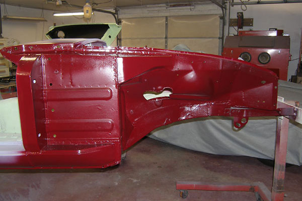

The insides of the front fenders were painted off-the-car, and then installed.

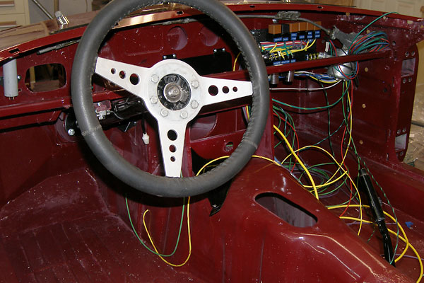

Chassis Wiring
Preparing to get started on taillamp wiring.

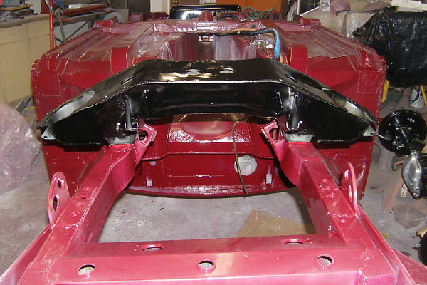

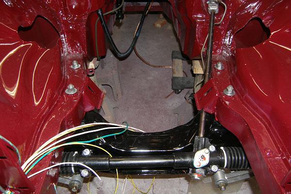

Reinstallation of the front crossmember.

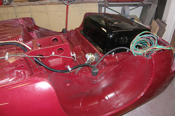

Routing of battery cables.

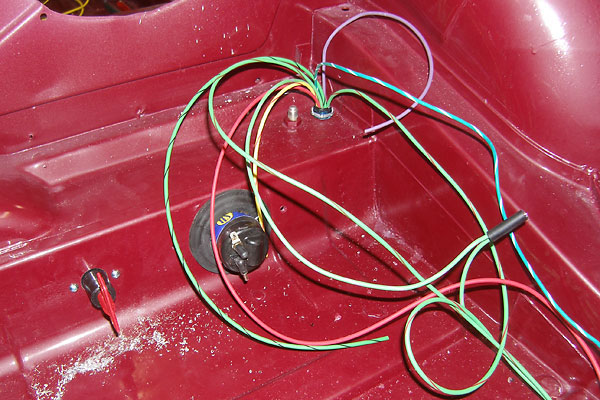

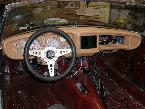

Ready to get started hooking-up the instruments and switchgear.

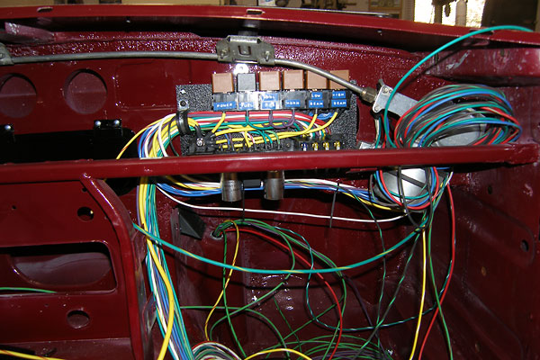

Advance Auto Wire fuse and relay block.

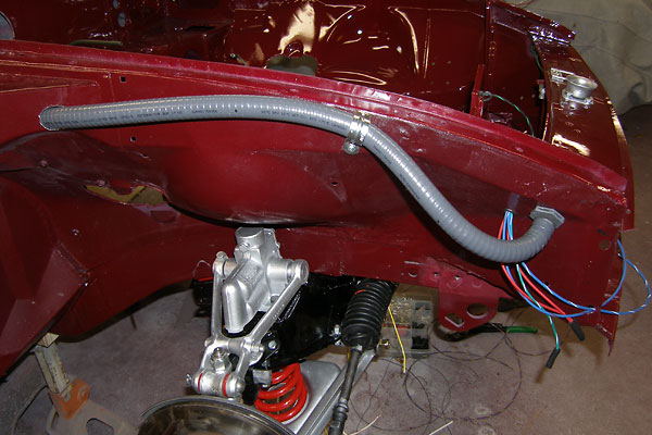

Flexible non-metallic conduit won't cause a short circuit in the event of an accident.
Flexible non-metallic conduit is less likely than steel conduit to cause a

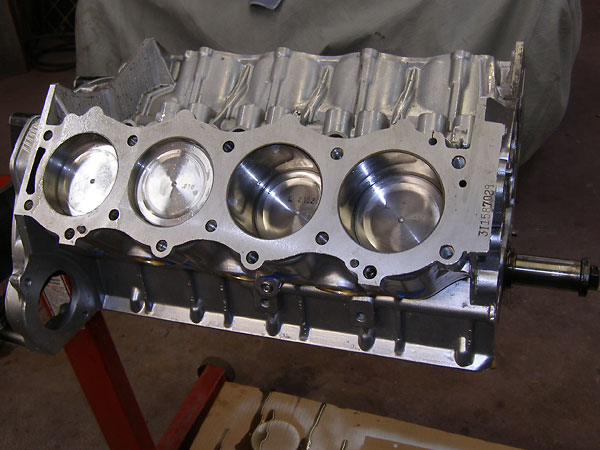

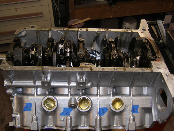

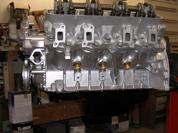

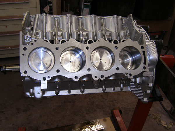

Identifying a Buick 215 engine block.
Sets of parallel ribs on the aluminum block are the easiest way to tell this is a
GM aluminum V8, not a Rover. Five head bolt holes per cylinder, instead of six,
identify it that this is a Buick 215 engine block, not an Oldsmobile 215.

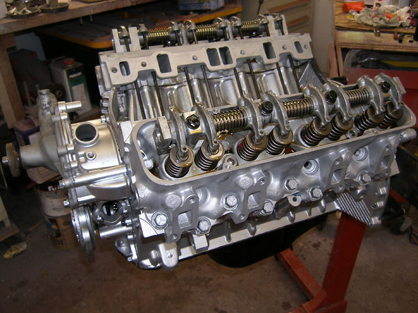

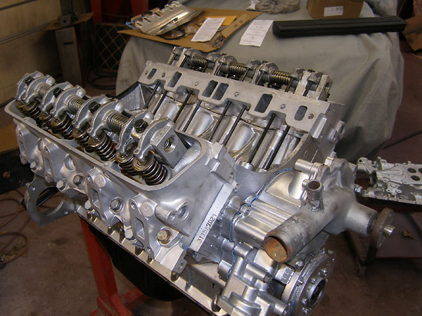

1962 Buick 215cid aluminum V8, bored 0.030 over.
The Buick/Olds/Rover aluminum engine block has a deep-skirted design.

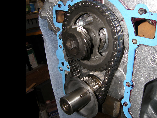

Timing chain and gears.
Rover 4.0 cylinder heads.
These Rover 4.0 cylinder heads have smaller combustion chambers and bigger valves than the original
Buick cylinder heads or any of the earlier Rover heads. They mount with just four head bolts per cylinder.

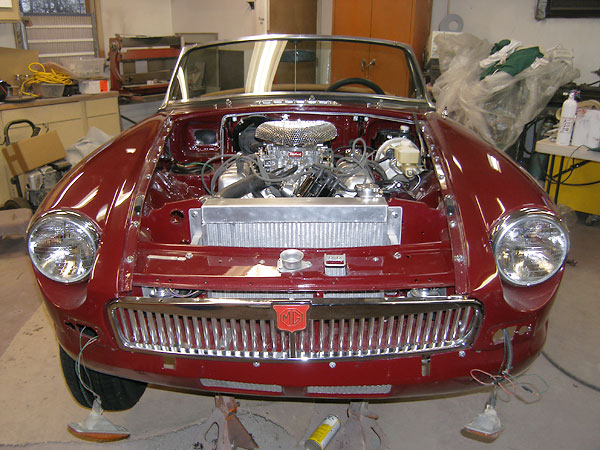

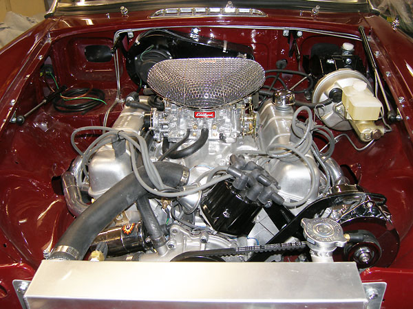

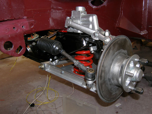

Rebuilt stock MGB, with one inch lowering springs. Lever shock absorbers.

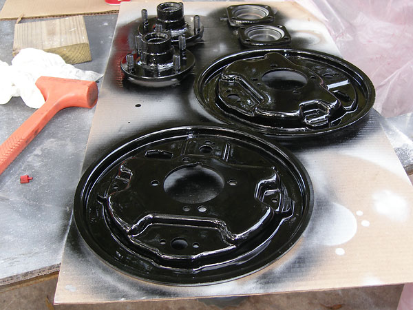

4-lug hubs and drum brake backing plates.

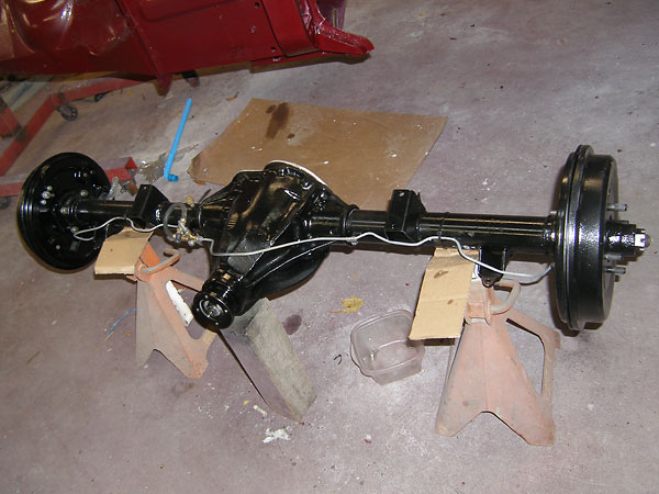

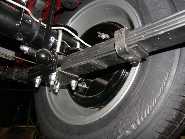

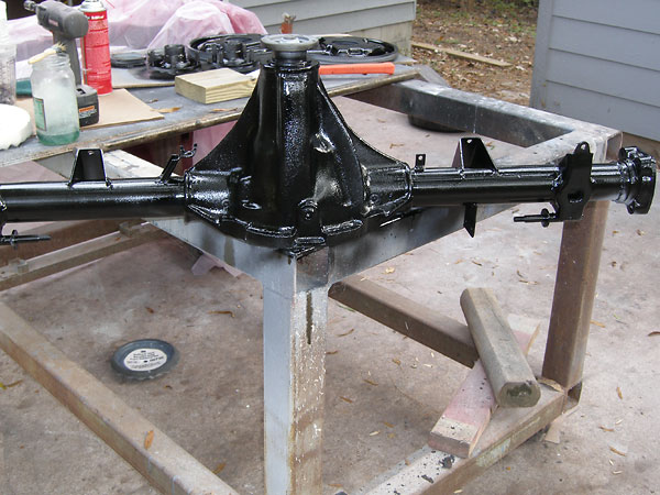

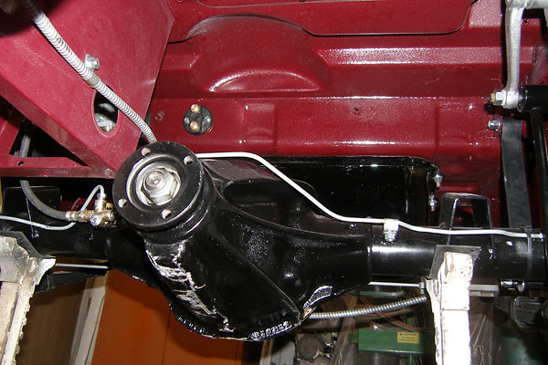

Later year models of the MG Salisbury axle have brackets for mounting an anti-sway bar.
Salisbury axle: all back together and ready to reinstall.
1 inch lowering leafsprings. Note the connecting link for a lever shock absorber.

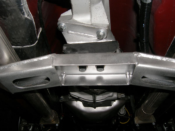

Transmission crossmember.

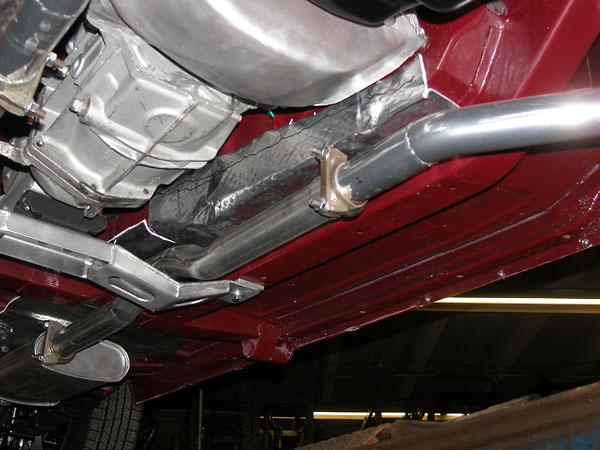

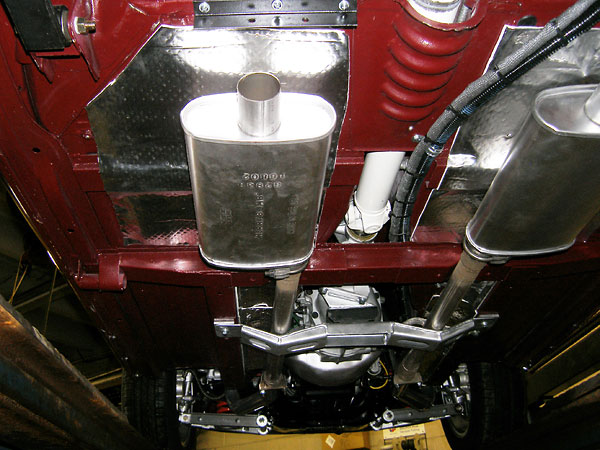

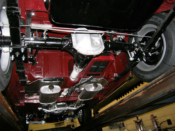

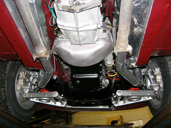

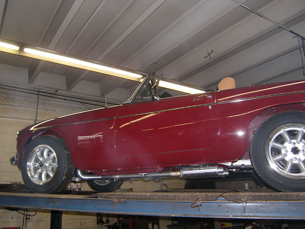

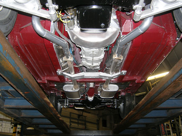

On the lift, for installation of the exhaust system.
Exhaust pipes were remade to add cleaarance to the transmission crossmember.
Sometimes you just have to take something apart and do it a second time, better.

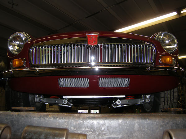

1962-1969 style MGB grille, used in conjunction with a 1973-1974.5 MGB gravel pan.

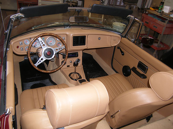

Trimming the Interior

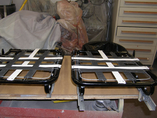

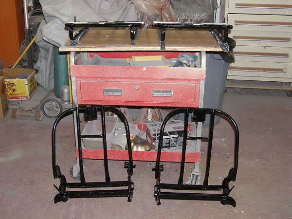

Repainted MGB seat frames.
Extra webbing added to seats.
Installation of the dashboard.

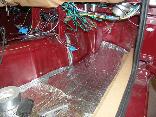

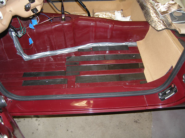

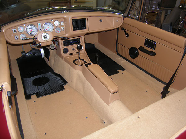

New mastic sound deadening added to the floorboards.

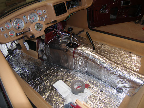

Applying foil covered insulation to reduce cabin heat.
With the insulation fully installed, it's ready for carpet.
Installation of the carpets.

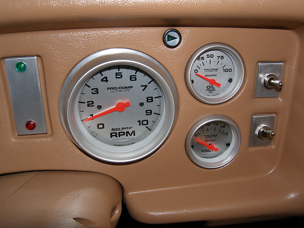

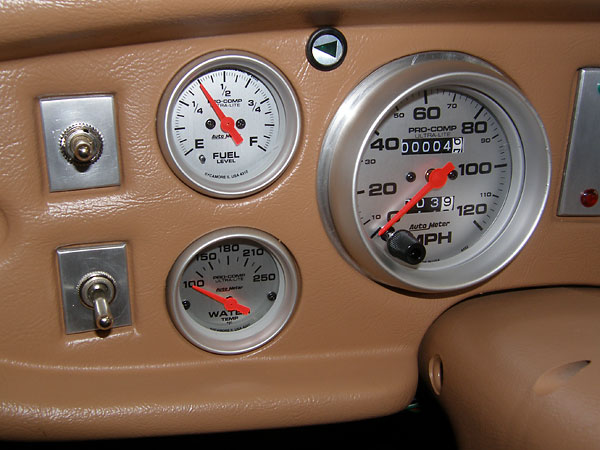

Autometer Pro-Comp Ultra Lite gauges.
Autometer Pro-Comp Ultra Lite gauges: programable fuel gauge,
water temperature gauge (100-250F), speedometer (0-120mph),
toggle switches in lieu of rockers.
Autometer Pro-Comp Ultra Lite gauges: tachometer (0-10000rpm),
oil pressure gauge (0-100psi), and voltmeter (8-18V).

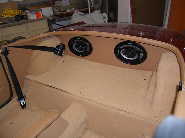

Sony Xplod triaxial 6x9 speakers.

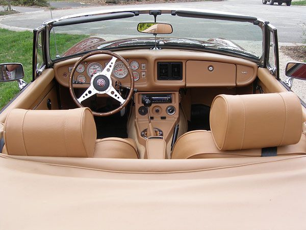

Completed interior upgrade.
Sony DIN-mounted stereo radio and CD player, mounted in the center console.

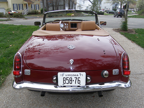

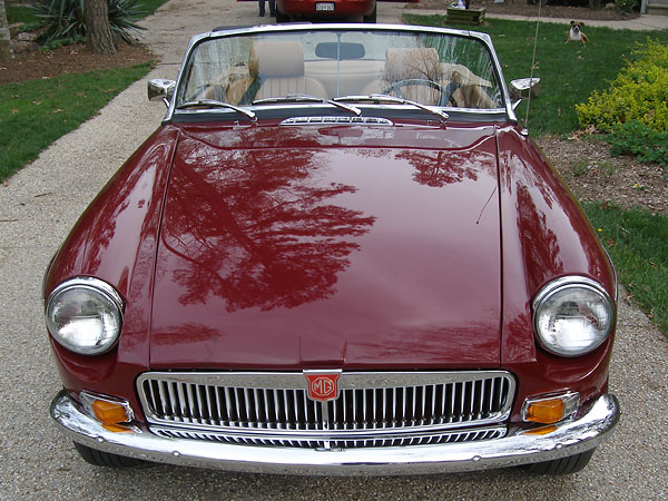

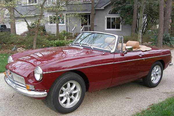

Completed
Dupont base-coat / clear-coat paint, in Jaguar Regency Red.
Dupont base-coat / clear-coat paint, in Jaguar "Regency Red".
Panasport 15x6 aluminum wheels with Goodyear P195/65R15 tires.
Pre-1968 MGB taillamp lenses.
The final photo.
