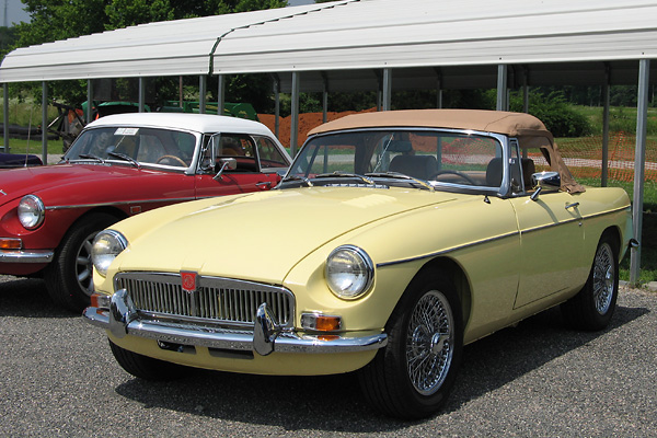

Mike Alexander's 1973 MGB rebuilt on 1980 bodyshell, with Buick 215 V8
Mike Alexander's 1973 MGB with Buick 215 V8
Owner: Mike Alexander
BritishV8 UserID: restorejag
City: Richmond VA
Model: 1973 MGB (rebuilt with 1980 bodyshell)
Engine: Buick 215 V8
Conversion by: owner

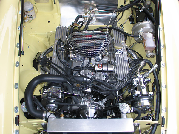

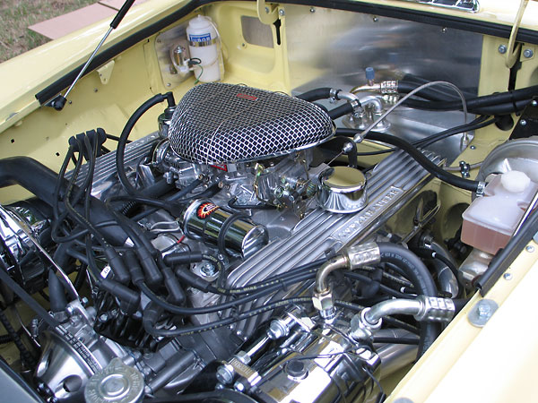

Engine: 1962 Buick 215cid aluminum V8, bored 0.030" over. Buick four barrel intake manifold with Edelbrock 1405 500cfm carburetor, with electric choke. Delco Remy distributor with Pertronix Ignitor ignition module (in lieu of original breaker points) and Pertronix Flame Thrower coil. Crower camshaft (part number 50229). D&D swivel mount oil filter adapter.
Cooling: D&D Fabrications aluminum radiator.

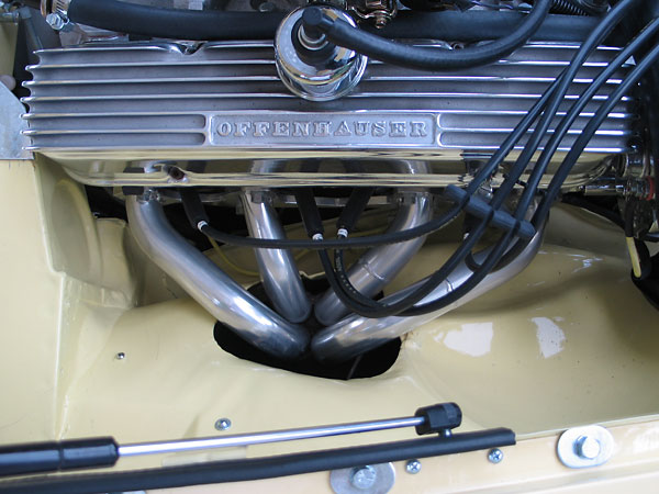

Exhaust: RV8-style through the fender headers. The fuel tank was centered to accomodate dual exhaust.
Transmission: Borg Warner "world class" T5 5-speed. Lightweight flywheel and driveshaft from D&D Fabrication. McLoed clutch and hydraulic throw-out bearing. Hurst Billet/Plus shifter.

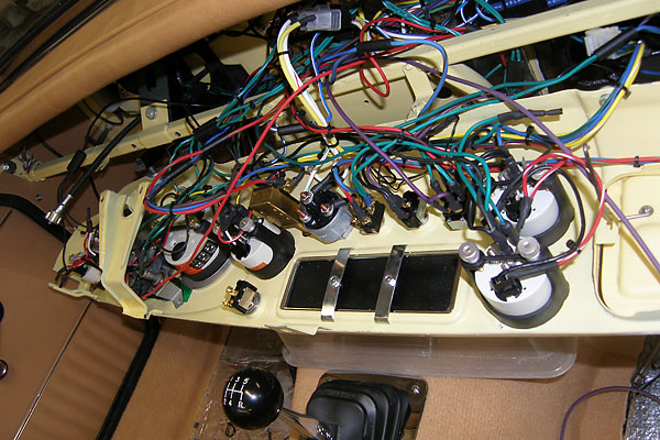

Electrical: custom wiring using an Advance Auto-Wire kit. 100 amp alternator. Gear reduction starter.

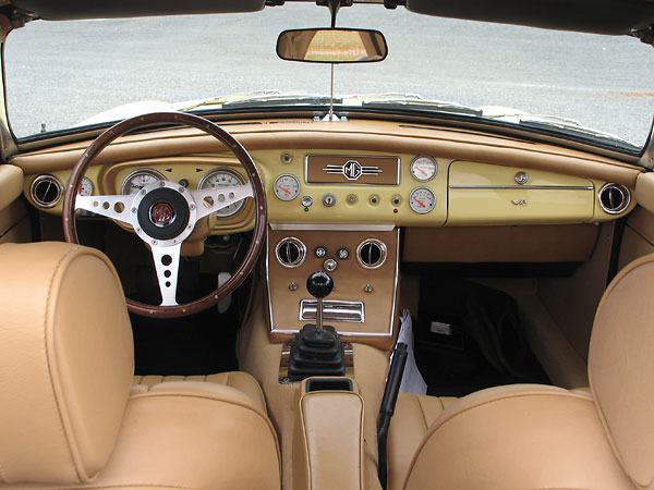

Interior: a "Mark 1" MGB steel dashboard was modified for this application. In lieu of black crinkle finish, it's painted body color. The dashboard is complemented by a custom, upholstered center console. A "Nostalic Air" air conditioning system has been installed. Tourist Trophy 15" wood three-spoke steering wheel.

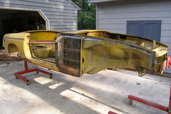

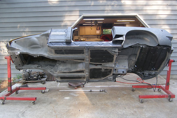

Body: a 1980 MGB bodyshell was the basis of the "rotisserie restoration" that started this project. The floorboards, trunk floor, rockers, doglegs, and lower front fenders were replaced. Hat-section reinforcements were added under the floor. Use of the later model bodyshell also necessitated a "chrome bumper conversion".

1962 Buick 215cid aluminum V8, bored 0.030 over.
Delco Remy distributor with Pertronix Ignitor ignition module (in lieu of breaker points).

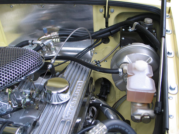

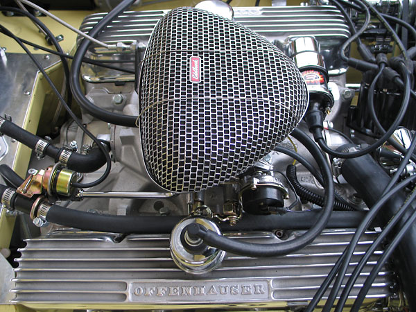

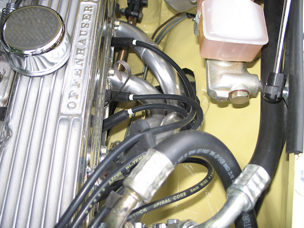

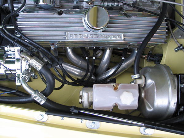

Offenhauser finned aluminum valve covers.

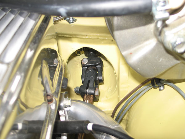

Steering universal joint.

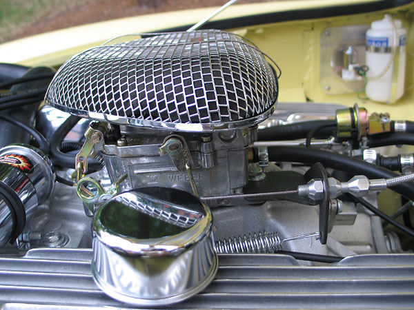

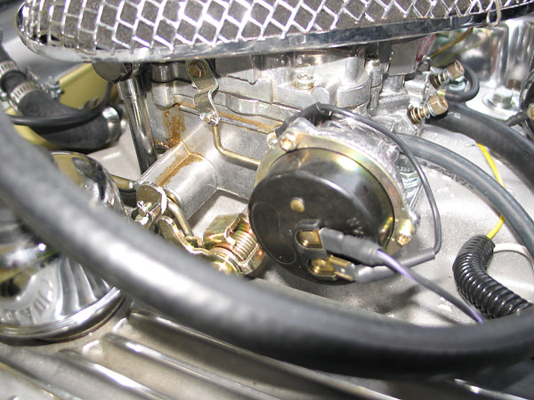

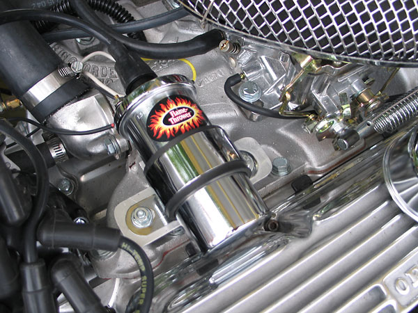

Pertronix Flame Thrower ignition coil.

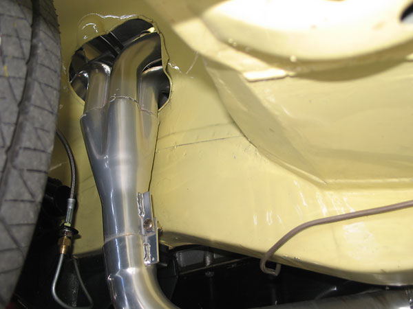

RV8-style through-the-apron headers.
"RV8-style" through-the-apron headers.
Accel Hi-Temp Spiral Core 8mm spark plug wires.
Four-into-one header collector.

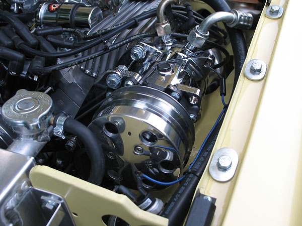

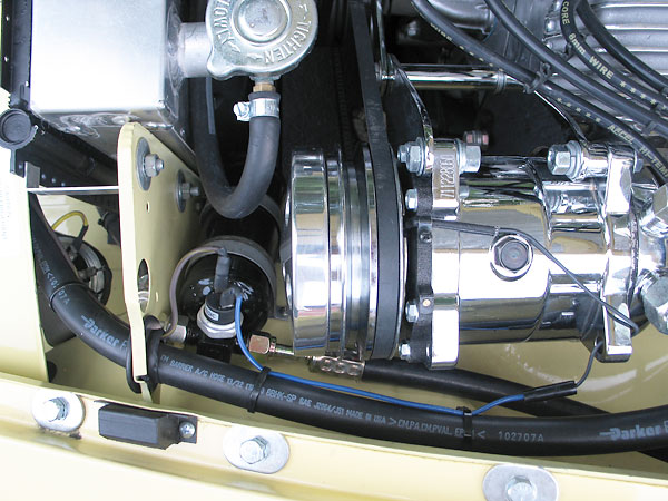

Sanden air conditioning compressor.
The air conditioning system's receiver-dryer.

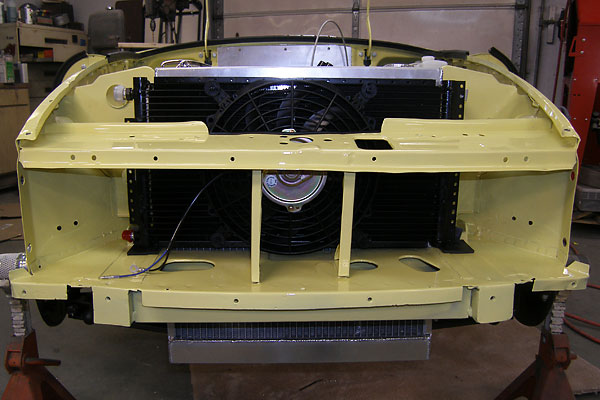

The air conditioning system's condensor, mounted in front of a D&D aluminum radiator.

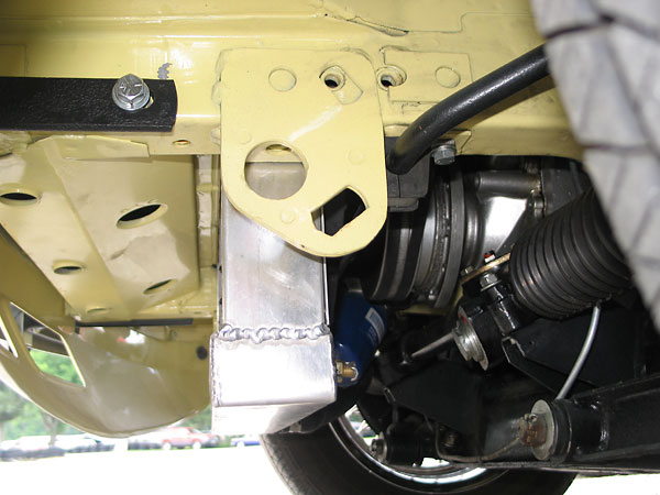

D&D Fabrications swivel mount oil filter adapter.

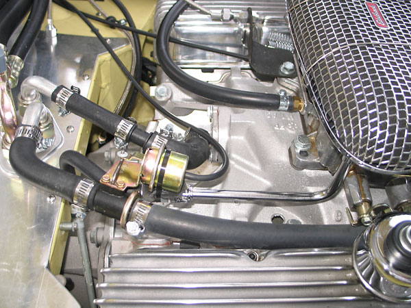

Positive crankcase ventilation system.

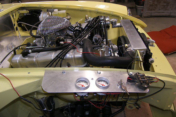

Electric choke actuator.
Hole in the passenger-side inner wing to accomodate the exhaust header.

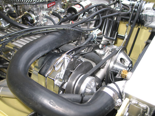

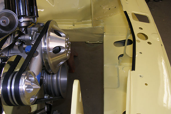

Delco 100 amp alternator (and billet pulleys).

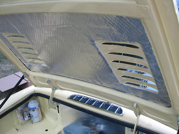

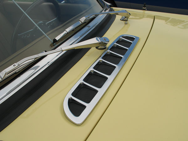

Hood louvers and insulation.

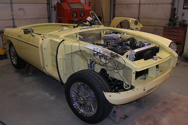

Wiring has been relocated out of the engine area.
Wiring has been relocated out of the engine area. Here, you can also see how the fenders
were modified to accomodate the earlier "chrome-bumper" style turn signal lamps.

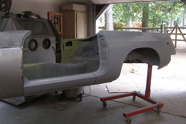

How It Was Done

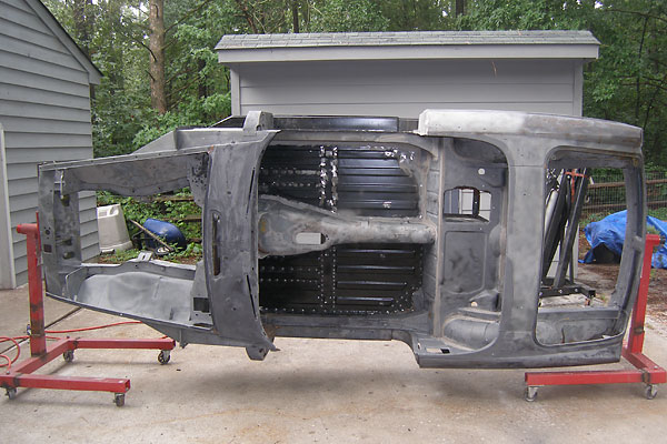

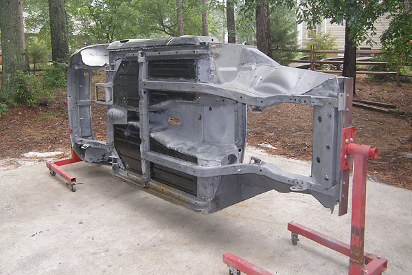

Ready to get started...

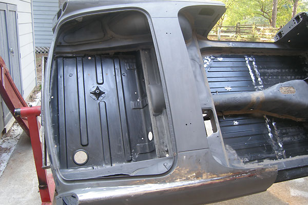

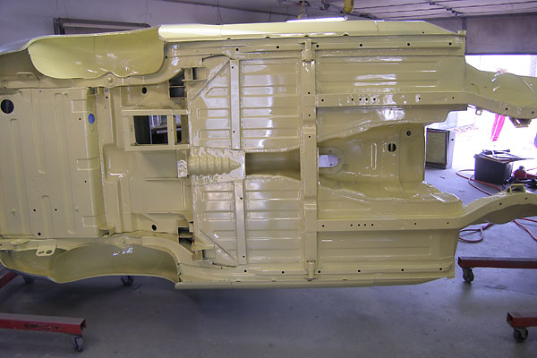

Installation of replacement floorboards.
Installation of replacement floorboards, as seen from above...
Replacement MGB floorboards.
and as seen from below...
MGB structural repairs
and from another angle.

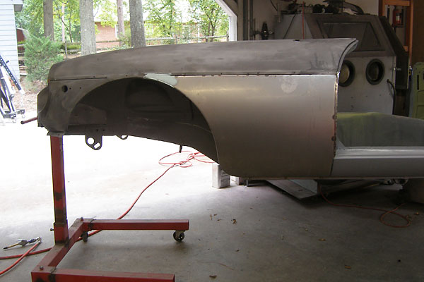

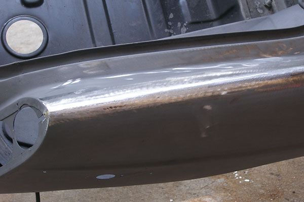

Eliminating the fender-top seam.
Replacement trunk floor.

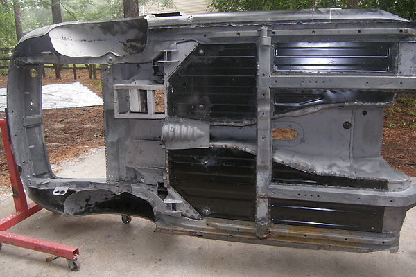

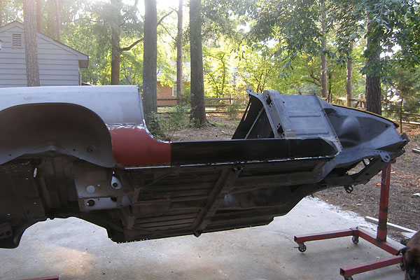

Replacing the castle rail (i.e. inner rocker panel).
Installing the rocker panel and replacement quarterpanel dog-leg.
Installing the rocker panel and replacement quarterpanel "dog-leg".

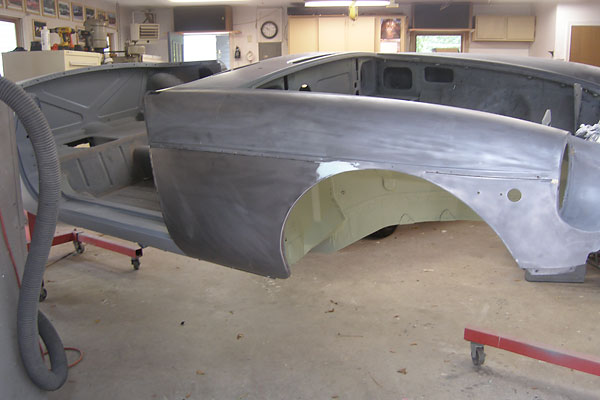

The passenger-side fender went on and looked really good.
The driver-side fender took more work. Rust repair necessitated replacing the whole lower part,
...which needs to be done on the car so that fit and alignment come out correctly.
Note also the tie-down brackets for transport.

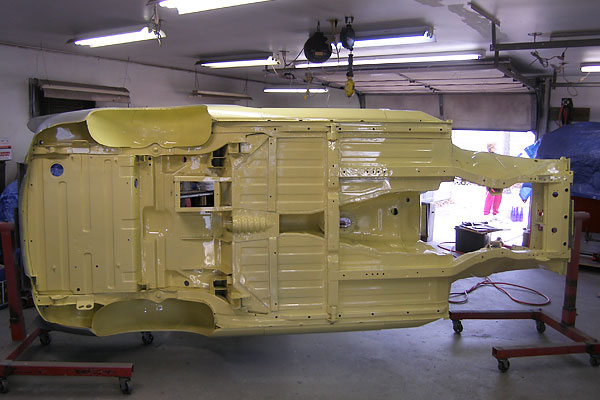

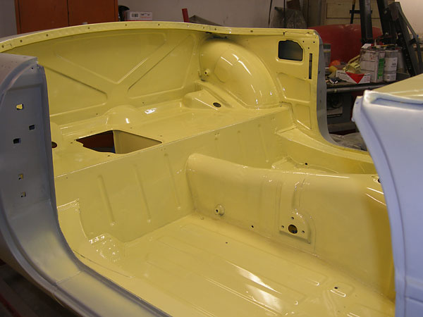

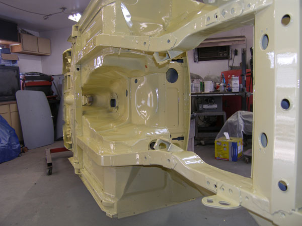

Painted! This view shows many of the distinctive features of a "rubber bumper" bodyshell. You might note
different leaf spring mounts, which project lower to lift the body. The heelboard stiffener has a deeper
cross-section to accomodate the driveshaft's greater angle. The radiator is mounted further forward, and
the radiator shelf and its reinforcement are more elaborate. Note also the tie-down brackets for transport.

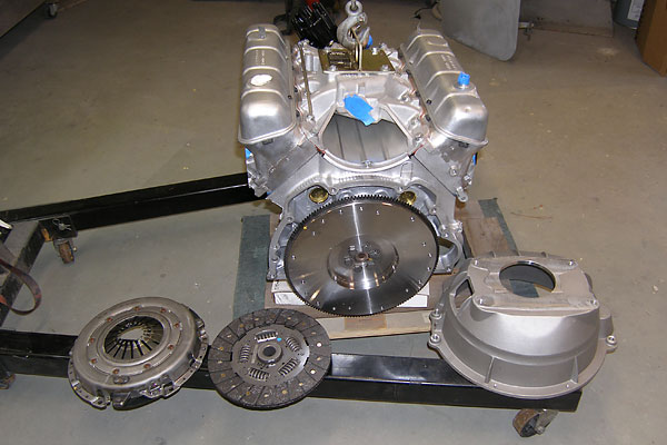

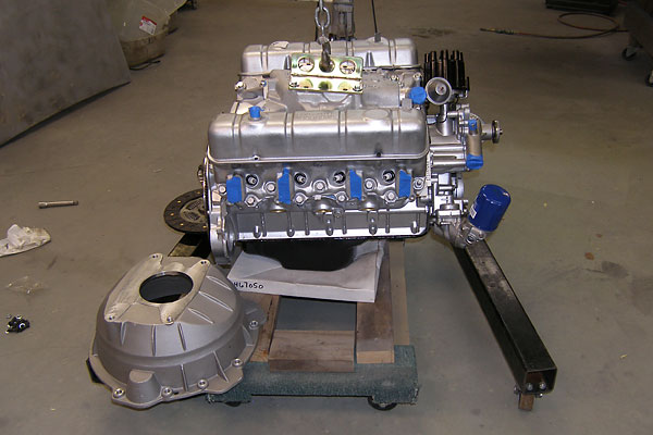

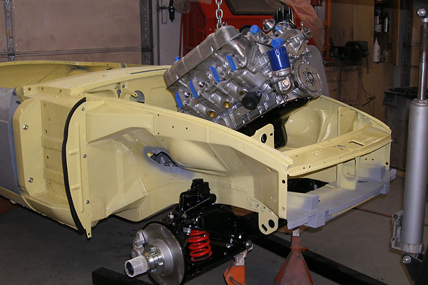

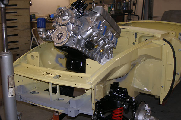

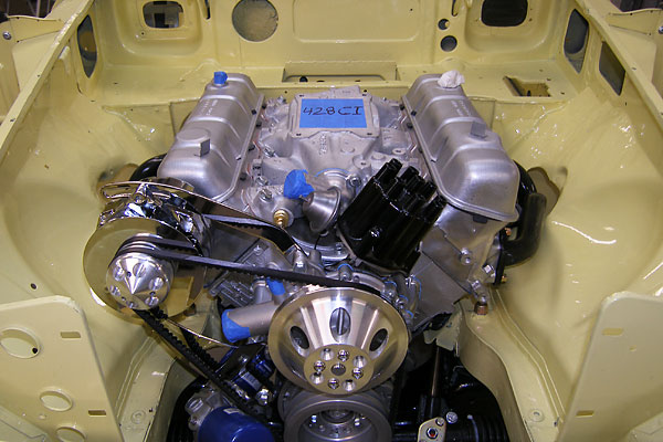

Buick's classic all-aluminum 215 engine, with a modern aftermarket transmission bellhousing.
Buick's classic all-aluminum "215" engine, with a modern aftermarket transmission bellhousing.
Chevy Camaro spec diaphragm pressure plate and clutch disc.
Actual engine installation is so quick and easy compared to all the preparation...
Of course, the engine will probably come out and go back in a couple more times.
(Of course, the engine will probably come out and go back in a couple more times.)
428ci
428ci

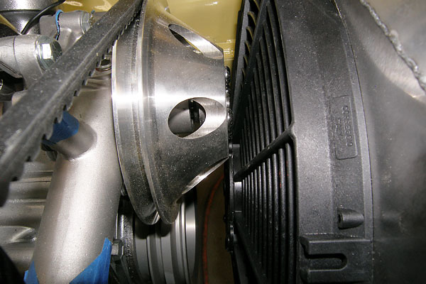

Installation of the alternator.

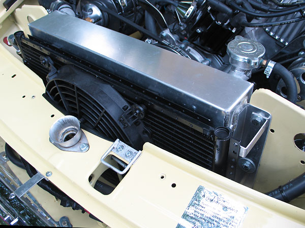

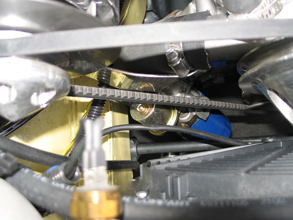

Checking pulley clearance, after installation of the radiator and cooling fan.
One fan pushing, and one fan pulling.

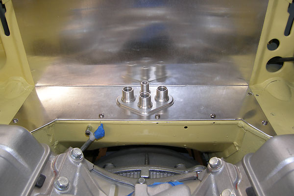

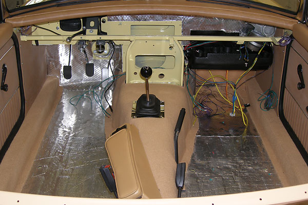

Pass-thru panel for the HVAC system.
Preparing to test-fire the newly installed engine.
Isn't this nifty: a remote gauge panel with starter switch!
Nostalgic Air climate system.

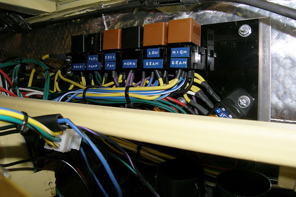

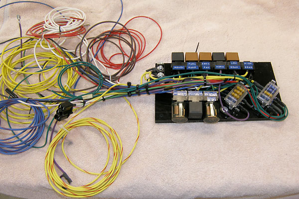

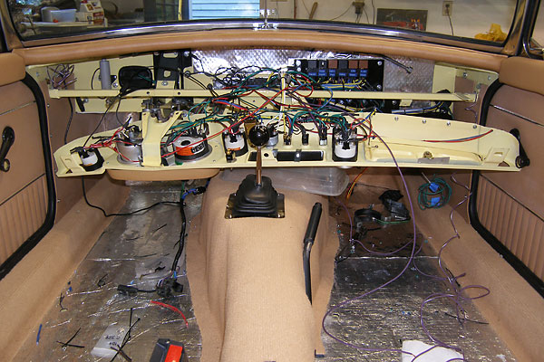

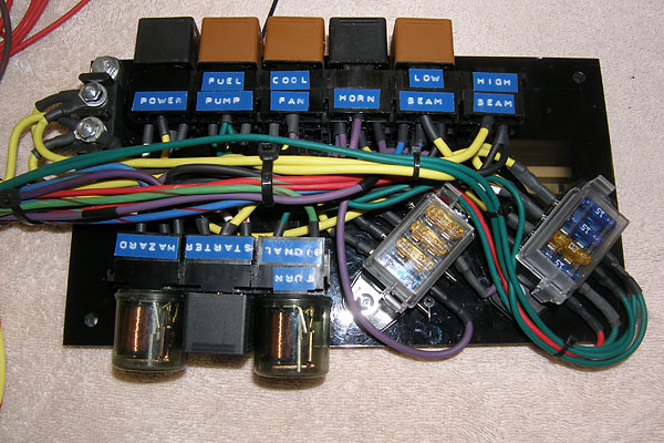

Advance Auto-Wire wiring system.
Seven relays, two flashers, eight fuses...
electrical architecture
relays
wiring

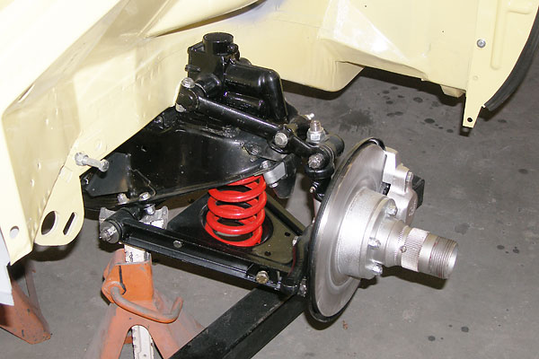

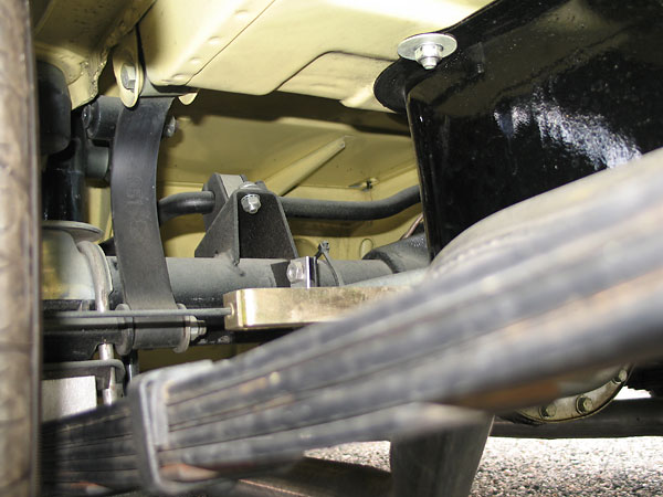

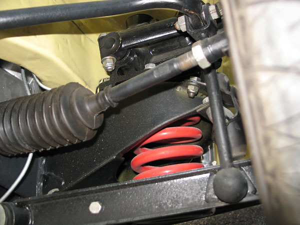

Rebuilt MGB front suspension.

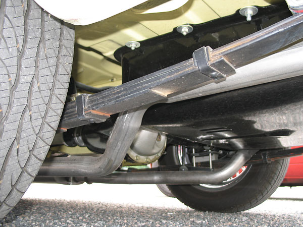

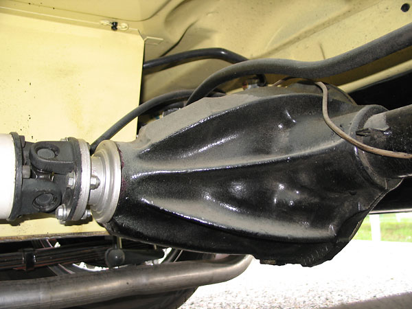

MGB tube-type (Salisbury) axle. The anti-sway bar brackets are a late-model feature.

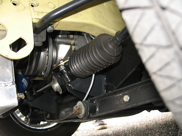

steering rack
steering link

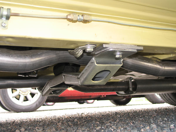

transmission crossmember
brake line passthru

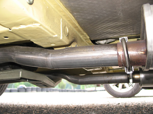

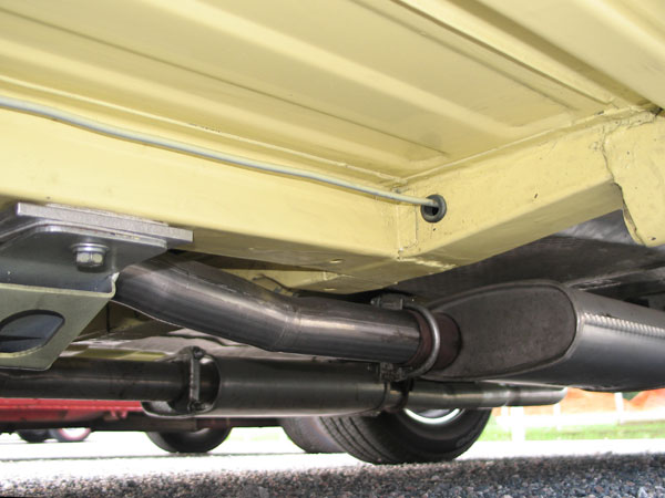

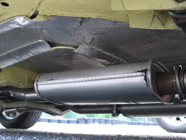

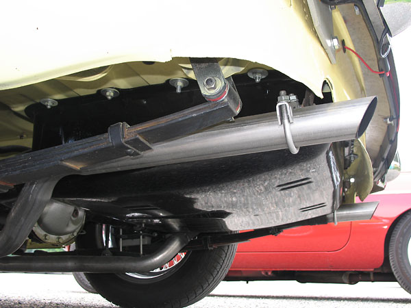

exhaust routing
muffler... and oddly routed brake line
exhaust

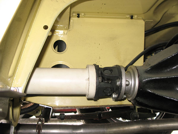

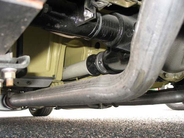

D&D Fabrication driveshaft.

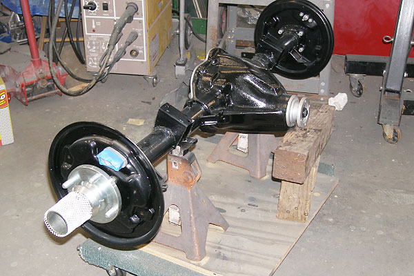

Salisbury axle. (Note: Salisbury is just a popular Britishism for Dana/Spicer.)
Salisbury axle. (Note: "Salisbury" is just a popular Britishism for "Dana/Spicer".)
Anti-sway bar bracket on the body.
Anti-sway bar bracket on the axle.
tailpipes

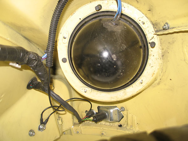

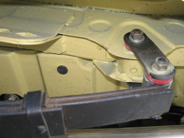

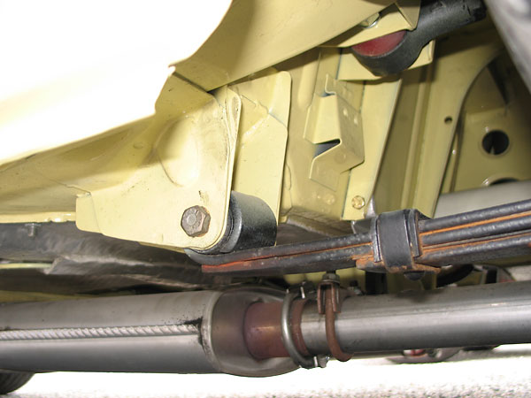

Red urethane bushings.

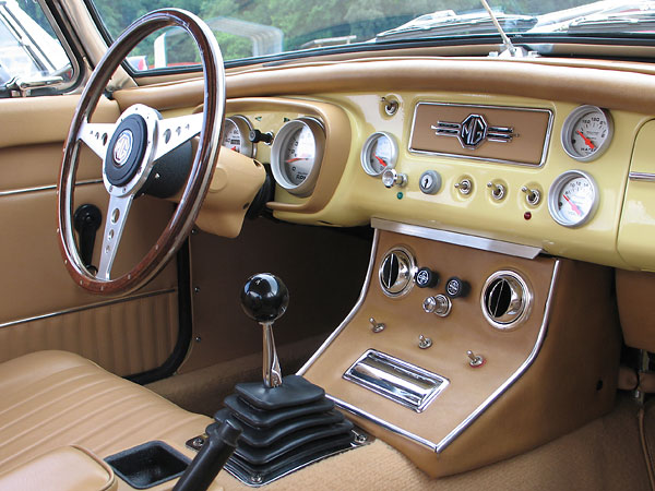

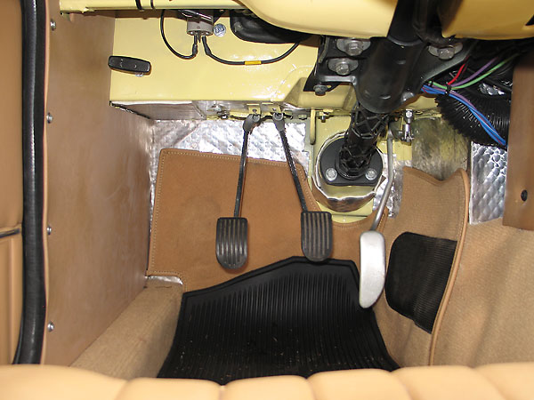

Tourist Trophy 15 inch wood three-spoke steering wheel.

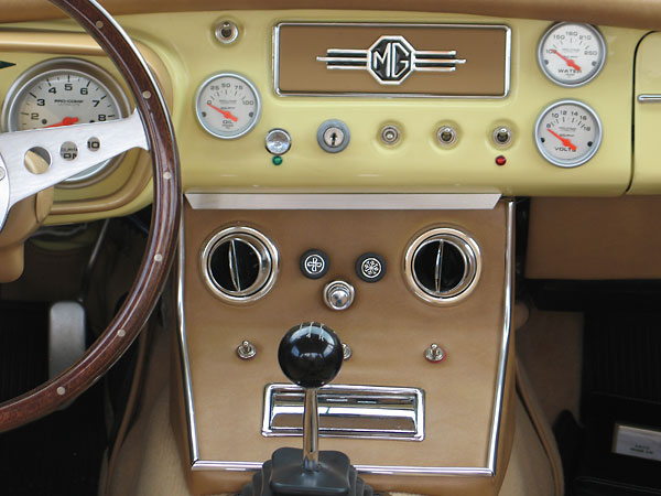

MGB steel dashboard, repainted body color.

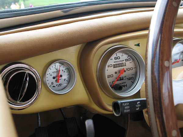

AutoMeter Pro-Comp programable fuel level gauge.

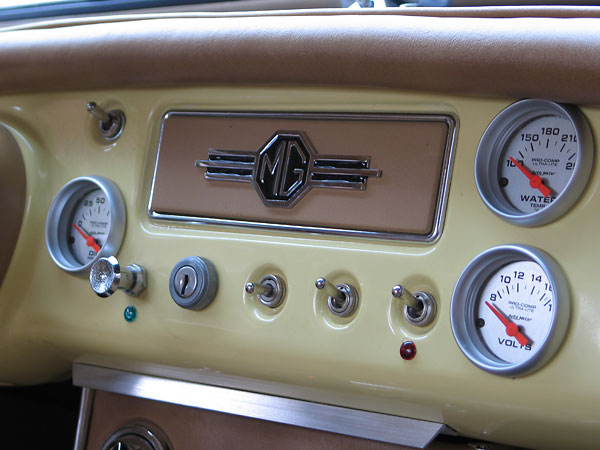

AutoMeter Pro-Comp gauges: oil pressure, water temp, voltmeter.
Custom built center console includes air conditioning controls and louvers.
1977-1980 armrest/console was cut down to suit the custom shifter boot.
pedals

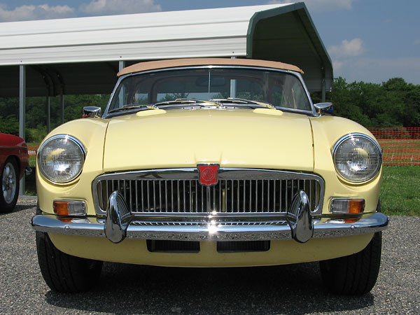

1962-1969 style grille is used with a 1973-1974.5 apron
It's so liberating to simply build your car with your favorite parts and features!
For example, here a 1962-1969 style grille is used with a 1973-1974.5 apron.
The cowl vent has been discretely blanked off.
Note that the cowl vent has been discretely blanked off.

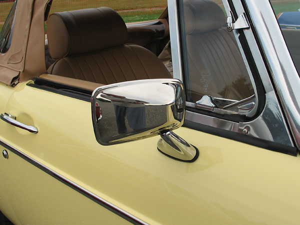

Later model (1974-1980) door mirrors.

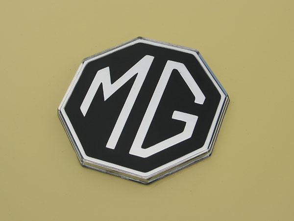

Later model boot lid badge.
Solid red taillamps (circa 1962-1969).
MkI bumper overriders on MkIII bumper: being mounted further outboard makes the car appear wider.

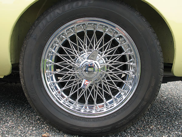

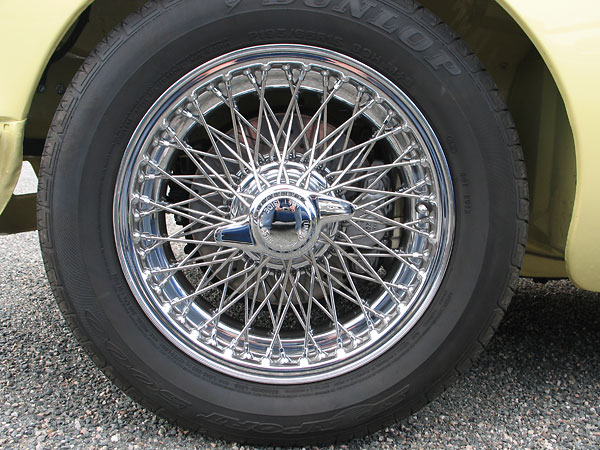

15 inch Dayton wire wheels.
15" Dayton wire wheels.
Dunlop SP Sport 5000 P195/65R15 tires.
