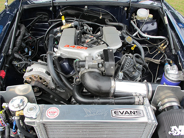

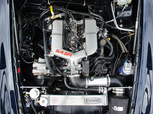

Engine: Chevrolet 3.4L V6 with FI
Conversion by: owner
How It Was Done

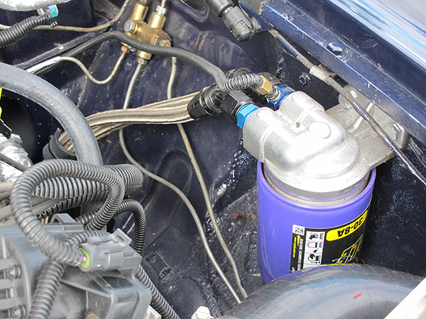

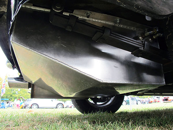

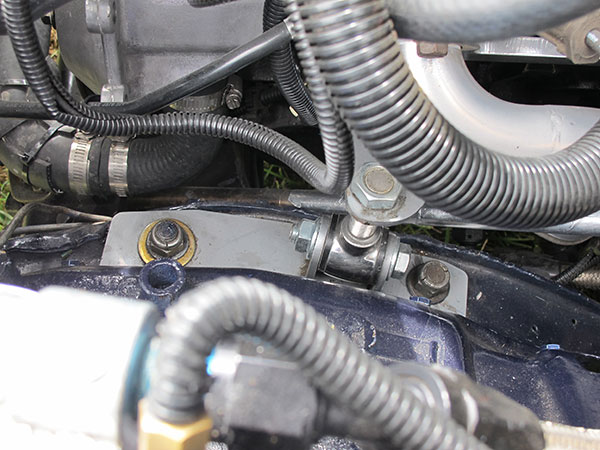

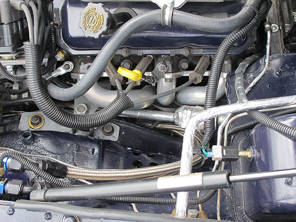

Engine: rebuilt 1993-95 Chevrolet Camaro L32 3.4L V6. Stock sequential electronic fuel injection. Stock wasted spark electronic ignition. Stock General Motors computer. AC Delco Premium Silicone 7mm spark plug wires. Custom Rod Works aluminum fuel tank, with built in Walbro high pressure fuel pump. Classic Conversions Engineering motor mounts. Royal Purple "Extended Life" oil filter (part# 30-8A). K&N air filter.

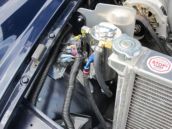

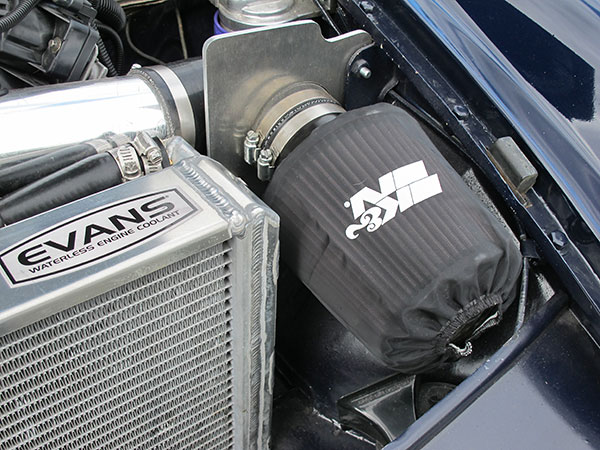

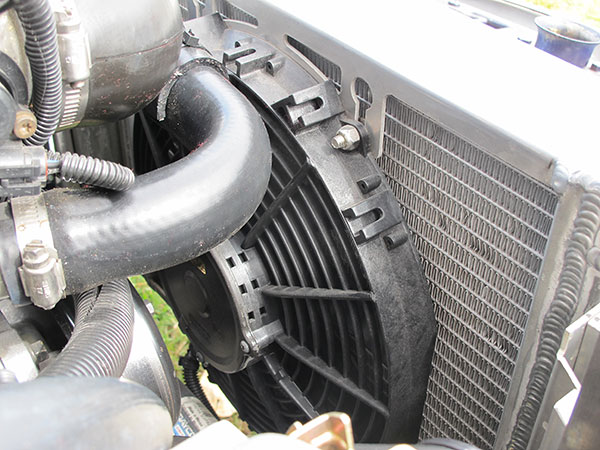

Cooling: Wizard custom aluminum radiator. Spal 1390cfm electric fan (type VA03-AP70/LL-37S). Evan's waterless engine coolant.

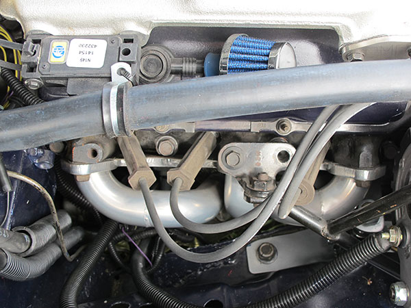

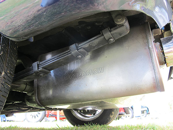

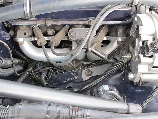

Exhaust: Classic Conversions Engineering headers. Custom 2-into-1 system. Magnaflow muffler.

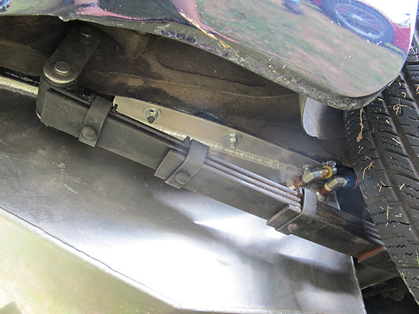

Rear Suspension: standard new leaf springs. World Wide Auto Parts rebuilt/uprated Armstrong shocks.

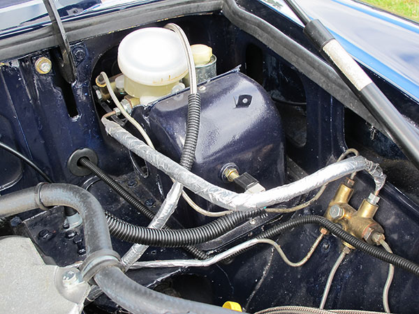

Brakes: (master) new, standard MGB master cylinder.
(front) rebuilt, stock.
(rear) rebuilt, stock.

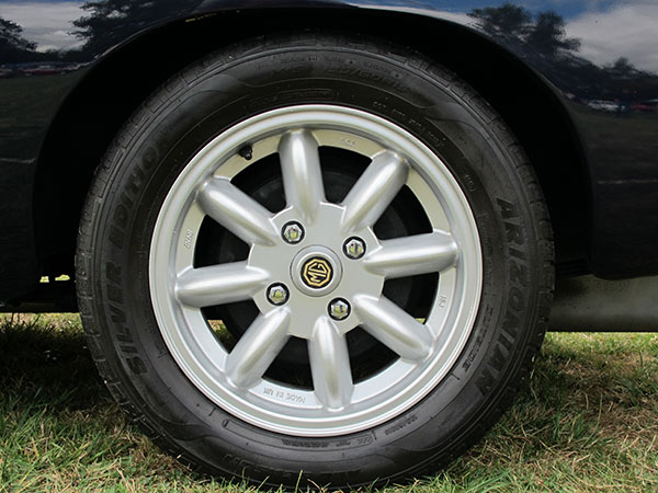

Wheels/Tires: Minator (KN Wheels Ltd.) eight spoke aluminum wheels, size 15x5.5J. General Altimax 185/60R15 tires.

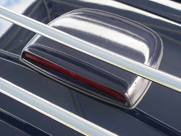

Body: Preform Resources MG RV8-style fiberglass bonnet. MG RV8 "centre high mount stop lamp" (CHMSL). Luggage rack. Factory hardtop.

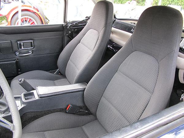

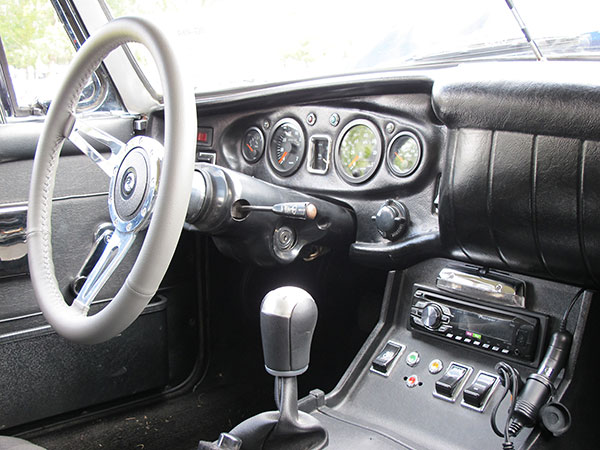

Interior: completely refurbished from bare metal, POR15 paint. Sound & heat insulation and new carpets. Flashpower "Classic full leather" steering wheel. Mazda Miata seats. Pioneer AM/FM/CD/MP3 stereo radio. JBL Flip 3 Splashproof Bluetooth Speaker 3-point inertia seat belts.

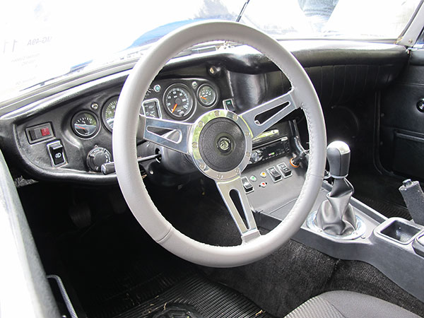

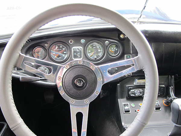

Instruments: VDO gauges (left to right) fuel level (E to F), tachometer (0-7000rpm), GPS speedometer (0-120mph), coolant temperature (100-250F). Smith oil pressure (0-100psi).

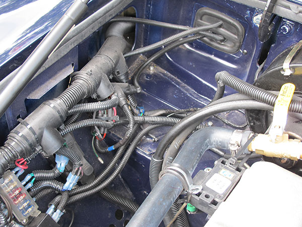

Electrical: completely rewired. All circuits LED fused. Relays on major systems. Delco 125A alternator.

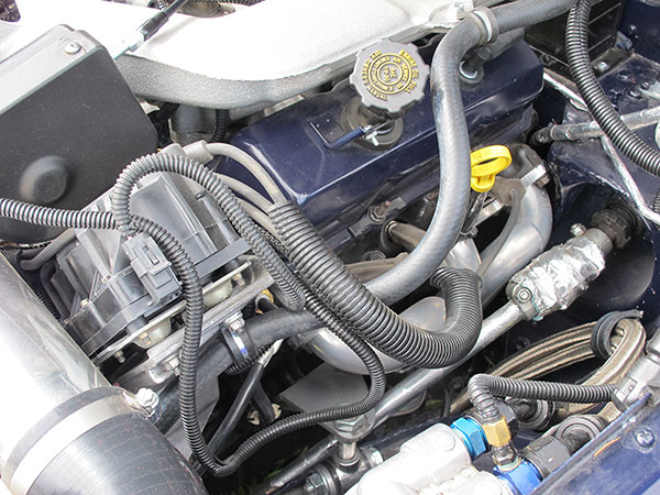

Rebuilt 1993-95 Camaro 3.4 SFI V6.

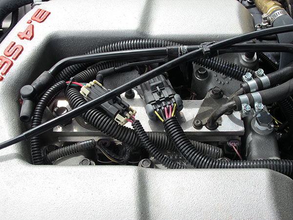

Wiring for stock sequential electronic fuel injection.

Royal Purple Extended Life oil filter (part# 30-8A).
K&N air filter.
K&N air filter.

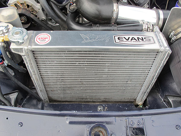

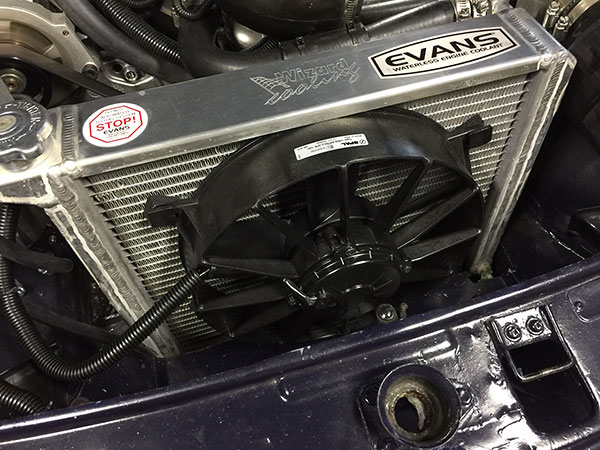

Spal electric fan.
Old: Spal electric fan, pulling. This fan was installed when the car was
presented at Portland Oregon's 2016 All British Field Meet.
Spal 1390cfm electric fan (type VA03-AP70/LL-37S), pushing.
New: Spal 1390cfm electric fan (type VA03-AP70/LL-37S), pushing.
This fan was installed after the All British Field Meet.
Relays control lights, horn, fuel pump, heater fan, etc.

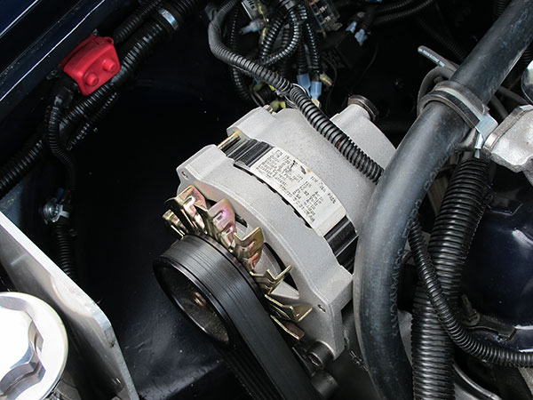

Top left: manifold air pressure (MAP) sender.

Upgraded fuse block and relays.

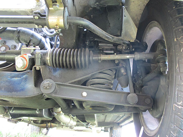

Front Suspension
Stock MGB front suspension, with World Wide Auto Parts rebuilt Armstrong shock absorbers.
Rear Suspension

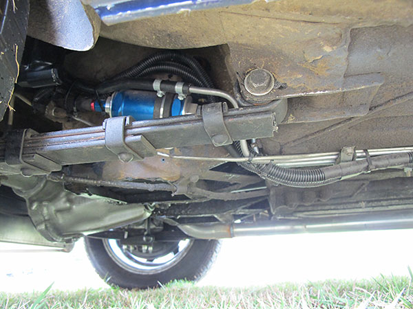

Billet aluminum fuel filter.
Custom Rod Works aluminum fuel tank...
...with built in Walbro high pressure fuel pump.
Magnaflow muffler.
Magnaflow muffler.
VDO gauges including GPS speedometer.
VDO fuel level (E to F), tachometer (0-7000rpm), GPS speedometer (0-120mph),
and coolant temperature (100-250F) gauges. Smith oil pressure (0-100psi).
Flashpower Classic full leather steering wheel.

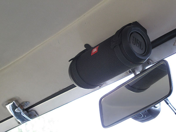

JBL Flip 3 Splashproof Bluetooth Speaker.
Mazda Miata seats.
Mazda Miata seats.

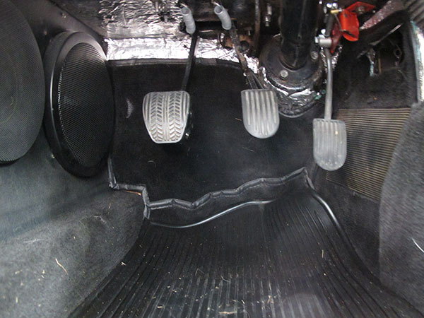

Stereo speakers mounted in the pedal boxes.

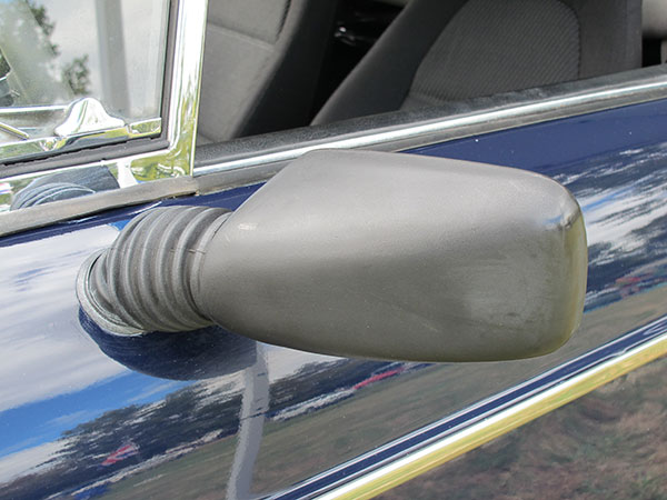

Side view mirror.
Side view mirror.

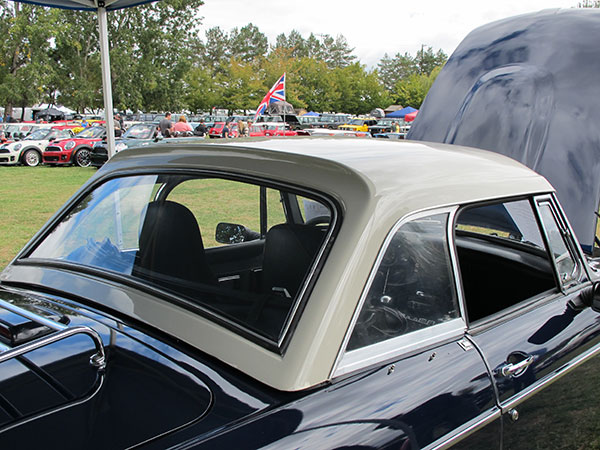

Factory hardtop.
Factory hardtop.
MG RV8 centre high mount stop lamp (CHMSL) by Hella of Australia.
MG RV8-style "centre high mount stop lamp" (CHMSL) by Hella of Australia.

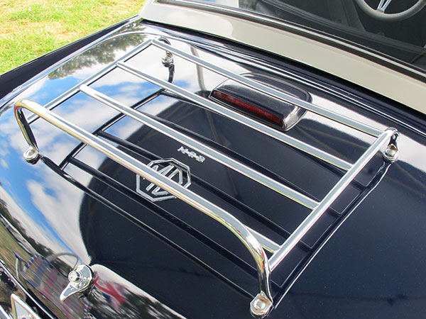

Luggage rack.
Luggage rack.

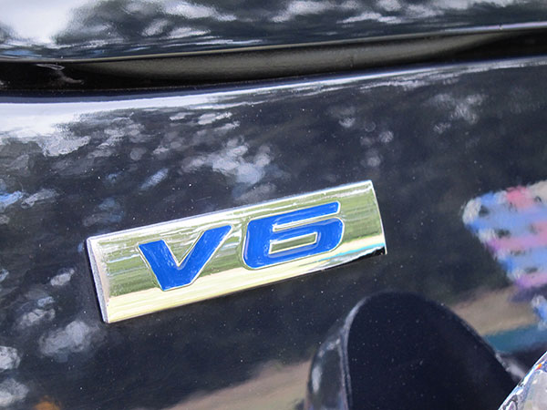

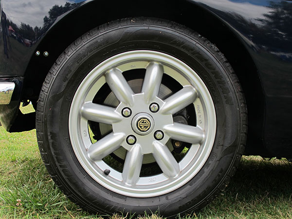

V6 badge.
V6 badge.
