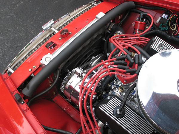

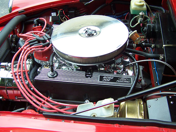

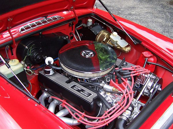

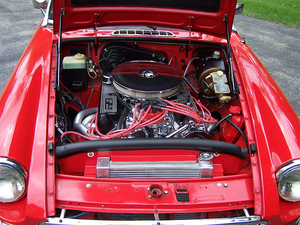

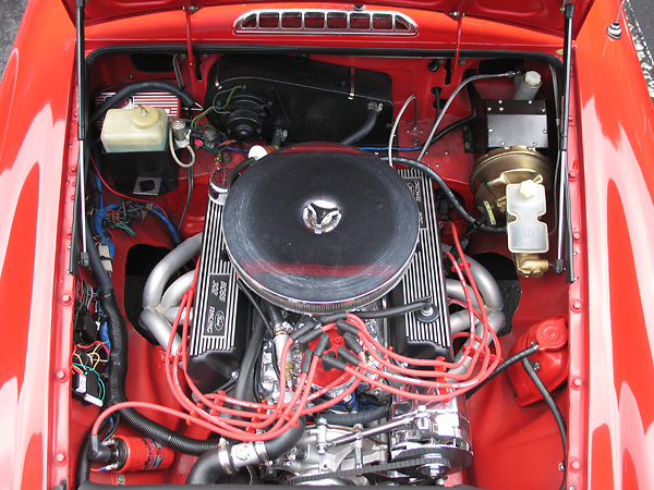

Engine: Ford Boss 302 crate engine with 4 bolt mains (Ford Racing M-6007-X302B). Aluminum heads (X306 GT-40). Hydraulic roller camshaft (E303). Edelbrock Performer intake manifold. Edelbrock 650cfm carburetor. MSD "Small Diameter" Pro Billet distributor (part number 8579). MSD6AL capacitive discharge ignition system. MSD Blaster 2 ignition coil. Ford Motorsport short-neck regular-flow water pump. Remote oil filter and oil cooler.

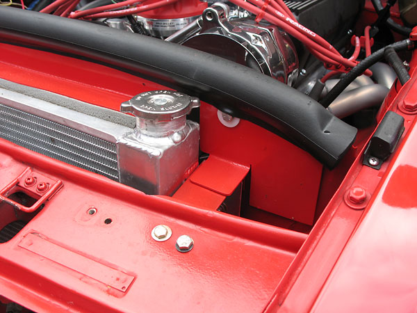

Cooling: Mantell Motorsport aluminum radiator. Flex-a-lite low-profile electric fan with shroud.

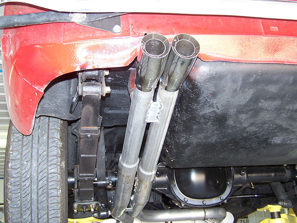

Exhaust: Fast Cars through-the-fender headers, with Jet Hot coating, exiting into 2.5" aluminized dual exhaust with crossover pipe. Flowmaster 50 Series mufflers. Both pipes exit at the rear, on the driver's side.

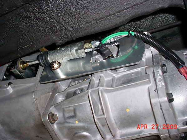

Transmission: Ford Racing Super Duty T5 5-Speed (P/N M-7003-Z). Gear ratios are 2.95, 1.94, 1.34, 1.0 and 0.63:1. Ford Motorsport Aluminum Flywheel, CNC pull-type slave cylinder, MGB master cylinder. Shifter was modified by Mantell Motorsport, and is great. D&D Fabrications driveshaft.

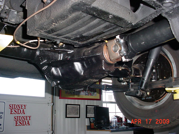

Rear Axle: Chevy S-10 10-bolt, narrowed by D&D Fabrications. Alburn limited slip differential. 3.42:1 final drive ration. (4 x 4.5" lug pattern was retained.)

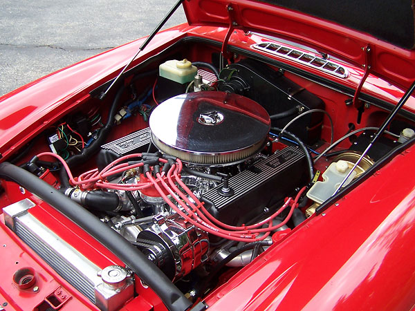

Engine conversion by: Pete Mantell at Mantell Motorsport.

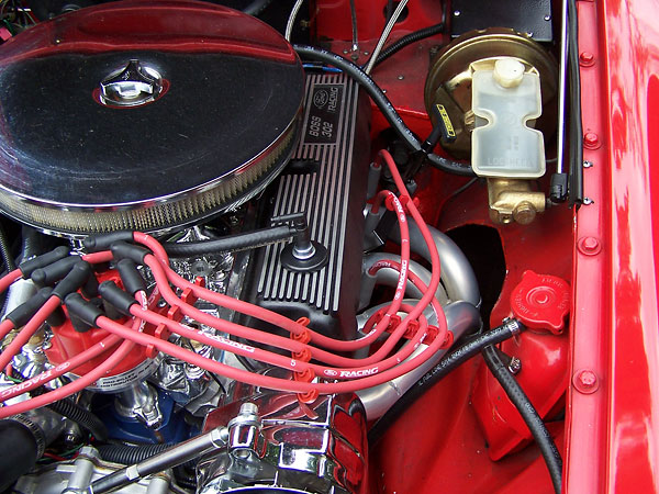

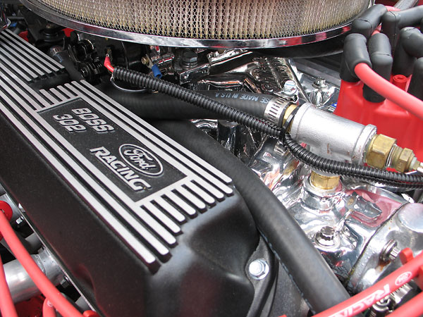

Ford Boss 302 aluminum valve covers.
Ford "Boss 302" aluminum valve covers.
MSD Small Diameter Pro Billet distributor (part number 8579).

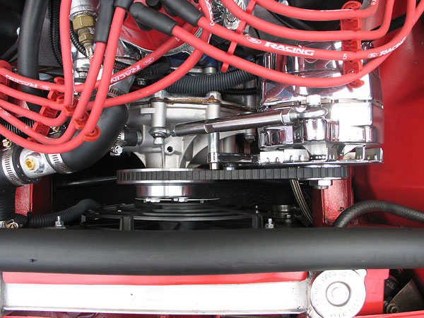

Ford Motorsport short-neck, regular-flow water pump.

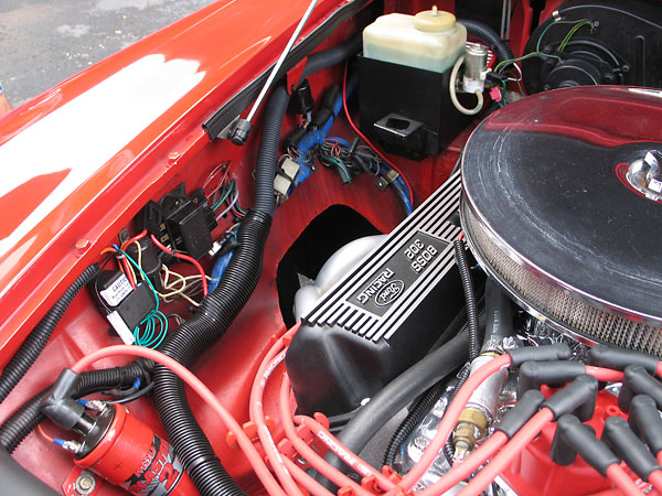

Thermostatic/electric choke wiring.

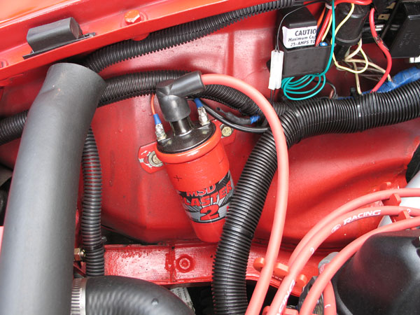

Ford Racing spark plug wires.
MSD6AL capacitive discharge ignition controller.

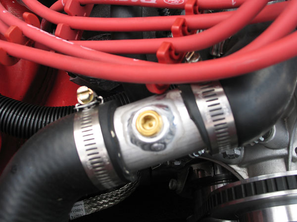

Inline vent port for purging air from the cooling system.

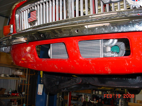

Mantell Motorsport aluminum crossflow radiator.
A recirculation shield also prevents air from bypassing the radiator.

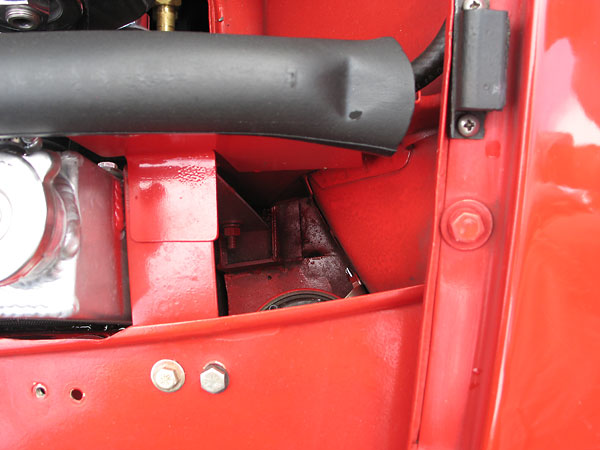

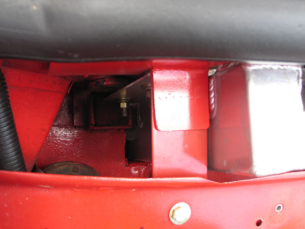

radiator installation details
front shelf and slam panel

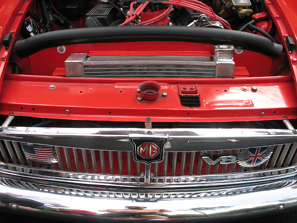

oil cooler
remote oil filter
exhaust crossover pipe
Exhaust crossover pipe, and dual FlowMaster mufflers.
Both tailpipes exit on the driver's side.
CNC pull-type clutch slave cylinder.
Chevy 10-bolt rear axle.

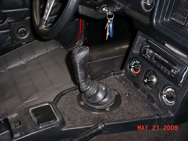

Leather covered gear shift knob.
