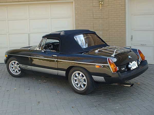

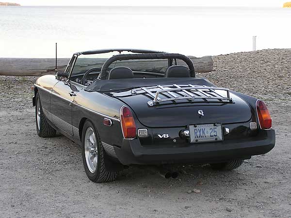

MGB V8 from the back
MGB V8 from the side
