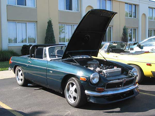

Engine: 1962 Oldsmobile 215 (10.25:1 compression, 185 H.P.)

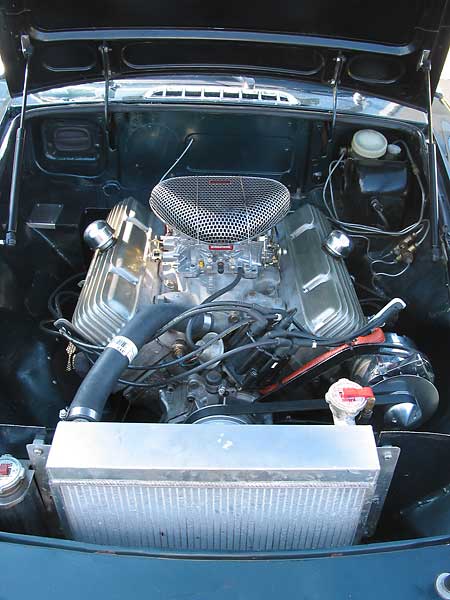

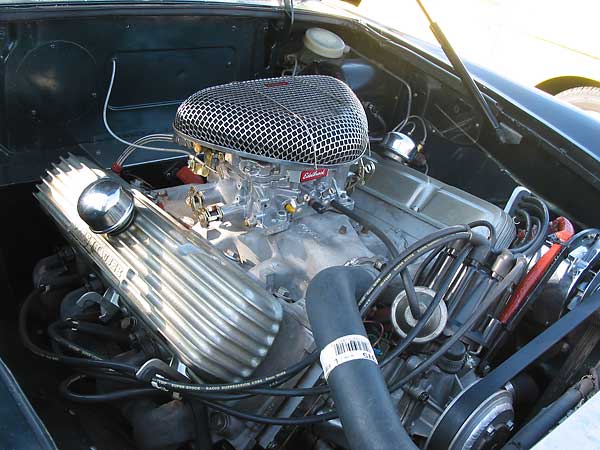

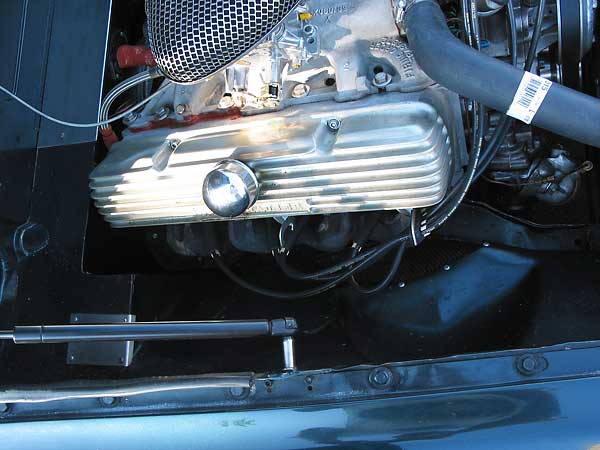

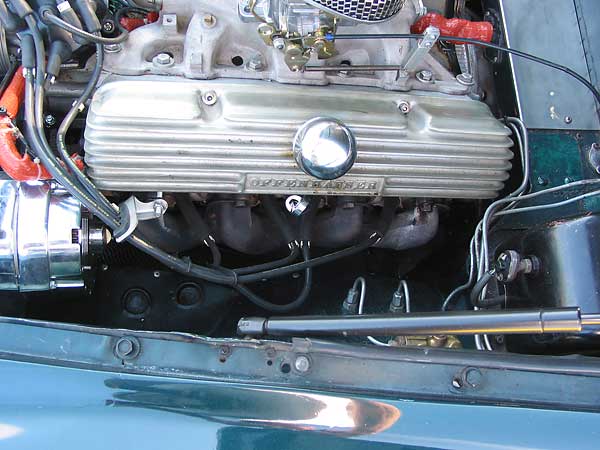

Engine: Engine Rebuilt to stock specifications. Dual Rochester 2-bbl carburetors on Edelbrock manifold. Individual carbs are same as originally supplied on the Buick/Olds 215 low compression 2-bbl engines (except now equipped with .052" main jets and progressive linkage. Choke butterflies removed.) Offenhauser P/N 5188 cast aluminum valve covers. (P/N 5189 fit Buick/Rover.) Tilton high-torque mini-starter.

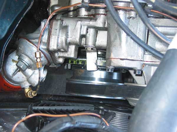

Buick V-6 "metric" oil pump base with aftermarket cheap-o spin on remote oil filter adapter from J.C. Whitney. The two stainless braided lines lead to the oil filter mounted behind the passenger side headlight. The under-fender mounting keeps the engine bay from being cluttered as well as makes oil filter changes very easy. A chromed steel cover protects the filter from stone damage.
The engine was mounted as low as possible using self-fabricated mounts bolted to rear vertical flange on crossmember. The mounts were bolted to the engine and the engine lowered into the bay until there was only 1/8" clearance between the front of the crankshaft and the steering rack. The trans tail was adjusted to give the proper U-joint angle and the crossmember was marked and drilled for the mounts.

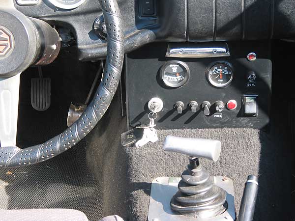

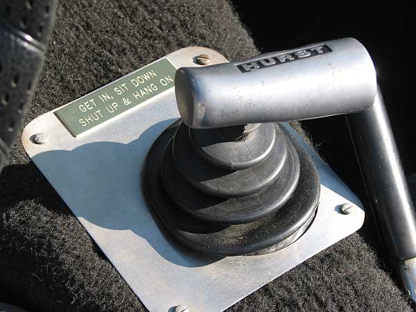

In 1995 the MG received a Borg-Warner World Class T-5 5-speed from a 1991 Trans-Am. 0.73:1 fifth gear. Transmission can be removed from under the car in about 1/2 hour. The shifter is located about 1-1/2" to the rear and 1/2" to the right from stock position. A shifter plate large enough to cover the enlarged hole in the trans tunnel was fabricated from 3/32" stainless plate and fitted with an aftermarket rubber boot. The only modification needed to switch from the T-50 to T-5 was accommodation for the T-5's angled rear mount.

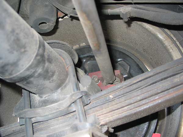

Front suspension: Moss tube shock conversion on rebuilt front end. Monroe-Matic shock absorbers. The two top mounting bolts on the shock towers loosen every 5,000 miles or so despite Lok-Tite and lock washers. 1" ADCO sway bar with urethane bushings. The engine is mounted so low that the tops of the stock lever shocks had to be lowered to keep the exhaust manifold from contacting them.

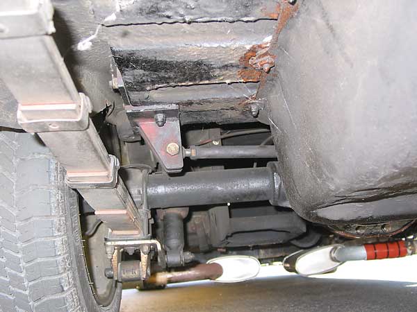

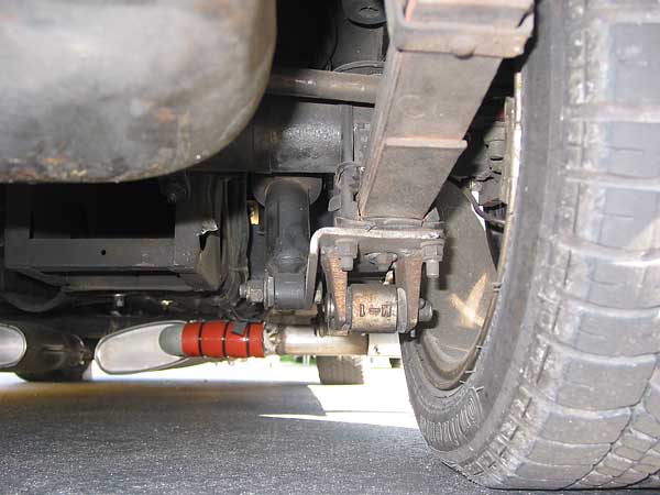

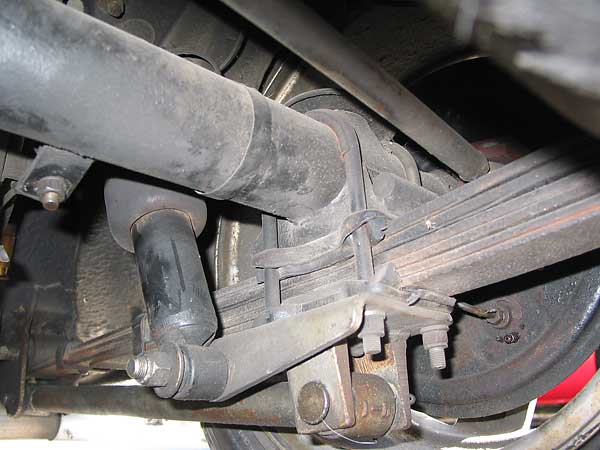

Rear suspension: Moss tube shock kit which required rewelding because of shoddy workmanship. Monroe shocks wore out after 5,000 miles. Replaced with Delco P/N 3062 air shocks originally for a Corvette. Fit right on after the top Moss shock mount was reversed to provide more travel. The air shocks are great if carrying a heavy load or for adjusting the rear suspension stiffness. The pair of shocks and the air line kit was $37.00 complete (in 1993) from Greg Hire (219) 483-1744. No problems at all after several thousand miles. Home built traction bars and a Panhard rod keep the rear end under control and located. The function of the Panhard rod is to keep the rear end from deflecting sideways in heavy turns, and it does that well. It also adds some stability to the rear end even under straight line acceleration and normal driving.

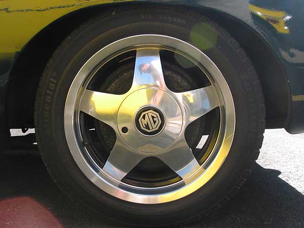

Wheels/Tires: originally Datsun 260Z aluminum wheels with Goodyear 185/60 x 14 tires. Z-car wheels bolt right on but the flat-landing lug nuts require that the wheel be mounted by using two stock tapered MG lug nuts to center the wheel on the hub. Then two flat landing lug nuts are installed and tightened. The MG nuts are then removed and replaced with flat landing ones. Also should bore out the wheels bolt holes about .020". The MG wheel bolt o.d. is so close to the Datsun wheels bolt hole i.d. that chaffing during driving can occur. This will make the wheel extremely difficult to remove, especially when laying in a puddle trying to change a flat. Wheels were then changed to Prime aluminum aftermarket units with 215/40 x 15 Continental tires. No tire rub and they grip well. Wheels were polished.

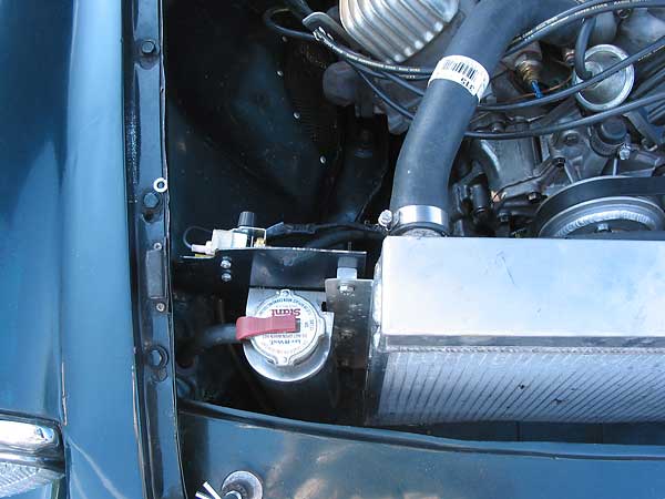

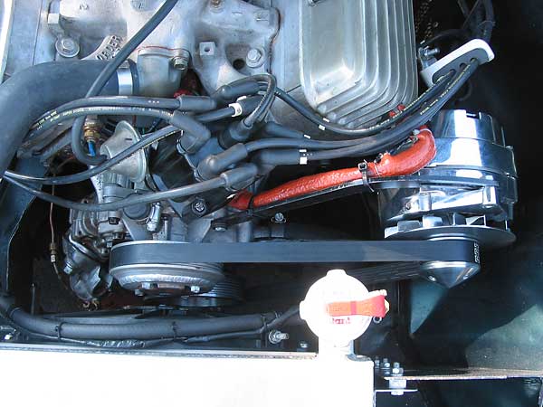

Cooling: stock 1978 MGB radiator. There is an aluminum engine driven fan on the water pump which was cut down in diameter, to just clear the upper radiator hose, while still remaining as large as possible. If you cut down a fan, the blades must be cut the exact same length or unbalance will quickly ruin the water pump bearings. An overflow tank was constructed of 2-1/2" diameter stainless steel tubing with a radiator cap neck silver brazed on. The tank is mounted forward of the radiator support plate and to the right side. A filler was fabricated from 1-1/2" stainless tubing with a 1/2" pipe plug and mounted in the top radiator hose. This provides a high fill point to avoid air locks in the cooling system. Two stock MGB electric fans provide additional cooling in case of a summer time traffic jam. This system has proven very good at keeping the engine cool. The electric fans turn on very rarely. Two cut-outs in the inner fender wells contribute to the efficiency of the system. The fender well areas next to the exhaust manifolds have to be dimpled inward in pre-'75 bodyshells in order to provide clearance for the headers/exhaust manifolds. I cut these areas out completely and replaced the solid sheetmetal with a double layer of expanded aluminum mesh, (actually gutter screen) painted black and riveted in place. The wheel wells are low-pressure areas when the car is moving, so the engine bay air (heat) is actually sucked out of the engine bay when the car is in motion. This in turn allows more air to flow through the radiator as well as getting the hot air out from under the hood. I would recommend this modification for all MG's V-8 or 4-cylinder.

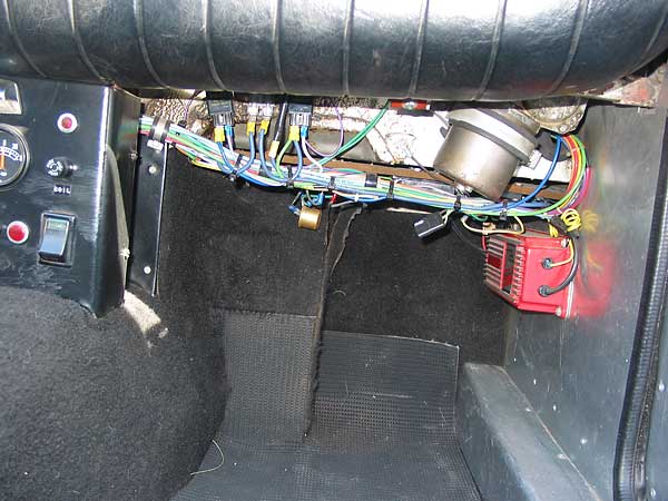

Other Modifications: All engine wiring, i.e. alternator, distributor and coil high tension lead, are all encased in a silicone/fiberglass heat resistant cover. They are routed under the intake manifold and plug into a bulkhead electrical connector mounted in the firewall just under the heater box. The coil is mounted behind the firewall in the opening under where the heater was once mounted. (The heater was discarded). When the engine is being removed, a quick pull on the plug and all the engine wires are disconnected.
All wiring was removed from the engine bay. A thirteen fuse, two breaker fuse panel was mounted in the passenger side footwell. Most of the home-built wiring harness was constructed of wire two gauges larger in size than stock. Every circuit except the alternator to battery wire and the feed wire to the ignition switch is fused. There is a remote starter switch installed in the engine compartment so that the engine can be turned over, or started, while roadside trouble shooting. The new system has worked flawlessly for four years. Prior to this I had electrical problems every 2-3 months.

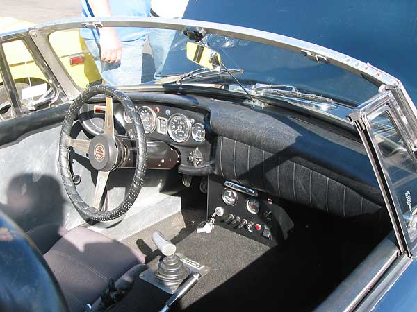

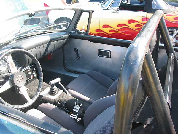

Aluminum paneled interior. Liked the looks of a friend's MGB racer but found that an aluminum floor and trans tunnel acts like a broiler in the summer sun; therefore the floor and tunnel are carpeted. Appearance is controversial. Some people like the functional clean look, other think is looks terrible. Did find out that if you rest a sweaty leg against the panels, they must be wiped down, otherwise the aluminum corrodes.

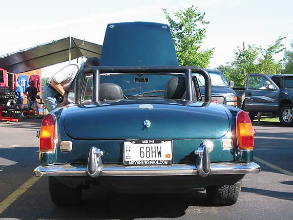

Roll bar is approximately 6" higher than those sold in the catalogs and which fit under the top. Problem with those bars is that they are often lower that the top of the driver/passenger's head! That presents a problem if a rollover occurs. I have rolled a car once and it left an impression (in my memory, not in my head)! I want plenty of clearance between the top of my balding head and the top of the rollbar. One problem is that the top frame will not fit over the roll-bar. In those very rare instances when I do put a top on. I pull the frameless stock top taut over the roll bar and secure the header rail and snaps. The car looks a little deflated but it keeps the (majority of) rain off.

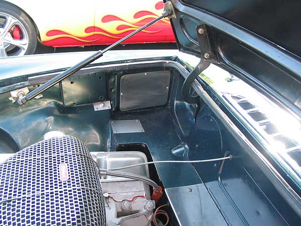

Kurt Schley's engine compartment
offenhauser valve covers

cooling system details
multi-rib fan belt
swiveling oil filter mount

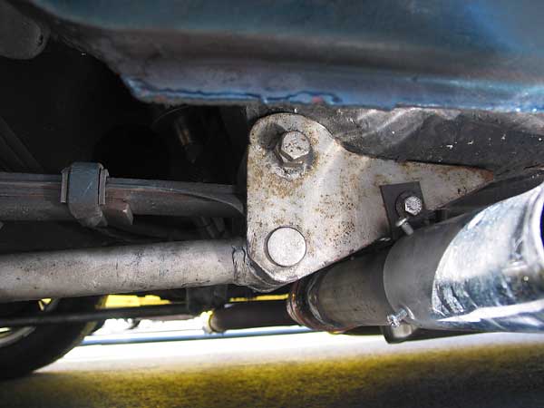

Panhard rod attachment to chassis
traction rod and Panhard rod
Panhard rod, mounting to axle
traction bars, front mounting
traction bars, viewed from rear
old school interior
custom center console, and hurst shifter
get in, sit down, shut up, and hang on
Joe Racer interior, featuring aluminum panels

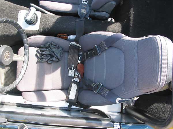

Mazda Miata seats and four point safety harnesses
wiring harness and MSD ignition
roll hoop
